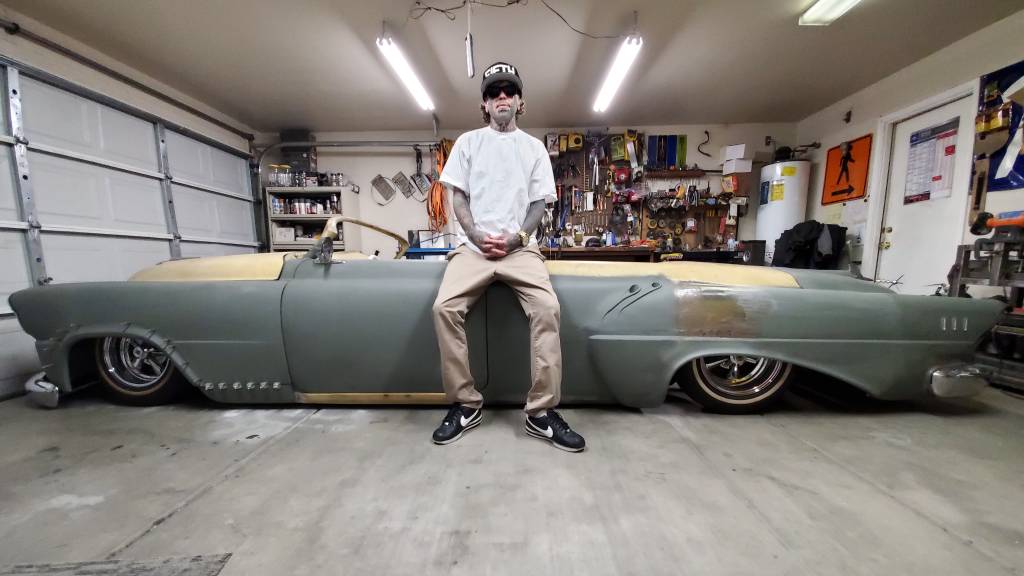

  8. Awesome work! We're all patiently waiting for more pictures. Seriously dude, you could start a show!

  10. belair
    Joined: Jul 10, 2006
    Posts: 9,024
    belair
    Interesting 53-54 Chevy throwback on the 57. Looks like you're having fun.

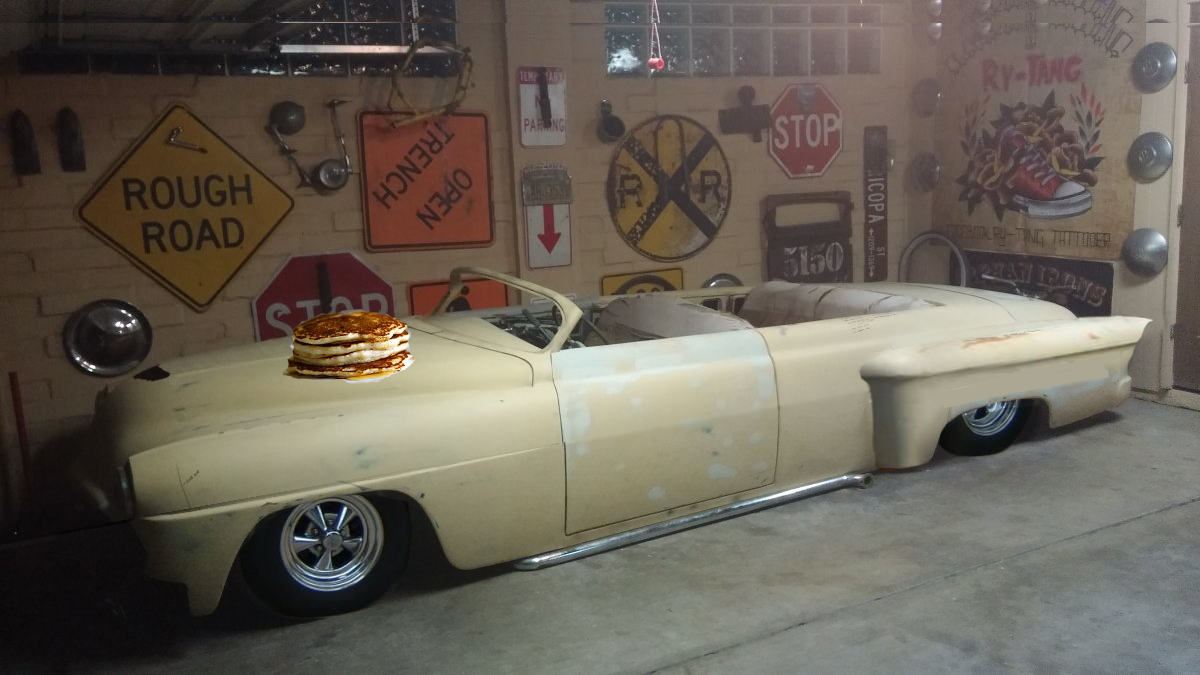

    Has anyone pancaked a hood before? I'm thinking about doing it to the car. Any advice or photos would be greatly appreciated!

  12. Gearhead Graphics
    Joined: Oct 4, 2008
    Posts: 3,887
    Gearhead Graphics
    from Denver Co
    pancake as in sectioned, or pancaked as in reshaped the opening?

    I mostly see pancaked hoods on early 50’s custom trucks where there is plenty of nose to pancake down.
    from memory and from how you do things I’ll just say it works about how you think it does.

    I hesitate to say this, because you have gone above and beyond all expectations and continue to impress with not only your skills but also your eye for design. However, pancaking was done in a lot of cases for 2 reasons, to check another box on the show entry so it had yet another modification and to close in the opening to highlight the engine when the hood was open. It also made it much harder to service the engine.
    The first is something that many here can point to in hindsight as being something that caused the decline of customs on the show circuit because "more is better" caused some pretty bad choices.
    The second is something that really only relates if you are displaying the car with the hood open all the time.
    So, first, define the opening by making the turn-downs or drip troughs or whatever you want to call them. Then make the underhood framework/support structure. Fit and hinge until all fits and works. Then extend body to trough and skin the hood frame.

  27. OahuEli
    Joined: Dec 27, 2008
    Posts: 5,243
    OahuEli
    from Hawaii
    Done.
