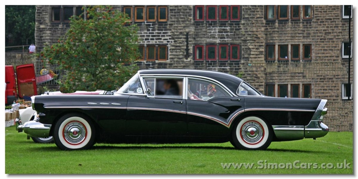

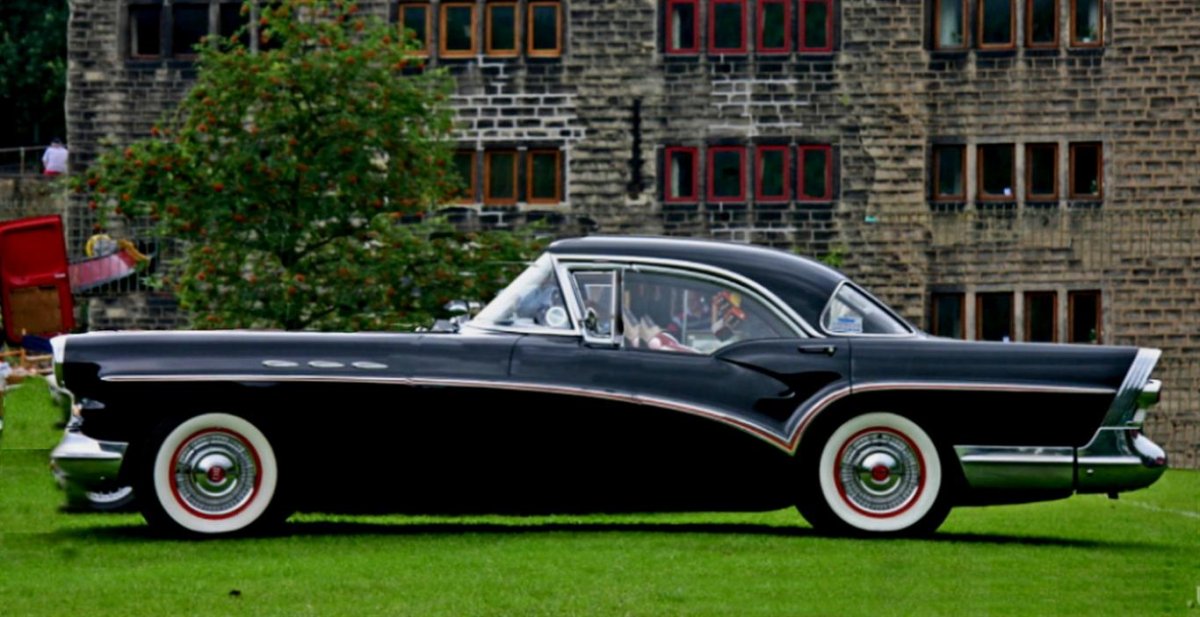

    Someday, I want to move the windshield and firewall of a 57 Buick 4 door back the length of the front door windows to make a sports sedan and sit in the back seat. Been watching for a price I like on a pretty clean 4 door car with good chrome.
    Not intending to hijack your thread, but here is pretty much what I have in mind.
    From this,
    To this
    chryslerfan55, RDE, rramjet and 10 others like this.

    Rytang, your project looks like a lot more work to me than my idea does. Other than the hood and the deck lid, you have to cut and fit and straighten every panel inside and out, including all the framing for wheel wells and door jams. That is huge.
    While not trying to minimize the reality of how much work my idea would be to complete, it doesn't appear to me to be on the same scale as yours. On mine, nothing would change from just behind the original front edge of the rear doors all the way to the back and the front fenders and inners would remain the same except the back of the fenders would have some of the front door skin grafted on. I'd need a donor hood to give up it's last 20 inches or so to be attached to the original. The biggest part of the job it looks to me would be the doors. The front half of the inner door structure would have to be separated from the skin and spliced to the back half of the rear door structure, then re-attached to the skin in it's new location to keep the raised molding line in the proper place. The roof gets shorter, but it appears that the height and width don't change and the entire firewall, cowl, windshield and front door hinge pillars all moves back in one chunk along with the front part of the floor. Of course, I don't have the car in front of me to measure and figure all the little details, but I've studied a lot of pictures of these cars in various stages of dis***embly and it really does look like a smaller job to me than sectioning. The car is already pretty low and wide and sleek compared to most of the other 50's cars, so chopping or sectioning is really not necessary in my opinion.
    My hat is off to you and anyone else that would do a complete section job and yours looks great.

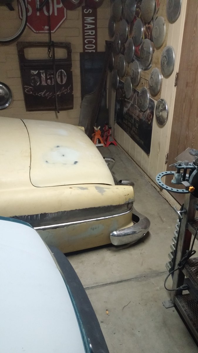

    *notice the bottom door hinges on my storage room... That's how low it is.

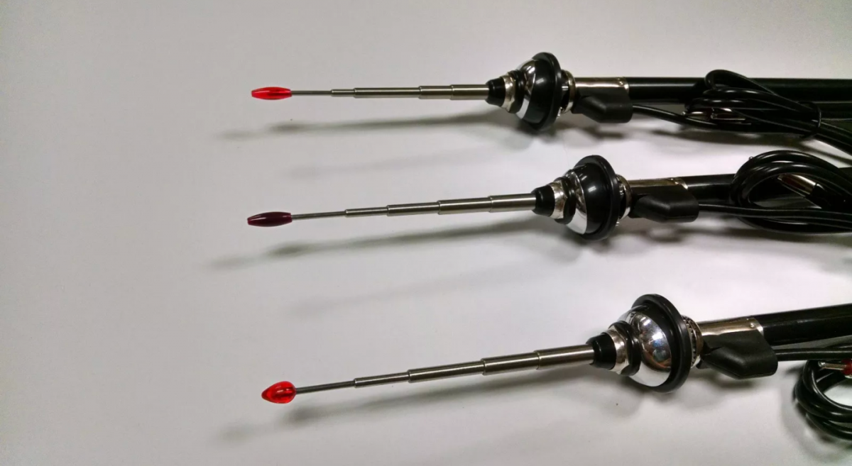

    20160621_201832.jpg I think I'm gonna take a break from the section... Maybe french a couple antennas, or start working on the taillights. Anyone know where i can get the 60s style plastic tipped antennas? Or have a set of Lee Lenses laying around for 56 Bel Air taillights??

    I follow Atomic Toppers, but I think those are a little too much. I like the cl***ic look of the ones that were on old vws. With just a small color plastic piece on top.

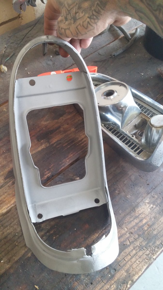

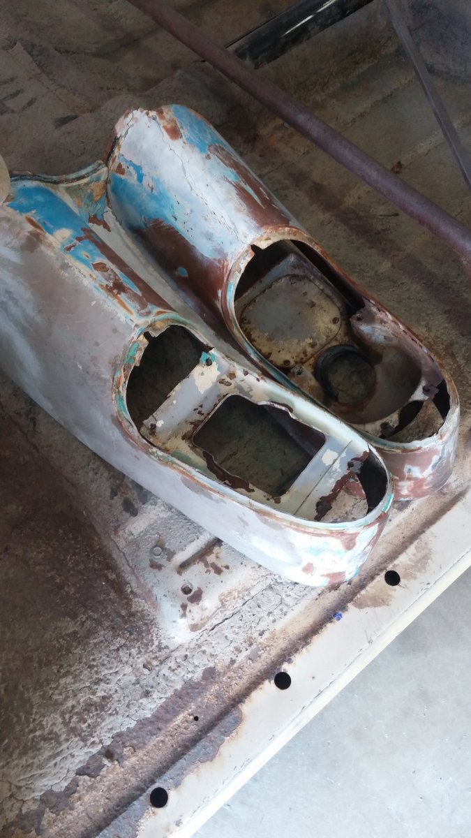

    20160628_143820.jpg 20160628_151804.jpg 20160628_152844.jpg 20160628_194239.jpg UPDATE Had a small area of rust above the stock body skirt/panel that I need to fix before I could weld them on. 20160529_175623.jpg 20160623_143819.jpg 20160623_143751.jpg 20160627_161728.jpg I also took apart, fixed and cleaned the 56 taillights. Also started t******* the sheet metal and got them sand blasted. I'm hoping to make these work in my now very small quarter panels. Thoughts?

    I fear the taillights may (or may not) take over and look cartoonishly large - they are wide and tall. But I like their look. How low can you mount them?

    I'm thinking angled, over the bumper. They aren't even close to the same shape or size of the desoto... But I'm sure I can make new shapes. I really want them to work. I want to make them look different than anyone else using 56 bel air tails...

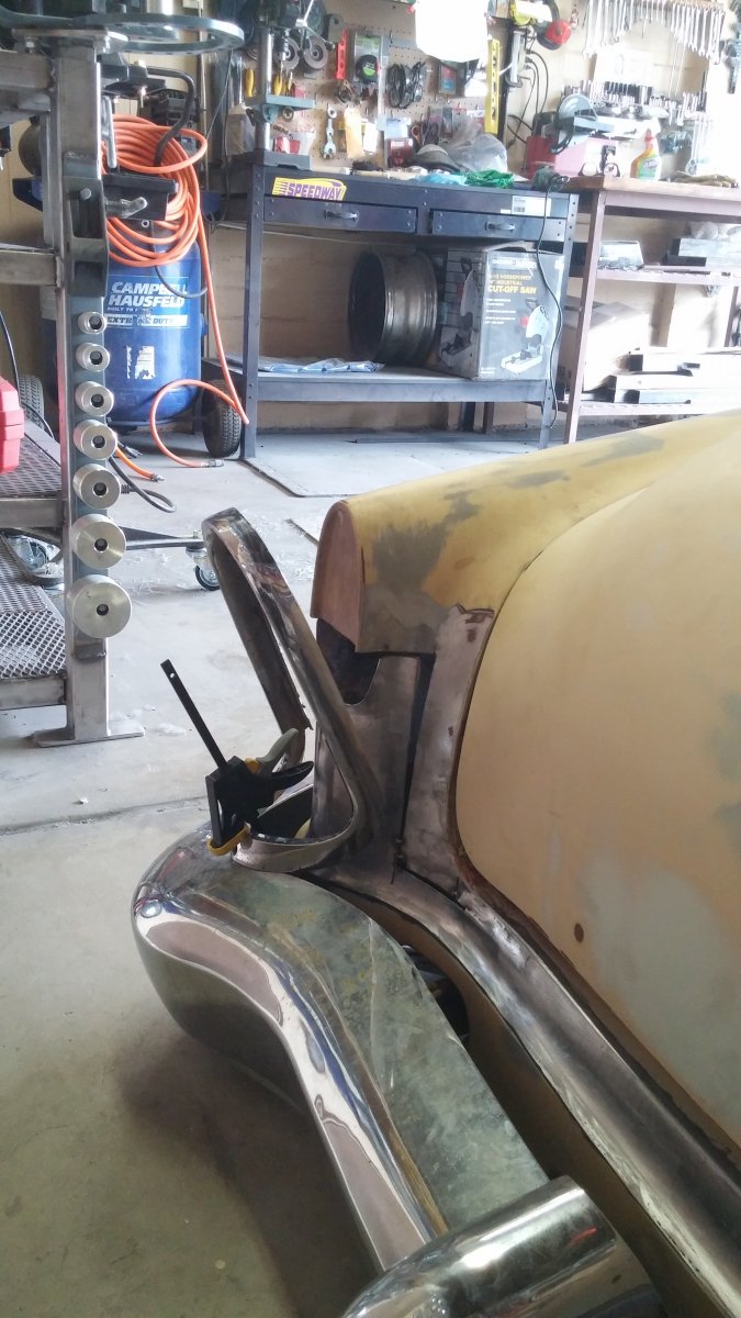

    This is kinda what I had in mind. Thoughts? Suggestions? I've never done a taillight swap before... 20160623_145202.jpg
  30. Here's a quick phone edit.
