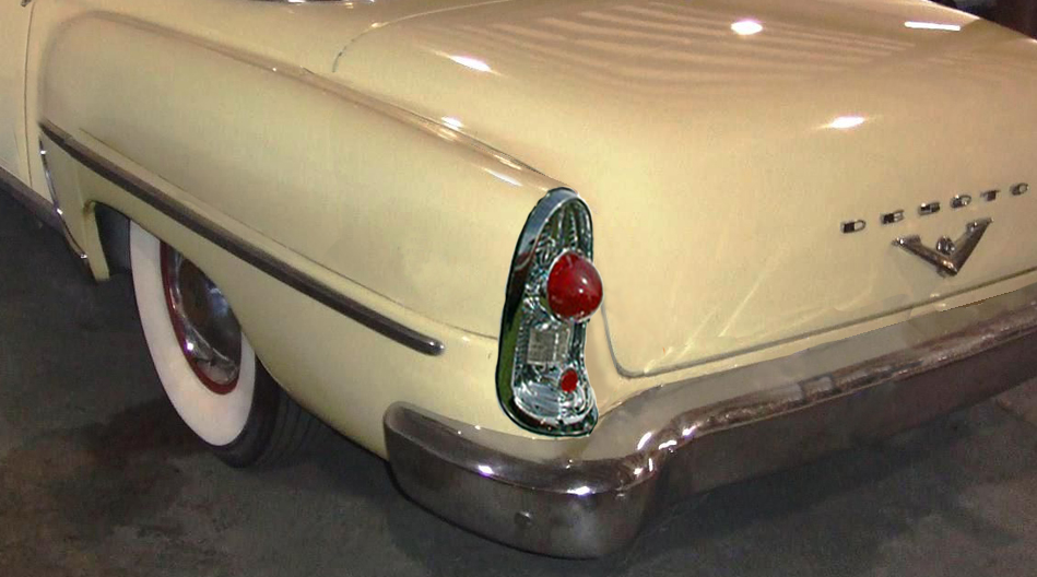

    Its a good start and the most logical position to place the new tail light.
    But........how does this work with your tailfin idea? I think you may need to decide what sort of fin to build then incorporate the 56 taillight into that.

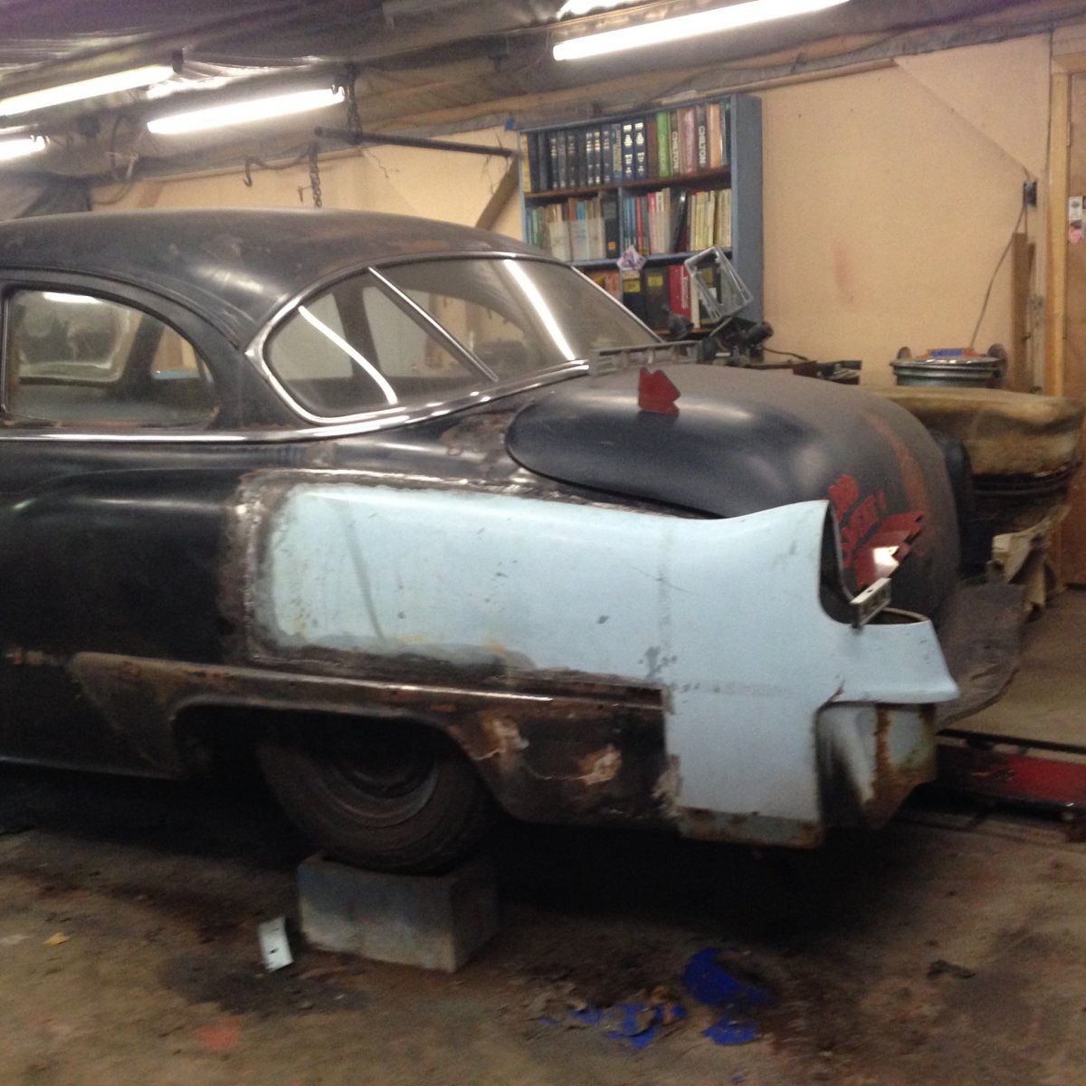

    I count these 51 cad quarter panel as a 'fin' its more of an upsweep though, I could see you doing something similar using your 56 lights. eg: http://www.jalopyjournal.com/forum/threads/the-oldsmobile-nobody-wanted.1011248/
    You can also experiment by setting the taillights upside down or at a sloping angle?
    Another member grafting Packard lights onto his Mercury it can be as simple as extending or flattening out the top of your quarter panel:

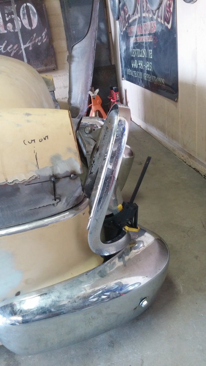

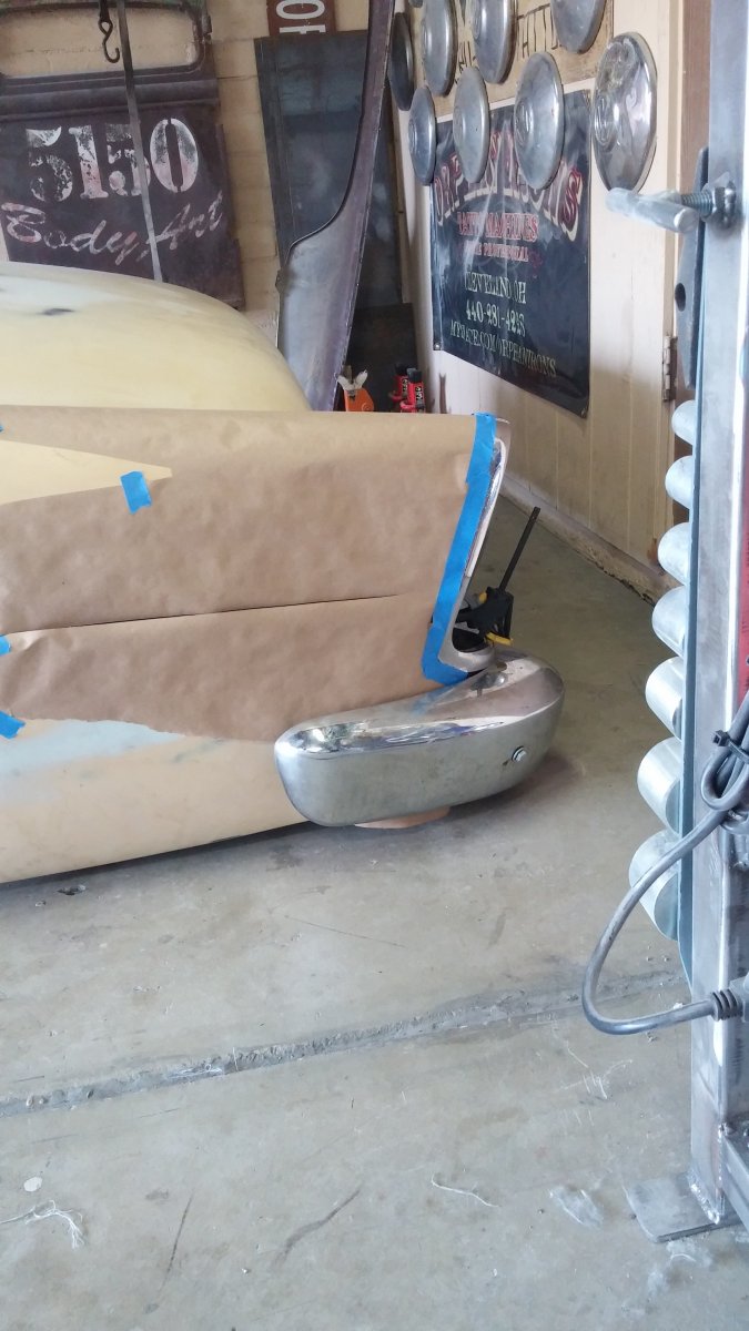

    20160623_143639.jpg Some paper just to see how it looks. I kinda like it. Now where to start? How do I keep them lined up with each other?
  9. Ralphies54
    Joined: Dec 18, 2009
    Posts: 798
    Ralphies54
    Have you tried turning the frame upside down and then papering it in. You did say you wanted them to be different than 56 chev. Eapecially if you don't need the gas filler door ! Maybe Lee lenses or ??
    rytang likes this.
  10. Peanut 1959
    Joined: Oct 11, 2008
    Posts: 2,188
    Peanut 1959
    Draw a line down the peak of each fender. Draw a line down the peak of the taillights and mount them to what's left of the Chevy fender. Tack some welding rod to align and hold the taillight units in place. Use as much of the Chevy fender metal as possible to bridge the gap. Fill in gaps as necessary.

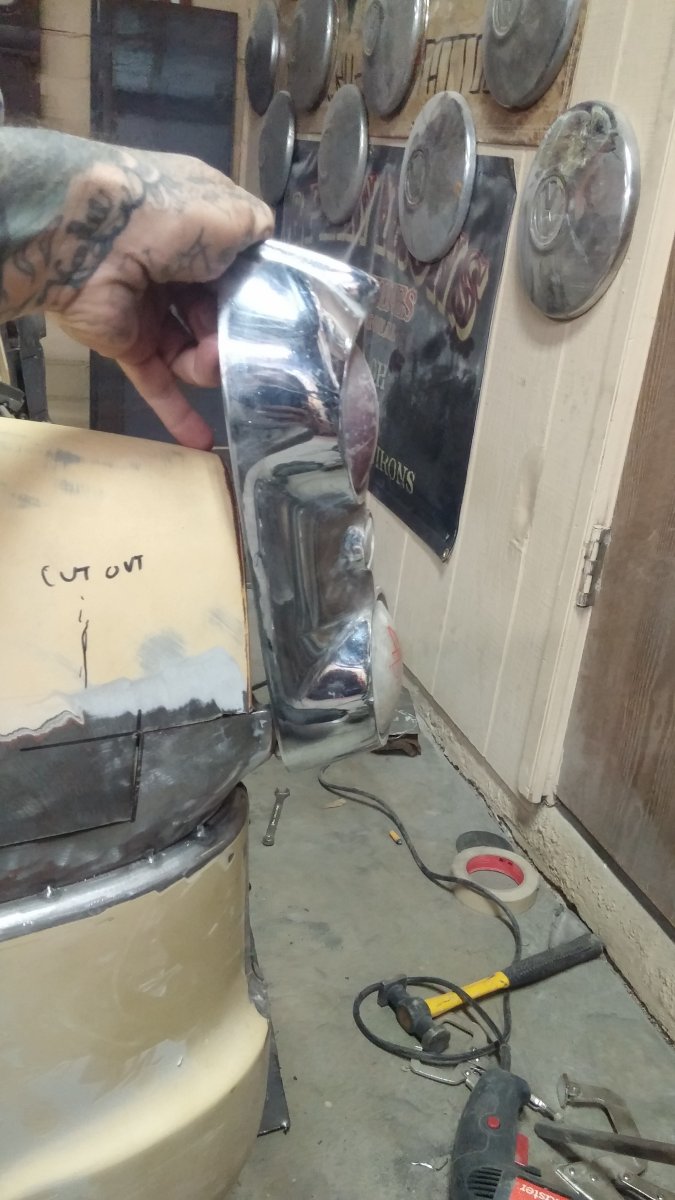

    Lee lenses are a must! I just don't have any extra money for them right now. I did try them upside down... Looked terrible. Also I know that in 56 lights you have to modify them for the lee lenses... Does anyone know what modifications?
  12. rytang
    Joined: Jun 29, 2016
    Posts: 449
    rytang
    from Arizona
    I cut all the Chevy metal away. It was too far damaged. I'll have to make it all.

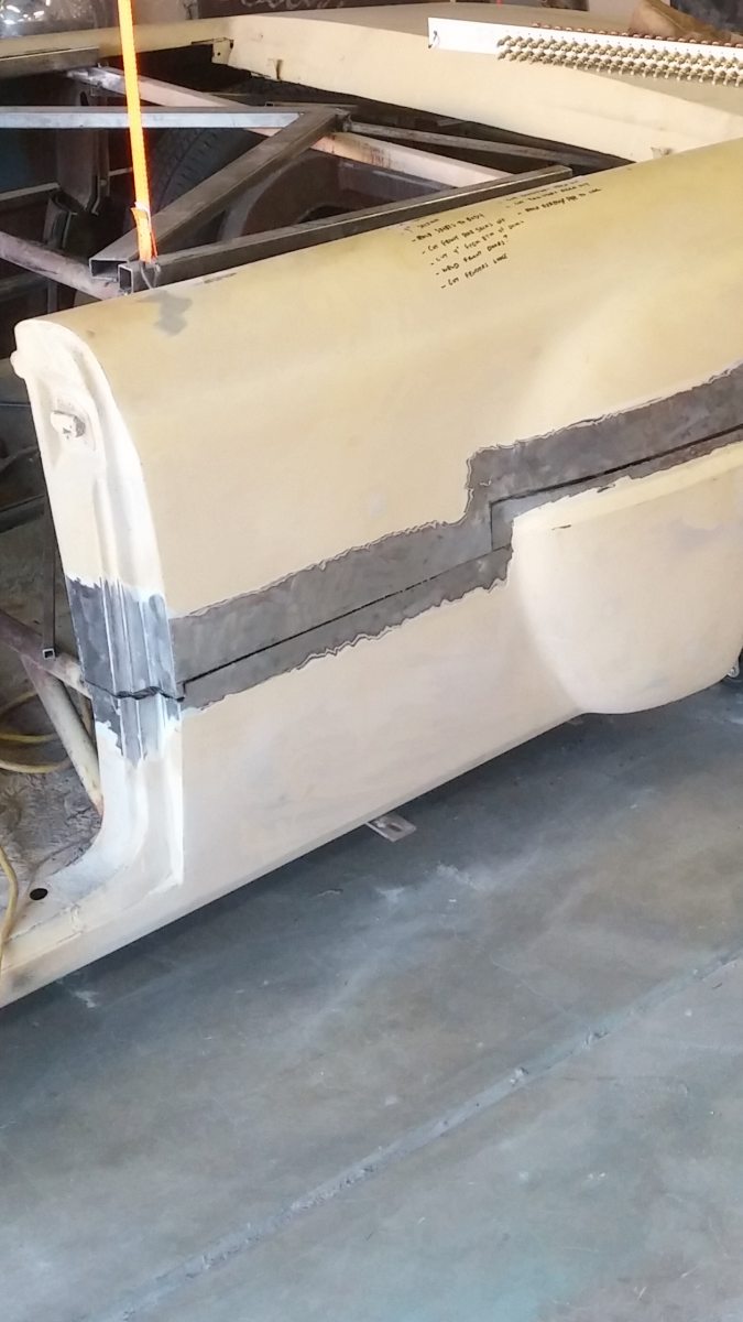

    Just read your thread from the start and its pretty impressive. I know squat about sheet metal work but guessing you made the cut step in front of the wheel well for strength? Threads like your are always a blast to read.
    Btw, if you'd like to see an idea Photoshopped I can probably whip something up. Just let me know.
    rytang likes this.
  14. rytang
    Posts: 449
    rytang
    from Arizona

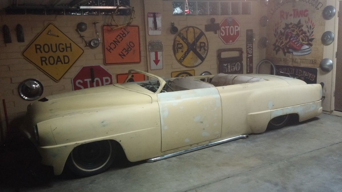

    These cuts? These were determined by the cars widest points. I did cut above the wheel area a little for strength. The door jam cut was kinda like a puzzle peice, to help align it when it went back together. I'd love if you messed with some Photoshop! I have no idea how to do that. Screenshot_2016-07-16-11-30-36.png

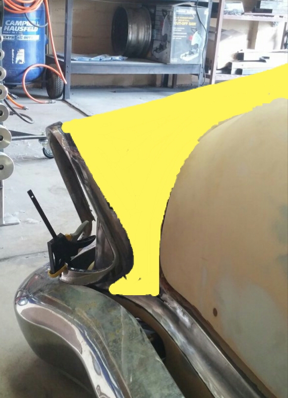

    lol already on it. I couldn't resist. One question; what is the difference in length between the original taillight and the '56 chevie taillight? lt'll help me get a good reference.
    I hope these photos help. Since the 56s arent mounted, and the stock 54 won't mount anymore... Im not sure of the measurements. I am thinking I'd like the top of the light to be angled even with the edge of the bumper. Also included a full pic of the car before the section. Thank you!

    This isn't exactly proportional but hopefully close. I raised the peak of the rear fender maybe an inch or so. 4. reworked quarter w 56 tailight.jpg e

    Thank you! I love the look. I'm going to have to angle the piss outta them tho, to make up for taking 4 inches out of the quarter panels.

  22. Just checked this..... I was going to mention to rytang it looks like he'll have to raise the top of the qtr. ( where it meets the tail light housing ) an inch, inch and a half just to get the tail light off the bumper. Could always drop the bumper an inch or so I guess.
