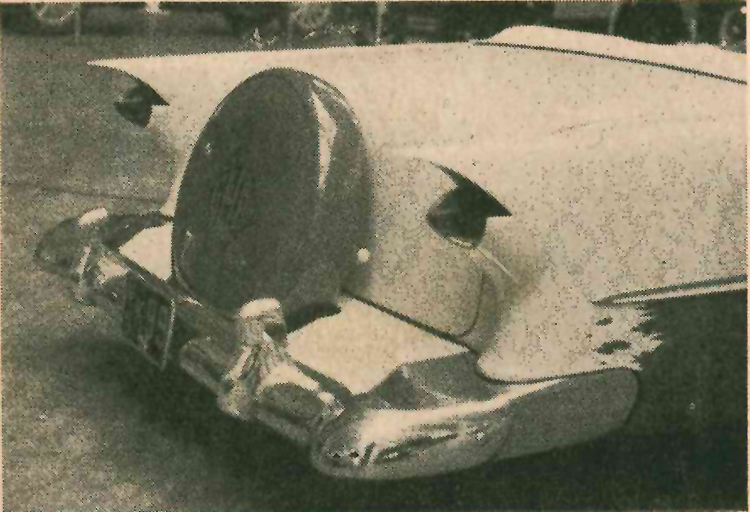

  24. Sancho
    Joined: Apr 24, 2001
    Posts: 5,036
    Sancho
    I looked some last night. I found one I will post later but it's a small photo.....
    I can think of some more but may not be able to find them. I recall another '57 Ford, I think a convertible. It was a dark color. I have only seen B&W photos, taken at a show. Seems like it was called the "spyder" (spelled that way?) I think it had a large spider painted on it.
    Another one I remember but don't even know what kind of car it was. It had beaks coming down from the top and up from the bottom. In between I think it had '56 Chevy lenses.
    rytang likes this.

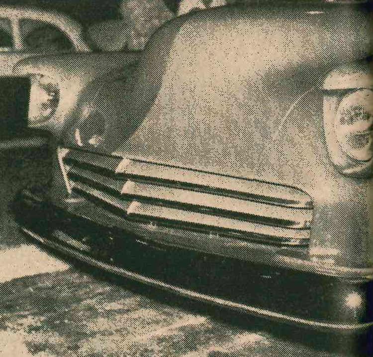

  26. Sancho
    Posts: 5,036
    Sancho
    An example from the 1958 Custom Cars Annual, although they don't curve down.
    Here's an example of headlights done that way:
    chryslerfan55 and rytang like this.
