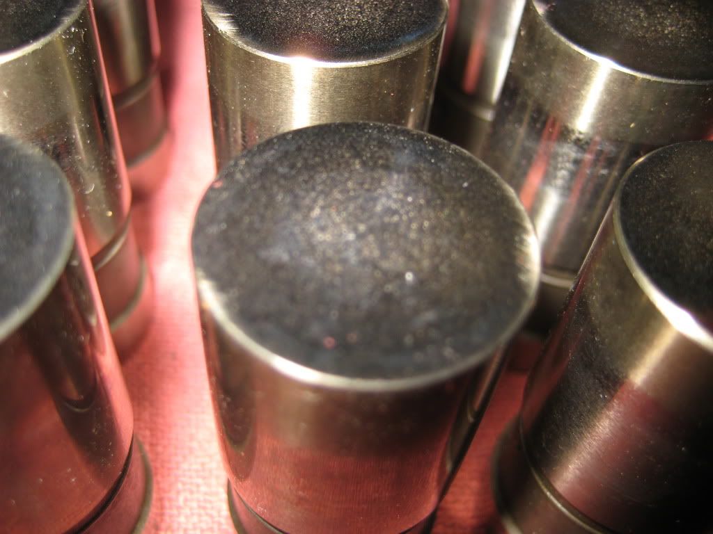

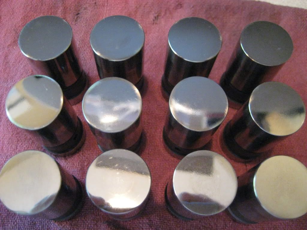

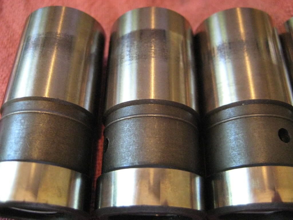

    1. Early Hemi Tech
    Yep..I found a nice set of NOS Johnson lifters for my 455 that I'm putting together. Crower also sells lifters that have a hole drilled in the face to help extend cam & lifter life, but I'm not sure if they are US made. I know Johnson's are.
