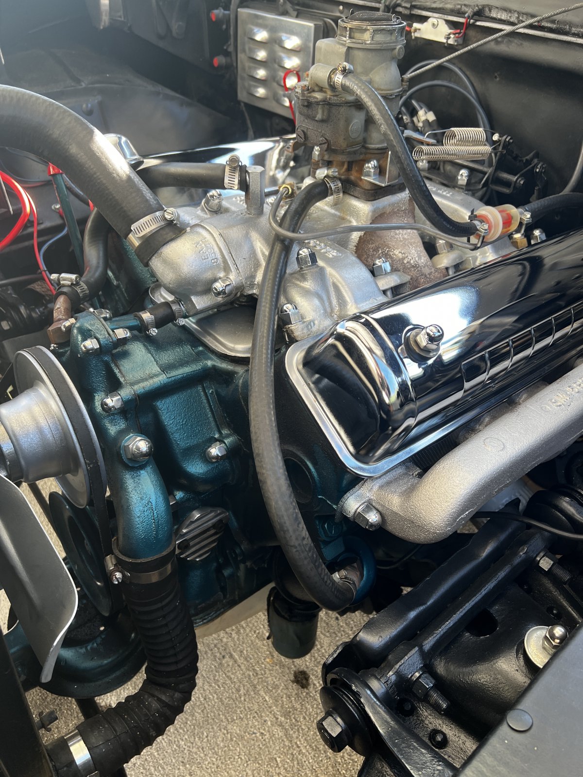

    The double canister was the latest best for loadmatic dist and was used with a 4 barrel in 56 on 2 different places on the carb. I’m guessing your 2 barrel doesn’t have that option.
    Your left side exhaust manifold looks to be a 57- up and the right side a 55-56 Fairlane which had dual exhaust,
    If you change intakes use the truck gaskets which restricts the exhaust crossover heat and won’t burn the intake paint.
    Someday if you AC, the VA and OAP units have a heater and the lines normally go where your heater was removed. The Cal 51 plate needs a metal 54 tag to be correct.

    Go for the 57 up distributor big improvement.

    What entails installing the 57 and up distributor?

    Thanks for the info. Is it possible to replace the double vacuum canister on this distributor with a single? We loosened the distributor hold down, advanced as much as we could and that double canister hits the throttle linkage. But the motor runs better as we advance it.

    What does that swap entail? What other parts have to go along with it?

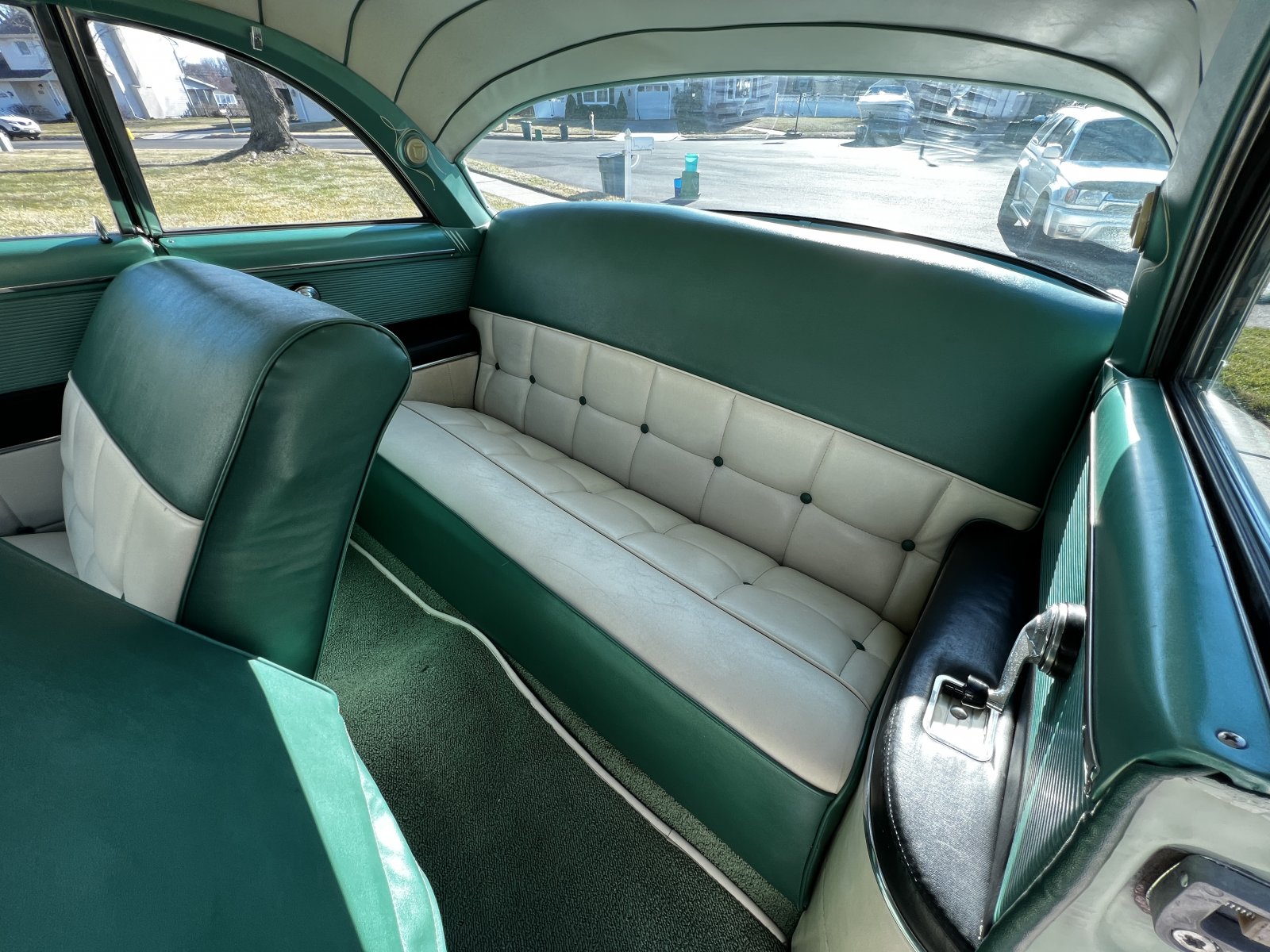

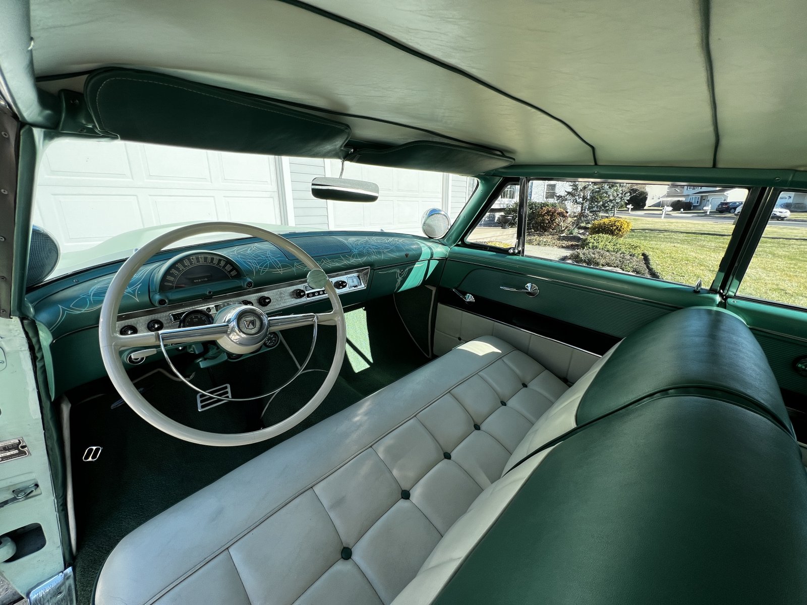

    Interior: The dash, garnish moldings, column, steering wheel, etc are all original paint from 1954! The door panels and rear side panels are original from 1954. The headliner, seats, carpet, kick panels, etc. was upholstered in Tijuana .

    You have a Load-O-Matic distributor. The inner vacuum line uses venturi vacuum to advance the timing as more air flows through the carburetor venturi. The port for this should be well above the throttle plates. probably mid-carburetor. It works like mechanical advance on more conventional distributors. The outer line, which is plugged, goes to either manifold vacuum or a port on the carb that is just above the throttle plates. This is the conventional vacuum advance that advances the timing when there is little or no load on the engine. It's purpose is to improve fuel economy. The engine will run it's best with both lines properly connected.
    Many have mentioned changing to a 1957 or later distributor. The 57 and later distributors have mechanical advance and no longer use the venturi vacuum setup. On these distributors the vacuum canister has only one port and it is for vacuum advance to improve fuel economy. If you ever change out your carburetor for a 4 bbl or a newer 2 bbl, you will need to change to a 1957 or newer distributor. This is because the newer carburetors do not have a port for venturi vacuum. Without that signal to the Load-O-Matic distributor the engine will run with fixed timing. That's okay for a race engine but not a street driven engine.

    Thanks for the info! Since that distributor has the double vacuum canister I can’t advance the timing any further. It hits the throttle linkage bracket. The motor is definitely sounding better advancing it with more response and not lazy / sluggish. Would it be possible to remove the second canister that’s plugged so I can advance the distributor more? If not, any ideas on what else I could do? I don’t plan on putting a 4bbl on right now, but if I wanted to put a 57+ distributor on it will I have to change the cam gear from 13 tooth to something else?
