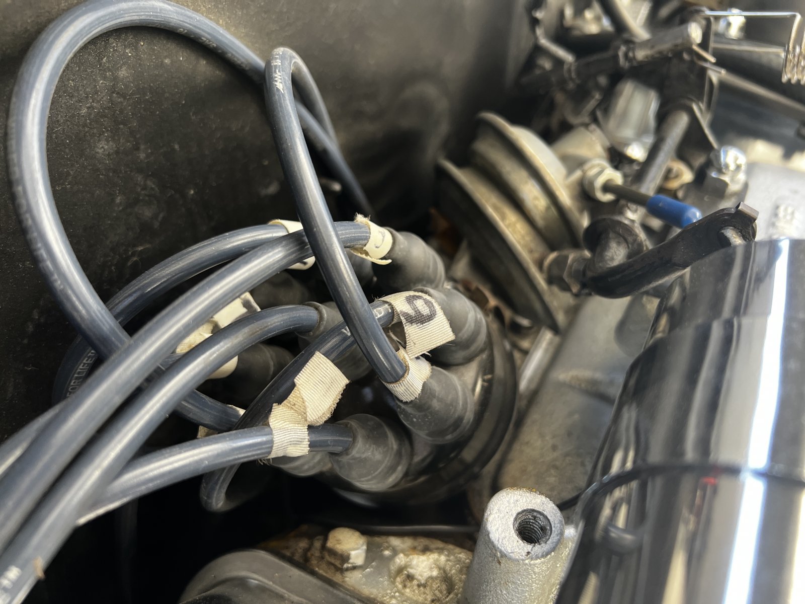

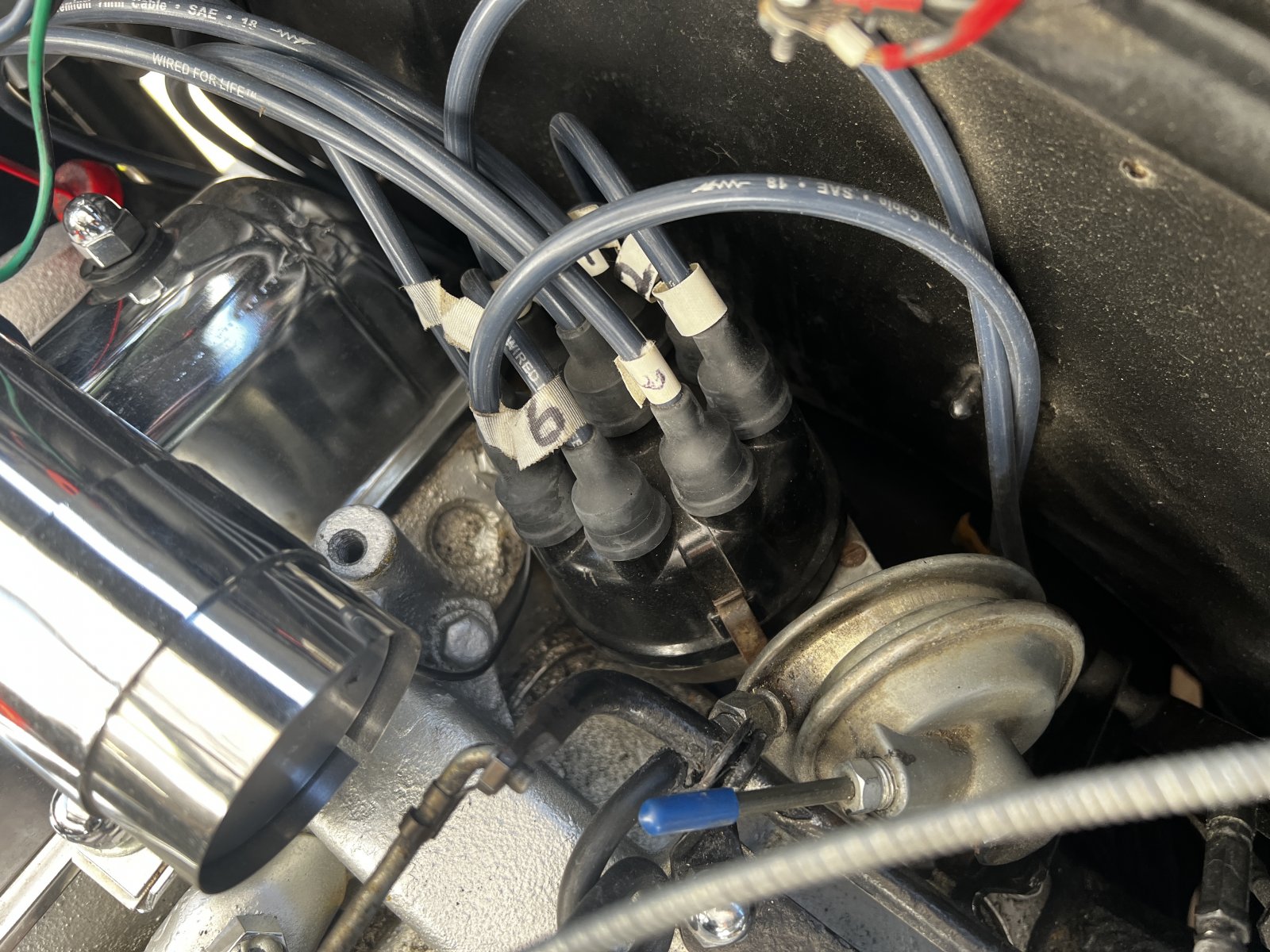

    You can “clock” by just moving each spark plug wire one position back or forward one spot for which ever direction is correct and adjust it accordingly. May be easier.
    I ran my 56 with a single canister loadmatic for a few months with a stock 4100 Holley before I changed to a 57-up and Carter WCFB from a 53 Cadillac. It ran fine in fact very well and the change came because I wanted a different carb.
    Today a lot of mechanical advance Fords distributors are converted later engine models and not original yblocks and there have been problems with them. I’m not sure if there would be a difference using the earlier gear.
    I like a combo distributor but Ford made the loadmatic work for many, many years.

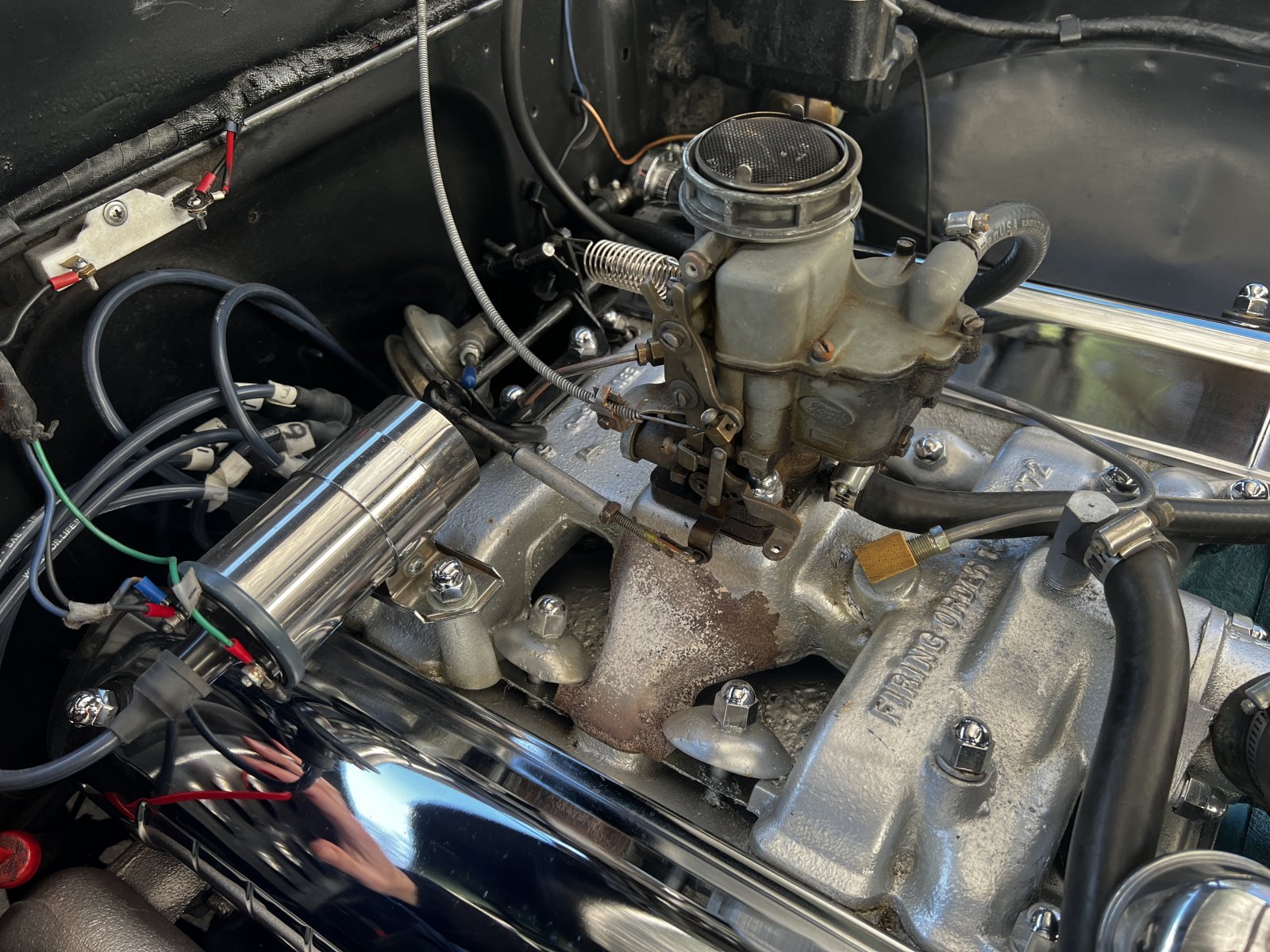

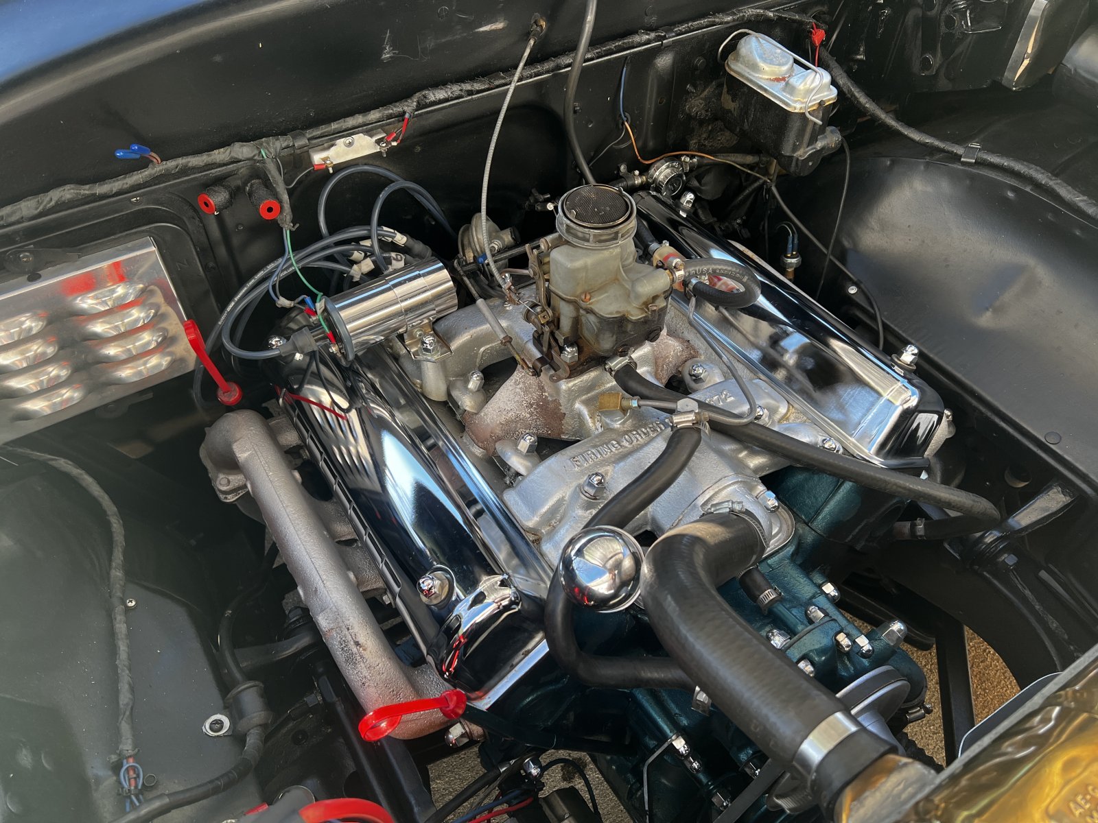

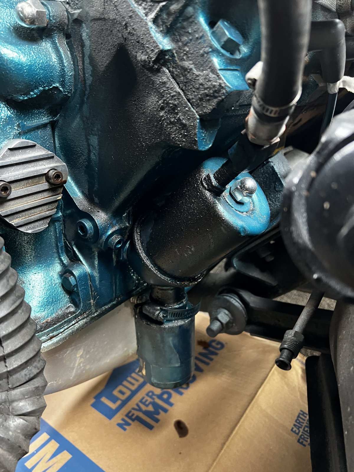

    Is this hose up front going to a small canister the road draft / blow by tube into some sort of a catch can? Is it possible that small canister has to be drained time to time?

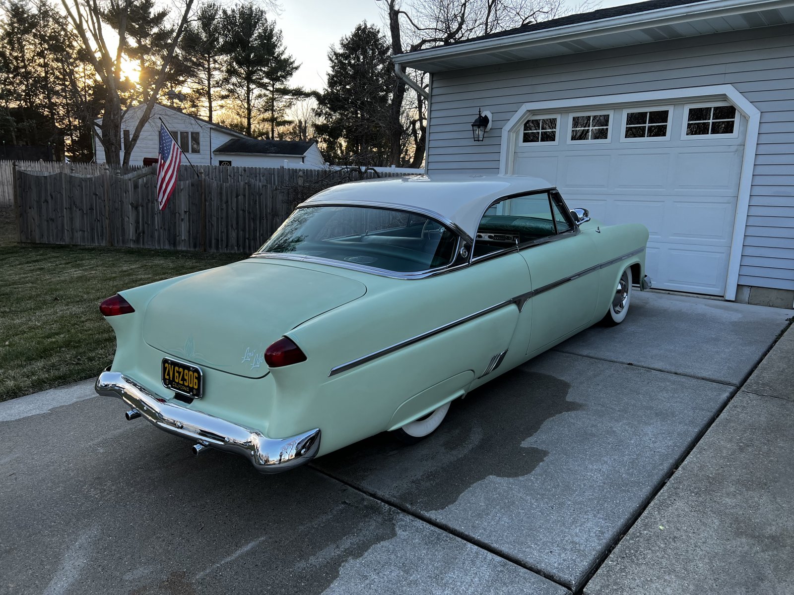

    Just a guestion here....but what is wrong with the way it sits now...?
  7. HelmuthBrothers
    Joined: Oct 11, 2007
    Posts: 791
    HelmuthBrothers
    from New Jersey

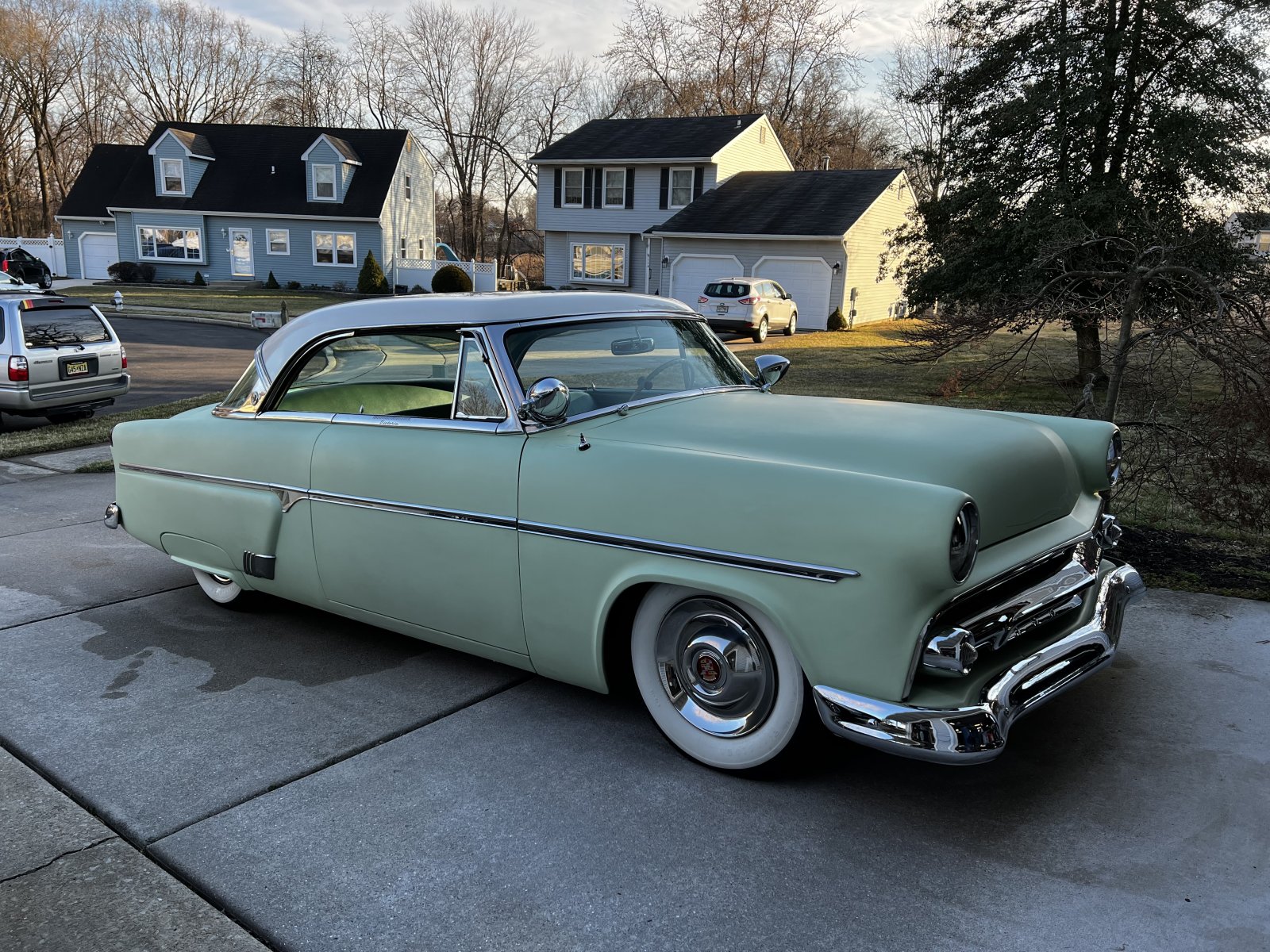

    40292736-B249-4ED0-A030-DBEE2F5544A9.jpeg Top photo is now and bottom photo is the original stance. Had 3” blocks and air shocks. Now it has 2” and has a slight forward rake.

    If you look carefully I believe you will see a PCV valve somehow attached to the original crankcase breather canister. Many Ford guys have discussed this on the Yblocksforever.com page and it really not advised because of oil splash. Most install a PCV vale from the rear of the valley cover of a 62-64 car/truck or a 55-57 Thunderbird one.
    Any oil caught in it should drain back into the engine on the style I had on my 56 The draft tube seems to blanked off at the bottom of the canister. There still may be a wire mesh style filter in it. There was one when the system was installed in 54. I am not that familiar with the 54 and it may well be different than the 55-57 which I am.
    To check your system, with the engine warm at idle remove the oil fill breather cap and see it the tube has suction on it. It should be able to hold a piece of paper. In A proper setup the fill cap will have a 1/2” hose line and a hose to the air cleaner on the inside of the paper element. (Many are left open like yours)
    The yblocksforever.com website has the knowledge and help of many who obviously have and like their Y’s. You can search in the site and ask anything. Ted Eaton monitors it and is one of the premier yblock engine builders of our time along with a few others. Good luck with a very nice car…

    Is the large black hose that comes off the plate under carb for PVC ? I don't see a PVC valve without a valve Its a vacuun leak causing the engine to run lean.

    Expanding your photo there IS a PCV attached to the canister the way I see it. You can see the hose and clamp on the slip on you can’t see. Then the body of the Valve itself and then the 6 sided place for the wrench. I’m betting a 3/8” threaded portion is under the 6 sided part. All early PCV valves were serviceable and came apart.
    I’d bet 99% we’re screwed into the base of the carburetor and not this direction and it’s why I stated to do the test above. I still use this style today ( V100) on ALL my PCV conversions as most are at the rear of the carbs.
    The Z28 302 SBC engines used a PVC valve that screwed into a boss on the oil fill cap which was sealed at the top. This would be the proper valve to use in this application.
    The correct vacuum reading on a closed system was engineered to be fro 1 to 3 inches of vacuum.

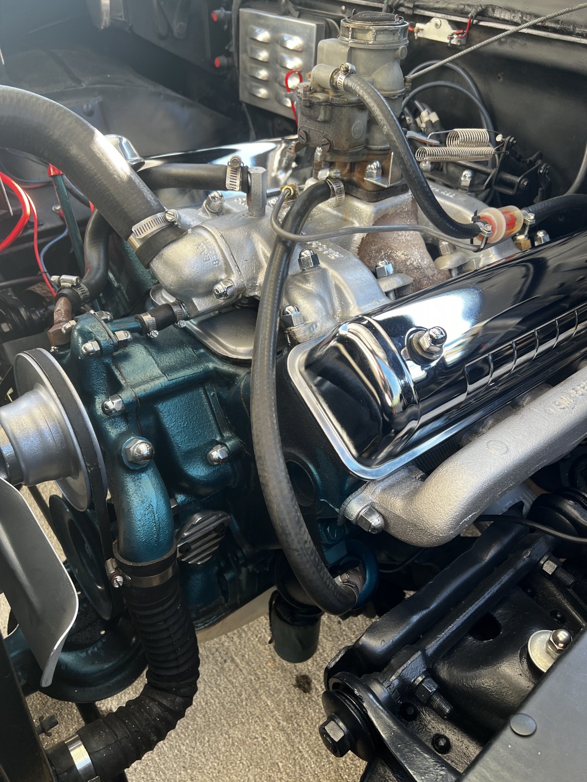

    16073401-273E-440D-B083-AB14F53ED704.jpeg Thanks so much for the info. Checked if we have vacuum on the oil fill tube with paper and we do. And yes it does look like there’s some type of PCV going into that canister at the end of the rubber hose. I don’t think we have any vacuum leak going on but this canister is making a mess. Not sure what’s going on until I can Jack the front up and get in there.

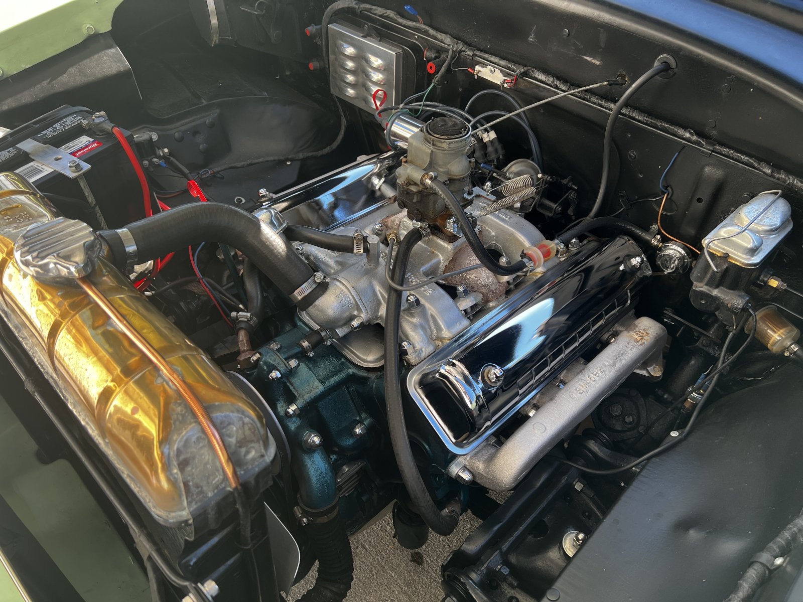

  13. You need a rubber hose to connect the metal vac*** line (to the left of that rubber hose) to your distributor for vac*** advance.

    As was mentioned, the 56 (or 55, any y block loadomatic) is part of a system with a specific carburetor. If you can’t identify the carb as being the correct one, that distributor will never work right. The 239 used a different cam (bearings and the gear) than all later y blocks. It also used a tang oil pump drive shaft, the later models used a hex drive. With the later oil pump and the 56 distributor, that’s probably taken care of. The hex drive uses a c clip to retain the shaft at the oil pump, so it can’t pull out when you remove the distributor. Hopefully that was done.
    There’s been a number of issues with recently rebuilt Cardone 57 up distributors, they’re the wrong length to properly engage the cam gear. Check that against the 56 unit before you install it.
    I can’t say about the 239, but most of us are running more than the spec advance on the initial timing. More on the order of 8-10 initial. With less advance and no “mechanical” advance from the loadomatic, your performance is about what I’d expect. So the later model distributor is probably the easiest and cheapest fix. As pointed out, there’s a lot of info on Eaton’s site. Include how to modify an early carb to use a later (57 up) distributor. I do not know if it covers the 2 barrel or just the 4 barrel. Worth a look.
    Jimmy 6 is correct about the PCV stuff, that’s another common problem for oil and/or vacuum problems when tuning.

    The bottom canister catch can was added to a cut off draft tube pipe. Take the acorn nut off and remove the top screen cover with the hose/ PCV valve and hose to carb. Inside you find 2 bolts I believe they will be 5/16” co****, remove everything else and clean it all up.
    With it all apart unscrew the PCV valve and clean it. You might need carb cleaner for it.
    Put it all back together since it works. Like I said above this is not the recommended way for a PCV system fora y block but it will work. It all should be done with a later valley cover.

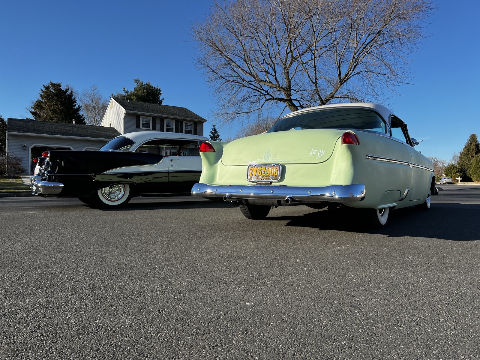

  24. HelmuthBrothers
    Posts: 791
    HelmuthBrothers
    from New Jersey
    3157A911-8D93-4A22-B5CB-9C2621F7BC10.jpeg 976C291F-A9C5-4E34-A508-EEE4879B398F.jpeg Here’s the current state of the car alongside my dads 37 Chevy which just came back from paint and is ready for re***embly. This weekend I’ll be able to knock out most of the issues with the 54.
    Heres the list:
    New tires and spin balance wheels
    Install 3” blocks
    Check for driveshaft clearance
    Replace fuel sending unit
    Replace worn upper steering column bushing
    Replace front and rear shocks
    Replace fuel line hose for hard line at pump
    Repair bent shift linkage
    Replace antenna
    Install 57 distributor
    Install Rochester 2g
    Check spark plugs & wires
    Clean and paint suspension / frame

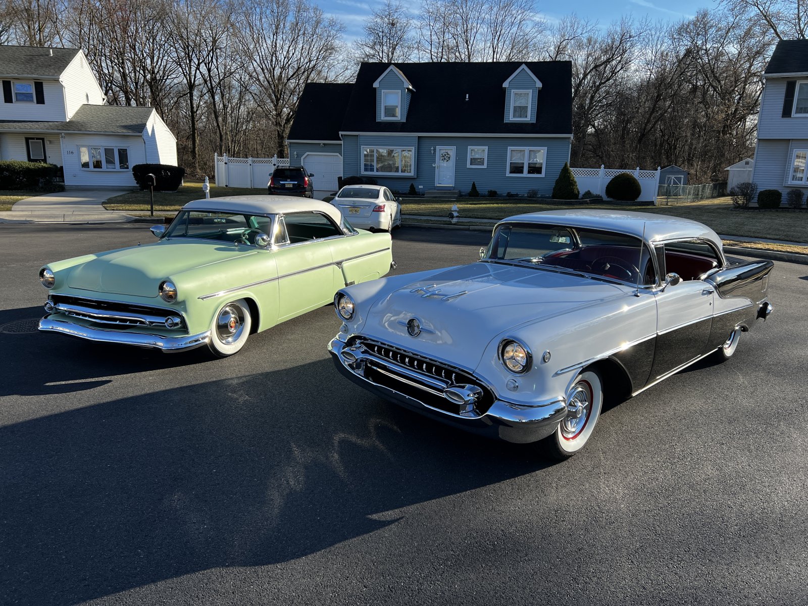

  28. In a previous post I mentioned that Mr. Izardi has a killer garage find coupe. Well, here ya go. 2935C97C-868D-49B6-A322-0C4B9D4181B6.jpeg
