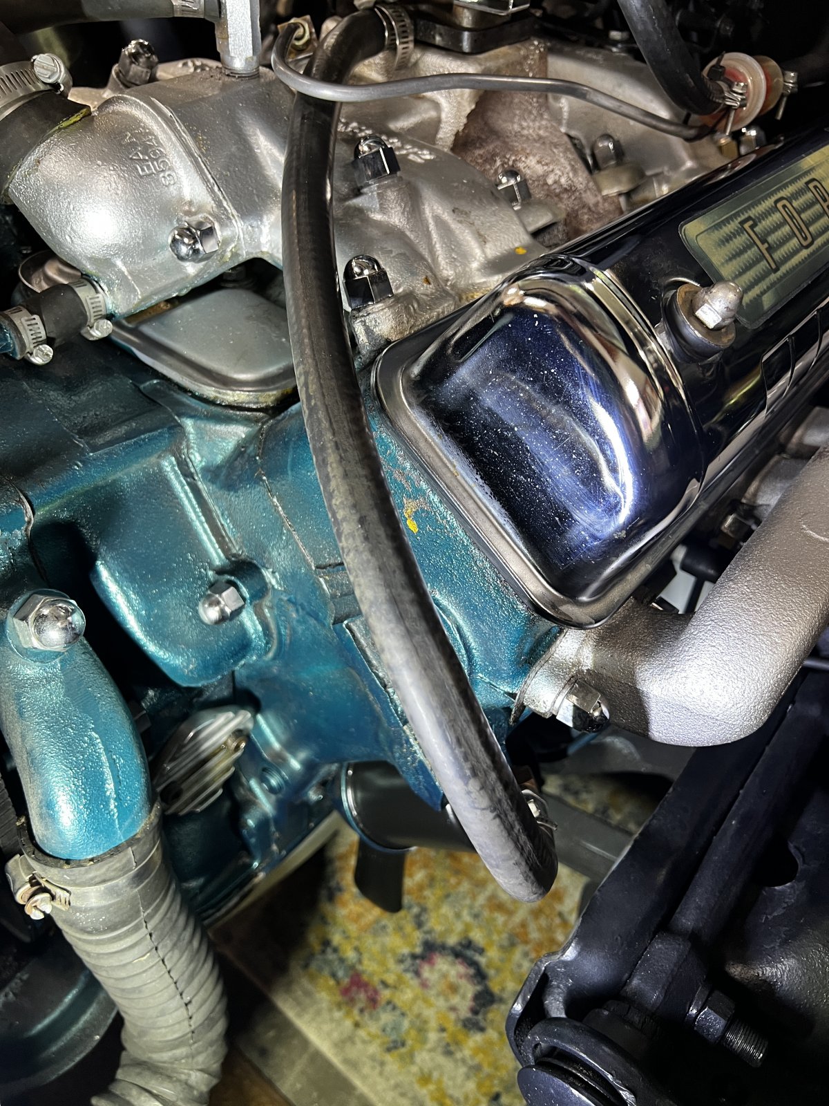

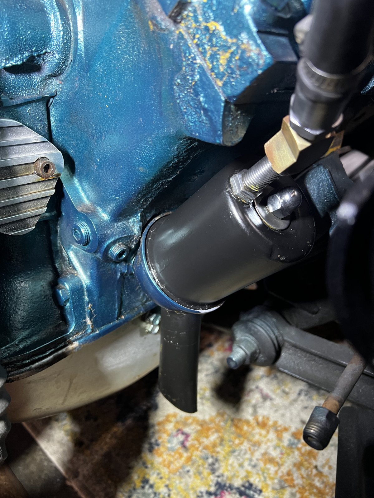

    [QUOTEand someone hose clamped a plastic catch can to the bottom of the road draft tube. It was disgusting. Cracked and leaking. I put a filter in the canister, cleaned the entire system out and repainted a few things. [/QUOTE]
    Did you plug the draft tube?

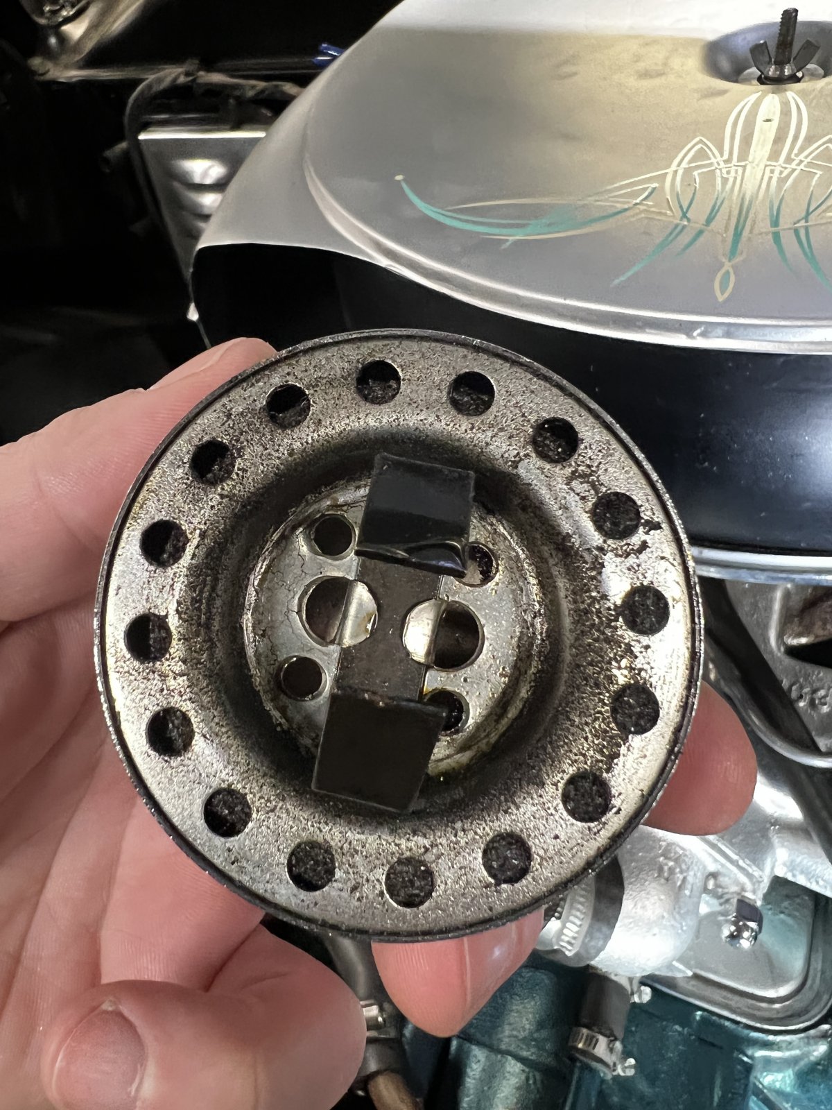

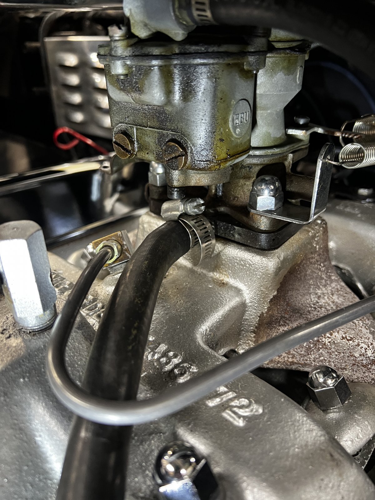

    302CC429-0B2F-46C9-8AE4-74BA53AB67AF.jpeg D9BB1064-24CF-4682-84AF-94B98BF8EE9E.jpeg 88C82B90-5F81-4F8A-B9BF-02D0CE7B0FF1.jpeg 1A9C04F6-59D9-4528-A063-B3F4D372C382.jpeg 78C3B94F-745A-42F3-BEBB-F03DA062FD17.jpeg The road draft tube is still open. I’m now realizing that by having an oil filler breather cap and an open road draft tube that one should be closed right? My current setup.
    -Oil filler cap is a breather
    -Carb baseplate has hose going down to the road draft canister filter with an inline PCV valve
    -Road draft tube is still open

    With the pc valve plug the road draft tube . You want the pcv pulling air through the engine. With out filter the pcv could pull air and dirt into the engine

    In order for the PCV system to be effective, you need to close off the road draft tube.
