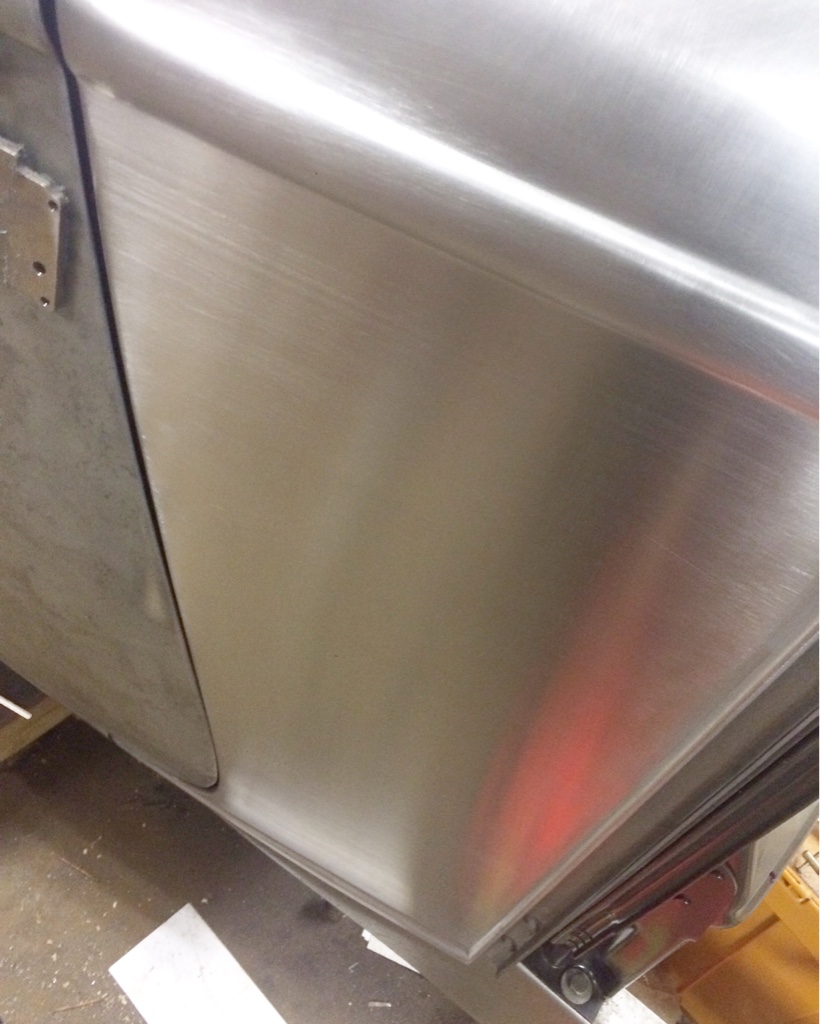

  30. Flop
    Joined: Jun 8, 2006
    Posts: 3,885
    Flop
    I don't use it much for paint removal more for finishing but have used both machines and the Eastwood machine is far superior . I get about 2 cars out of a scotchbrite drum . Eastwoods scotchbrite is also way better then the compe***ors .
    biggeorge, patmanta, rod1 and 5 others like this.
