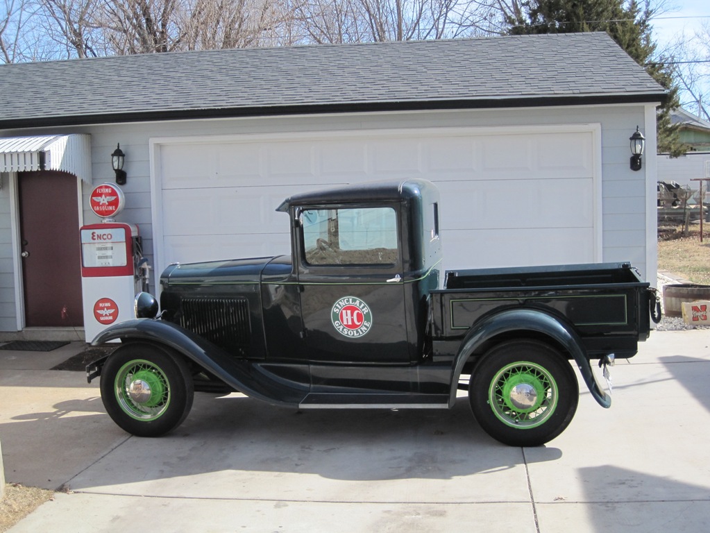

    I've driven this one thru 3 states. Original engine, high compression head, hi performance cam, fully synchronised 3 spd with overdrive, hydraulic brakes

    I have a daily driver 30 pickup with a banger, started out with a stock motor, Winfield head, Mallory dist, Ansen and a Holley 94, knocked the rods out of it, built a B motor with the same spped equipment, knocked the rods out of it twice, finally pit in an H&H inserted motor. Still a 50-55 mph truck, 60-65 with an overdrive. My avatar is a 28 with a V8 60, sold it had no low end torque, I'm now building a 30 Sport Coupe with a 8BA flathead. I wouldn't build a banger for long distance.

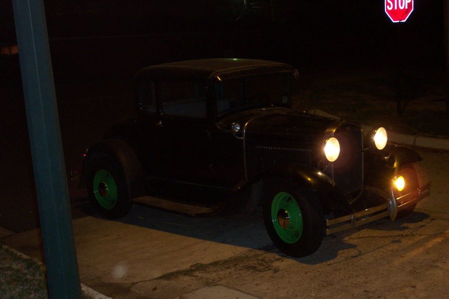

  13. i am about to drive my banger on the highway tomorrow....ala hunnert car pileup
    yes it will be at night...when know one is around
    and i'll be doing 57 mph
    tk
