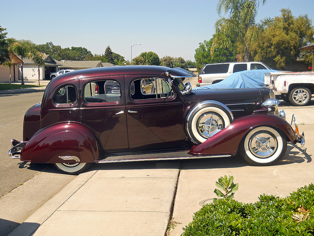

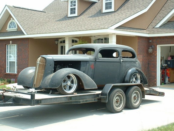

    Frame 1st, here is a picture of one just clean and lowered and one with a chopped top on a 2 door

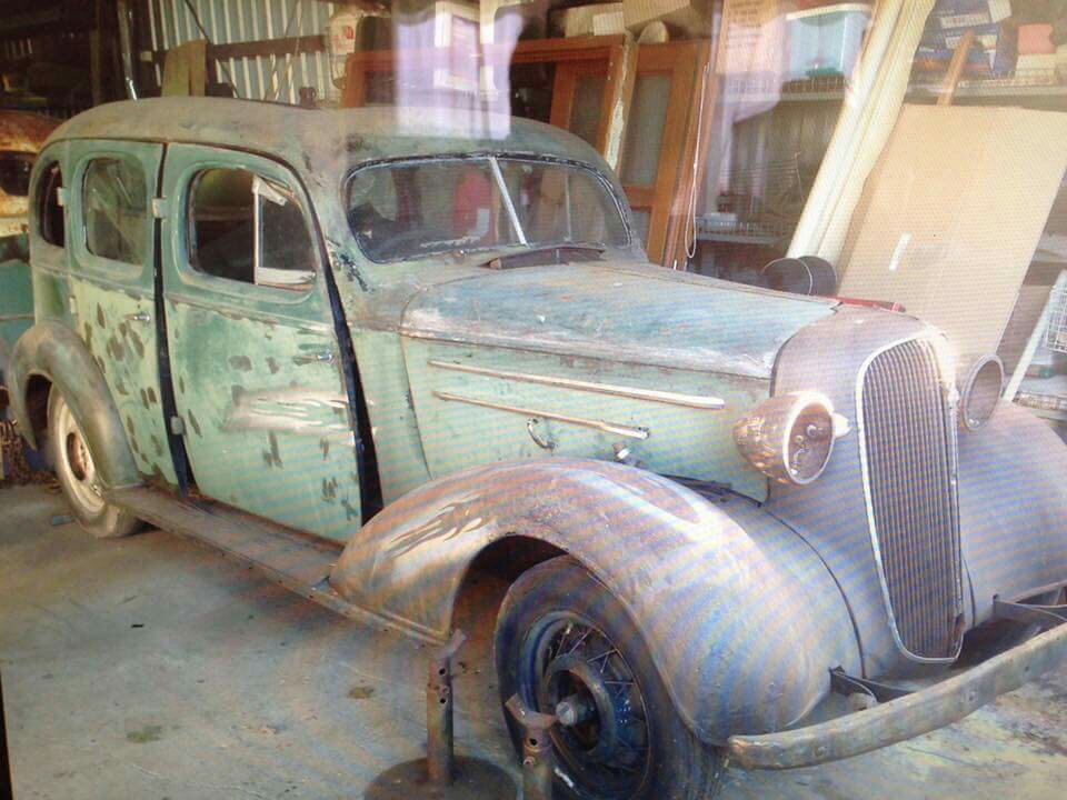

    Started stripping the body down to lift off the chassis

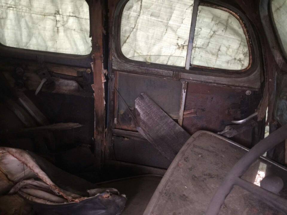

  13. you should rebuild all the body supports and get it square ON the chassis. the car should be sitting square, on four even tires or jack stands.
    don't rip all the wood out if it is good. hard to tell from here but the wood around the door windows looks fine. replacing/repairing/bracing the wood might be easier than making steel replacements.

    some thing doesn't jive . those are 35 doors .either the radiator shell has been changed or the doors have been changed , I suspect the shell .
  15. Back a few posts, from the OP:
  16. Simon Intrudor
    Joined: Aug 7, 2014
    Posts: 19
    Simon Intrudor
    Aussie made body on chev chassis
    Tripped me out aswell
    Sent from my SM-N9005 using H.A.M.B. mobile app

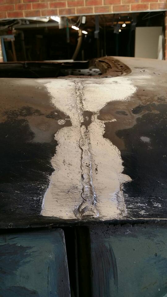

    Removed all the body lead and she aint pretty...
