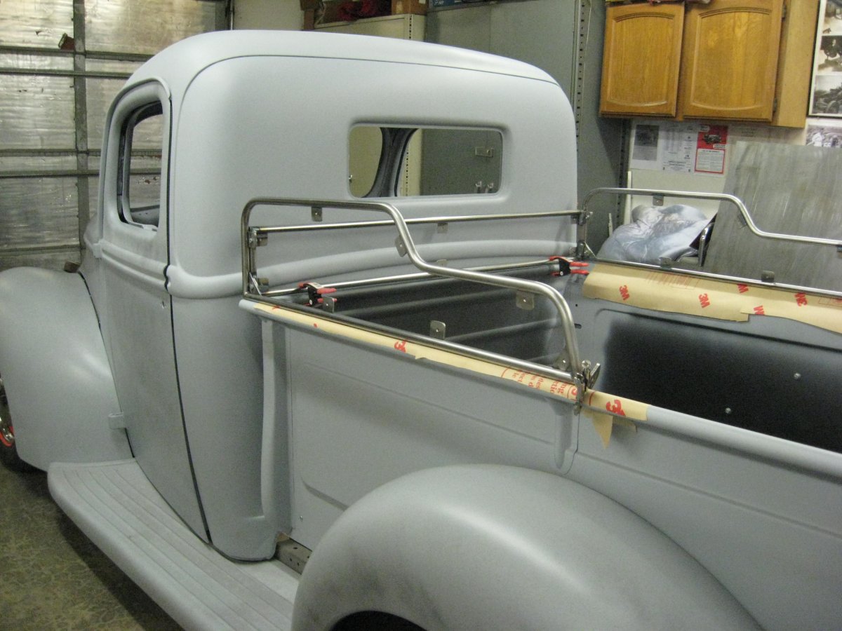

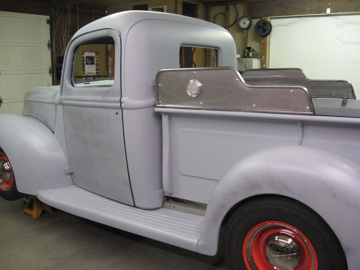

  11. Marty Strode
    Joined: Apr 28, 2011
    Posts: 9,703
    Marty Strode

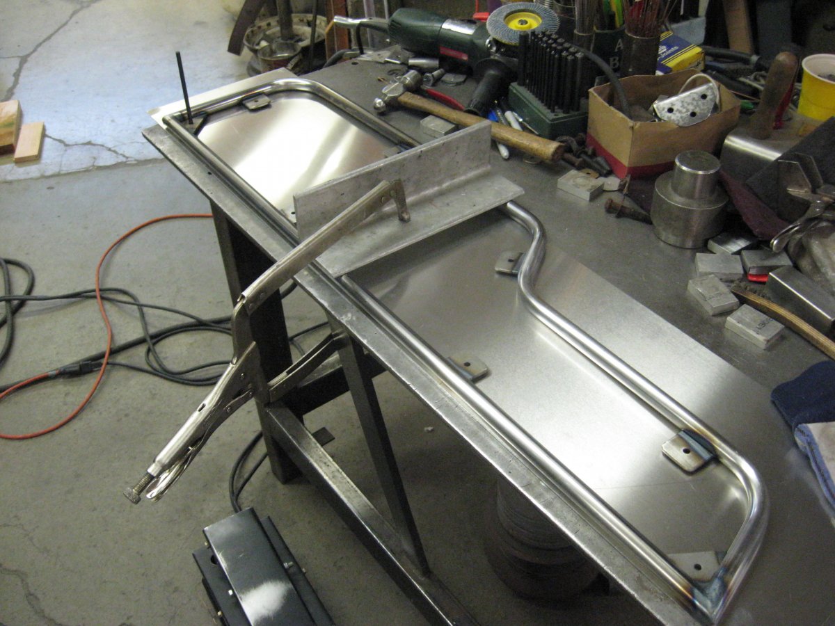

  13. exterminator
    Joined: Apr 21, 2006
    Posts: 1,695
    exterminator
    Did you make those side boards? I like them.
  14. Marty Strode
    Posts: 9,703
    Marty Strode
    Yes, here are some construction shots along with the finished product. The tube frames are 3/4 X .065 steel, and the panels are .063 aluminum that has been clear anodized . IMG_5070.JPG IMG_5132.JPG IMG_0506.JPG
