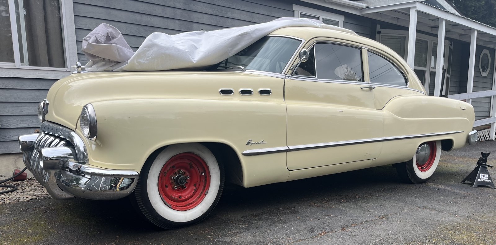

    Well I picked up another project. Like I really needed it. 1950 Buick Special Sedanette. Car is in great shape. Original straight 8 with three on the tree. I’m in the process of rebuilding the engine last shop really screwed it up. I already picked up a factory dual carb/dual exhaust manifold. Took .050 off the block and head to get the compression up a little. I installed 2.5 drop coils on the front with a disc brake conversion. I have a set of 3” drop coils on the way for the rear. I picked up a rearend from a 55 super so I’m going to use the center section with 3.58 gears and the larger brakes on the rear. Plans are to just make it a clean mild custom.

  3. CG, something strange about your car! Front fender script does indeed say Special.. But the one piece windshield says Super.
    Neat car, but then I MAY be biased.

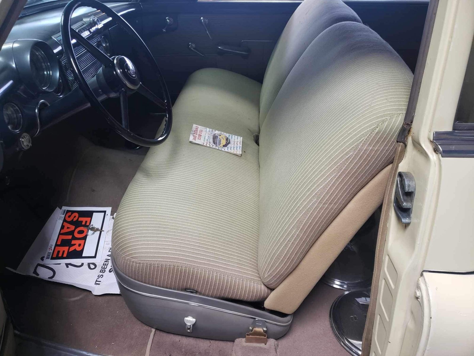

  13. BJR
    Joined: Mar 11, 2005
    Posts: 12,071
    BJR

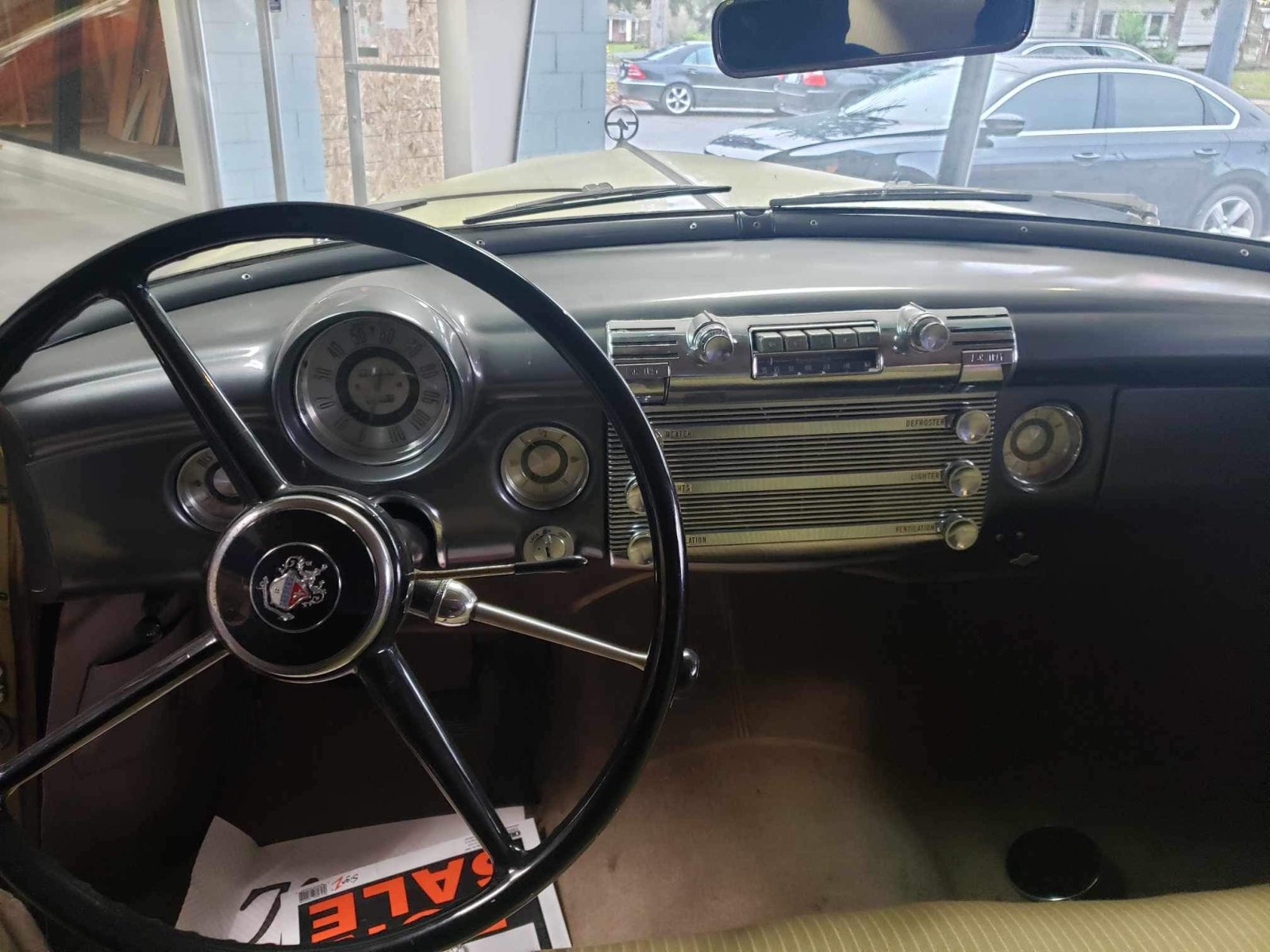

    If you look at the inside picture, the center trim clip has a cutout for the division trim for the 2 piece windshield. So the windshield has been changed. Good eye.
    Welcome to the Buick club. Beautiful car.

  15. A couple more pictures would be great. Drivers side engine and the Fisher body data plate.

  17. Looks like a 46S with a 56S windshield. I had a Super with a broken Dynaflo. The compound carb unit off a '41?. does it have hood release cables or the key slot inside the ports on the hood?.
    The straight 8 is torquey.......don't forget to post the build process.
  18. Fat47
    Joined: Nov 10, 2007
    Posts: 1,632
    Fat47
    Good eye BJR. Yes, it looks like someone replaced the windshield with one piec gl***. Much like you could do with early 50's chevys with an Olds windshield.

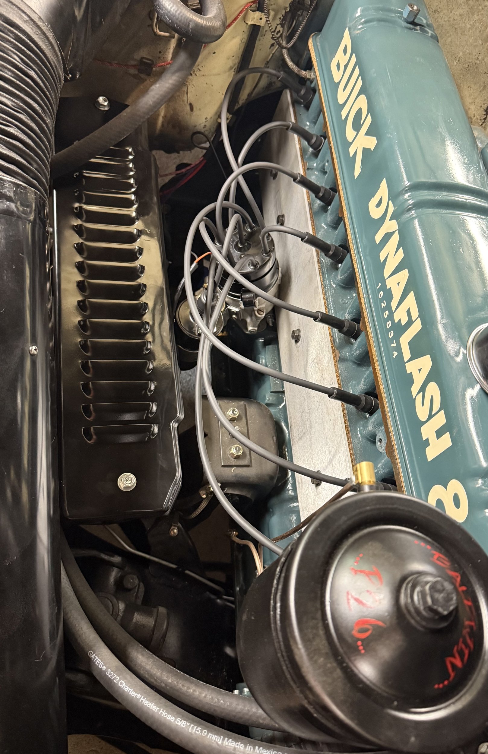

  22. Acres
    Joined: Dec 19, 2021
    Posts: 1,752
    Acres
    from Sweden
    Dual carbs NICE!!
    Is that an older intake from the 40s?
    Dig the whole car, 2door lowered jetback, any more plans?

  24. CGkidd
    Joined: Mar 2, 2002
    Posts: 2,930
    CGkidd
    Not really anything major just plan on it being a cruiser. My 46 Chevy is more of a custom.

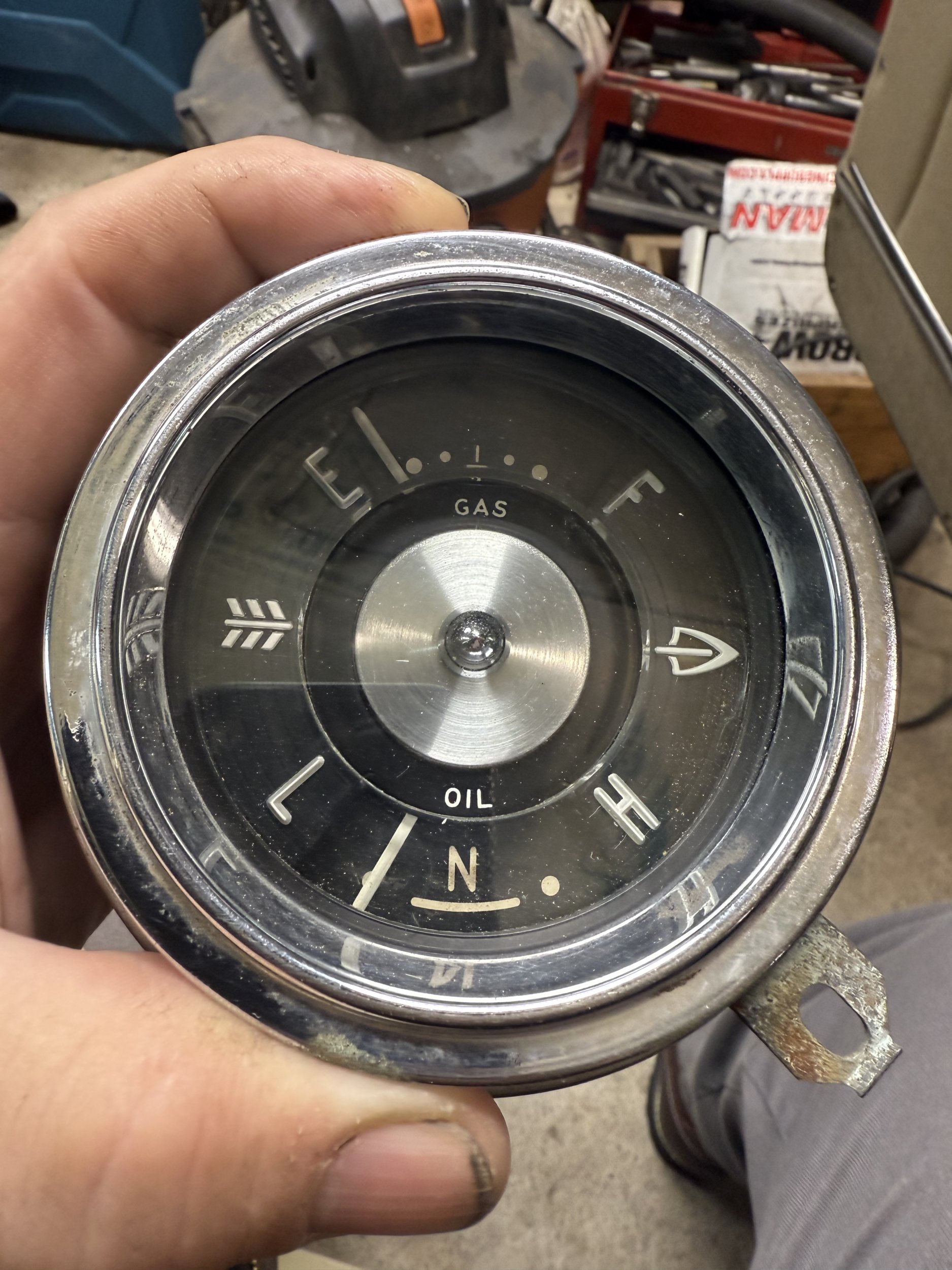

  28. CGkidd
    Joined: Mar 2, 2002
    Posts: 2,930
    CGkidd
    Anyone know what year and model this from? I’m looking for the matching water temperature and amp gauge cluster. Any help is appreciated.
  29. '51-'52 Buick and I believe '53 Buick Skylark
  30. Fat47
    Posts: 1,632
    Fat47
    loldtimer may be correct. The guage design looks the same as the one in my 49 Sedanette with the exception of the all black back ground. The 49 has the 3/4" circular ring in silver. It is 3 3/8" wide. So, probably the size and design is the same with a minimal change in background color. So, if you can't find the single guage you are looking for you could switch out both it and the temp/amp one from a buick of this era.
