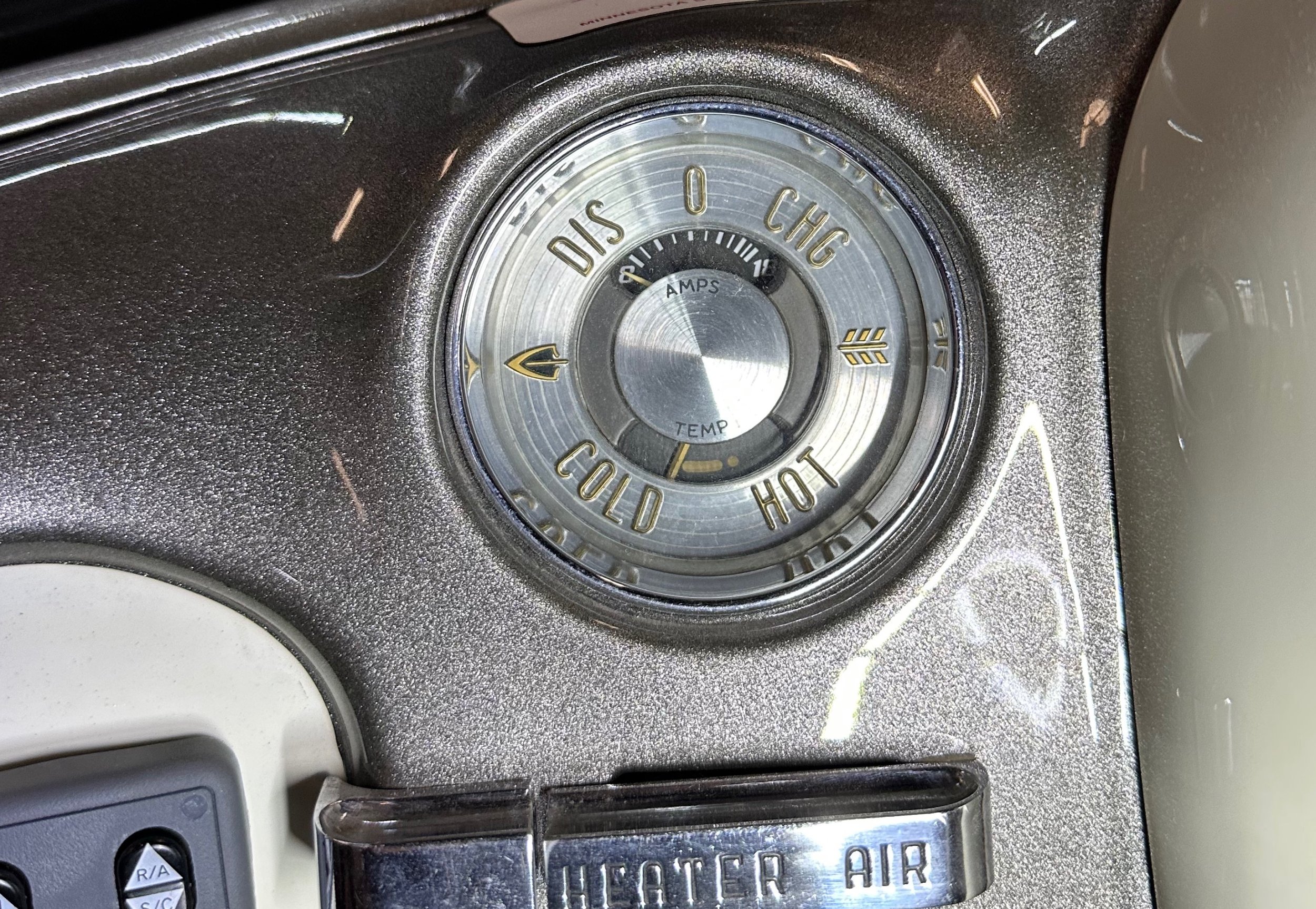

    I agree with Fat47, here is a picture of my 49 Super gauge. I mounted a volt meter behind the stock face where the Amp gauge should be. Zero is 12 volts, anything to the right is more so I know it's charging. Buick volt gauge.jpeg
