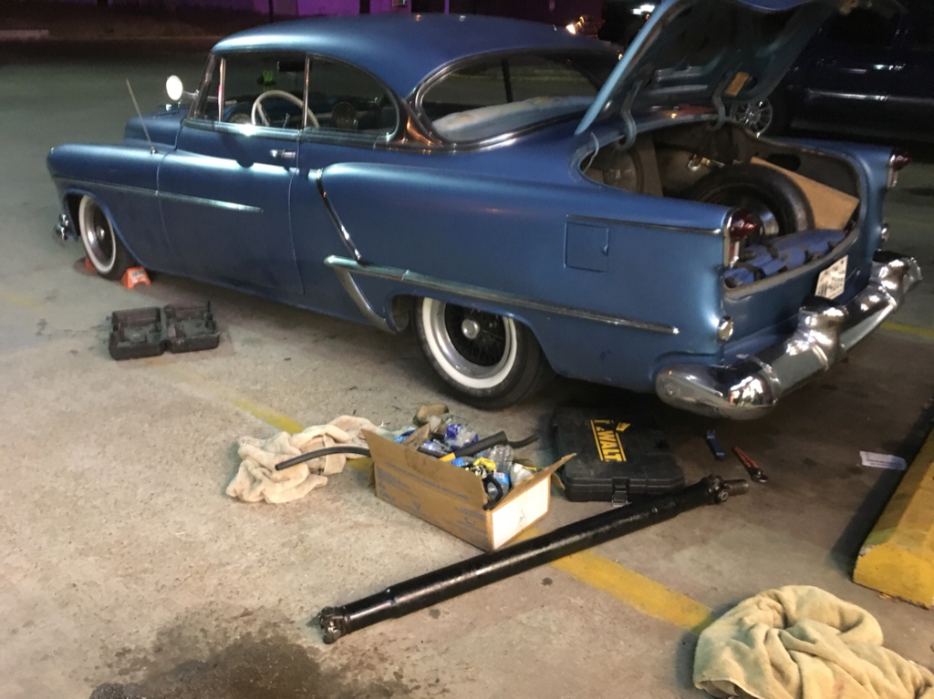

    That’s my best guess for now. I haven’t gotten it apart yet. Would the yoke have to
    Be replaced or can it be machined?
    Also, another possible point of screw up. This is the ujoint I purchased last time, and the same one I have coming to me again. What are the pieces I have circled? I ***umed they were shims, but I didn’t see a useful place for them to go.

    I’ve got a theory and some questions:
    Check out this zoom in (still haven’t had time to get under the car, just looking at pictures).
    The top left bolt likes like that may be where it started to break. Could I have just tightened it too much and cracked it there? I’m not sure what the torque should be on it. I may have been over eager to tighten it because I ruined the last joint by losing a bolt.
    Also, if you look at the top right, there’s a thin metal bar that connects the two ****erfly ends. Is that bar supposed to be cut off after the driveshaft is connected? I left it on.
    If it turns out my yoke is bent, can those be machined down or do I have to replace it?

    Well **** again.
    I love this Olds, but it may be time to find a new daily since this is breaking weekly.
    The u joint did in fact take out the yoke. There’s no telling where I’ll find a replacement.
    This is what I get for pre registering for Pistons & Paint. There’s no way I’ll find replacement parts in time.
    Oh well. Time to start hitting up parts stores.

    I ordered a new u joint a week ago, the company sent me an oil seal. Huge help. NOT.
    I ordered new bushing from Summit. They sent me the wrong ones. Another huge help. NOT.
    Decided to drive out to Summit because I can’t wait on shipping. They’re supposed to have the bushings and Ujoint. Well, they had the bushings, not the joint. I get home to replace the bushings and I cross thread a nut. Awesome.
    Driveline shop says my yoke is no longer available and no one else has it either. On the bright side, they said it wasn’t THAT bad...
    I finally figure out why the ujoint blew up. ****er’s catalog says it should come with medium duty end caps, but it came with light duty instead, so that’s why they broke.
    I call up ****er, they don’t sell one with medium duty caps anymore, they won’t warranty the u joint, and they won’t sell me just the caps. Screw those guys.
    So now, I’m hoping my spare unjoint shows up in time. Fortunately, I kept the old medium duty ends, so I’ll throw those on instead. I still have to try and repair my yoke and hope for the best.
    Looks like I need to start shopping for a new rear end. Anyone have any recommendations on what cars to pull one from?

    Unless you are beating the tar out of the driveline, what you had should have held up. Something was amiss there, incompatible parts or something else. Maybe a new rear and 'shaft is a good option, unless you can find a yoke at a salvage yard. Do you know for sure what the existing rear is from?

    I keep thinking the same thing, but the way it broke also makes it look as though it was too weak. I also keep coming back to the fact that there was no shudder until I bottomed out a few days prior to it breaking.
    I was told it’s a 52 Olds rear. I haven’t confirmed that.

    If it started to shudder after bottoming out then failed a few days later i would make sure there is no binding of the driveline when the suspension cycles. I don't remember whats in the car for an engine and transmission,
    possibly the driveline is bottoming int he transmission causing the problems at the back?

    Good lord. What a friggin week.
    *in my best dramatic announcer voice*
    “Last time on Scott’s-Car-Is-A-POS!”
    Anyway, Wednesday ended with me finding out my spare u joint I had ordered was coming to me in the mail as the wrong thing again. The company I ordered from had changed stock numbers, so several of their orders had been messed up. I called up Summit and there way way they could get me the right u joint before Friday evening. By the end of Wednesday I had given up. There was no way I’d make the car show.
    I got a call from the driveline shop Thursday morning. It went something like this:
    “Hey Scott, we’ve got your driveshaft balanced and ready. Want us to put in a u joint too?”
    “Wait, you told me you didn’t have one for it?”
    “Yeah, we didn’t the other day. We got one in yesterday.”
    “Holy ****, yes please! Throw that thing in there!”
    I picked it up, went straight home, and spent the evening putting the car back together. The test drive was sorta on the way to work the next morning... not smart, but successful nonetheless.
    I didn’t highway test drive it till this morning on my way to Denton from Waco. And I’ll be damned, the car made it. I’m at the show now. The car didn’t have any issues on the way here.
    Something could still go wrong on the way home, but that’s what AAA is for!
