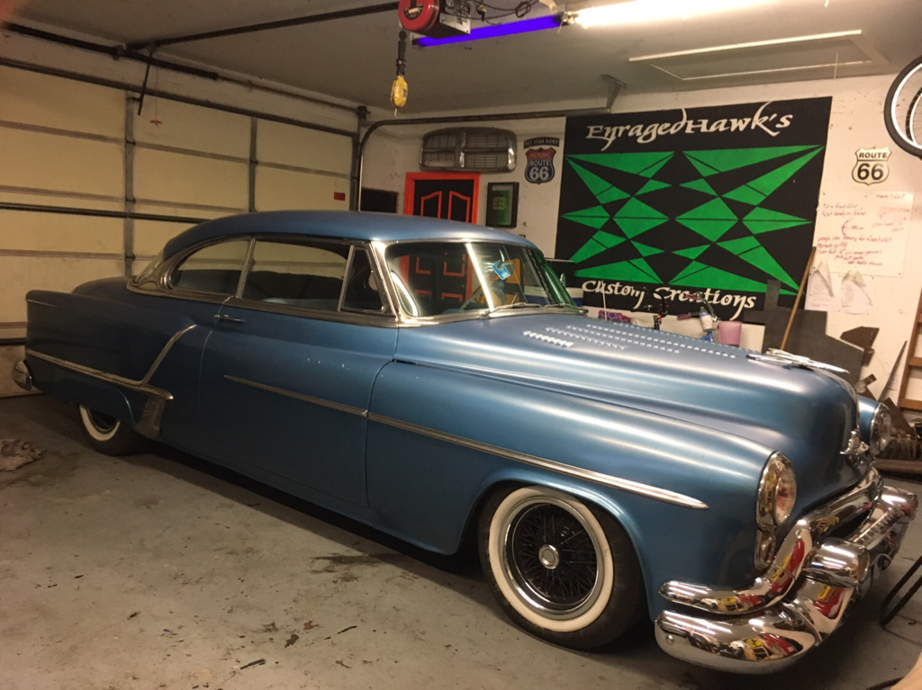

    Wow! Just got the car back from alignment. I couldn’t be happier with how it rides, and now it’s straight as an arrow.
    I had to try a few different shops. Several said my car was too low and they couldn’t get it on the rack. Ha!
    Next will likely be new tires. Time to start pricing them. I still need to plan out what to go about the rear springs (replace the springs or swap the bushings).
    Anyway, because I hate posts without pictures, here’s a picture from a local car show last week.
    Oh, and a mildly funny story. When I started the car up, an alarm chirped next to me. I tried to tell myself to be mature (yeah, didn’t work). I revved the **** out of mine and got a nice pop from the exhaust. I left the car beside me behind with the alarm blaring.
    I’ll grow up someday.
