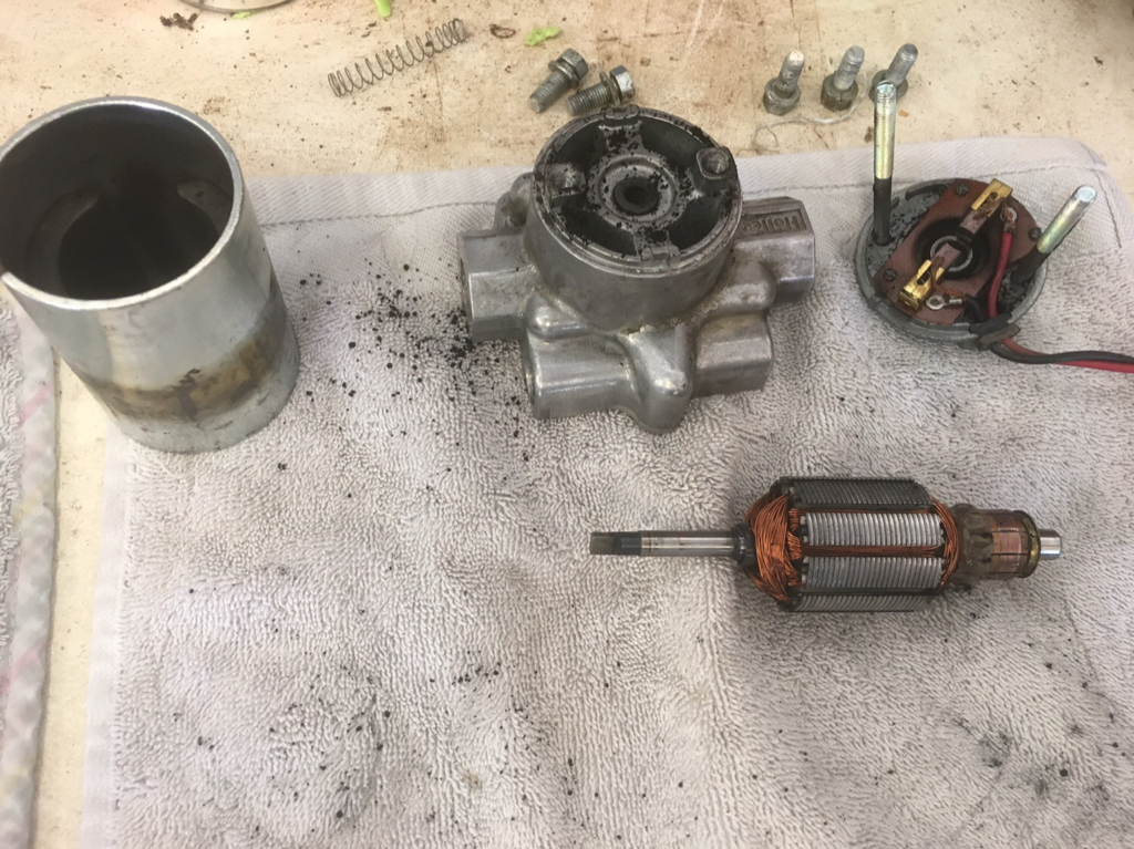

    Ok ok ok... more answers keeps meaning more questions.
    Called Holley this morning. Described everything going on to them, and they agreed the pump seemed like a likely culprit.
    I went through the whole thing tonight, and even the motor itself.
    The top end was loose and there was a bunch of **** inside the motor. I cleaned everything up, put it back together, and still had the same g*d d**n f***ing problem.
    *ahem*
    Anyway. The motor at least ran more quietly after I was done.
    Still thinking it could be the motor, I borrowed one from a friend and hooked it up. Still continuing the same problem.
    It has GOT to be something in the tank (again). But I’ve been pretty confident in every solution I’ve some up with so far. Haven’t had a winner yet. I’m stressing a little just because LSRU is coming up fast. It’s a big deal to me to make it.
    Going to drop the tank tomorrow after work. I’ll keep you guys posted.

    Couple thoughts…..the pump looked pretty messed up for being relatively new. I see a filter at the tank in the pic. Has that been there since the pump was installed? Is there another up at the carb? When you replaced the rubber fuel line did you use hose that is designed for our new wonderful ethanol blends? What did the debris look like that you found in the filter, black particles or rusty junk? And lastly tell us how you wired that pump in and to what tie point, what gauge wire etc.:D
  19. EnragedHawk
    Joined: Jun 17, 2009
    Posts: 1,256
    EnragedHawk
    from Waco, TX
    I called Holley a second time when I took the pump apart because it was so gross. I told them about all the junk on the motor side, and the tech didn’t seem surprised at all.
    The filter before the pump was not always there, which is why I though I killed the pump. It didn’t get added in till about 4 or 5 months in. I cleaned the pump screen at that time too. There is also one at the carb. Holley recommends 40 micron before the pump and 100 after.
    The fuel lines are basic rubbers I got from Summit. I ***umed everything made now was for ethanol pump blends. Maybe I’m wrong. The **** in the filter was rusty looking.
    I ran my wiring setup by Holley as well, no complaints from them. I even had a volt meter at the pump while the pressure was all over the place, voltage was constant. I’m running a relay up front with roughly 16/18 gauge wire to the back.
    Here’s my current thought process: There either has to be **** in the tank I can’t see or a break in the line between the pump and tank I can’t see. Here’s what I ordered last night:[​IMG]
    I’m going to add a screen to the pickup tube and replace the line from the tank to the pump. Even when I drained the tank into gas cans, I could hear the pump struggling. Maybe something moved when I dropped it from the car.

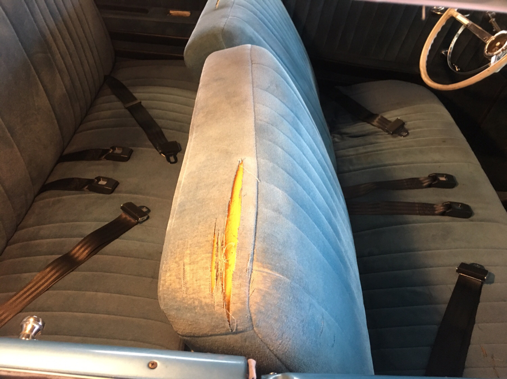

    I decided to drop to carb off for a rebuild. Should have it back in a few days. Really hoping that’s the final issue. I’ve already decided that it’s LSRU or bust. I’ll slap the car back together and go for it. Worst case scenario, AAA will get us back home and then we can go in a boring car.
    Anyway, while I’m waiting, I installed the seatbelts I got from Summit. My car is now 100% safer. It’s got belts AND it doesn’t run. Haha
    Soooo.... I don’t believe I’ve mentioned it in this thread at all, but the Olds does have a name. My wife suggest Baloo when we got it, and I loved it. It’s the only car I’ve ever named and genuinely used the name. I mention this because I’m super excited about what I ordered for the ****ons on the seatbelts...
    They’ll be in next week. I’ll post a picture once I’ve got them on.
