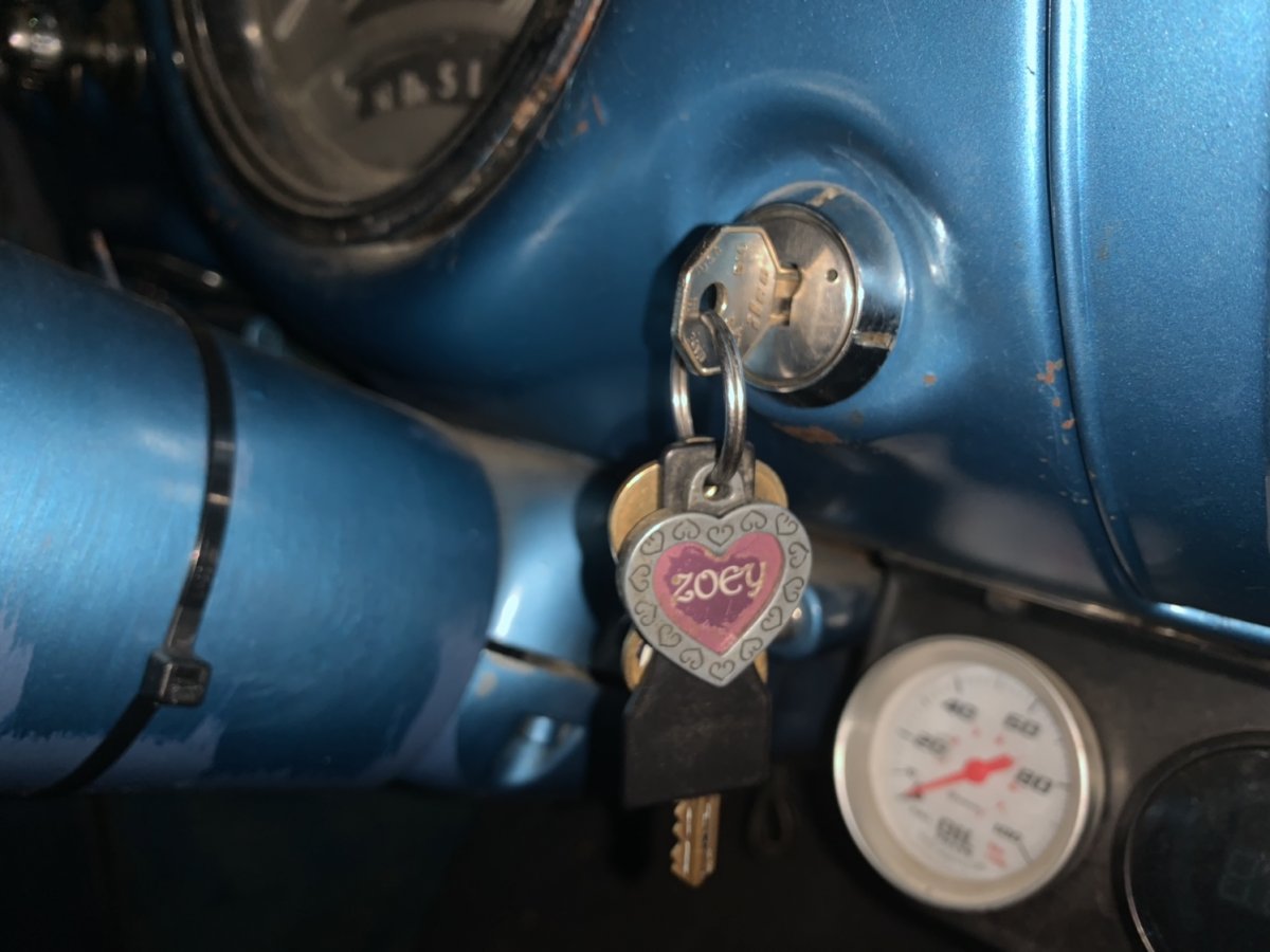

    We lost our Zoey 2 years ago. Hardest thing I had to go through in a long time. VERY sorry for your loss.
