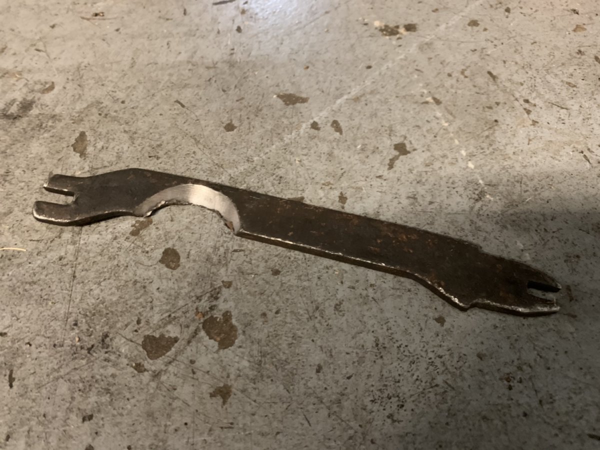

    Soooo, I messed up somewhere. Not sure how, but I did.
    Driving through town last night and I lost my rear brakes. Fortunately the front work great, just gave me a mild heart attack.
    I just pulled the drums off and found this on the p***enger side:
    It’s the parking brake link. The spring was also chewed up and spit out. I’m having a hard time finding what I need online, so on to my questions
    Could I either:
    A, just find a close enough match a junk yard (and just get to to match both sides)
    Or
    B, if another won’t work, would it be a just awful idea to bend it back, cut out the bad section, and weld in a patch?
    Thanks as always.

  8. Dick Stevens
    Joined: Aug 7, 2012
    Posts: 4,126
    Dick Stevens
    I would go with option B, I don't see where it is bent, so I would make a circular patch to fit the space ground out of it and clamp it down and weld it in and make sure that it is straight after repair.
    Hombre, chryslerfan55 and EnragedHawk like this.
  9. EnragedHawk
    Joined: Jun 17, 2009
    Posts: 1,256
    EnragedHawk
    from Waco, TX
    Decided to go for cut and weld. Figured I have nothing to lose.
    Still gotta dig up a new spring.
    Since I’ve got the brakes all apart, I might as well ask. That’s gotta be why I lost the rear brakes, right? Pedal almost hit the floor.
