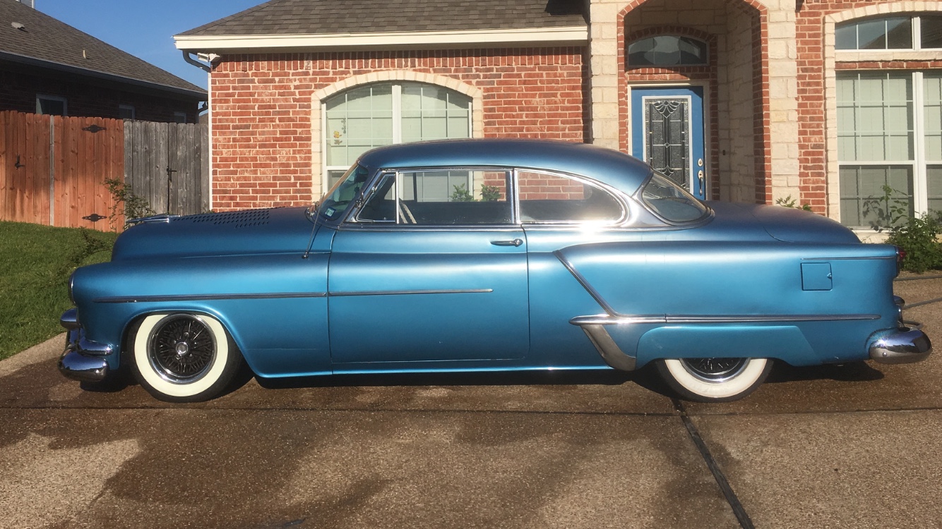

    I vote strip the rears also. Not that you asked.
  2. Lone Star Mopar
    Joined: Nov 2, 2005
    Posts: 4,197
    Lone Star Mopar
    My opinion is not equal to your labor but there is no doubt the chrome looks way better.

  8. EnragedHawk
    Joined: Jun 17, 2009
    Posts: 1,256
    EnragedHawk
    from Waco, TX
    Really happy with how the wheels came out!
    Thanks for all the input!

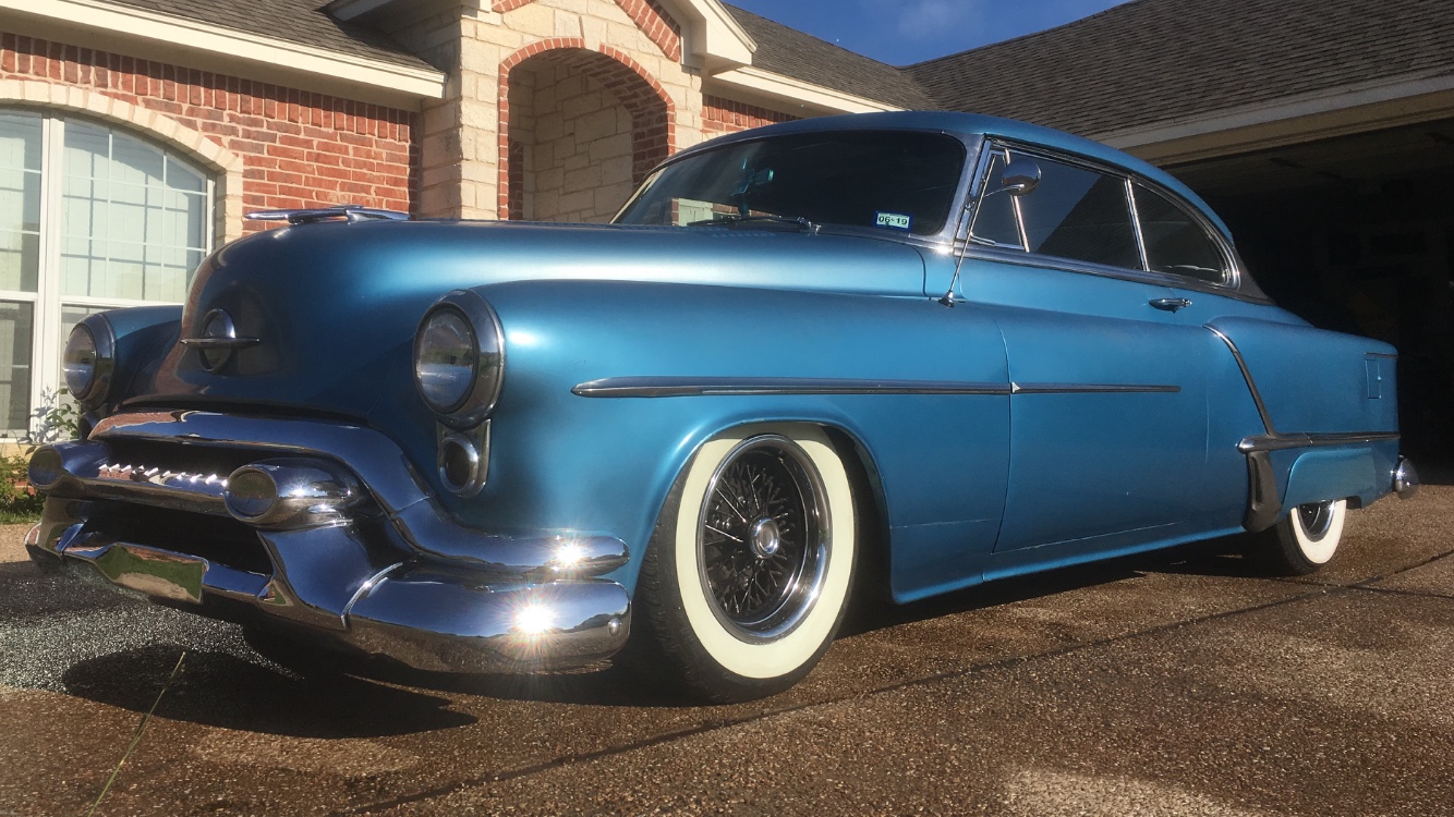

    Those shiny wires really changed The look of the car!!!! They and the car look great!!!!!

    Picture mostly because I hate a pictureless post. I included my latest project. Picked up a 54 Chevy dirt cheap. Haven’t gotten far on it clearly.
    Anyway, not exactly a problem, but it’s getting to me.
    For anyone that kept up with this thread, remember my solution to the car overheating? A big ass fixed blade fan. Works amazing.
    But holy hell its loud. It’s ok in town, but the highway is a nightmare. I’ve managed to ignore it strictly because it works so well.
    I’ve tried putting in an electric fan, but it still gives me overheating issues. If there’s a shroud, it blocks off too much air and overheats on the highway. If there’s no shroud, it overheats in town.
    I’ve considered a few options, but unsure on any of them.
    1) switch to a flex fan? I don’t know how much that would curb the noise.
    2) switch to a fixed blade fan with a clutch? I’m not exactly sure if that would work the way I’m thinking.
    3) buy a quality high CFM electric fan. I don’t mind this option, but I would hate to drop a lot of money on a fan that doesn’t improve my situation. I already have two that don’t do the job.
