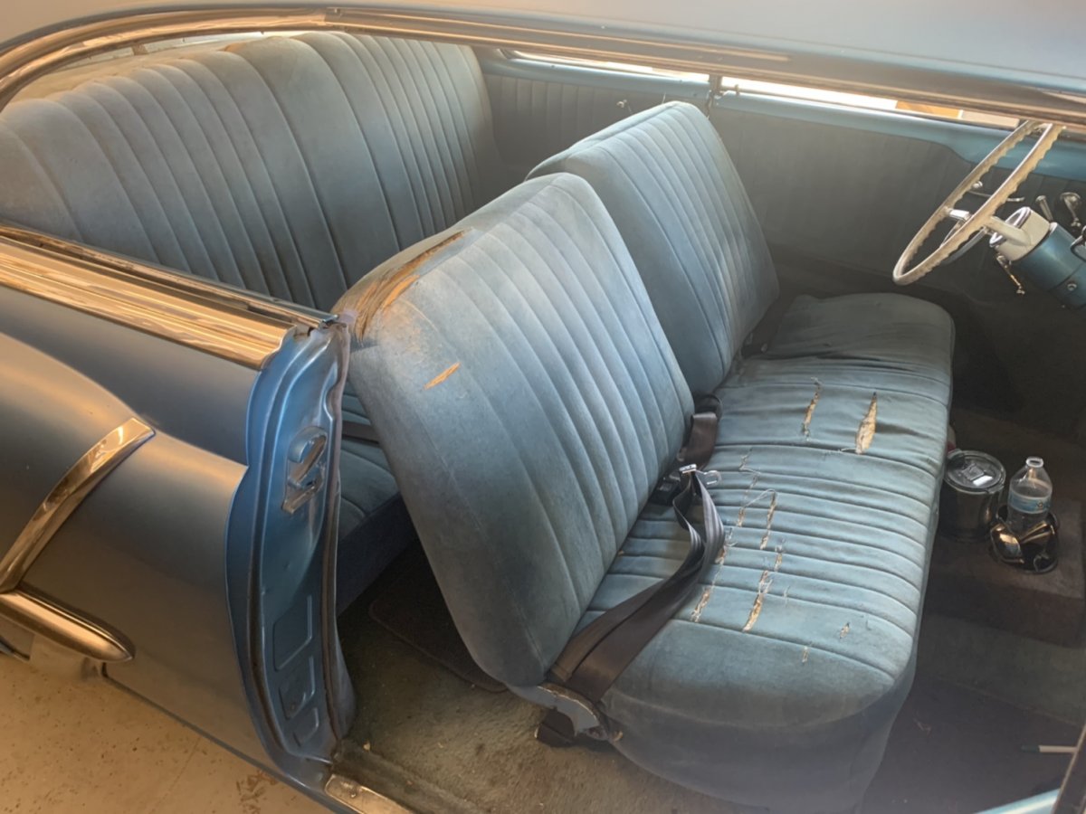

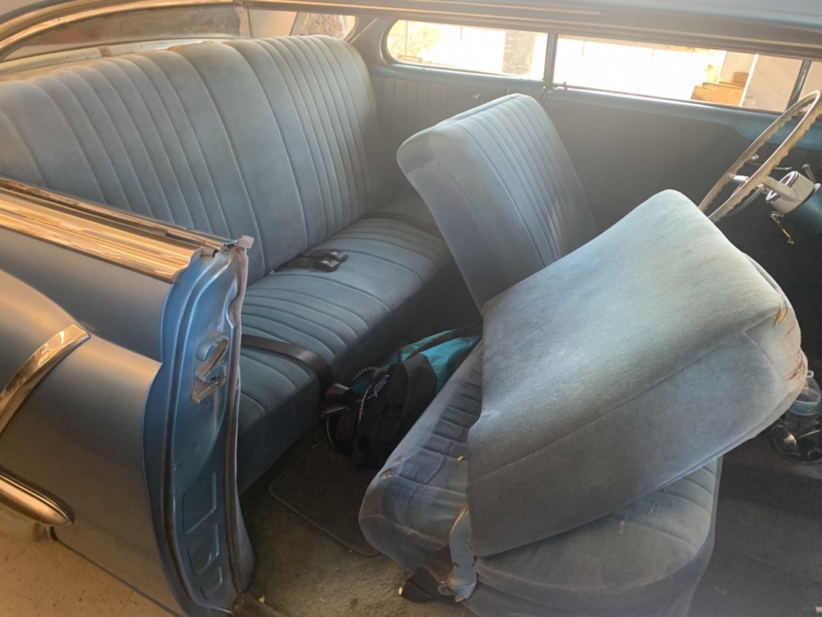

    Hey all, had an interior question. I thought about starting a new thread for it, but I’ll try here first. First two pics are just for fun.
    I ended up selling off the Cadillac seats. The fronts couldn’t tilt forward enough. Being a two door and having kids, I really need easy access to the back. On the bright side, I sold them for more than I paid, so that’s cool.
    I want to keep my original seats, but I can’t afford to have someone do a custom interior. I keep eyeing ****py seat covers, but I don’t like them.
    Now I have been looking at interior kits like this:
    That’s something I can afford to do. Even if not all at once. Something Olds specific is a little hard to come by. Anyone know a car that would match up well enough to what I have? I thought maybe a bench seat wouldn’t be too difficult to match, but I don’t want to jump into it without a little research.
    Here’s a better shot of my interior:

    Call me crazy but I don't think the seats you have are too bad. They look good in the car.
    I've had basic *** white press pleat covers in my 57 ford for almost 20 years and they still look more than presentable. When in doubt, you can't go wrong with white tuck and roll if you can't get something specific. And don't listen to guys saying it's hard to keep clean. It cleans right up with a little bleach white or soft scrub and magic eraser.

    100_5860.JPG Blue with white inserts or white with blue inserts would look good in that car,something like how this seat is done up.

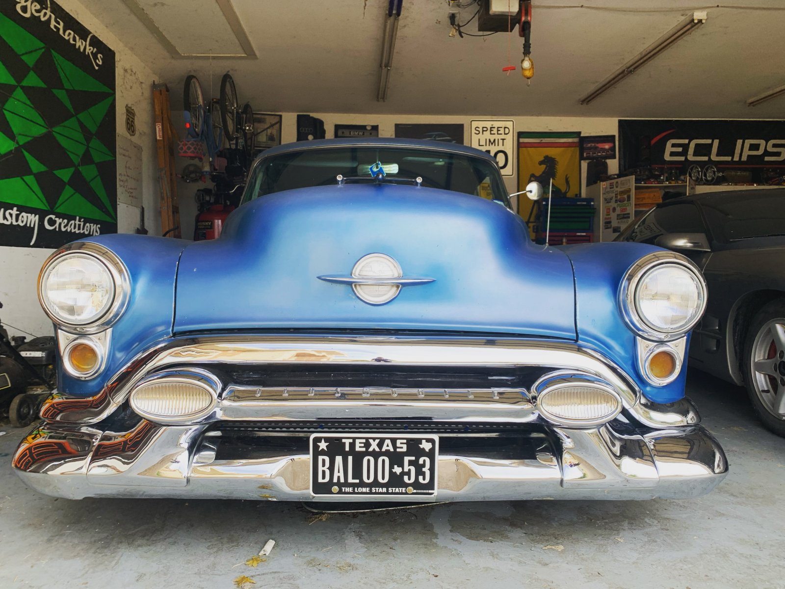

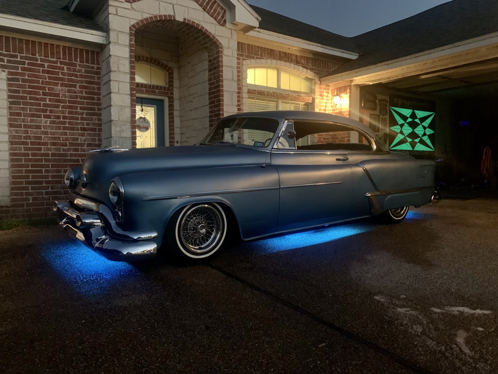

    I know most of you guys will hate these, but I added some lights. Only showing off the one picture. They’re lame, but I like them.
    Still being used as a daily driver as well. Also have kids and dogs in my car. It’s always a fun experience. B1FAA23A-6444-4FD3-B230-3E6C65D6E840.jpeg

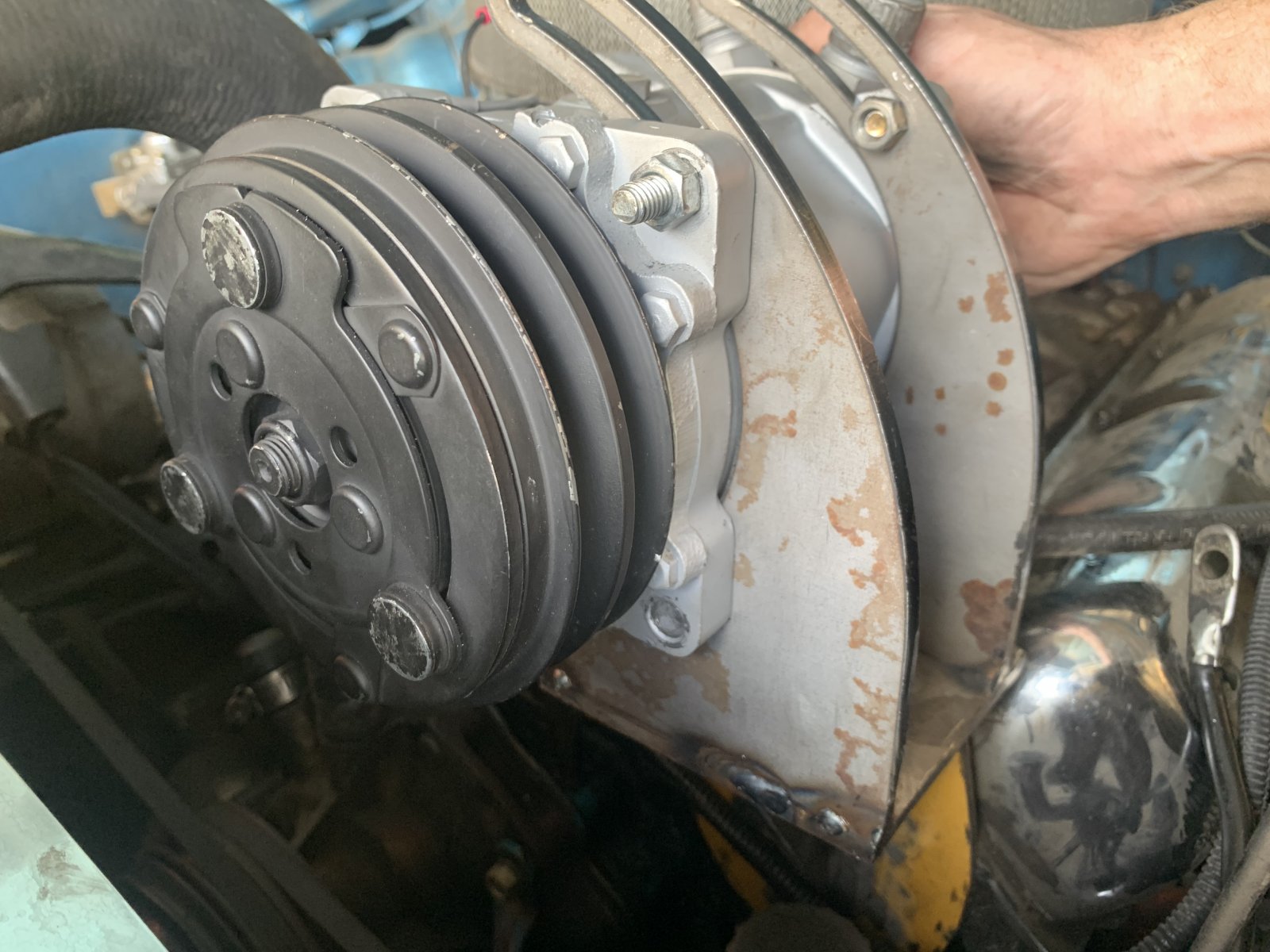

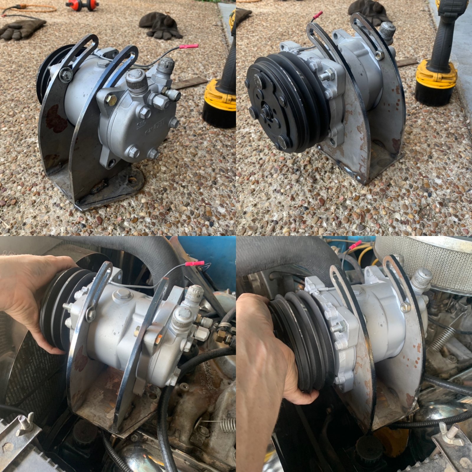

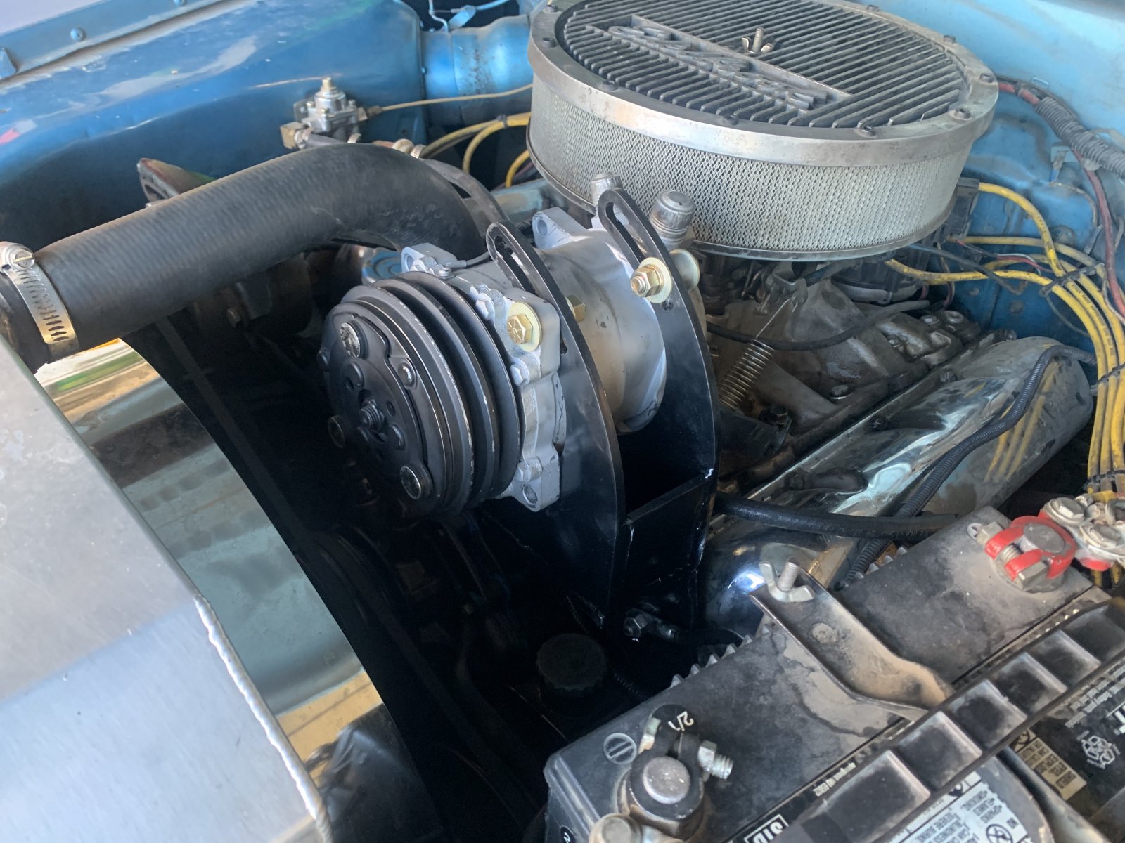

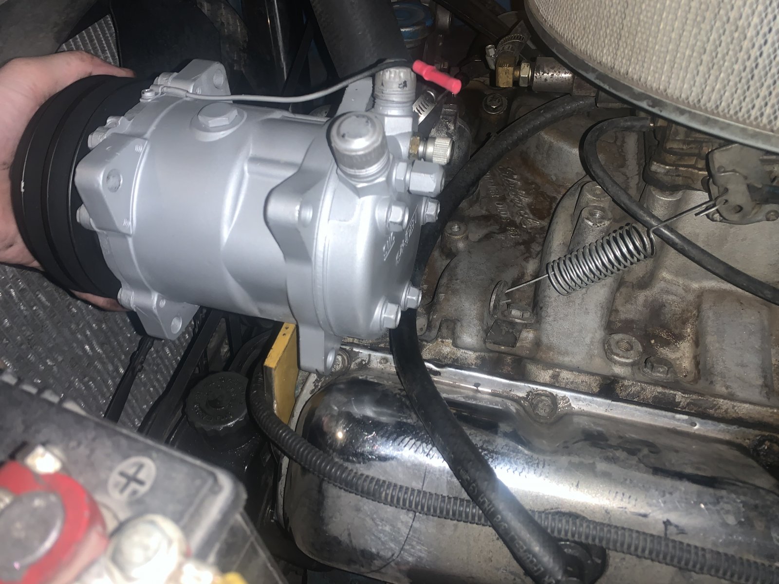

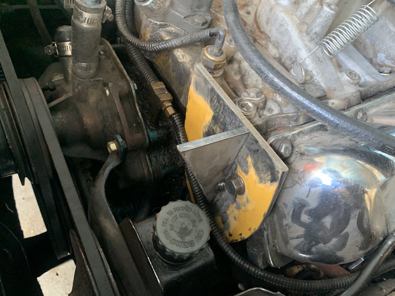

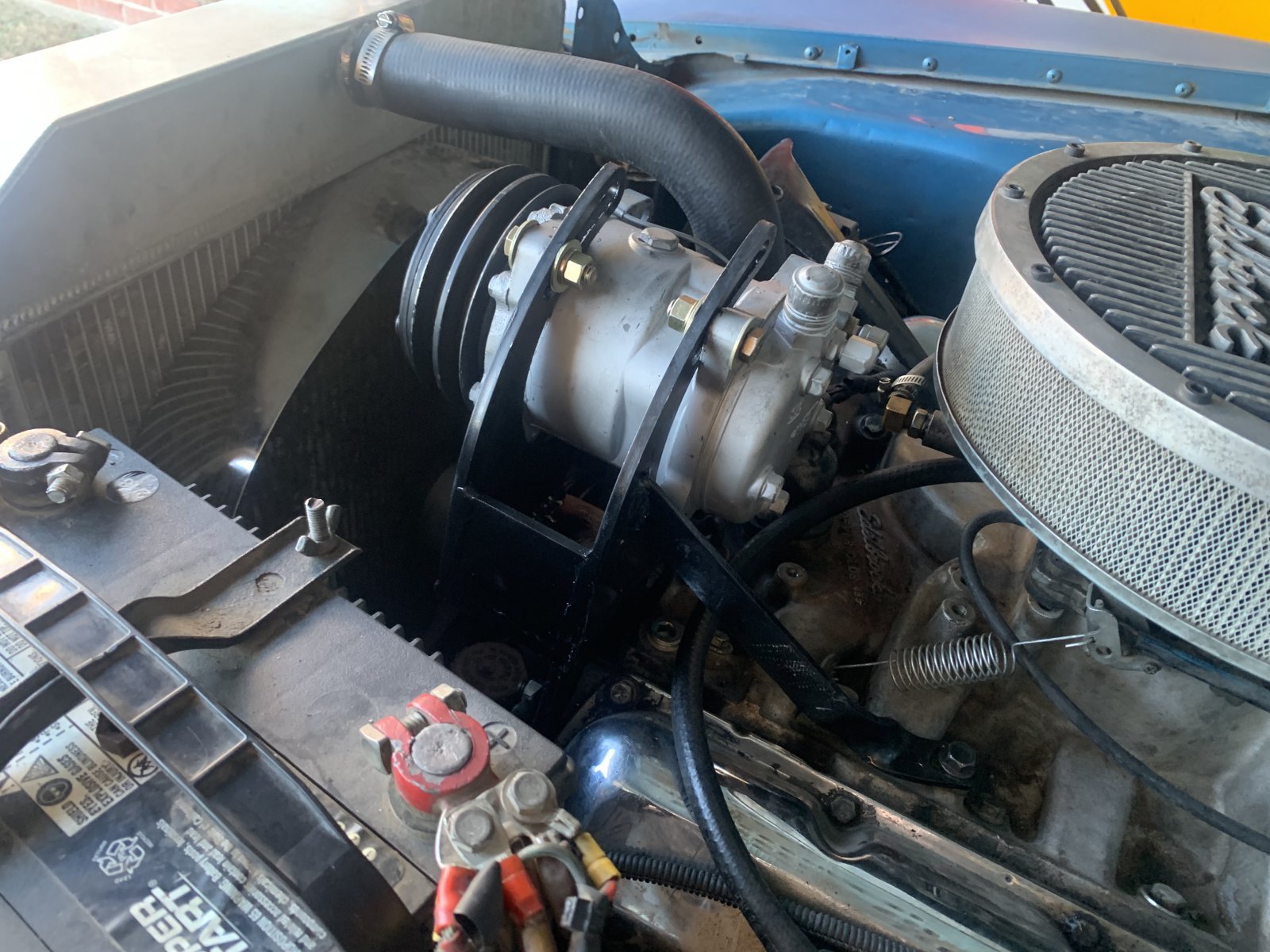

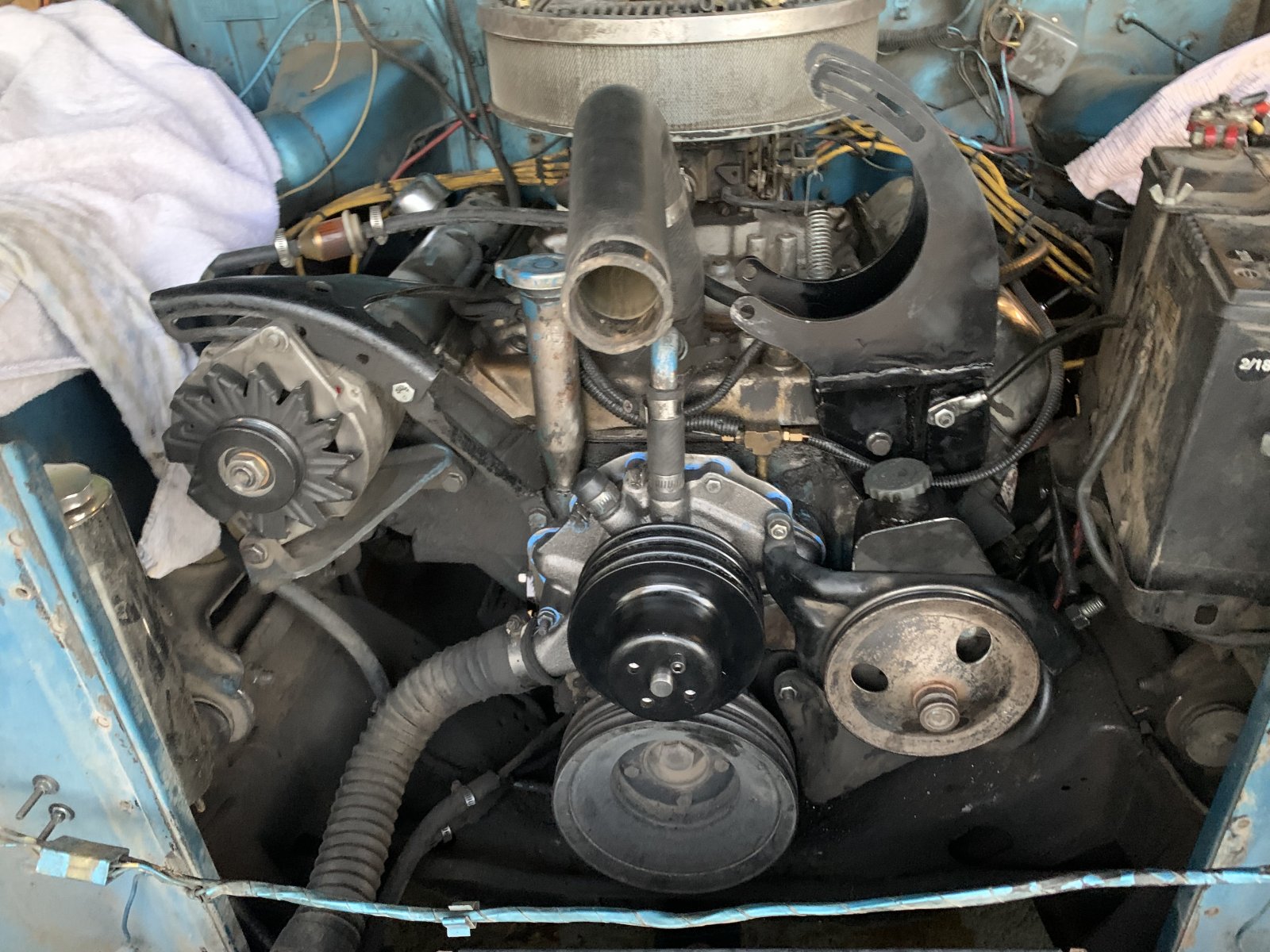

    I’m finally looking into adding AC. Long story short, I decided to make my own AC compressor brackets. I’m pretty proud of them.
    9FBDBB4D-54E6-4FF0-8CB5-079A33EE3549.jpeg 689E975B-E4B6-4BFC-AC9F-FB997127FEB2.jpeg 69350408-F4DB-4FE3-87FA-14A42543906E.jpeg B516AB8C-3372-4477-8508-C4D0C1C397C3.jpeg 2BDFD874-AF2D-4CBA-8D06-DDFD07AFC65C.jpeg 4E39A0A4-AA21-473D-897D-E80653F446E7.jpeg
    While I was at it, I noticed my fan was loose. Turns out the bearing in the water pump had gone bad. And guess what? THATS THE SCREAMING NOISE IVE HEARD GOING DOWN THR ROAD!
    New pump got the fan to shut up. Sounds great going down the road now. I also found the correct pump and pulley to get all three groves to line up properly. Super excited about that.

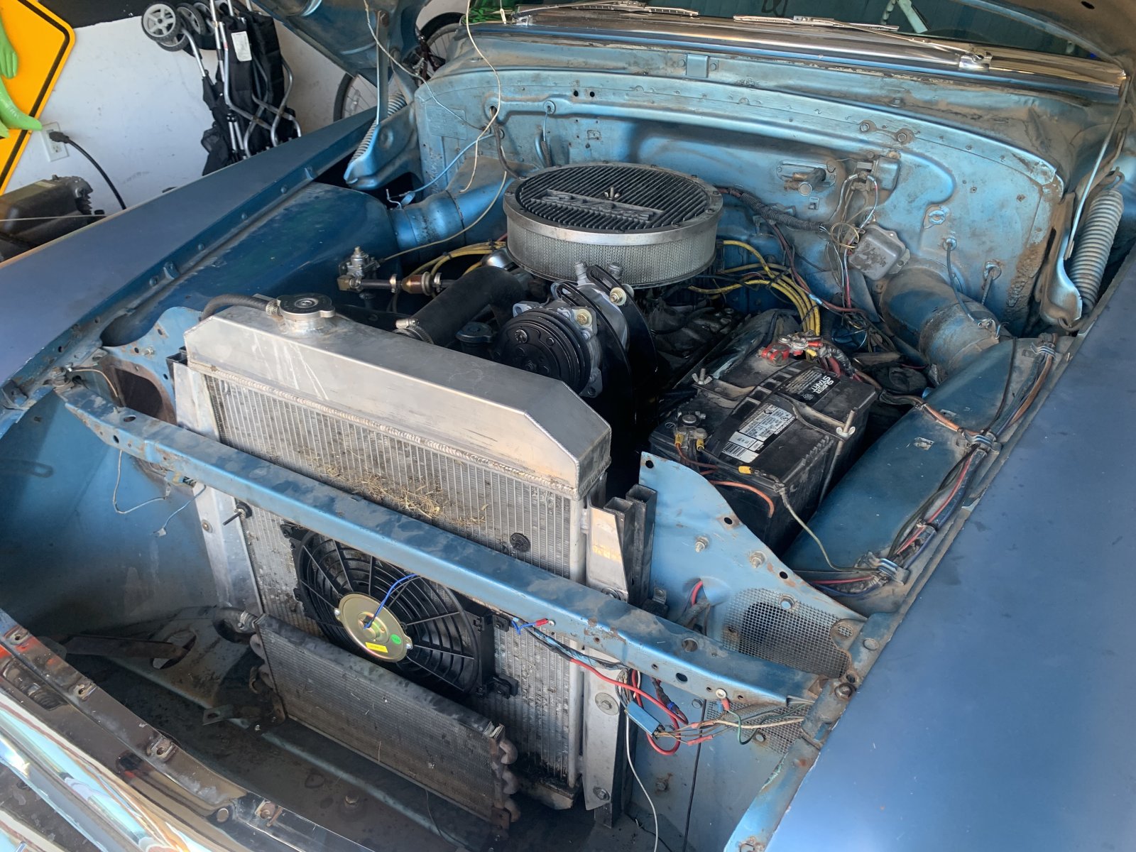

    And finally, I also added an extra electric fan to help keep cool in traffic. Starts creeping up to 210/220 sitting still for too long. Hopefully this will help. Kicks on at 190*.
    0CAEEE66-F7AD-45ED-ADF8-3272E99B1FD8.jpeg A08C6DFB-BC55-4C2E-8271-7E86FA393CDB.jpeg DEB18EEE-98F1-4897-9C7F-C9EB30136742.jpeg
