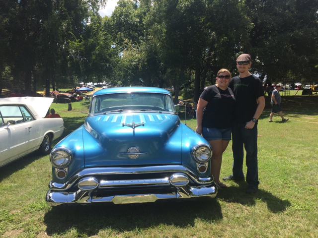

    Hit up my first car show with the olds. It's nice just being able to drive into and out of a show for once. No trailed, no h***le.
    Engine is still bleeding bad. Haven't had time to mess with it yet (school just started back up, I'm a teacher). For now I'm keeping the car within a few miles of home. Hopefully I'll have it fixed up soon.

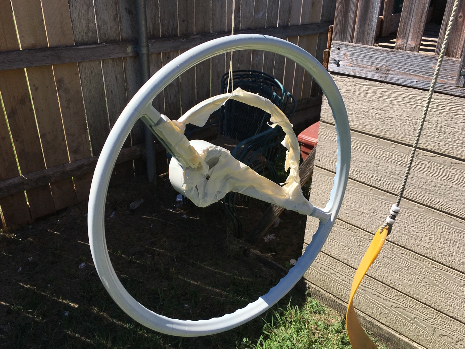

    Anyway, at the round up last year I picked up a new steering wheel. I was just out in the garage trying to swap it over, but nothing fits together because of the telescoping column. I can get it on there, but I can have the horn ****on on it. Are there any particular kits out there for putting old steering wheels on telescoping columns?
    For now I've got it all back together. Hoping to lose the grandma steering wheel before the next car show.

  29. vtwhead
    Joined: Oct 20, 2008
    Posts: 5,305
    vtwhead
    that steering wheel is from a 64 BelAir or Biscayne. Will be a challenge to get it on correctly I am sure
