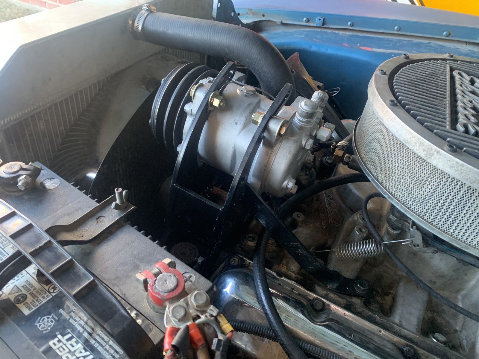

    We'll come back to the A/C in a moment.
    Raise that ON temp to 200°F.
    190°F setpoint the fan is going to be constantly running once the engine is warmed up. Not good for fan life nor is it really going to do any cooling because....
    We'll have to have a talk about that battery terminal*eye twitches*, but first...
    That duct, it does nothing useful.
    It ducts the air around the fan/fan blades, yes. But after the air flow gets past the fan that hot air can now do a 180° turn and superheat the radiator.
    When the air pressure inside the engine bay is higher/hotter than outside, the hot air will leak out wherever it can, including back out through the front of the radiator(reverse flow), which then it will be pulled back in via the fans and reheat the radiator.
    Like two Tasmanian devils on either side of that fan duct, just swirling around.
    A vicious cycle.
    Air will bounce around and go in whichever direction without proper ducting. Need to control that turbulence. Herding cats can be easier.
    Still gotta build that wall,
    Make cooling great again.™
    Adding a simple shroud to cover the radiator, such as
    Along with the fan duct would greatly improve cooling capabilities.
    Move the duct to the outer portion of the shroud to prevent blocking air flow inside the shroud.
    To aid in moving more air through the shroud when the fan is not pulling enough, one way trap doors/flaps can be added.
    Note the six trap doors(check valves) on this Derale ***embly.
    This will provide greater cooling capacity and prevent backflow of hot air through the radiator.
    With the increased cooling capability this will reduce underhood temps and your running hot issues. You will also be able to remove the pusher fan which is costing you more energy(power) that you do not need to be wasting. The cabin will also be cooler as the engine bay will not be overly heat soaked anymore. Which in turn will require less cooling.
    When adding A/C, the improved ducting of the radiator fan will allow for proper cooling of both condenser and the radiator without the need for an electric pusher fan.
    I would not add an A/C system until AFTER the original cooling problems have been resolved
    Adding A/C will just compound the hot running/overheating issue.
    Adding more heat to an already heat soaked system is going to cause more heat related problems, not just hot running issues but electrical issues as the alternator will not charge correctly if it is overheating.
    This will then affect the electrical system including ignition. Which will then have the engine running poorly.
    Need to build that wall(and shrouding, and ducting)

  5. 57JoeFoMoPar
    Joined: Sep 14, 2004
    Posts: 6,500
    57JoeFoMoPar
    I agree with all of this. Pusher fans are 25% less efficient than pullers, and the space in front of the motor on the electric fan is going to create a dead spot in the radiator where little air flows through. The goal you have is to get as much air through the entire core of your radiator as possible. A proper shroud will pull air all over, not just through where the fan happens to be in front of.
    Years ago when I stuffed a big Chrysler wedge in my 57 Ford, I had crazy bad overheating issues. The only thing that fixed the problem was a proper shroud, and a giant 7 blade fan from a Cadillac 500. I, like you, put a pusher fan on the front to try to help the problem. It did virtually nothing.
    You could also have a custom radiator built which would probably help you as well, since it might well have a better core design than what it is you're using. They're not as expensive as you may think. The custom radiator I had made from Superior Radiator in Michigan was under $400 and is super nice.

    Hey Mike!
    Since I replaced the water pump, the engine has been cooling perfectly. It rarely gets above 180/190. I put 350 miles on the car a couple weeks ago going to Pistons and Paint with no issues. I'll definitely keep that shroud style in mind. Once the summer comes back around, idling in traffic may become an issue again.
    The whole AC project is on hold right now anyway. I mostly wanted to get the bracket made. Once I hit my winter break, the plan is to rip out the interior, patch and seal the floors, add some door seals, and do a full rewire of the car with a Painless kit (trust me, that battery terminal bugs the **** out of me). When I get all of that done, then I can justify some more time and money on AC stuff.

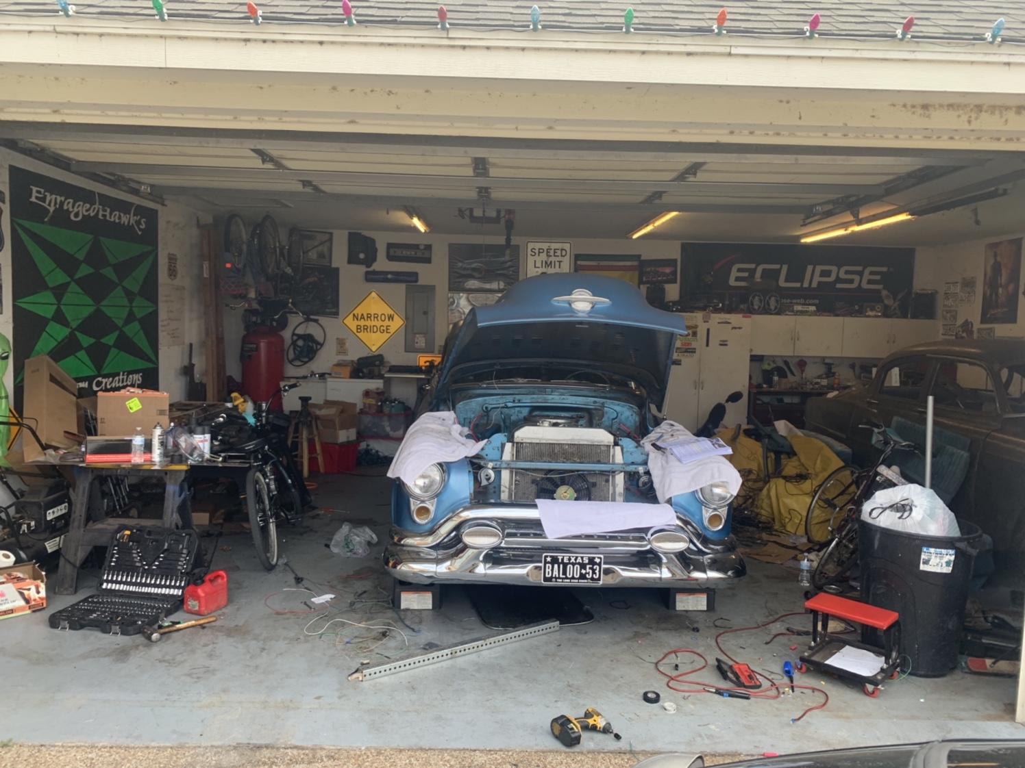

    Well, the time has come. I tore into Baloo today.
    I ripped all the interior out to see what I had going on under the carpet.
    It ended up being worse than I wanted, but better than I expected.
    I spent most of today cleaning everything up to really see what I had to work with.
    I’ll just be using flat plate to patch the floor. I’m not a professional and this isn’t a show car. I’m picking up steel tomorrow. Any recommendations on what gauge? Currently planning to get 12.
    Once the floor is patched up, I’ll use sound deadening on the whole thing. Should be here Wednesday. Once all that is done, I’ll run up to Summit and get a Painless kit.

  8. BJR
    Joined: Mar 11, 2005
    Posts: 11,277
    BJR
    12 gauge is awful thick, might want to get something closer to what was used originally. Like 16 or 18.
    Dave Mc, loudbang and EnragedHawk like this.
  9. EnragedHawk
    Joined: Jun 17, 2009
    Posts: 1,256
    EnragedHawk
    from Waco, TX
    Yeah, after posting I had already changed my mind to 14 or 16. Only reason I want it thicker is because I don’t have a way to roll beads.
  10. 57JoeFoMoPar
    Posts: 6,500
    57JoeFoMoPar
    That's still too thick. 18G is the correct gauge. If you use too thick of steel, you can run into issues welding it in place where the heat you need to penetrate the heavier material liquifies the good floor you're trying to weld it to. Those floors look pretty good for the most part, it's not like you're putting huge patches in where you need to roll beads in the them. If you do get a section that oil cans, a few well placed hits with a ball pein hammer will take care of it.
