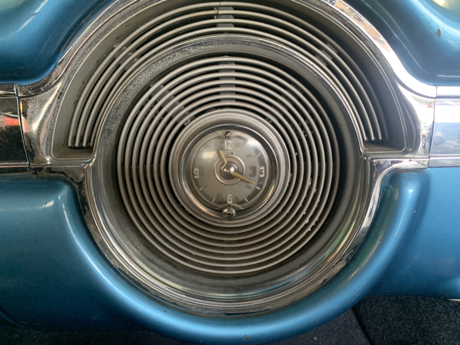

  12. BJR
    Joined: Mar 11, 2005
    Posts: 11,269
    BJR
    Those clocks are not hard to fix. Take the cover off of it and oil all the gears and the pins they spin on. Next file the points. Most quit working because the battery slowly went dead and when the clock tried to rewind there was not enough left in the battery for it to rewind. So the clock points just sat there and burned. I have fixed a bunch of them with these simple to do fixes.
    Hombre and EnragedHawk like this.
  13. EnragedHawk
    Joined: Jun 17, 2009
    Posts: 1,256
    EnragedHawk
    from Waco, TX
    I actually have a second clock in a box of parts… I might give it a shot. What kind of oil do I use?
  14. aussie57wag
    Joined: Jul 13, 2011
    Posts: 673
    aussie57wag
    from australia
    Cool car. Extra cool with the olds motor. You won't have any issues with that that you won't have with a sbc. LS would give different harder to fix issues. Looks good lowered. Air bags I see as a waste of money. Just low is cool. I saw some talk on an overdrive auto. Look into T700. That would be my pick of auto. But muy choice would be old school cool 3 speed column shift with electric overdrive.
  15. vtwhead
    Joined: Oct 20, 2008
    Posts: 5,303
    vtwhead
    my 50 Ford clock didnt work either. Took it out and blew all the dust off then put it in a small container with a cotton swab that was wet with kerosene for a couple days (old farmer trick) and it lubed it up quite well. File the points and it now works. Give it a try. There is info on the web about these clocks and how they were meant to function.
    EnragedHawk likes this.
  16. BJR
    Posts: 11,269
    BJR
    For oil I use sewing machine oil, but any light oil will work.
    ClayMart, bobss396 and EnragedHawk like this.
  17. bobss396
    Joined: Aug 27, 2008
    Posts: 18,732
    bobss396
    Agree on sewing machine oil, or the little tube that comes with hair clippers. I worked with a guy who fixed car clocks on the side years ago. He said most of them just needed to be cleaned and oiled.
    ClayMart and EnragedHawk like this.
  18. EnragedHawk
    Posts: 1,256
    EnragedHawk
    from Waco, TX
  19. bobss396
    Posts: 18,732
    bobss396
    I saw it on IG and commented. Good for you, I knew there was not a lot to fixing them.
  20. EnragedHawk
    Posts: 1,256
    EnragedHawk
    from Waco, TX
    Yeah man! I’m super excited about it.
    So, got another question; I read that the clocks will auto adjust their speed over time as you keep correcting the time. Is that true on this one too?
    I ran both clocks on my work bench all night to see how they did. The one from the car was about 15 minutes behind after 8 hours. The other was 5 minutes behind. I played with the speed adjustment on the back of both before leaving this morning to see where they’re at later.
    bobss396 and Papas32 like this.
  21. EnragedHawk
    Posts: 1,256
    EnragedHawk
    from Waco, TX
    Clock is back in! You’ll never guess what time I took the photo at…
    I ended up switching to the spare clock since it was a little more accurate. Hoping over time the accuracy will improve as I adjust hands.
    It’s dumb, but I am super excited about this thing working. Literally sat in the car about 15 minutes just listening to it tick and rewind.
  22. ClayMart
    Joined: Oct 26, 2007
    Posts: 7,792
    ClayMart
    After cleaning and lubing a clock mechanism like this, especially without doing a complete dis***embly, I'd give them at least several days if not weeks of "run-in"time before worrying too much about their accuracy. As the new oil works its way into the gears and bushings it's also still flushing out some of the old oil and other dirt and debris. During this time I would avoid making any adjustments to the regulation.
    As far as adjusting the time making an improvement in accuracy . . . I doubt that it's a function of the clock's design. But you might end up seeing this coincidentally as a result. Probably more as a result of giving the clock more run-in time to circulate the new lube. And manually moving the clock's hands may further help to circulate the fresh oil.
    I'd guess that moving the hands manually would only work to make the clock maybe run slightly faster, but not to slow it down. This is likely the reason you usually see instructions stating to only move the time forward when adjusting the hands. Backing the time up a few minutes shouldn't hurt anything but you should avoid backing up the time over a span of hours.
    And remember that even when these clocks were running at their best, you could expect to see a variance of plus or minus a few minutes every couple of weeks or months. These are not digital quartz movements. :p
    WalkerMD, bobss396 and EnragedHawk like this.
