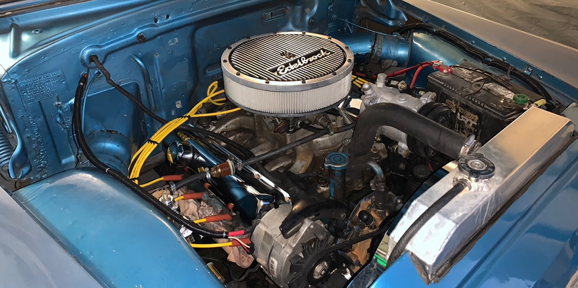

    A new radiator showed up today! Looks great. Got it installed and seems to cool fine. Because it’s not the same exact one I had before, it sits a little closer to the fan, but no objections from me.
    Also, I flushed the systems and switched back to cl***ic green coolant. That’s what champions website recommended.
    As you can see, I added a pusher electric fan. Seems to work great but…
    My alternator hates it. In fact, I think I burned up my alt on my test drive tonight. It’s just a 90 amp, but between the fan, fuel pump, and headlights, I think I pushed it too far. Smells funny too.
    Already checked the fan direction. It’s good. So I may just put a kill switch on the fan for night driving and see how that goes.
    bobss396 and AndersF like this.
    To help keep the alternator undercooked there are a few things you may want to look into.
    The main BAT cable does not need to go through the firewall. You want it as short as possible.
    Have that go directly to the battery (+) terminal. DC has a faster voltage drop over short distances. Eyeballing it that BAT wire is ~'8 long. No need for that.
    Having the 'Sense' wire long and going to where the main bus is located is fine, this will tell the alternator if it needs to kick up the charging output to keep the system, as a whole, up to snuff.
    With such a long BAT cable there is the added unnecessary voltage drop added to the system.
    At idle or cruise during the day it may not seem it's taxing the alternator, which is compensating, however this can already be pushing the alternator towards its max charge limit.
    When the loads pile on(***ulatively) at night with lights, tunes, accessories turned on the alternator is now at max output.
    Alternators are not designed to be at max output for long term.
    To be safe an alternator that is about 150% max output than what your current system already needs will be what you want.
    100A alternator with 90A system draw is just going to discharge the battery and then tax the alternator.
    Alternators are not designed to power the electrical system directly.
    Alternators are to recharge the battery.
    Battery powers the electrical system.
    Think of your toilet.
    Battery is the upper tank.
    Bowl is the system demands.
    Fill valve is the alternator.
    When its time to flush, tank is full and, for most of the time, flushing the toilet will do its job. Since no other loads the light trickle of the fill valve is fine for normal operation.
    However, after a night of Taco Bell, you may need to flush a few times to clear the load.
    If you just stand there holding the valve open your only going to have a small trickle of water come out of the valve and drain into the bowl, which will do no useful work.
    Same thing when using an undersized alternator. Initially it may be fine but the larger load will demand more work than the alternator can supply. It will just trickle and eventually drain the battery.
    Heat is also a problem.
    If the new rad and WP has fixed the cooling issues then it may not be too bad but you will still want the alternator to stay as cool as possible.
    When it comes to wire, the hotter it becomes the more resistance it will have(another reason to keep it short as possible). This includes the windings(wire) inside the alternator. If it becomes overheated a 90A alternator will perform as a 60A while still trying to maintain system voltage. Not good.
    The back of the alternator is where the air intake is, the fan is an exhaust.
    If the air at the back of the alternator is excessively hot(chrome valve covers reflect heat) you may want to look into adding some ducting(5" dryer hose) to the back of the alternator to pull fresh outside air in.
    Your alternator, I am not even sure what model it is supposed to be.
    Front looks like 10Si but the rear has 12SI cooling vents.
    There was a 17si used in ~'85/'86 before the switch to CS130.
    Stock replacements are
    17Si 108A (only output AFAIK) good for ~70A draw
    12Si 94A (highest output) Good for ~60A draw
    10Si 63A (highest output) good for ~40A draw
    (To feed a 90A draw you would use a 140A alternator.)
    If you get some variant of these alternators, without a dyno sheet, you are at the mercy of the manufacture/re manufacture of what you may get.
    I would trust AC Delco/Remy for rebuilds/new stock output units.
    If you need more power but a stock look then Powermaster is probably your alternative, otherwise going to a CS130/140 unit may be your next move.
    [/whinge]
