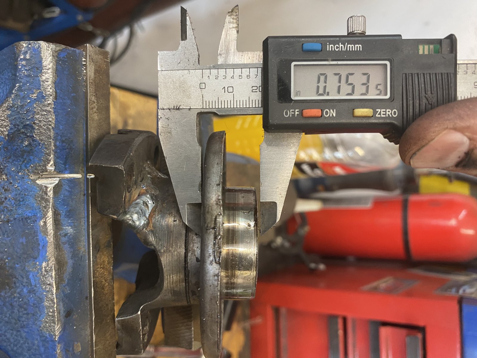

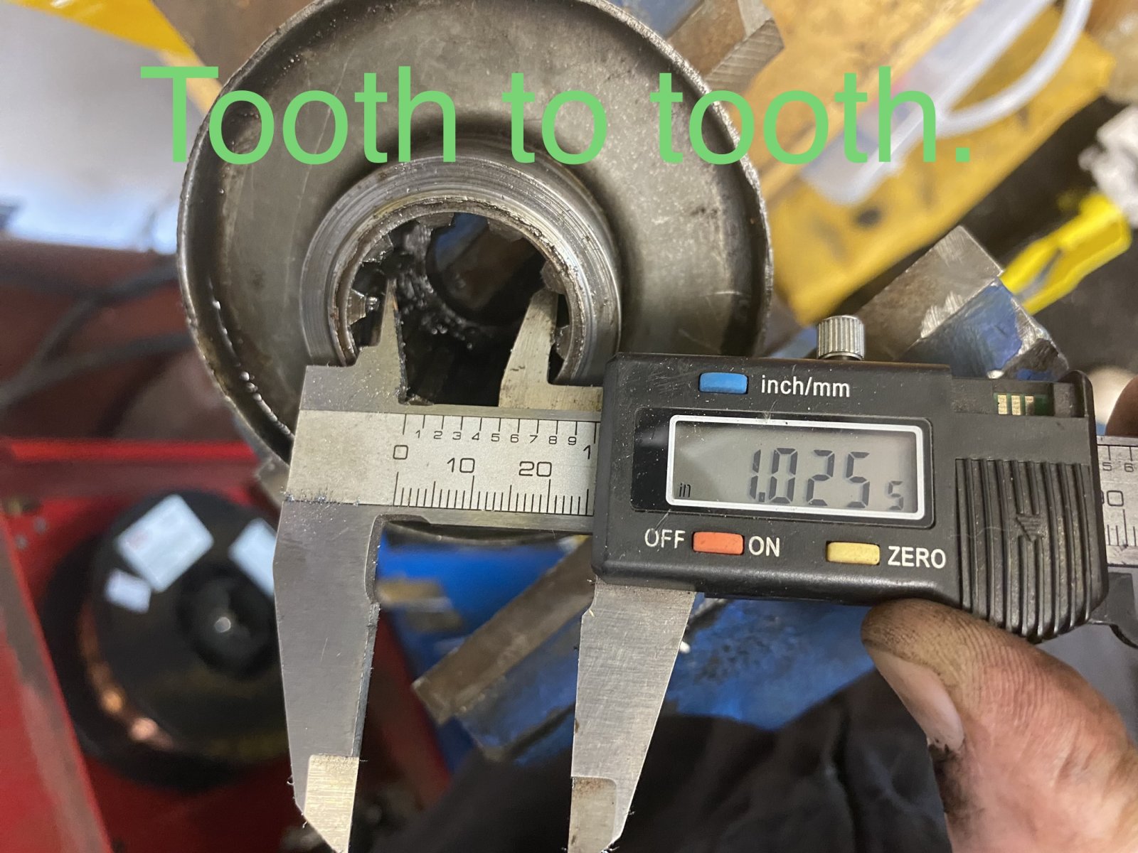

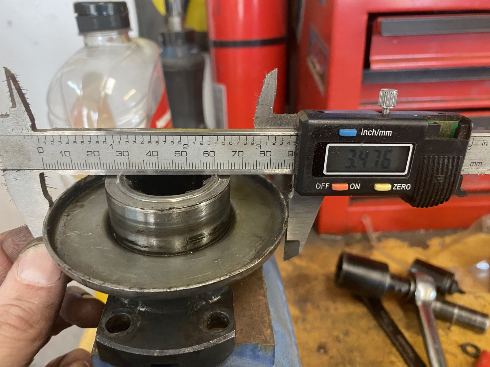

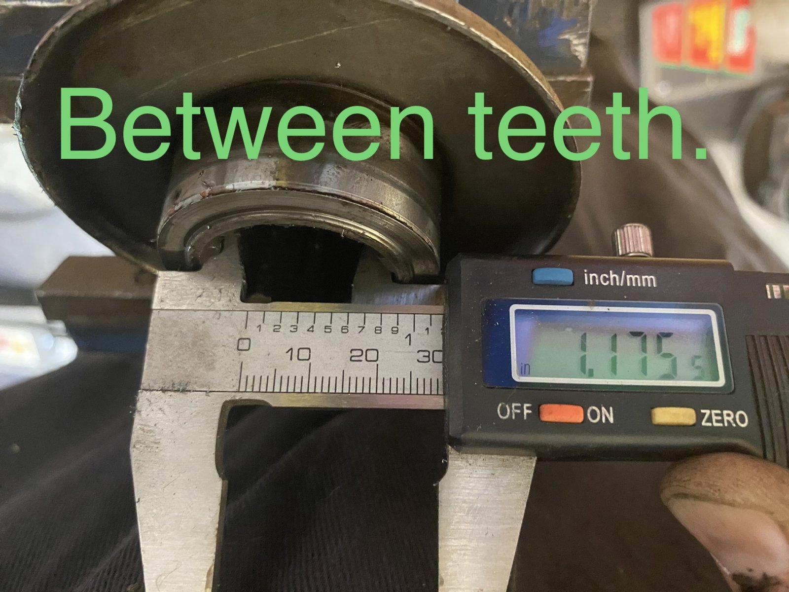

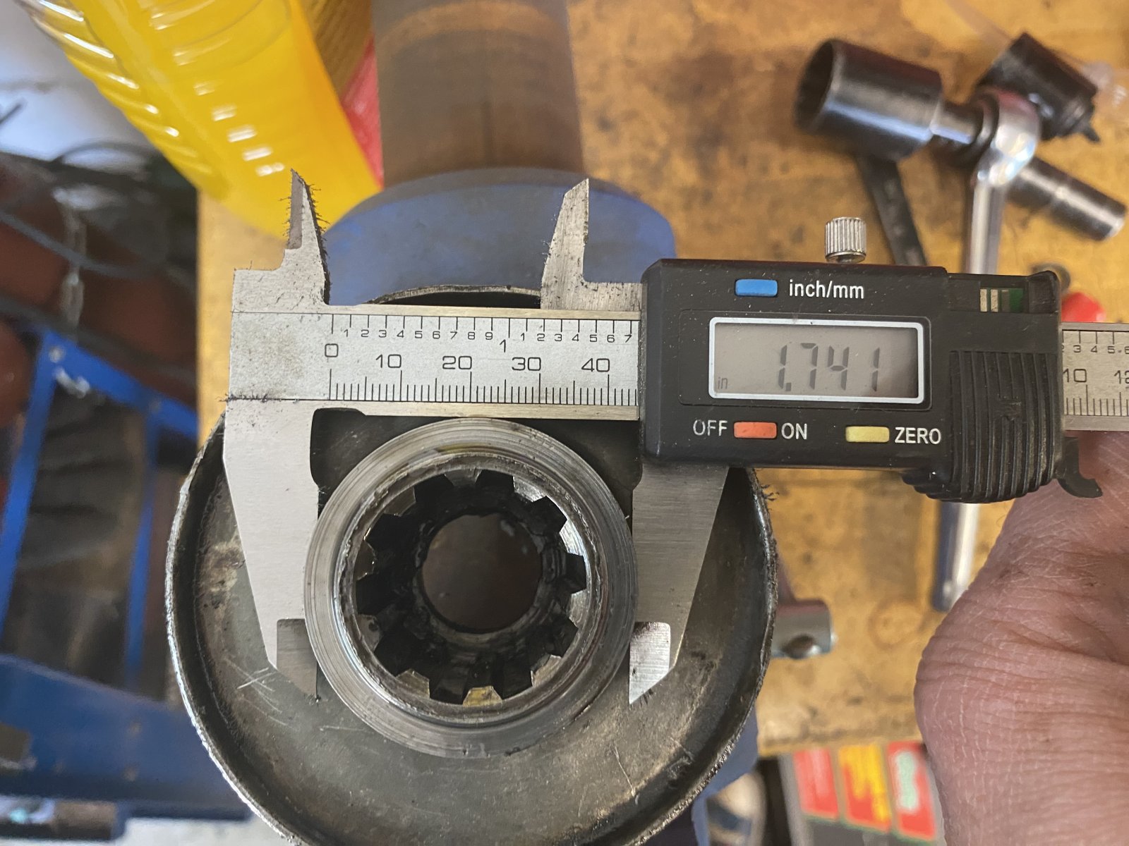

    I’ve been debating swapping in a different pumpkin from a later Olds/Pontiac. If you’ve got another yoke around, I’d definitely be interested!
    Here’s what I just send to the seller on eBay so he can compare measurements for me.
    Please ignore the ****ty welds. I had to do a quick and dirty job so I could drive the car up my driveway and into the garage.

    I can yank it out of my 50 tomorrow, its in shop on stands already, Im doing a built 8.5 10 bolt so I dont need the yoke

    Looks like splines are the same but the surface the seal goes on on mine is 1.44 were you show 1.74.

    Dang! So close. Thanks for checking!
    I heard back from the ebay seller. His measurements matched mine almost exactly, so I ordered it and a new u joint. I need to replace the pinion seal while I'm at it, but apparently it's different between 52 and 53. I'll have to get back under the car tonight and figure it out. Judging by the pictures, I think I need the 52.

    From what I think I figured out , the yokes 49-52 , 53-56 , the seal is 53-64.

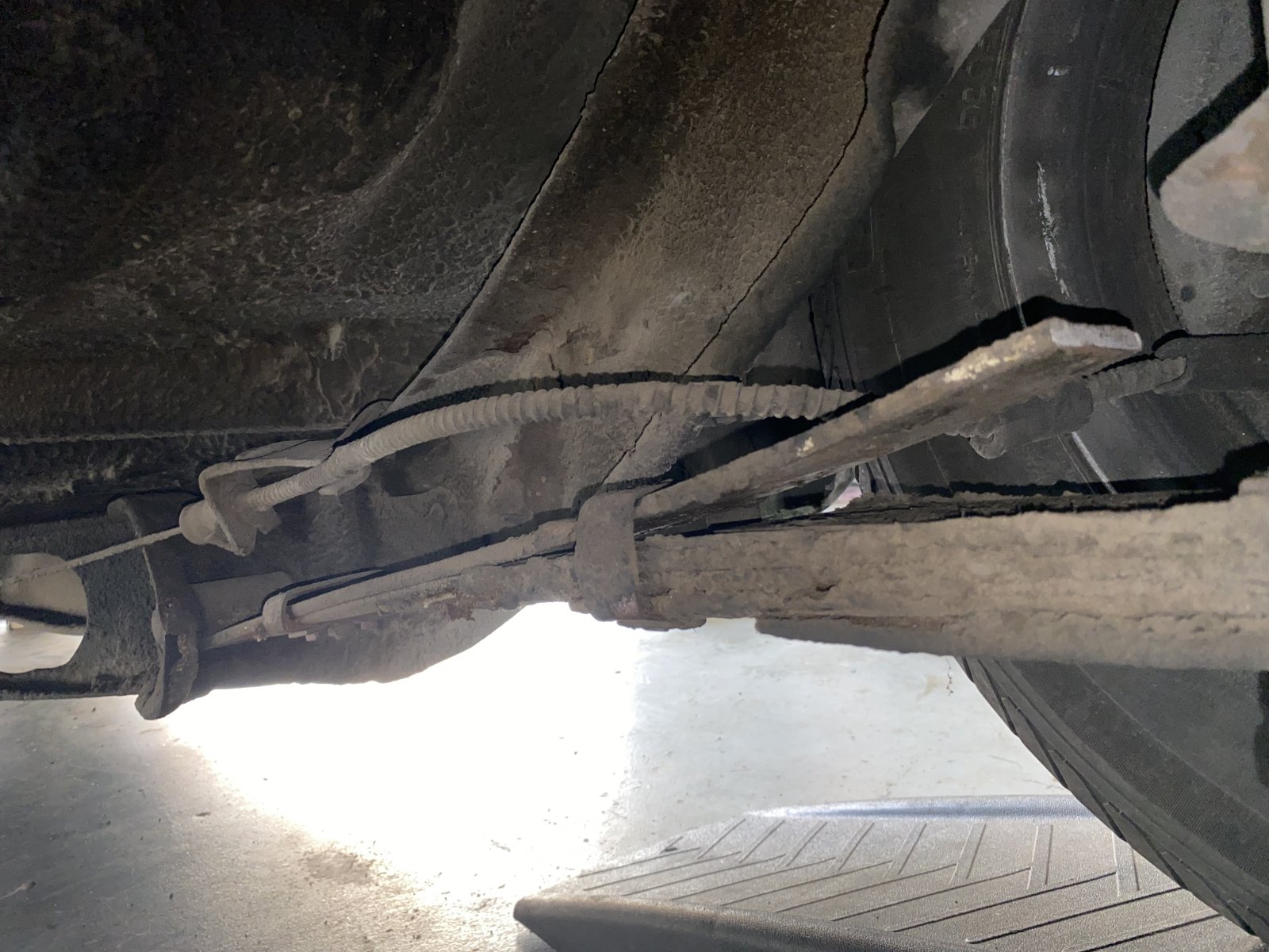

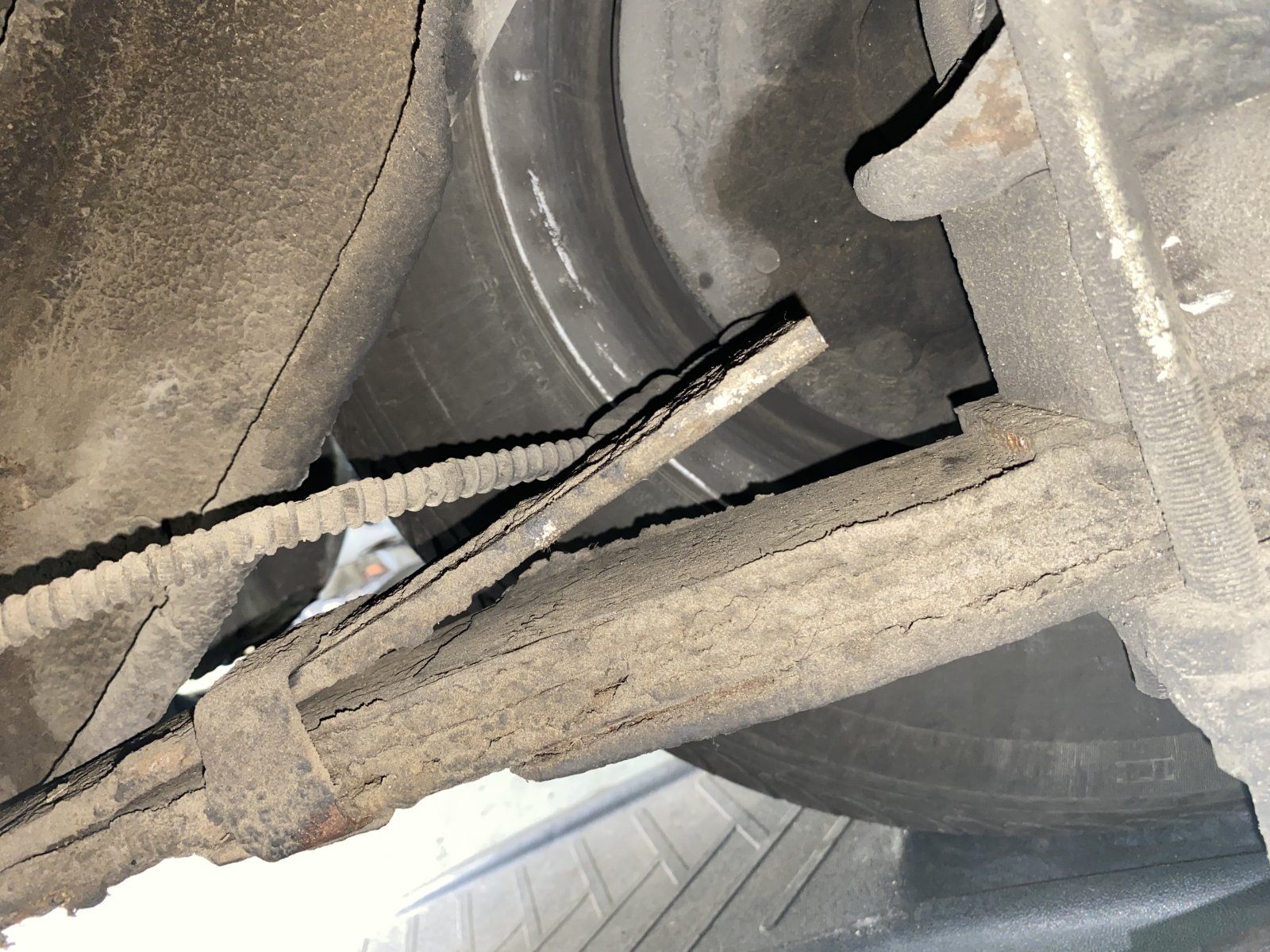

    Sooo speaking of LSRU... I discovered a broken leaf spring, which explains the dog tracking someone told me about a couple weeks ago. I'll add a picture later so you can see, but I'm debating sketchy solutions to get me by another month.
    Do I:
    A) ignore it, drive to Austin and back, then do the 4 link?
    B) clamp the spring back down?
    C) clamp and weld the spring back down?
    (please note, I know these are all terrible solutions, I'm just looking for the least terrible)
    It the top leaf on the p***enger side. It broke just in front of the lowering block and it's allowed the p***enger side rear to slide back a half inch. Again, I'll add a picture later.

    Thorbros has some good stuff. Yeah if you will be eventually pulling a trailer, I would beef up the whole back end.
    That's a tough one, but then again, I can't be the judge since up until I did the 4 link, my rear springs were sketchy too, I flattened them out and removed every other leaf, plus the longest ones lost their arches completely.
    If you ignore it and it shifts it may do more damage, but I doubt it shifting much more unless the pack is super loose, you may be able to get away with just clamping it down somehow, it's a tough call.
    Once you post a pic I can see what it looks like, but did you remove any leaf springs to lower it? Or flatten them out?
    I have most of the shorter spring pack from the original rear end, except the longest spring which I just cut off. If they help, you can have them at least to get you through (but I will take a pic of it later tonight to make sure they are all still there). From what I am reading, your broken spring would be the shortest spring in the pack, the top one closest to the axle? If that is the case, I may have what you need.

    Balls balls balls balls
    why did I look? Ignorance would have been bliss. Or a wreck, I dunno. Whatever.

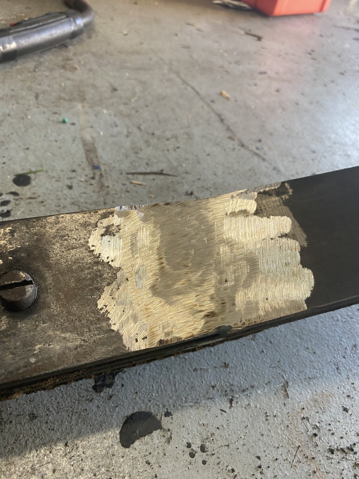

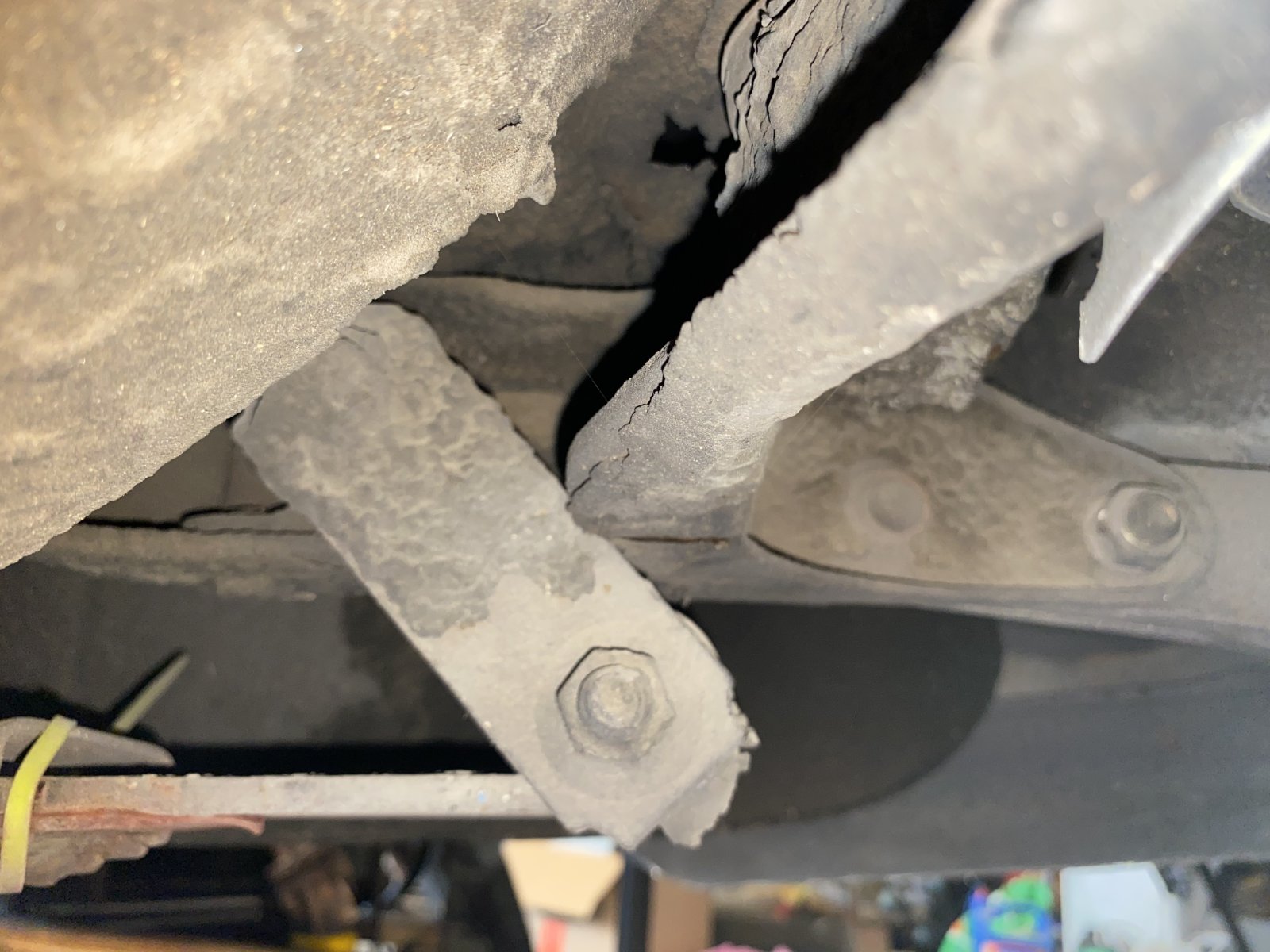

    Here’s the broken spring:
    7D59065D-934B-4182-953E-35FC0EBF1E94.jpeg 37305D94-E847-4C57-A86B-6A1D25EE4BCD.jpeg F56CBB16-9AC2-4CEA-9992-B7C7A75DD464.jpeg
    The rear hanger bumping the frame is the only thing holding the p***enger side of the rear end in place.
    A clamp wouldn’t do jack. My only option is to weld it without wasting money on new springs. I’ll have to think on it. I know the correct answer is to not drive to LSRU.
    lucky likes this.
  15. lucky
    Posts: 851
    lucky
    Correct. Do NOT drive.

    I don’t ***ume any Olds guys within a couple hundred miles of Waco want to loan me leaf springs for a month? I’ll pay rent as long as it’s a lot less than new springs. Haha
  18. vtwhead
    Joined: Oct 20, 2008
    Posts: 5,307
    vtwhead
    You must have a spring shop near you. Take it out and have them make you the main leaf. Not very expensive, at least not up here in our region.
    EnragedHawk and bobss396 like this.
  19. wvenfield
    Joined: Nov 23, 2006
    Posts: 5,671
    wvenfield
    Yep, I'd be off to a spring shop. Quick and easy for them and really not all that expensive. (granted prices have gone up since I had my springs worked on).
    EnragedHawk likes this.

    The bummer is going to be getting the front sping hanger bolt out. The front ones that go into the frame have always been a ***** for me to get out.

    I may be able to help you with your yoke, can you give me a u joint #? Or a measurement diagonally from inside corner to inside corner of u joint flat.

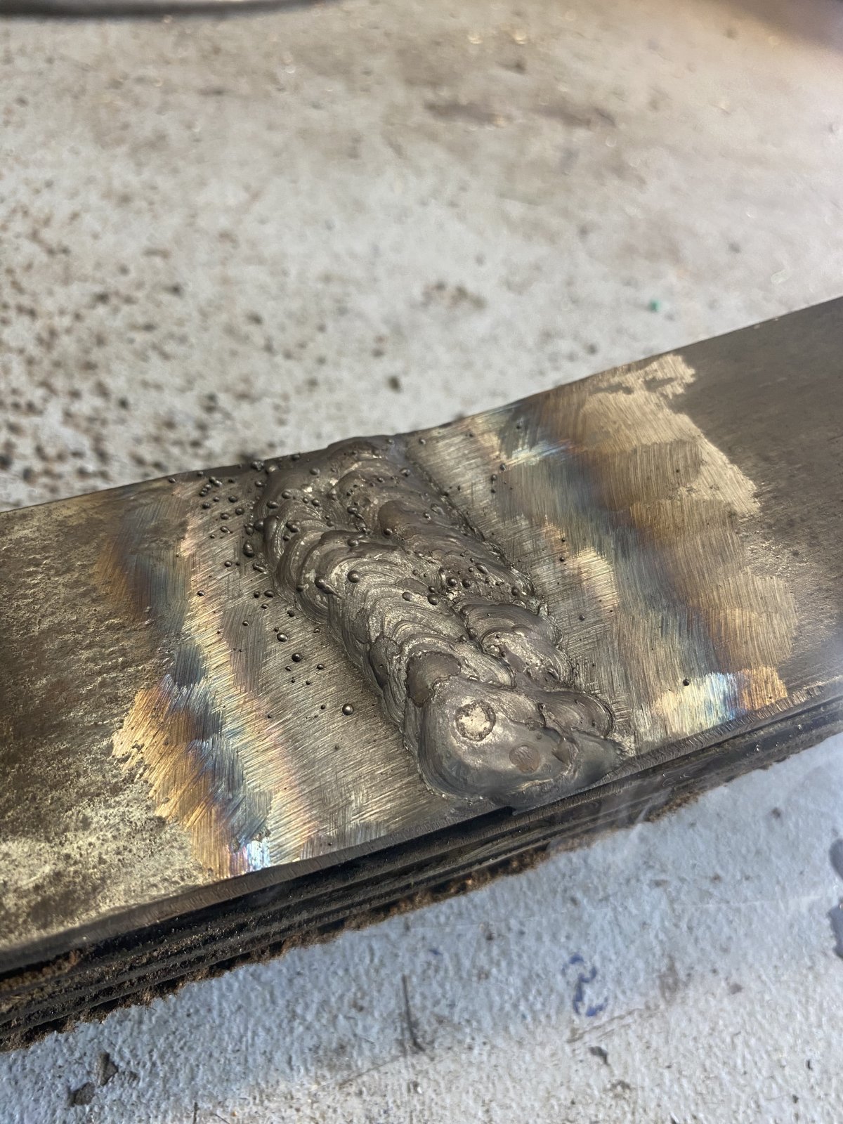

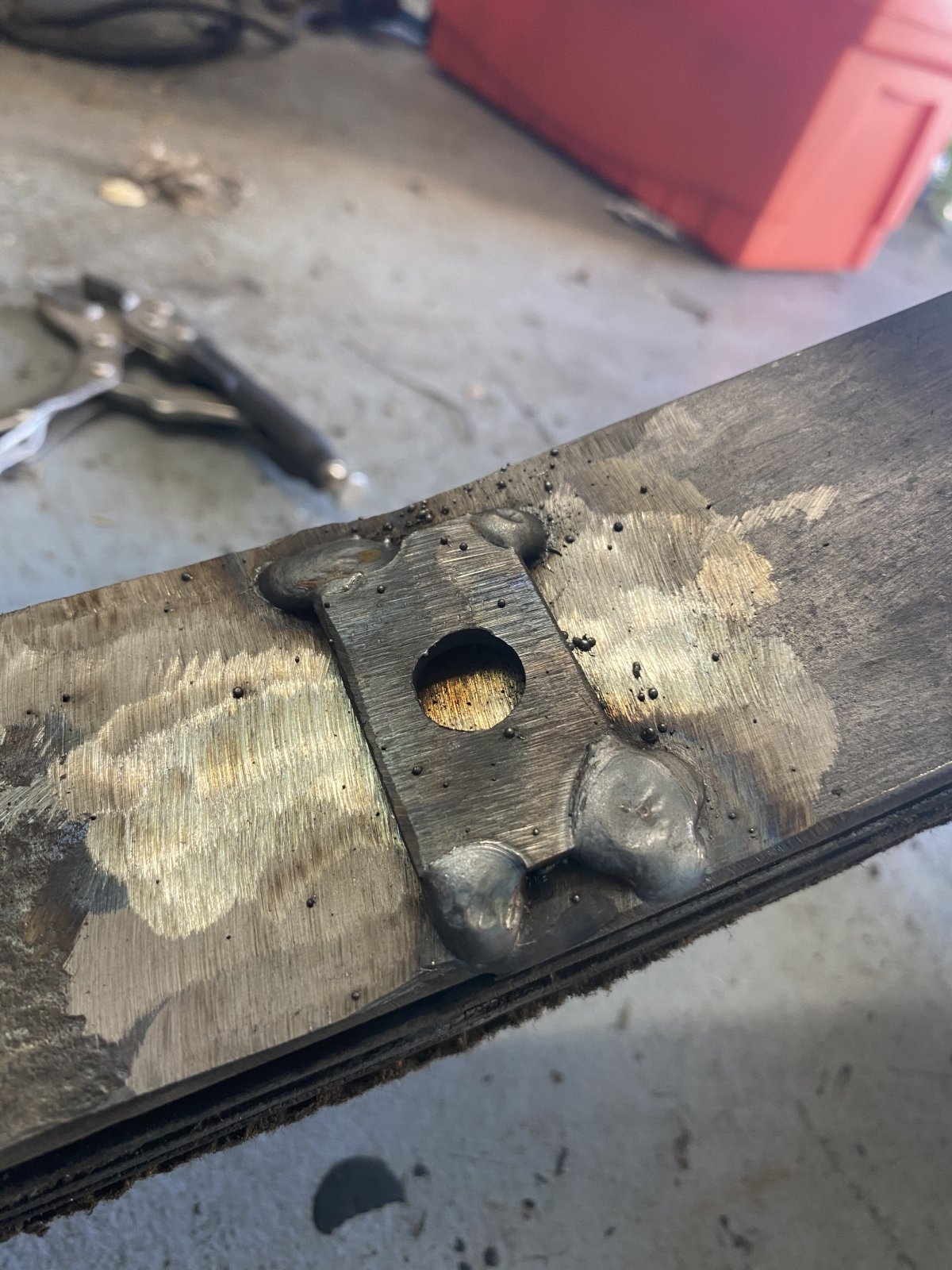

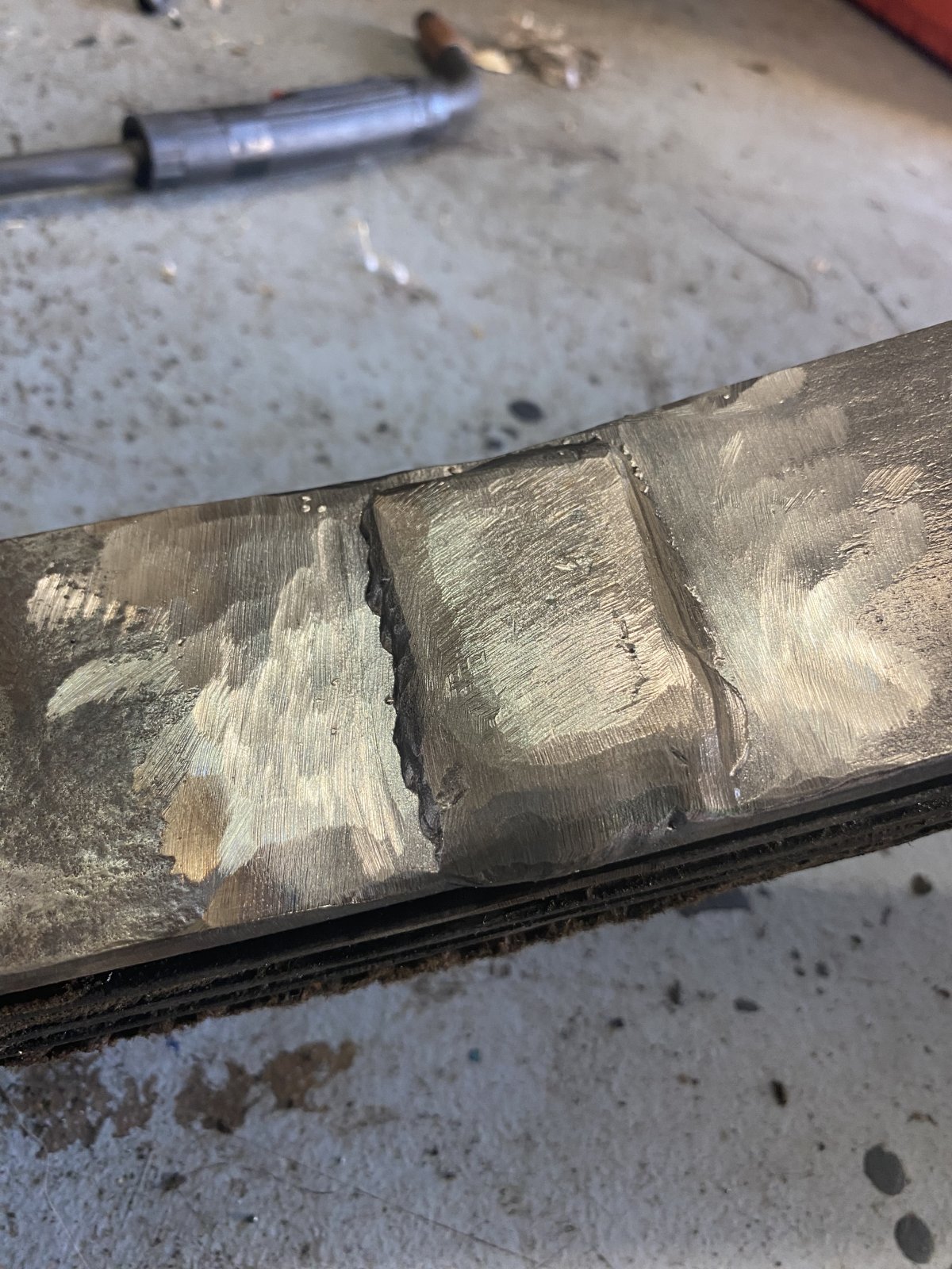

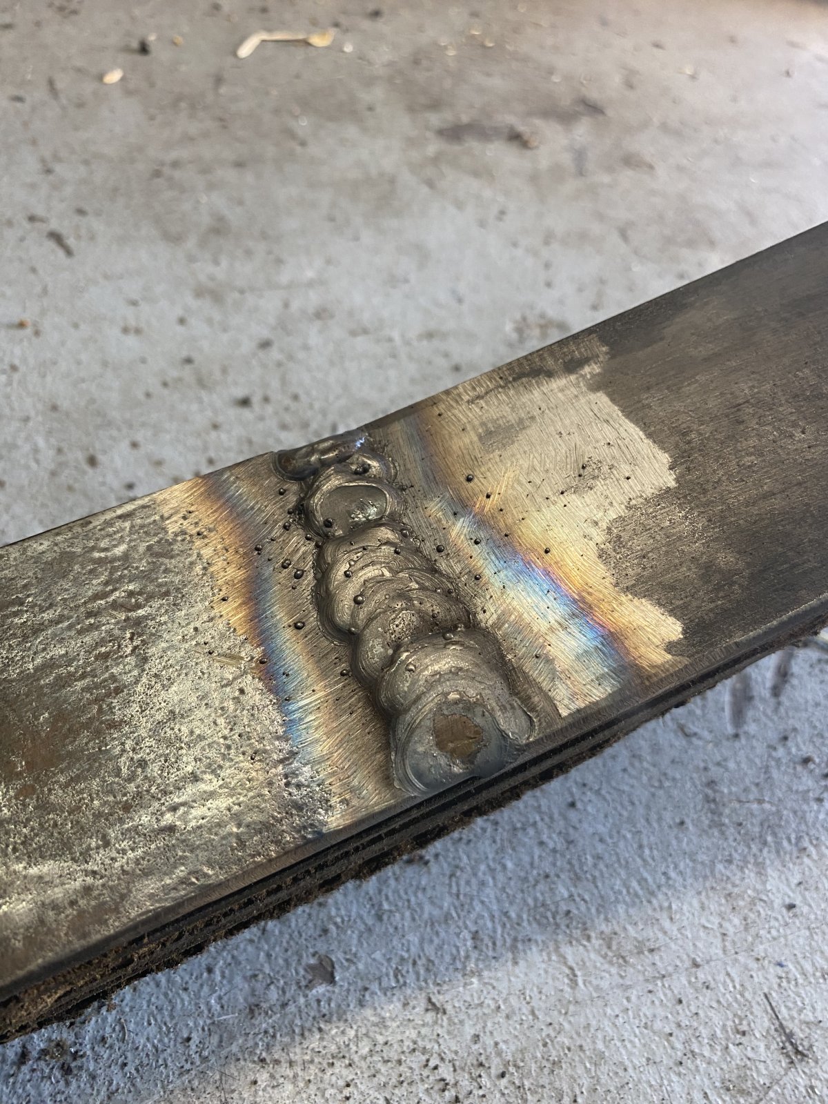

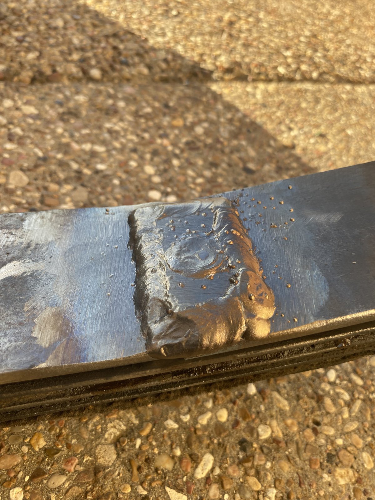

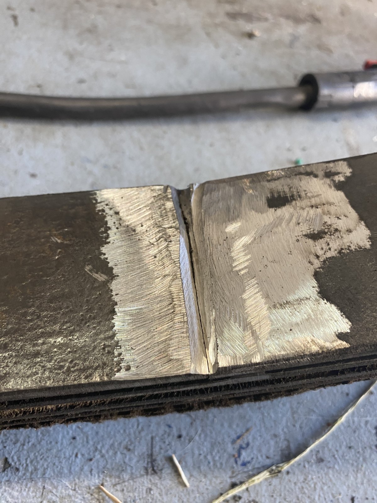

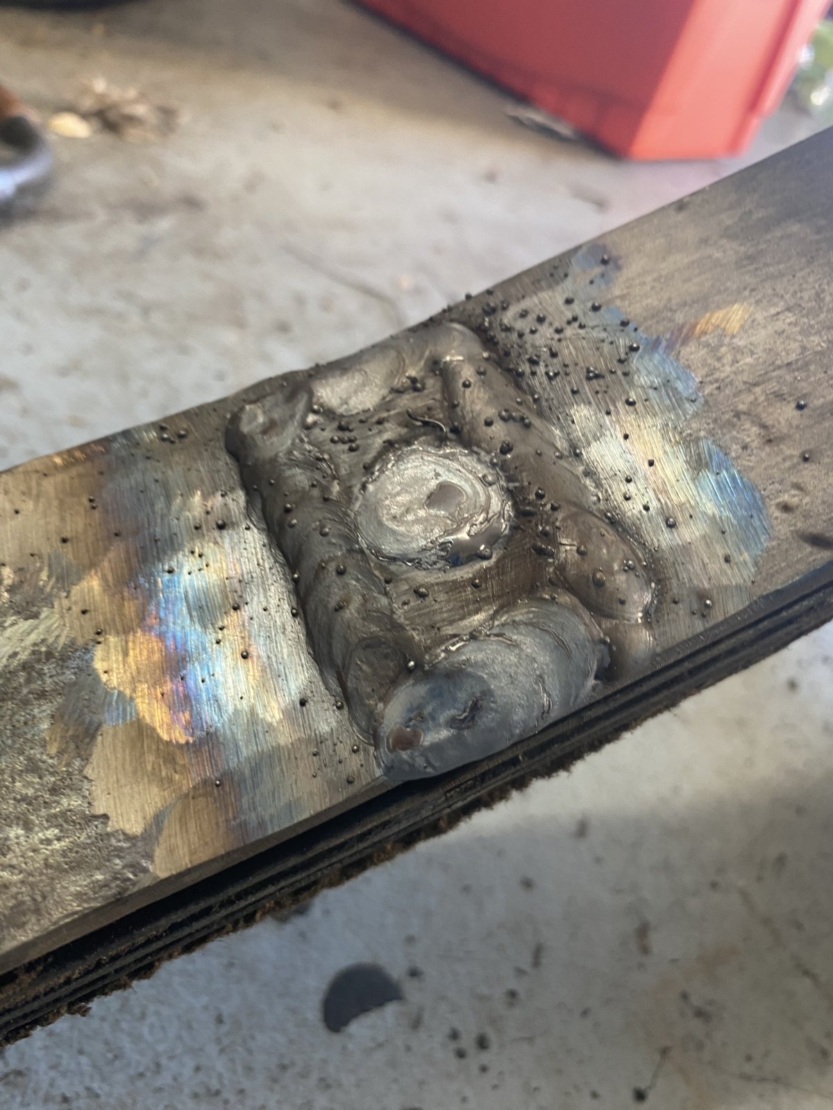

    Ok, this is no time to play “hide-the-weld”. Full disclosure on my repair process with before and after grinding.
    D0D3E7E2-3778-4E63-9F77-64008A970A19.jpeg 144C896C-F457-4A3F-9105-24B16D34C7AE.jpeg F0A69E82-C5BE-4DA2-9625-A027F4DB45F9.jpeg E4F9CFCC-A67A-47A5-8AB1-EFC9C46780EB.jpeg 61C380B9-9953-46A9-8E40-DEF1F7DD0FE2.jpeg A7E76A4E-6DC4-4B8E-AD0F-A2E3211660D8.jpeg C5268EBA-729D-467D-AB77-47314AF8E583.jpeg
    I have checked with a few people whose opinions I trust, and they say I’m good to go. Doing my best not to “hear what I want to hear.”

    The yoke is swapped and fits great. The spring is welded for now. My test drive suggests it was broken for a long time, because the car rides much smoother now.

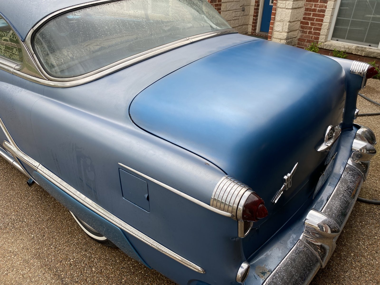

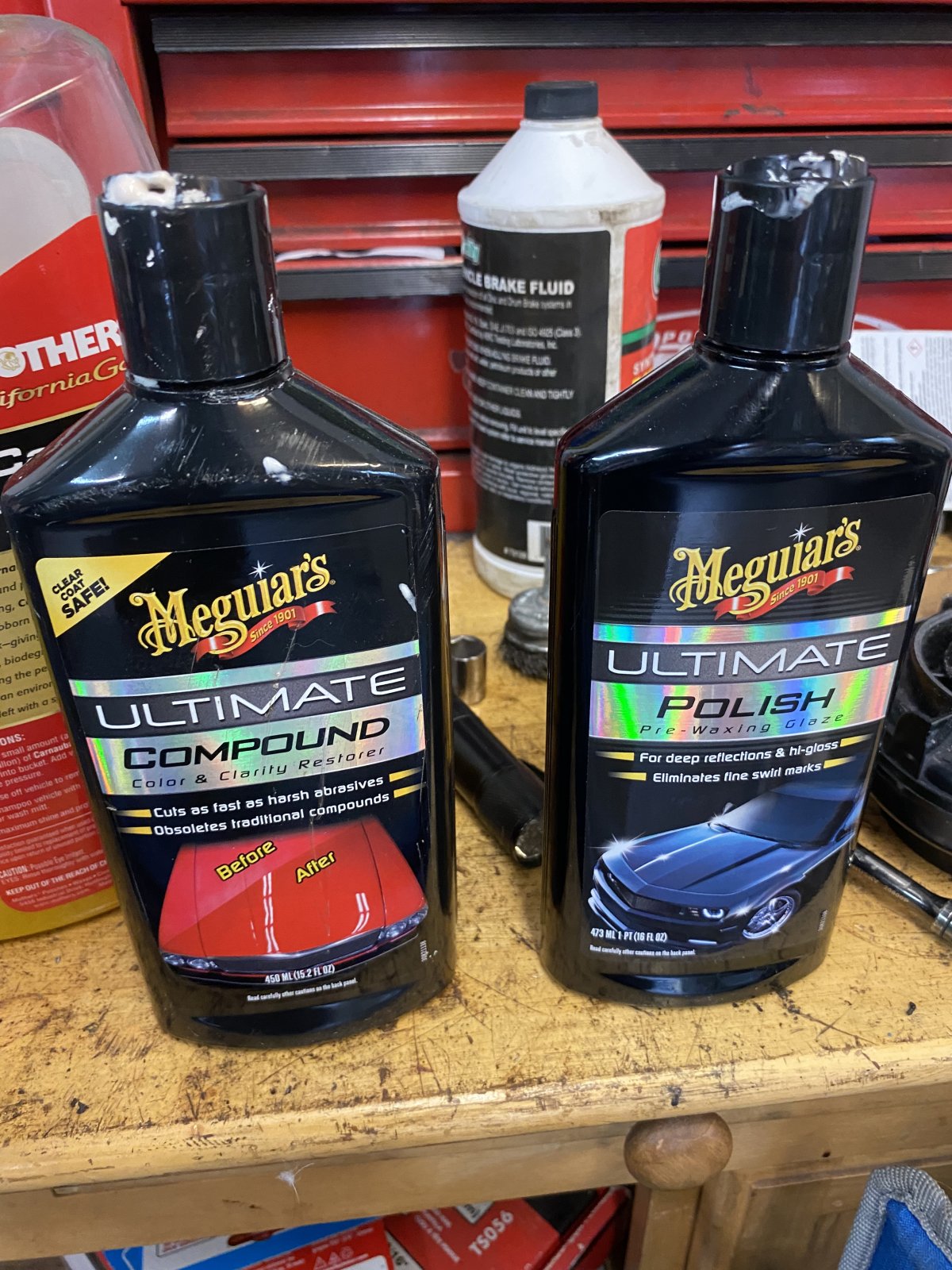

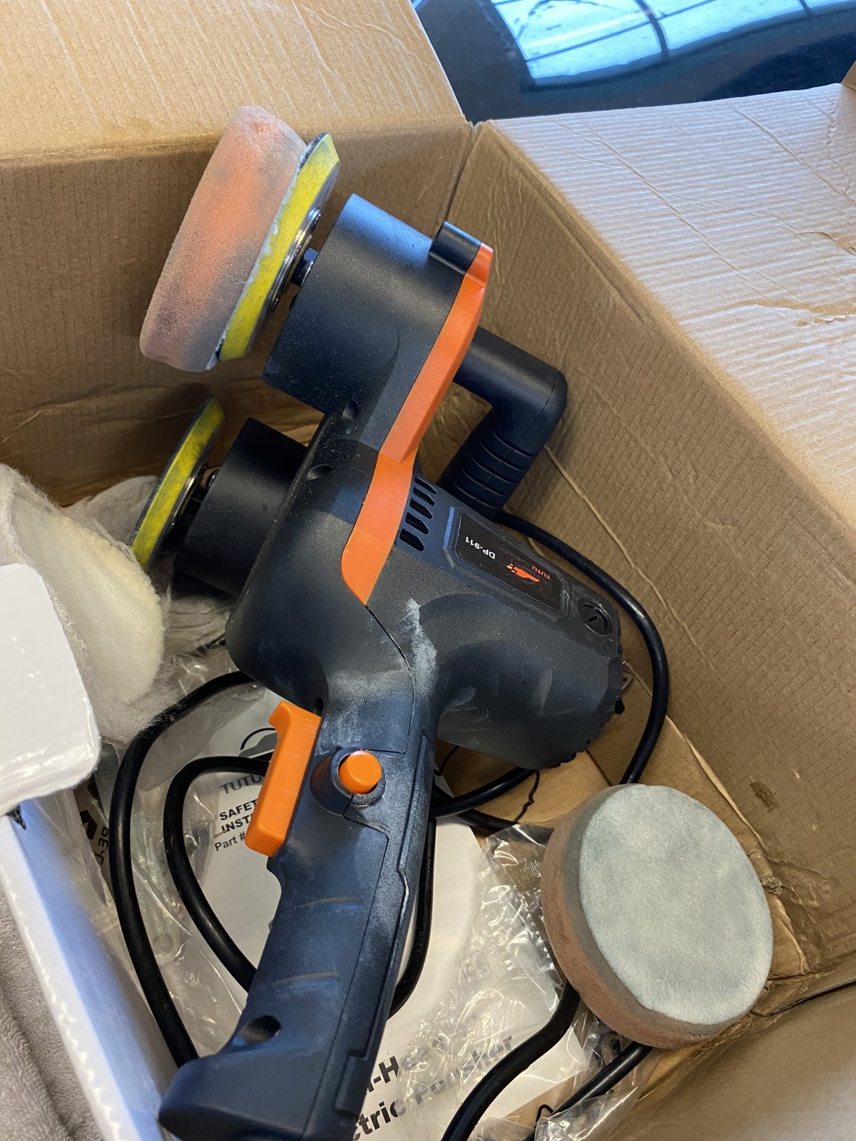

    I beseech thee O HAMB gods. Save me from myself. Uh, again.
    I’m trying my hand again at compounding the car before LSRU. So far, made it worse. A lot worse.
    I borrowed this from a friend:
    I’m using this rubbing compound:
    I’m going slow and overlapping, and the paint color looks way better, but I’m leaving serious streaks behind. F781E26B-5217-4562-B8A0-350D8CC26DD5.jpeg 65BFF824-43F3-4B11-9B59-4CAB28FF8CC3.jpeg
    Looking for advice on what I’m doing wrong.
