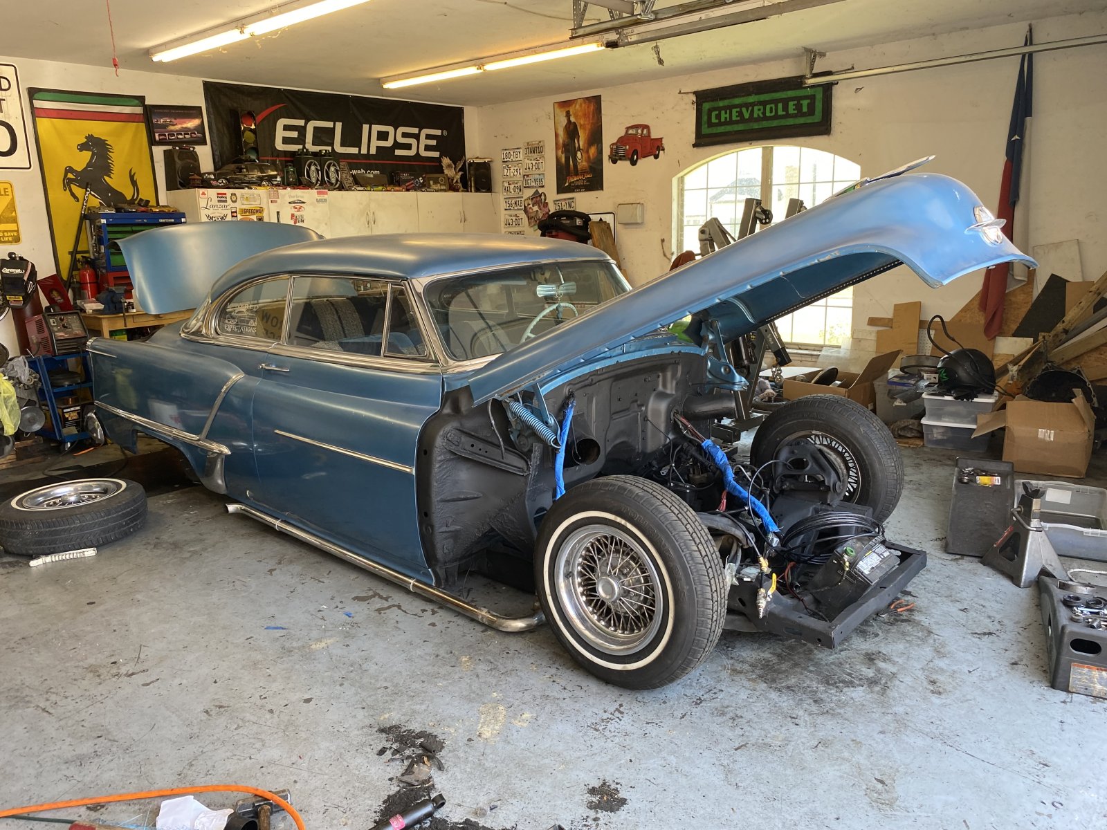

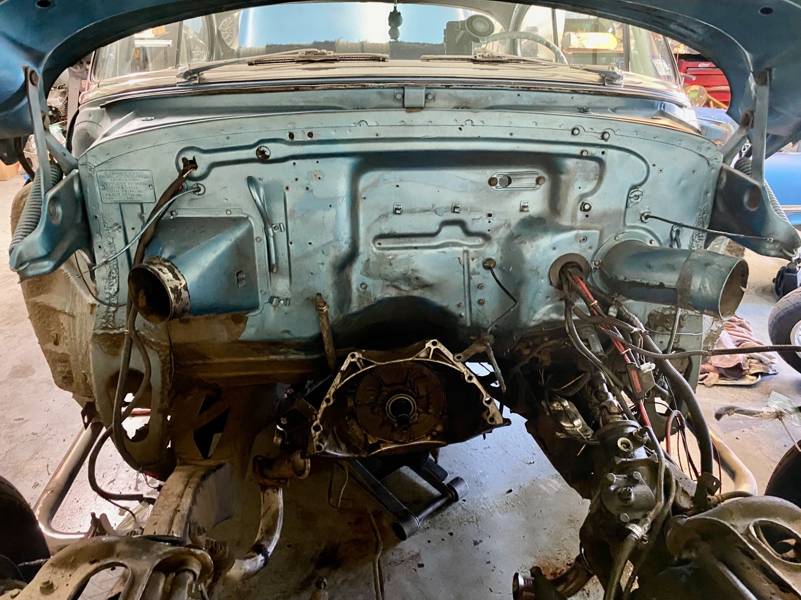

    Alright. The process has officially started today.
    Pulled the front clip off and the engine is out.
    Going to spend the next few days cleaning the frame up and the engine. May drop off the 200r4 for a rebuild this week too.
    Engine needed to come out for oil pan gasket and rear main seal. Going to regasket everything while I’m at it.
    Also going to paint the engine. Color recommendations? What color is correct for a 1968 block?

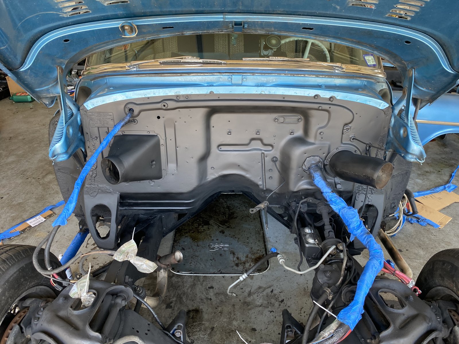

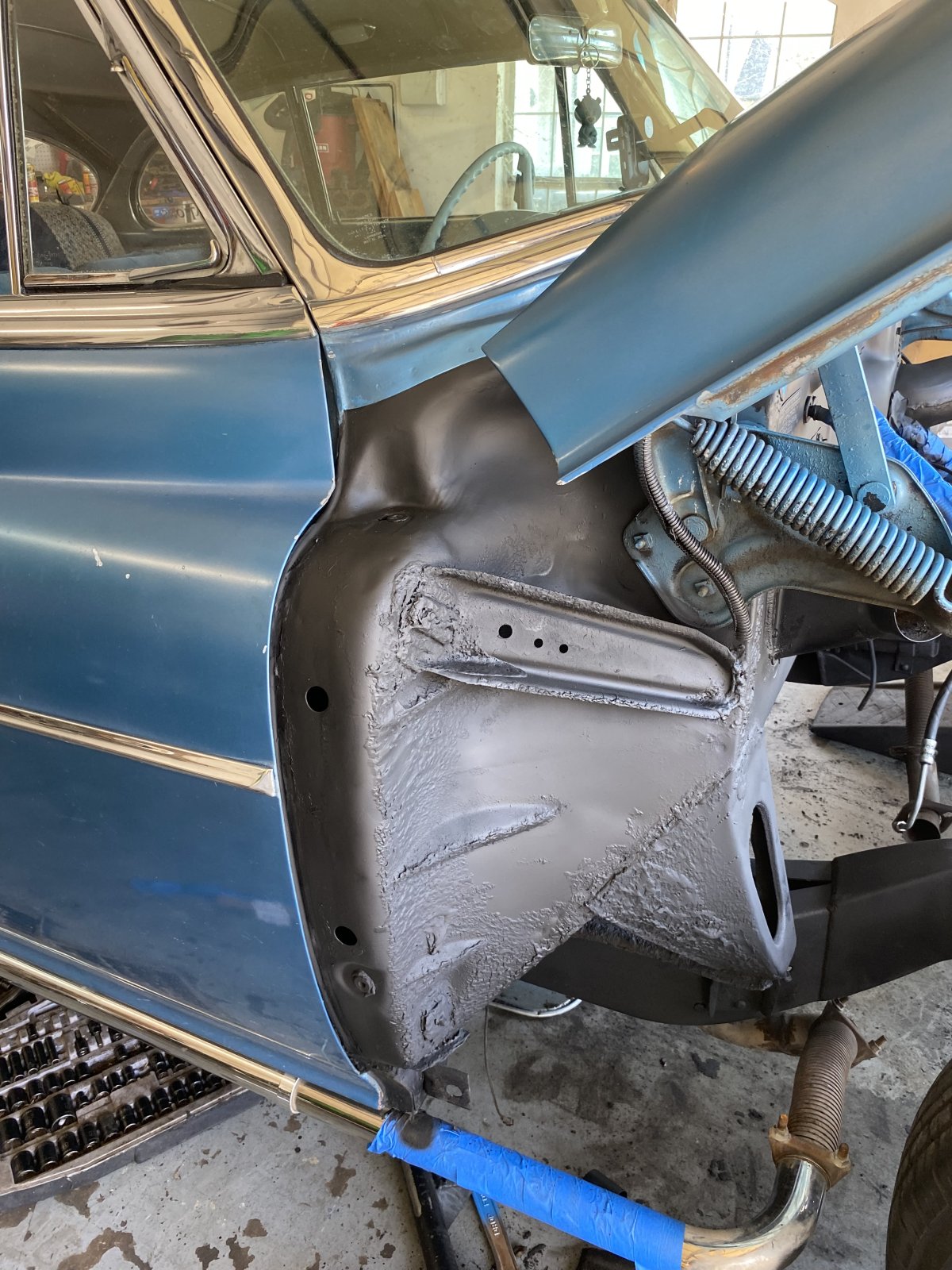

    I know most of you won’t agree with this move, but I went with flat black for the firewall and inner fenders. The paint was super worn, faded, and scratched up. Flat black will be easy to maintain if something gets scratched. If I knew what color I’ll paint the car someday, I might have done that. I’m so over spent on this current project, that paint is a looooong way away.
  17. bobss396
    Joined: Aug 27, 2008
    Posts: 18,753
    bobss396
    I use VHT ch***is and roll cage black. Not flat and far from glossy, very forgiving for touch ups and holds up well.
    Crusty Chevy and EnragedHawk like this.
  18. BJR
    Joined: Mar 11, 2005
    Posts: 11,364
    BJR
    I see you used tape to cover your wires and cables. You know what is easier? Aluminum foil, just form around and tape the ends. comes off way easier also.:D
    loudbang and EnragedHawk like this.

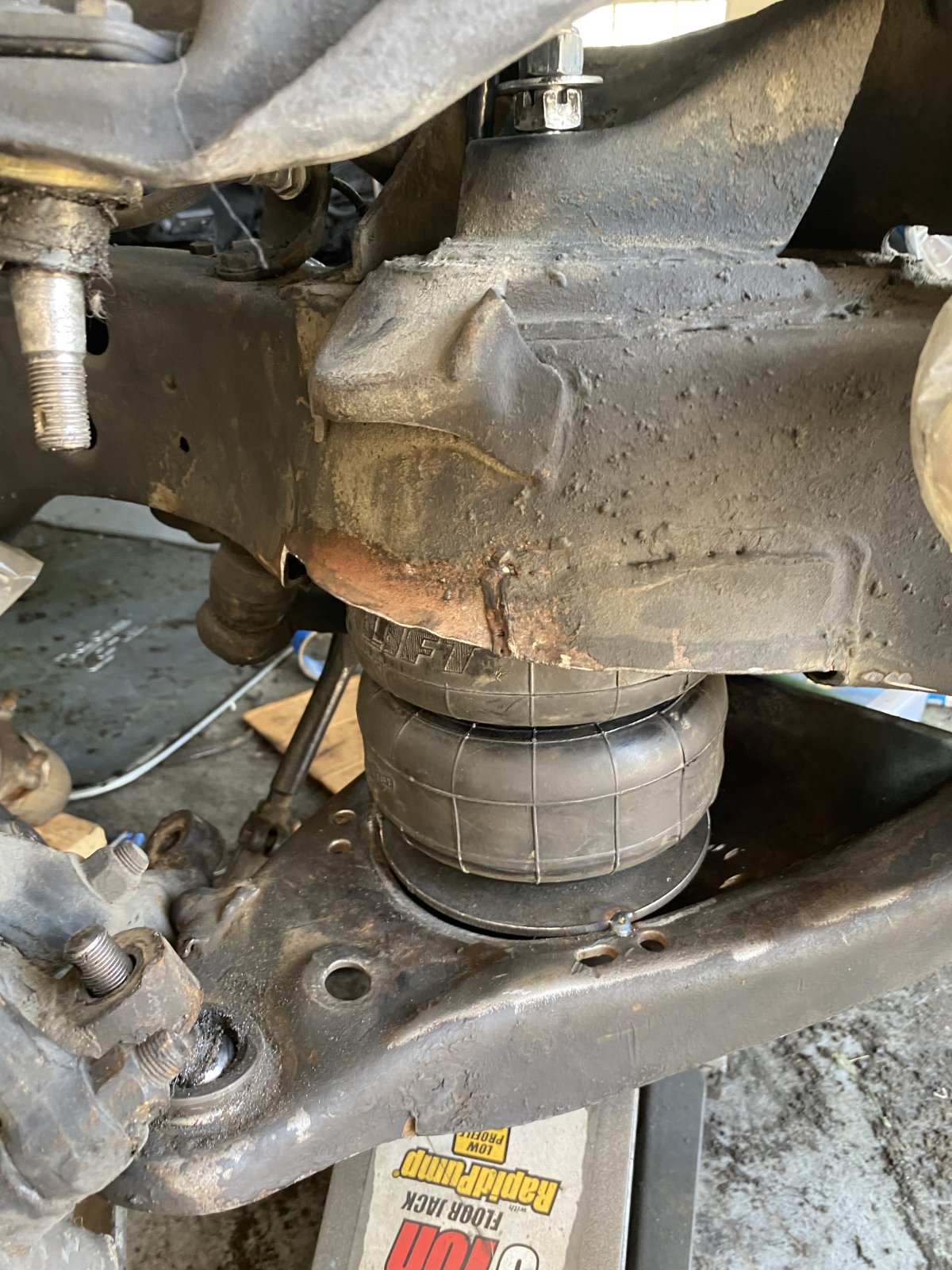

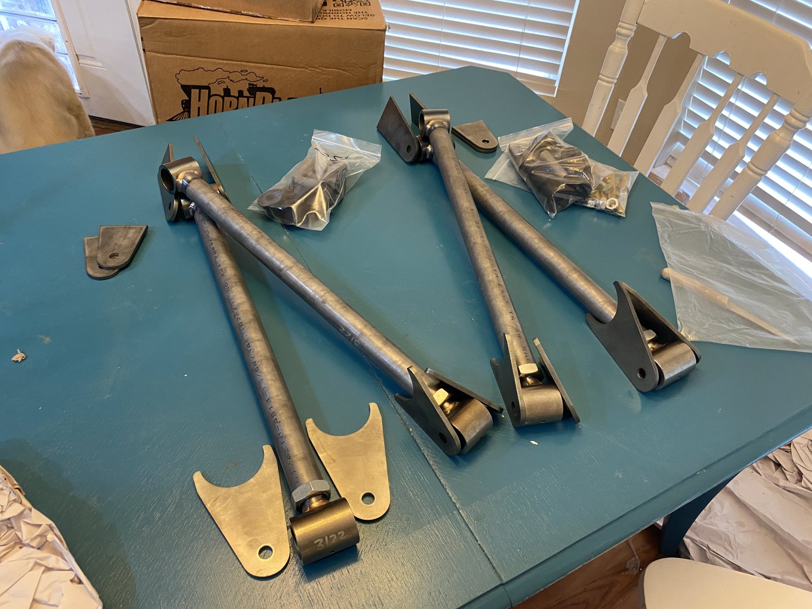

    Alright! Time for a decent update!
    All my stuff for air ride came at the end of last week.
    This is my last week off unfortunately before I’m back teaching. Going to try and make the best of it, so I got on it over the last few days and got the front mocked up and dropped. Everything is still just tacked together, but all the measurements are coming out perfect so far.
    It’s fun to see the front so low. I’m dying to see the whole thing down, so I took off the rear tires just to play with it some.
    I still have a long way to go on the front end. More measurements to take, welds to finish, shocks to install etc.
    With this being my last week off, I’m hoping to have the front end finished. There’s a chance the engine and transmission will be ready. If they are, it would be nice to have those thrown back in as well.

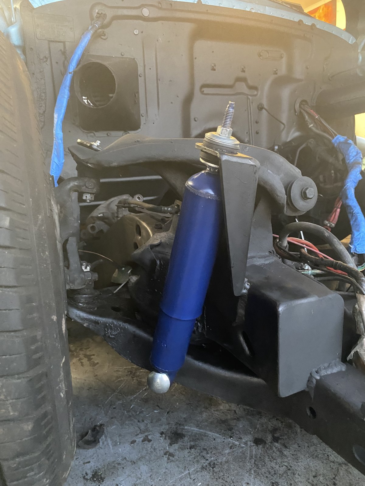

    Front is done! Well, mostly. Need to torque some stuff down and put the brakes back on. Everything is measuring out perfect! Same amount of lift on both sides at the same air pressure. I unfortunately had to ditch the sway bar, but I was able to keep 100% of my steering radius. I lost waaaay too much of it putting the shocks on the opposite side.
    Unless I get too impatient, I’m going to wait on the engine and transmission before I do the rear. Then I can do some shake down runs. If any issues come up, I won’t have to wonder if it’s the front or rear that’s to blame.

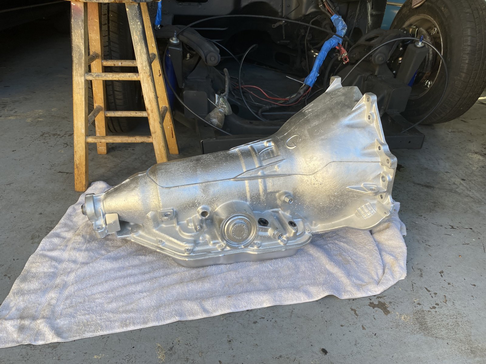

    The 200-4r is back!
    Engine should be back soon. I need a few parts to get the new trans going. How does this parts list sound? I already have the lockup harness. 2004r parts list.png
    I really wanted to get the engine and trans back in and drive a bit before bagging the back. To do that, I need a new driveshaft. That made me question how much the diff will move forward and backwards at different ride heights. I played with the bars on the floor. I exaggerated the numbers to get an idea.
    The differential could move as much as 2” forward when laid out. That makes me question the slip yoke location in the transmission. I’ll play with it more once the engine and trans are back in the car. That way I can get more accurate numbers.

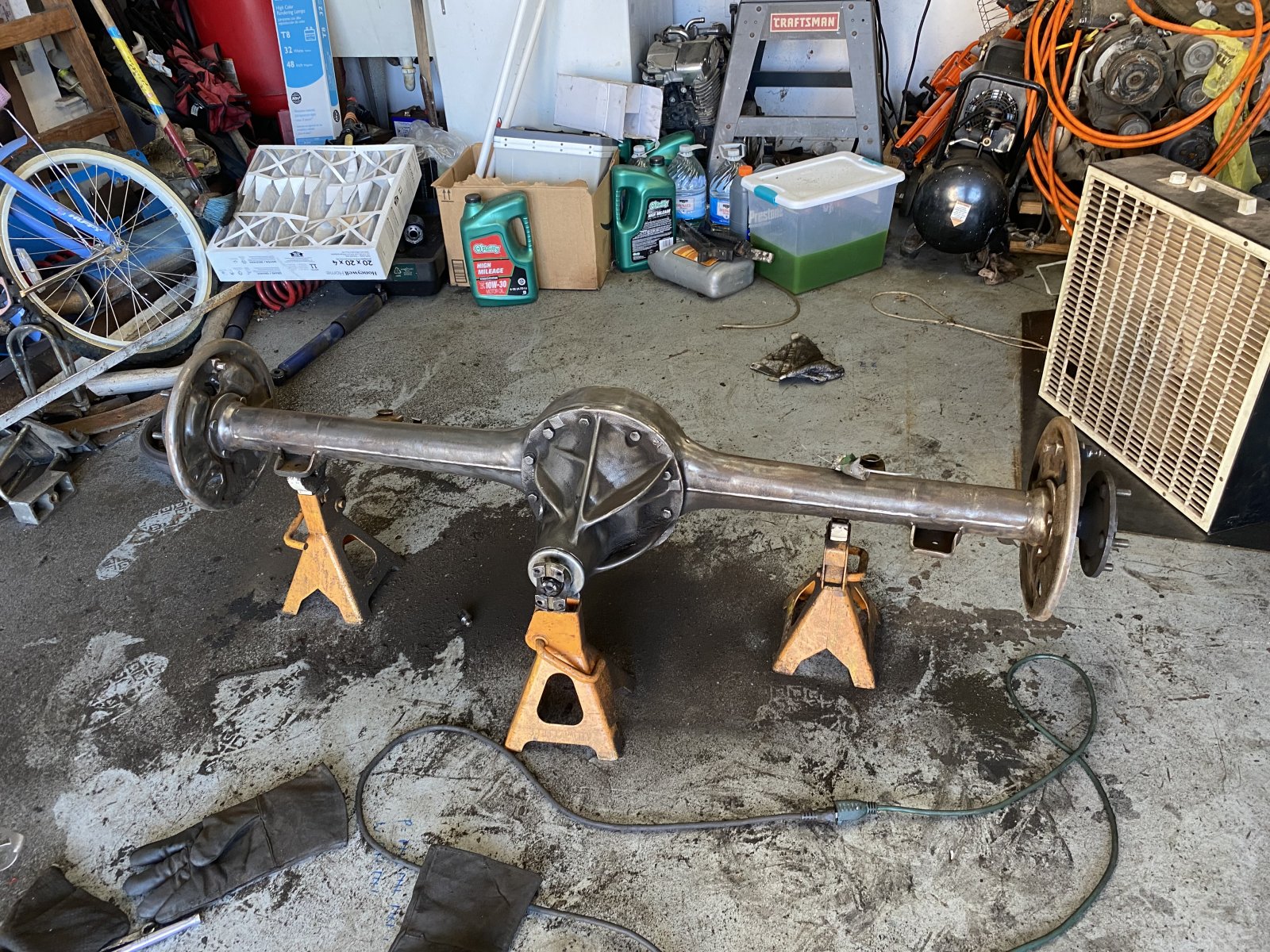

    Measuring with a caliper, it looks like the yoke can have 4” depth before bottoming out. I know you’re supposed to bottom the yoke, pull out 1”, and measure for the driveshaft, but obviously I don’t know just yet how much my diff will move.
    I decided yesterday to go all in. I want this car back on the road ASAP. I went ahead and pulled everything out from the back.
    About to show off my differential ignorance. I clamped one drum down so I could count rotations and find my ratio. I did it roughly 6 times and got 1.6 every time. Obviously wrong. But then realized, maybe with one wheel clamped, it halves the ratio because it’s not spinning like it should? Just guessing, but that would bring it to 3.2, and I was expecting to find a 3.23 gearing. Hopefully one of you can tell me if I’m on the right track.
    I’m about to call a driveline shop and see if they’ll give it a once over. I think I put the yoke on too tight. I swear I followed the directions for torquing the but down, but it doesn’t seem right to me. I think I loaded the bearing down too much. I have to kick the pinion over by turning the axles before I can move it by hand. Seems like it’s getting stuck. I drove it that way several hundred miles too, so I need to make sure it’s ok.
    On the diff topic, think 3.23 will be ok with 0.67 over drive and 205/75/15 tires? I’m after gas mileage here, not racing, but I also don’t want the engine to lug.

    I did confirm today that’s my ratio. Spent some time cleaning my rear end. Heh. I may still pull the pumpkin and have a driveline shop give it a once over to make sure it’s ok.
