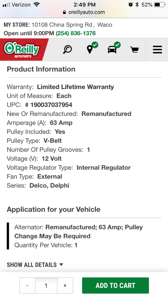

    Here’s the alternator that’s on it:

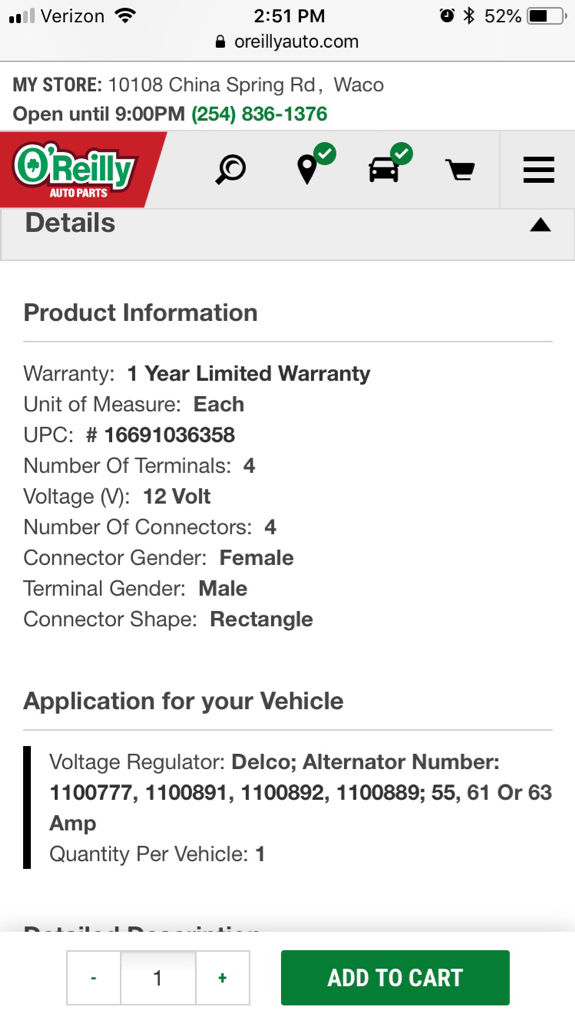

    So as it is now, it’s working. How am I supposed to bypass it? Because when I tried this set up, the alternator burned up immediately;

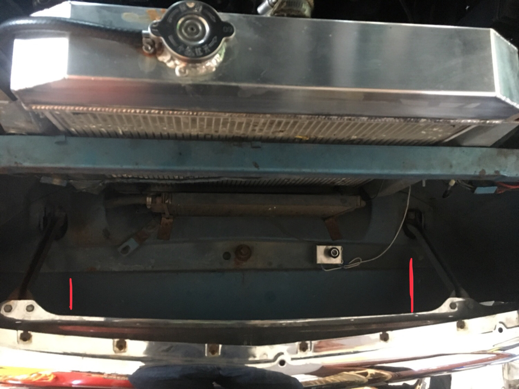

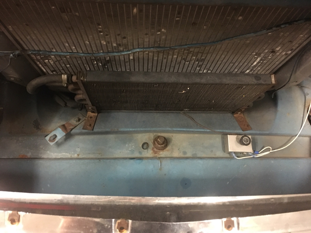

    Currently, there’s no place to add the airdam under the radiator, the floor is solid:
    Does this mean I have to bust out the saw? I’m not a fan of the idea, but I’m willing to do it to get this thing cursing properly.
    Also, in the engine bay, there’s really no where else for the air to go other than down and out besides the louvers. How can I fix that? Or is that the whole reason for a dam?
    I did have a mechanical fan around, but it was an older dented flex fan. I already ordered a steel fixed blade fan from summit.
  21. ClayMart
    Joined: Oct 26, 2007
    Posts: 7,788
    ClayMart
    Your photo shows the area in front of the radiator. You need to rig up a deflector of some sort just behind the radiator to kick up a bit of cool air directly into the engine compartment. Any air passing thru the radiator and trans cooler is going to pick up a lot of heat on it's journey.

    I wanted to mention, there is an upper cover for the radiator that mimics the shape of the hood.
    I went for another drive this morning, fairly long. About 30 minutes to my destination, then 30 back. I kept an eye on engine temp and voltage to see how closely they were related.
    I started out slow. Kept the car 45 and below. Engine temp would voice between 180 and 190. It’s hit 190 and almost immediately cool back down (does that mean a 190 thermostat?). Along with these temps, voltage stayed at 14.3 while driving, dipping to 13.7 when stopped. I’m totally cool with that.
    On the way back, by now, heat has built up under the hood. Mostly ran 190-200. I had a small jump on the highway where temps ran up to 210, but then slowed back down and stayed at the 190-200 range, no matter what speed I slowed to. Voltage maxed at about 13.8, and would dip to 12.9/13 at stops.
    Coming home last night, I cruised 65ish most of the way home, temps ran around 210/220 and that’s when the voltage*****ed the most.
    Ok, here’s the current plan I may go with. Mike, free to jump in and correct any bad ideas.
    I want to make two smaller cuts so the air dam will help blow into the radiator.
    From there, the metal can bend down, and I can add to it from under the car to make it a much larger dam.
    I have the mechanical fan ordered, I feel like I might as well use it. At the same time, I don’t see a reason I can’t put the electric fan on the front side of the radiator to****ist.
    Now, here are two other ideas I’m not sure about:
    what about some ducting that runs straight to the alternator to cool it off? I know mike said to get all of the air through the radiator, so I didn’t know if this would counter that effect.
    Also, should I put some kind of block off plate on the underside between the bottom of the radiator and the engine crossmember? Here:
    I haven’t tried taping off the louvers yet, though I did buy tape. I can’t think of any way to block those off long term that wouldn’t trap water. I may try the tape just for the sake of knowing what I’m up against.
    Anyway, help welcomed as alway. And again, a huge thanks to Mad Mike for all the help so far.

    I'm sure the engine would run cooler as the engine bay air would evacuate easily, but it would not be practical and not show us any useful airflow data.
    That cowling is fine. If anything it is helping direct are towards the radiator, rather than letting it spill up and over.
    I see how there is a massive gap on the side of the radiator. That would allow usable cooling air to bleed into the engine bay, which in turn would also prevent building up air pressure.
    Looking at original '53s...
    your radiator is forward the stock position and is now cut into the cowling rather than behind it.
    Was this to clear the 455?
    Those gaps at the radiator sides need to be blocked off to prevent the needed cooling air from bleeding around the radiator. Air needs to go through the rad, not around it.
    We need to build that wall.
    Make cooling great again.
    Thermostat will stabilize the temp. Allow an engine to warm up and the thermostat will gradually open til it reaches operating temp, and from then on will gradually open/close to maintain a given temp.
    If you see an instant drop in temps that is more likely to do with a fan, or a fan turning on. With an electric fan it would kick on/off at two temp set points.
    Sounds really good. Anything above 13.5 is preferred.
    Yup the alternator is getting heat soaked. Increase in heat will reduce voltage output. And increased ambient temps of the wiring will cause them to have higher resistance and cause voltage drop as well.
    No cutting!
    Not yet anyway.
    Currently we are in a research and diagnostic phase. Any modifications for testing need to be done in a non permanent way. Lot easier to undo a modification that makes the problem worse if it is just tape or bolted on. Cutting and welding are a bit harder to undo. Besides there are plenty of things to fix before we begin modification.
    Yes, I know you are itching to DO something, but you need to do things that will move your progress forward, not back.
    What we know is at lower speeds there is adequate airflow to keep the engine bay at a normal operating temperature. At higher speeds the air is not flowing where we want it to cool.
    Those massive gaps on either side of the radiator prevents cool air from going through the radiator. Those gaps are also huge leaks which prevents a proper pressure differential from building across the rad support which would allow the air to be pulled through the radiator, out and down to cool.
    We have to get there first.
    Fan isn't going to do much if air is not getting directed through the radiator.
    Adding a pusher fan to the front of the rad will impede air flow as well.
    Fix the air flow problem first.
    Need to create that pressure differential.
    Need to create a low pressure area behind(engine side) the radiator. All those open gaps are not allowing that to happen.
    Getting the air to flow through the rad, proper, will reduce underhood temps overall and improve the charging system.
    The deficiencies of the charging system are related to the excessive underhood heat temps, which is a product of the faulty air cooling.
    NOOOO!!!
    That is exactly where, with an air dam, the low pressure area would be created. That is where the hot air would get pulled down away from the radiator and out of the engine bay
    Engine bay is already cocooned enough and marinating in stagnate heat.
    Tape off the louvers and, if you can, tape off the massive air gaps on either side of the radiator. And go for a test drive.
