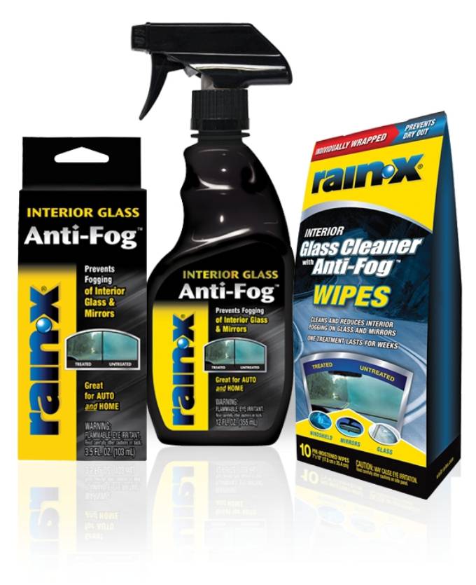

    On another note, daily driving in the rain*****s with no defroster.

  19. Peanut 1959
    Joined: Oct 11, 2008
    Posts: 2,187
    Peanut 1959
    I don't have any personal experience with the product, but maybe this would help?
  20. vtwhead
    Joined: Oct 20, 2008
    Posts: 5,298
    vtwhead
    good stuff^^^^^^^^^^^^^^^^^used it my 37 years ago.
    So why is the defroster not working?
    Peanut 1959 likes this.

    That sounds amazing. I’ll look into that!
