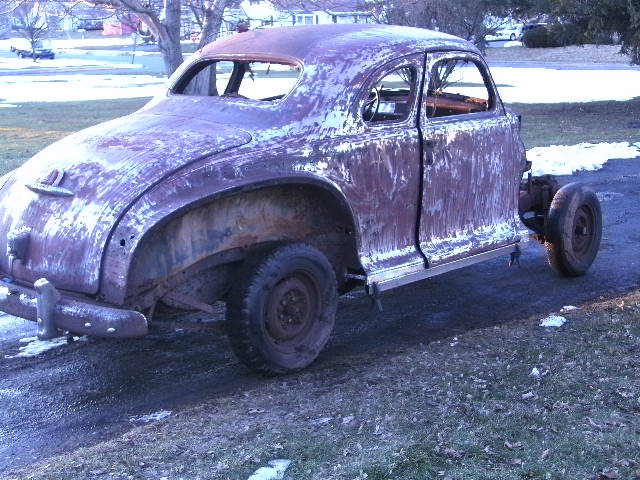

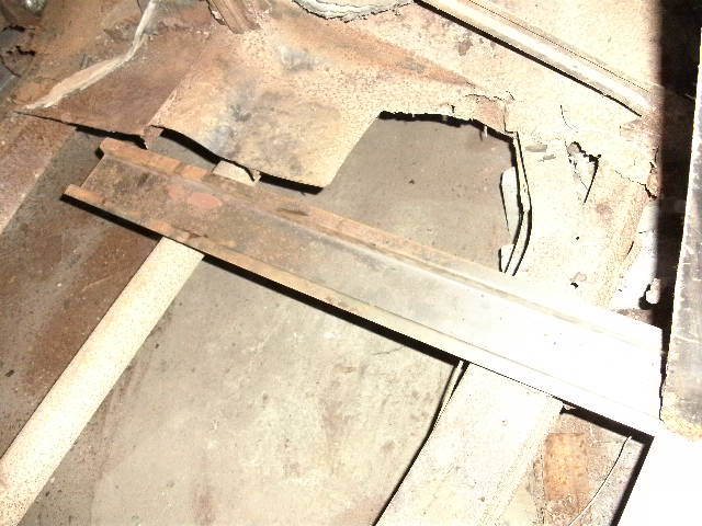

    with the snow here didnt get time to hang out in the garage today but did just ran out and snapped a few pics, of course camera was going dead
    you can see i took out what was left of the front floor section. you can see like a piece of track like-looking metal i will be using for my new floor supports once i get my rockers from the machine shop and installed. also you will notice the area i started taking the paint off with a paperwheel on the grinder. i will be removeing whats left of the rain gutters and welding 1/4" roundbar to fill the gap

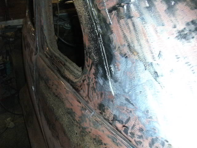

    igot the rest of the black paint off the driverside, all but the pass. door windows out and started rilling in where the rain gutter was

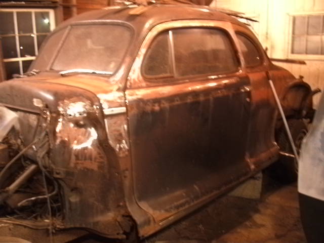

    from Hamburg Pa
    well i didnt want to sit inside all day with the all this freaking snow around here, so I dug out a path to the garage and made some progress on getting the paint off the car, i have about 1/2 the roof and alittle onthe trunklid yet, amazed i didnt hit any previuos body work or lead, but its looking better compared to when i 1st brought the car home. will get pics tomorrow

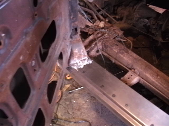

    also had a piece made up for an inner rocker. i did get the rocker tacked in place and also got a piece tacked in on the lower 1/4 just about the rocker will get pics later
    outer
    inner
    both together

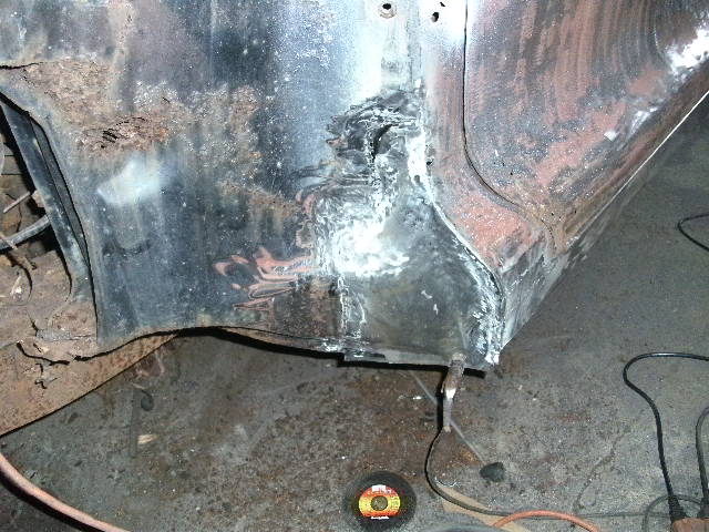

    its alittle slow going. only getting a few hours here and there in the garage. got the lower 1/4 and cowl to rocker welded up along with the lower cowl area

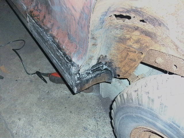

    some update pics. driverside rocker is all about in. sitll have a alittle here to get fine tuned but cando that after i have the other side in and body off the chassis

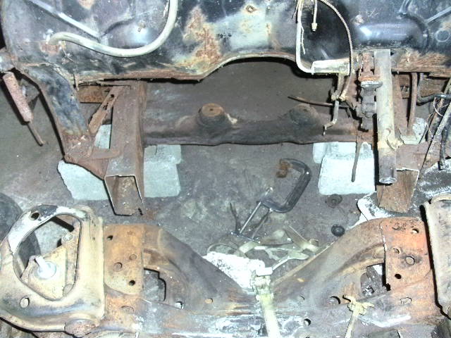

    from Hamburg Pa

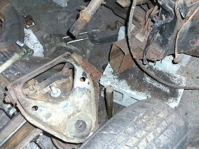

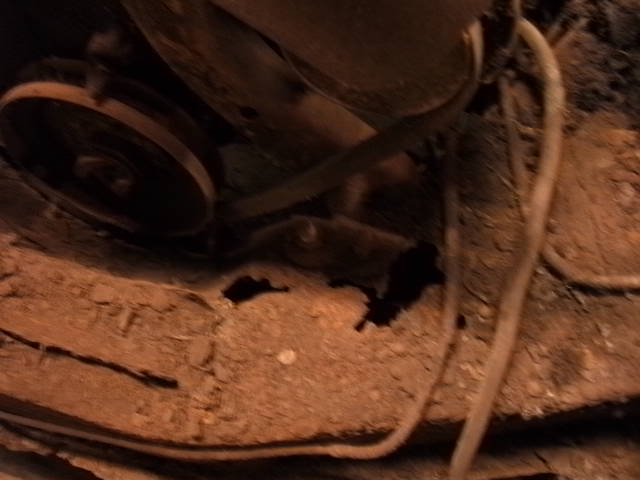

    ok finally got some time to mess with the car this evening. the freaking snow was holding me. got the m/t out and got he car turned around. as you see in the pics the front crossmember and frame passengerside rail back a few inches is rusted out badly. so i will be clipping the front from a 98 s-10, getting the whole frame cheap. so after i cleaned up my mess fromunder the car i got back in the garage and cut off the front suspension off.(will get more pics tomorrow)

    from Hamburg Pa
    been busy with other things the past week, had to scratched the s-10 clip as the guy changed his mind on selling now. so i came across (i know) a pacer clip, hey it was cheap and i can use the original wheels on the front. now i did narrow it 4" which keeps real close to stock tract width, and going to use a pinto rack which i picked up today. good thing is the pinto tie rods ends match perfectly to the amc. have to double ck but i think i can use rotors and spindles from a hornet which mite even bring the wheels in alittle more. i still have to weld some plate on the clip tomorrow for extra strength and cut off some of the extra metal off the clip that i dont need, but will reenforce it up with in some places. once all thats done i will start on the chassis. pics to come soon
