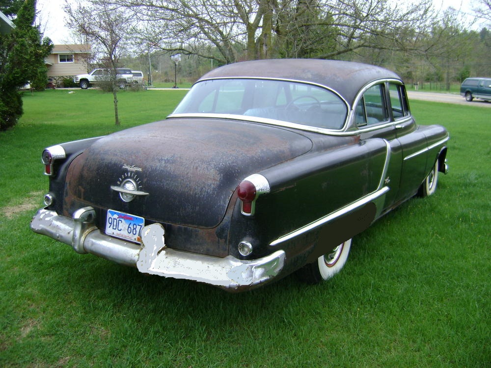

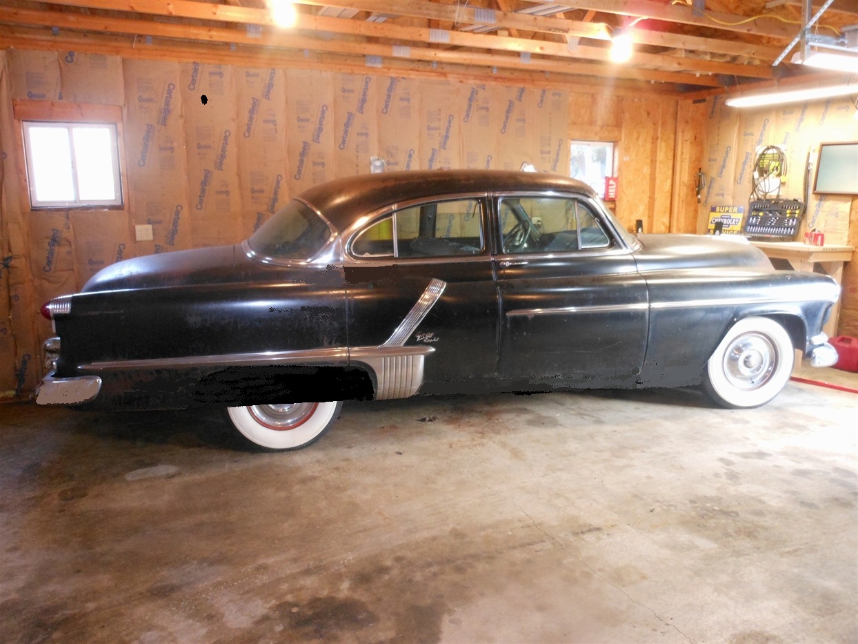

    You did an awesome job of matching that patia. Mine is similar, but of course the surface is rough. I was considering lightly sanding it and spraying with a flat clear to preserve it. This picture has some Photoshopping and the second one is original.
    Tom
    Tom
  7. plumfat40
    Joined: Jul 21, 2008
    Posts: 324
    plumfat40
    from colorado
    I like it, it is pretty dry climate here so I didnt put any type of clear. I would be afraid of adhesion . Looks good though

    Here is the original.
    Tom
