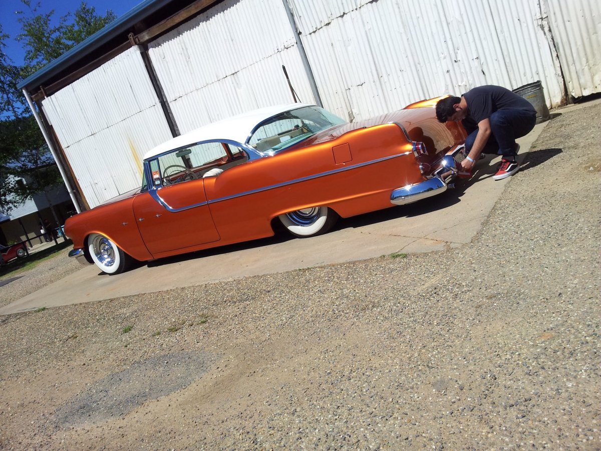

    I am going to try a suede black on the body. A bit more gloss and depth than matt black.
    Its black already but that was a rush job from the seller. I will be putting my own mix (Australian jeep colour Mango Tango with a small amount of gold pearl added) on the roof with a bit of lace.
    I like the lace idea but trying to decide on the final layout is a bit of a challenge.
    I am also going to try and rub the chrome to give it a matt look rather than shiny (except for the bumpers)
    I was surprised to see the main man (*****in rat fink)who owns the Pontiac project car looks a hell of a lot like myself when I was younger.
    The car gives me a rough idea of what my roof will be similar to.
    The pics attached. The roof will be a similar colour to the gold and white Pontiac and the base is going to be similar to the chev

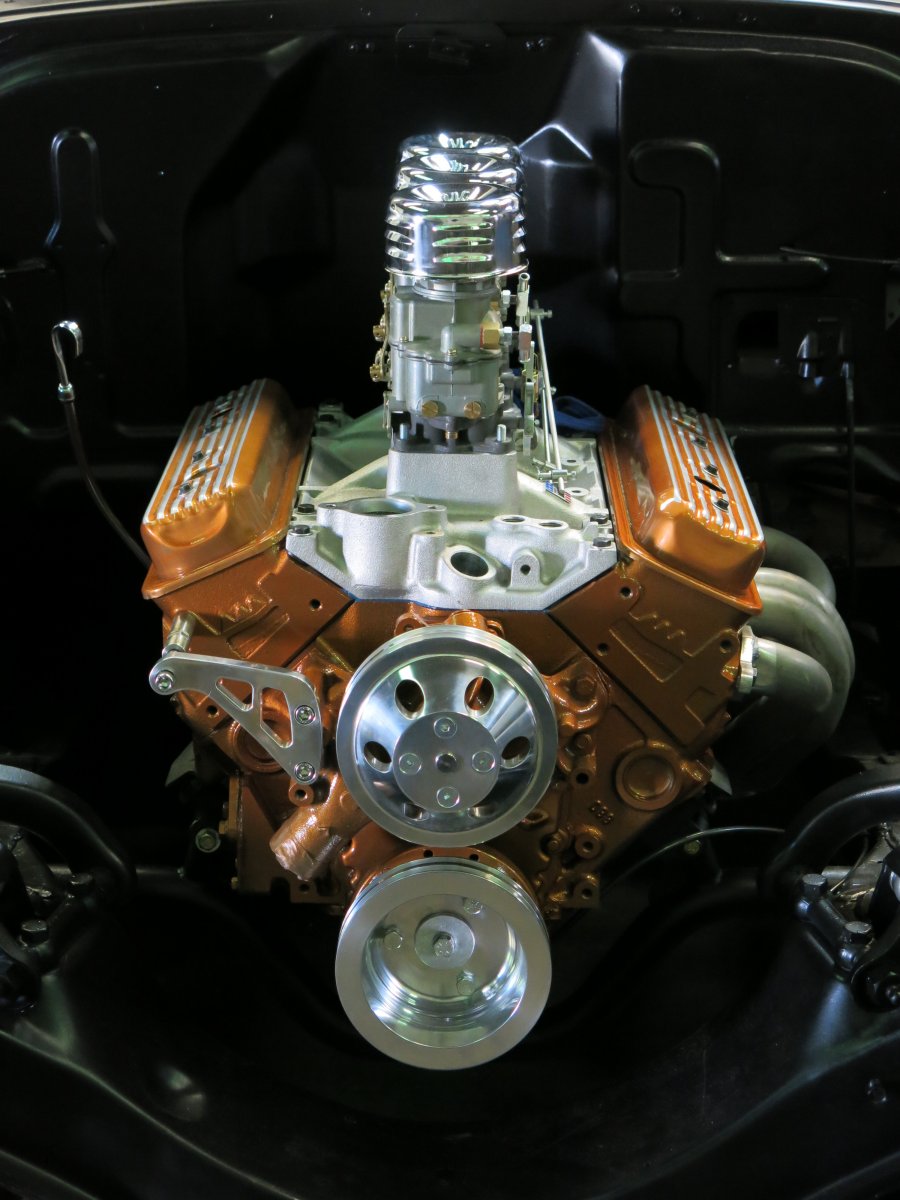

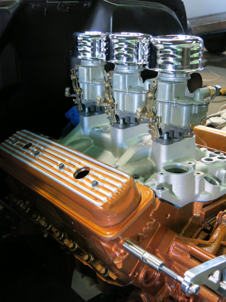

    Last year I made a very short post that I bought a 1955 287 V8. Since June 2015 I've been working on the engine to prepare it for a swap into my '54. Time for some pictures.
    First thing -- pull the intake, valley cover, & oil pan to clean this thing out.
    The timing chain had so much slack it was scary. Most catalogs will tell you that a 1955 timing set is out of production, but it turns out any Pontiac timing set will fit. This was replaced with a basic Cloyes timing set.
    After cleaning, I put the motor back together to run it. There is some fresh paint on the motor---I painted the valley cover and the bottom of the intake while the engine was apart.

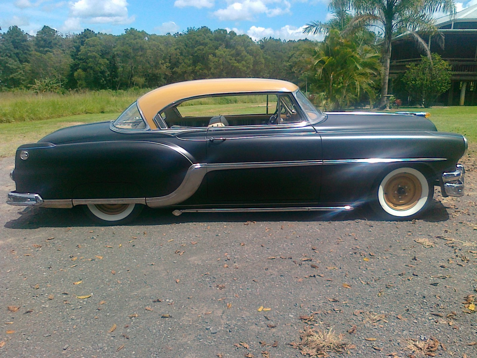

  26. GMAN55
    Joined: Jul 18, 2015
    Posts: 11
    GMAN55
    Looks like a nice old school motor.
    I have trimmed mine a little bit and by installing the 350 with a turbo 700 for the over ride and economical
    The old girl will look like a bit of a sleeper. the only thing to give it away will be the gold roof.
    The next surprise will be the view when they open the hood.
    It is almost ready to fire up.
    The roof colour is going to change from the practice coat.
    It will end up the same as the motor.
