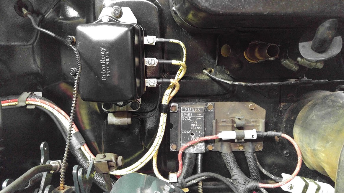

    If I am wrong, please disregard the following:
    If the white fuse holder looking thing is one of those plastic twist together fuse holders with a spring inside, I would replace it with a fuse holder that does not have pressure on it from a spring. Many 12V electronics come with that type of fuse holder. We have seen so many fail that they are banned from being installed where I work. Usually, they are intended for interior use. I would think their life would be shorter under the hood. Maybe that style is intended for that car. IDK.

    That is exactly what that is. If you look at the clip the fuse holder is in, there were originally 2 fuse holders of this type clipped to the firewall.

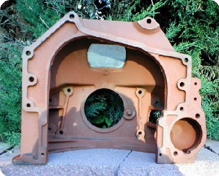

    Most excellent! You said you're unhappy with the 3.08 rear gear because the car is a slug off the line. Well, that old select-a-shift 3 speed trans was a carry-over from the 30s and GM never changed to a better 1st gear ratio when they put it in 50s cars. The old 30s roads called for 50-55 mph driving as so GM put in rear gears in the 4.00s...an optional 3.90 gear was called the "economy" gear. These low rear gears worked ok with that high geared 1st gear but when GM began using 3.00s gears in the 50s, that trans was obsolete with it's high 1st gear. No wonder you're having problems with slipping the clutch in 1st gear to get going. I found all this stuff out when I had my 57 Pontiac with factory 3 speed, last year for that selector trans. I fought mine through 4 busted transmissions and 4 smoked clutches [3.63 rear gear] until I finally admitted defeat! I couldn't fight that super high 1st gear and bought a muncie wide ratio 4 speed. Smartest thing I ever did! This swap made my car a completely different car...was easy to drive in town with the transmission's 2.64 1st gear.
    I know you are trying to keep all the parts original looking but if you use an early looking shift handle, nobody but you would know you had a newer trans. All it takes is a 58-60 bell housing [photo] and you can even reuse your rear motor mounts. Keep your present flywheel/clutch/starter and mounts. They all switch over.
    Hell, you could even bolt a T-5 to the 58-60 bell housing for overdrive if you wanted to but with your 3.08 rear gear a cheap saginaw 4 speed would work perfectly...I'd even consider a 3 ring saginaw 4 speed....commonly known as the vega trans as it has a 3.50 first gear! These are strong enough for your 55 pontiac motor and the 1st gear will make you smile...and it'll bolt up to your new 58-60 bell housing with zero h***le.
    Think about it. You should be able to sell the 6 bolt selector trans and shifter for enough to buy a vega trans and Hurst shifter [bolt-on handle] off craigs list.
    I've even used a hurst 3 speed shifter on the saginaw 4 speed when I didn't have the scratch to buy a 4 speed shifter...hooked reverse lever up to a separate handle. This worked as a great theft deterent when I'd engage 3rd and reverse at the same time, locking the trans so the car wouldn't move.

    Believe me, the 58-60 bellhousing was my first choice. More transmission options can never be a bad thing. But I haven't seen them for sale under $1200. I can buy 6 of these three-speeds for that.
