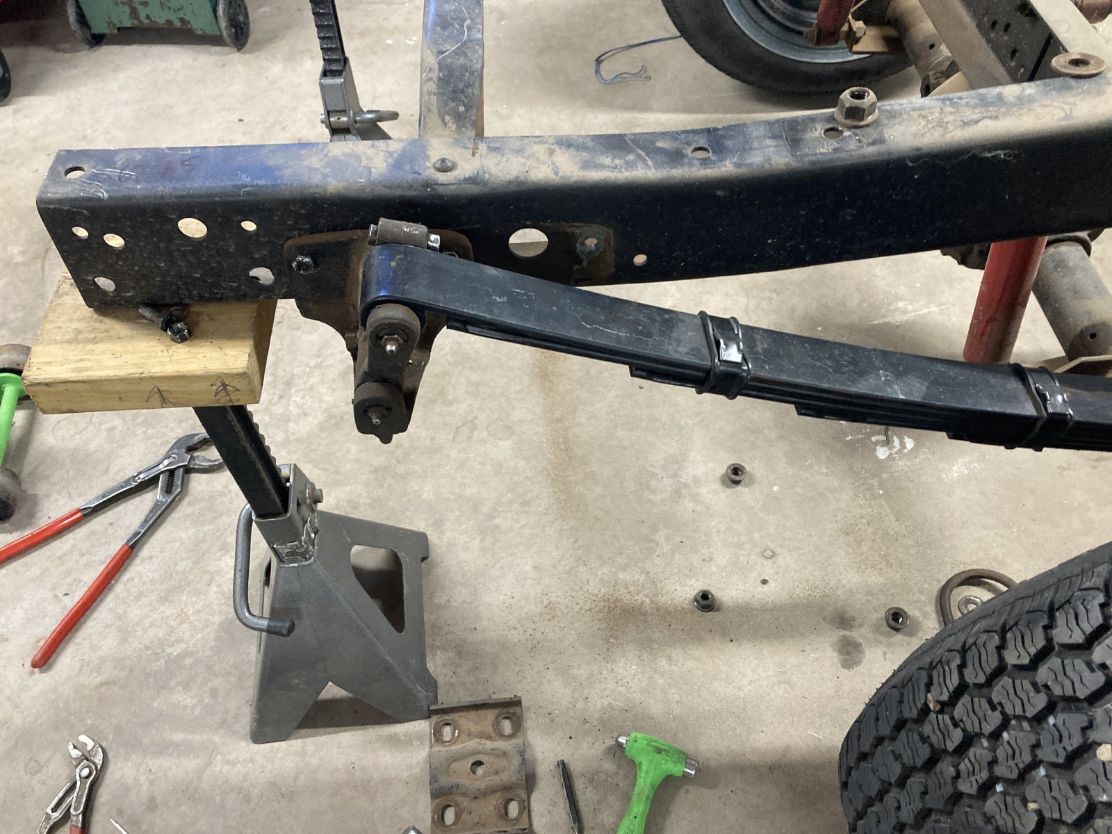

    Here is the deal on the 54 vs 55-56 springs: Almost two years ago I purchased new springs from Speedway. The sent the correct springs for the front but they sent the longer rear springs. After checking it out I was able to use the longer 55-56 springs by using the stock front spring mount and simply moving the rear mount back.
    I was pleasantly surprised in that I could use the original rear side frame hole for the front and then there was an existing hole for the new rear hole as well as an existing bottom hole. I only had to drill one new frame hole on the bottom and everything works fine. The old spring on the driver side shows the rear bolt in relation to the crossmember. The new, longer spring is shown on the passenger side with the spring hanger moved back.

    The last post only showed the passenger side, so here is the old spring and rear mount location on the driver side. Its hard for us old guys to make all this technology work.

    Another frustrating day. I got the spring deal worked out on the back end and moved on to the front. It took a bit to realize there is a difference from the pin to the eyes. After struggling with the one side I got it figured out and it was a snap for the other side.
    The Posie reverse eye springs have the eye reversed on one side only. The reversed eye goes to the back of the truck. Put the rear pin in first, then the front pin and lift the axle back to the spring. It takes a slight bit of jiggling and the spring pin drops in the axle and all is good.

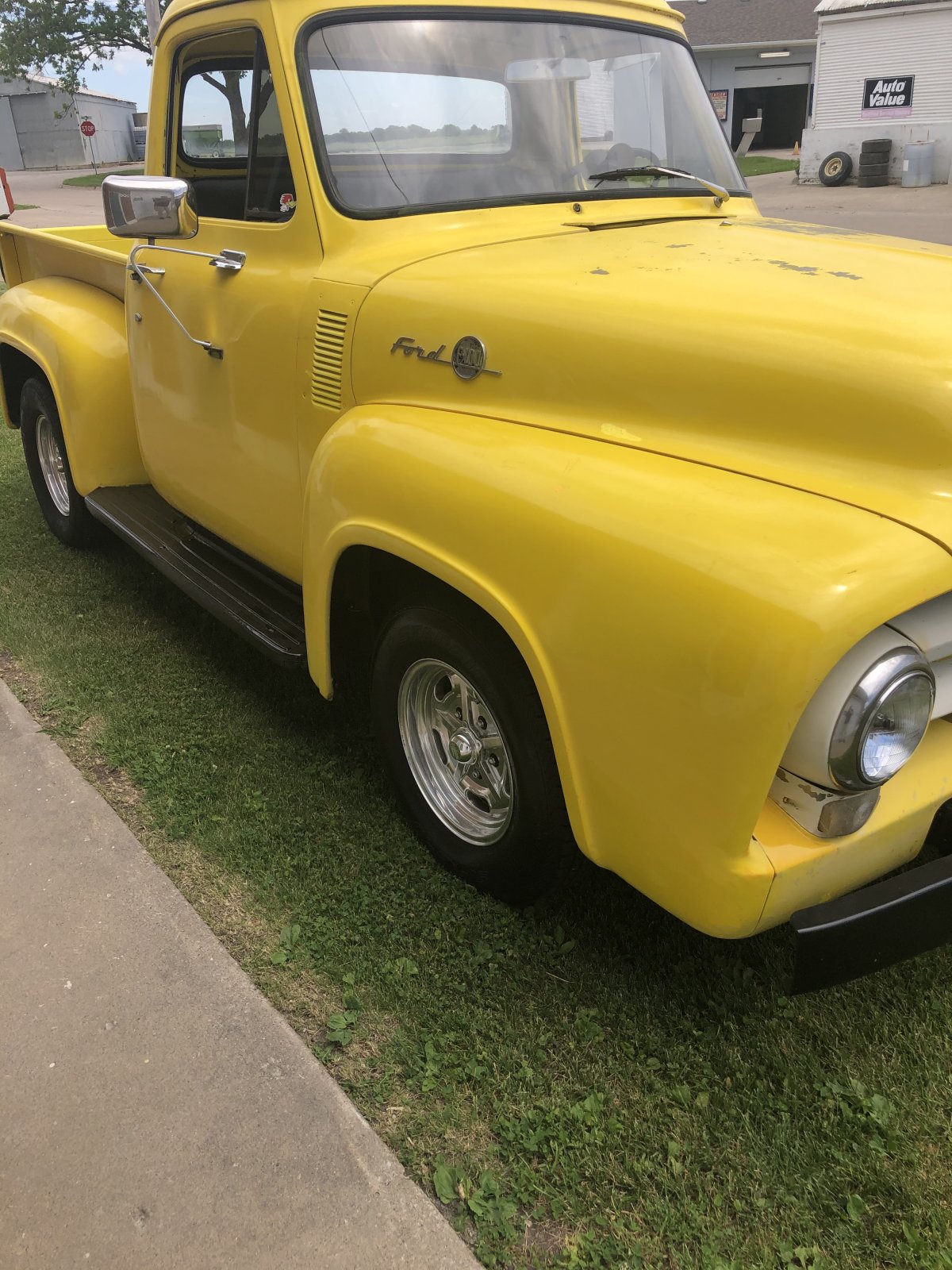

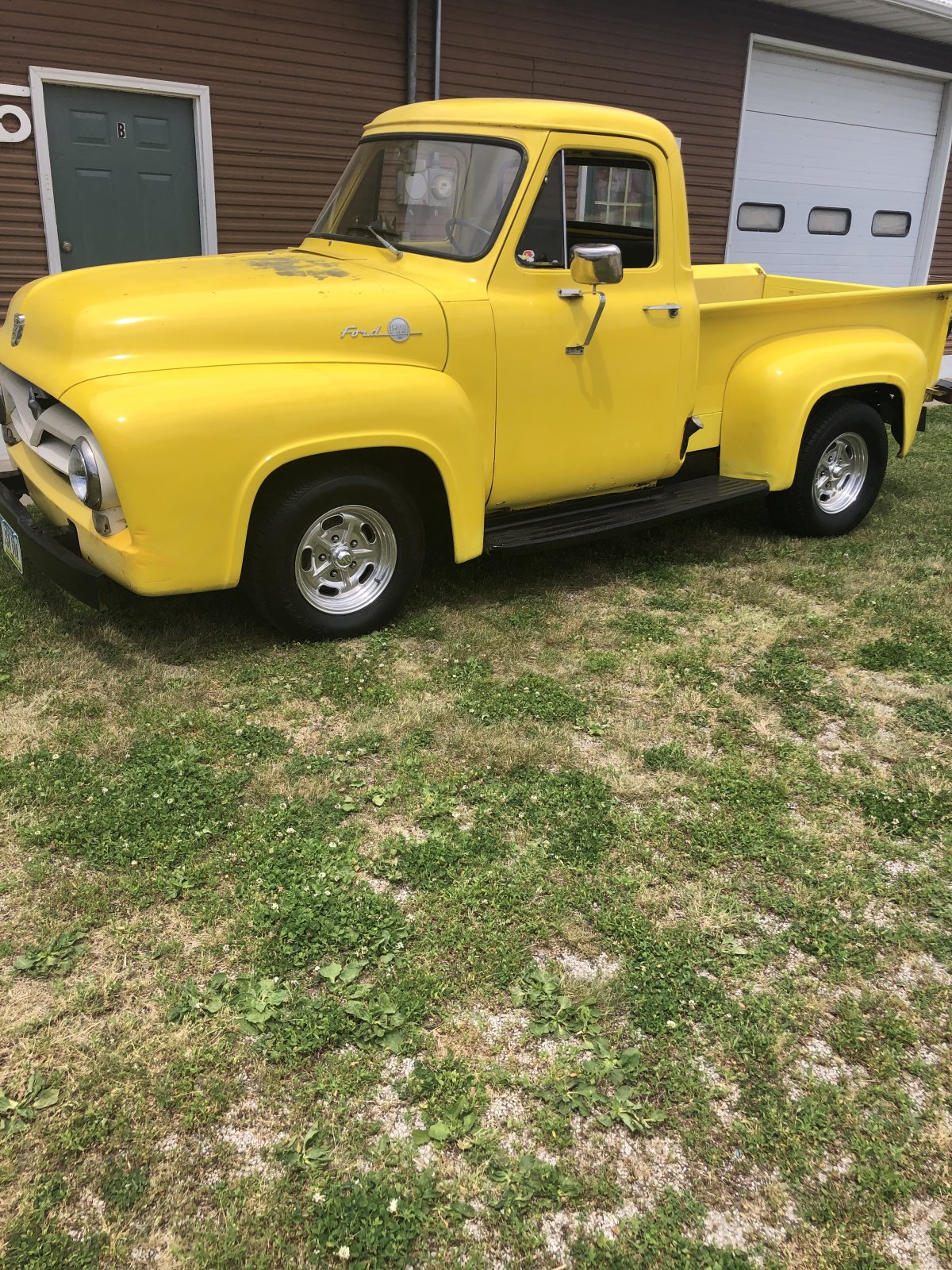

    Here’s a little inspiration to keep going ….
    My 55.
    8D2AAE5E-8BB1-401E-9BD6-165A15C99BC9.jpeg 2B41C8AD-E576-4EB5-AE32-B4A4725ED4B8.jpeg FE2285E0-A1F9-4253-B33D-24BD48F5CFA7.jpeg

    Keep it simple.
    No C-Vic or MII
    I run stock brakes, suspension.
    A little rake….larger rear tire, smaller on the front.
    Stock Arm Strong steering and stock brakes, just give yourself a little distance to stop.
    The only thing I would do with mine is change from the tall 3:90 rear to something a little more of a cruiser gear -
    if I could find a 3:54 gear to fit the stock pumpkin.
    Hang in there - keep going.
