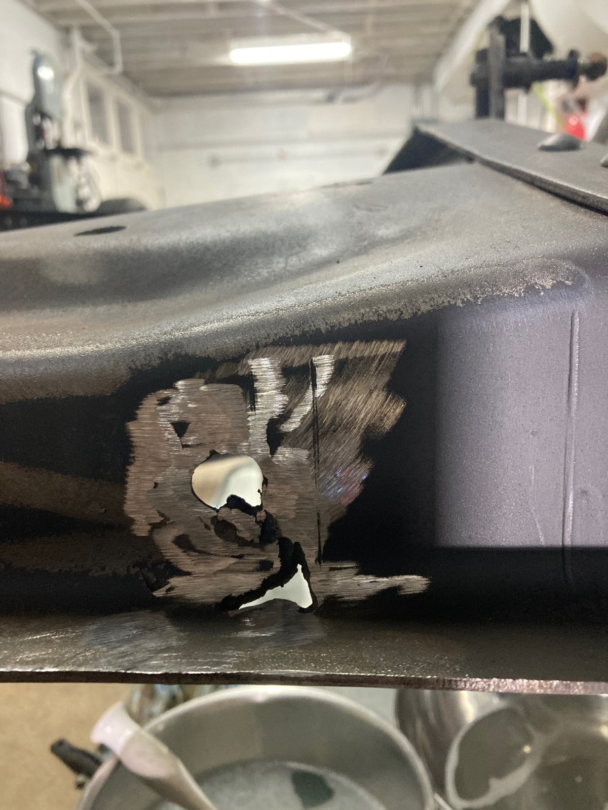

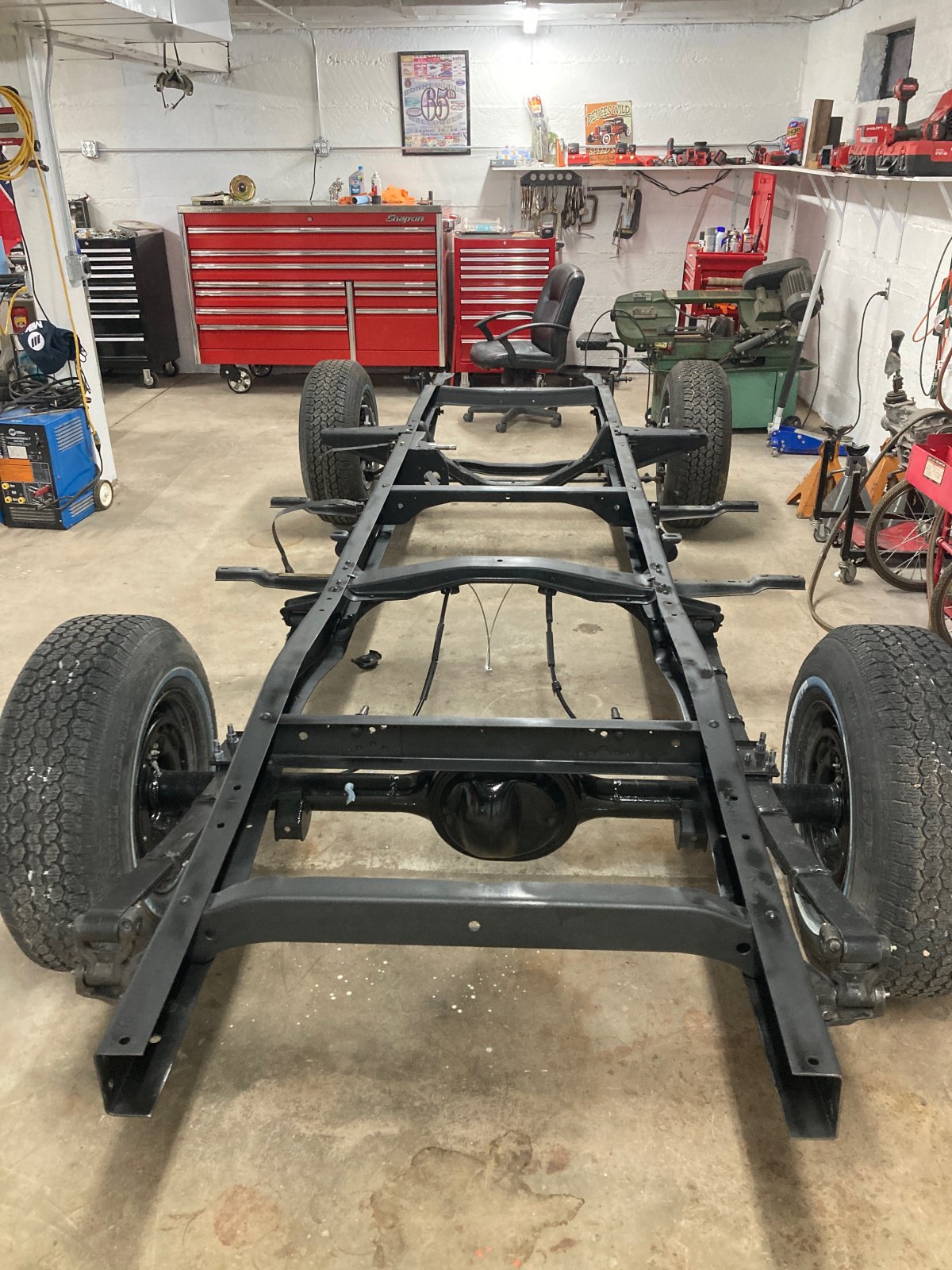

    I got a message on another site and was told these bolts were for an accessory cattle guard for the front. I never knew such a thing existed. I wont need that but I welded up the corners and restored the enlarged holes to original size. I also worked on about a half dozen holes that were enlarged with a torch. I got the frame cleaned up and painted tonight.
    My HAMB buddy Flyinandride has been using Rustoleum X2 Automotive Grade on his chassis and I gave it a try. I like the results. The frame had been cleaned up and painted by a PO but it needed some cleaning and touch up. I closed up the bad holes that were put in with a torch and have it painted.
    I'm close to being ready to mount the engine and trans into the frame. The plan is to get the rolling chassis with the engine it so I can break in the engine and make sure there isn't a problem with the cam and lifters. I'm spooked by all the bad reports on cams. I don't remember that ever being a problem back in the HAMB days. IMG_0622.jpg IMG_0623.jpg

  10. patsurf
    Joined: Jan 18, 2018
    Posts: 2,123
    patsurf
    at least look for the front guard before welding those holes up...-be different?!!
