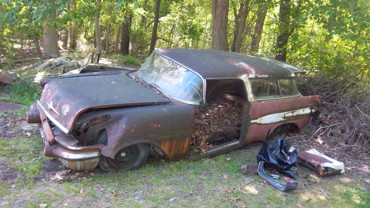

    Well, I got the Safari. Wasn't quite as "clean" as described, but it DOES have all the trim I need, the interior moldings, back seat, and gl***! Dis***embling it now, hope that the metal behind the stainless is in good shape.
    Big "Thank You" to Vic Collins and his brother Ed, for digging this out and bringing it to the shop, and to Lou Callisibetta for letting go of this hard to find car!

    I gotta ask, what the heck is the tow vehicle in the first photo? , I can't figure it out. HRP
  14. Sancho
    Joined: Apr 24, 2001
    Posts: 5,036
    Sancho
    Did you read the post? LOL
    "Another good friend, Dave Quail, helped me get the car back to my shop, with his 49 Cadillac Limo, mounted on a Ford F350 Ch***is, running a Caddy engine!"

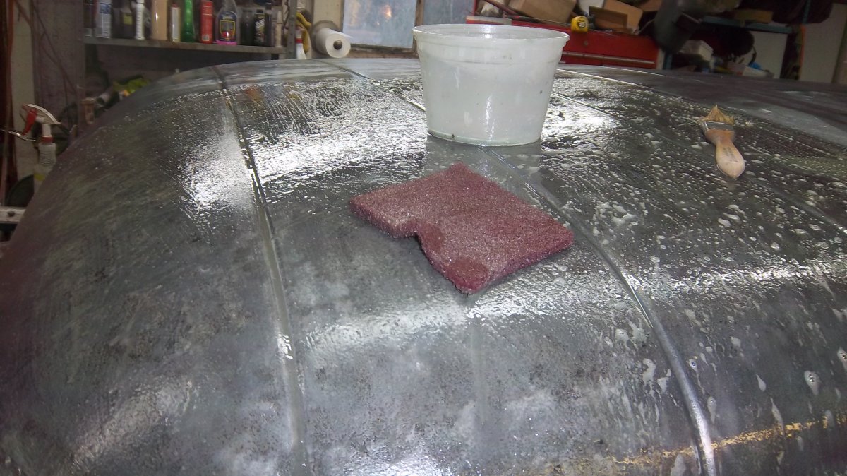

    Now on to the build. I finished up the roof, except for some pinholes in the rear corners. Fabricated the area around the tail gate. Finished most of the window channel replacement.

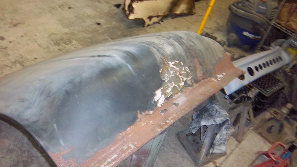

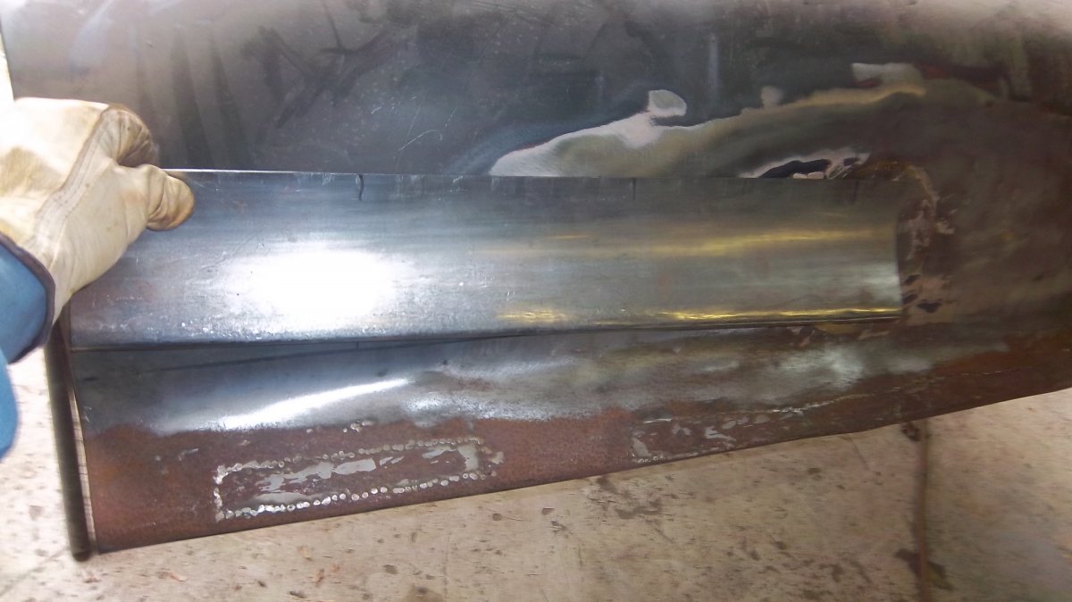

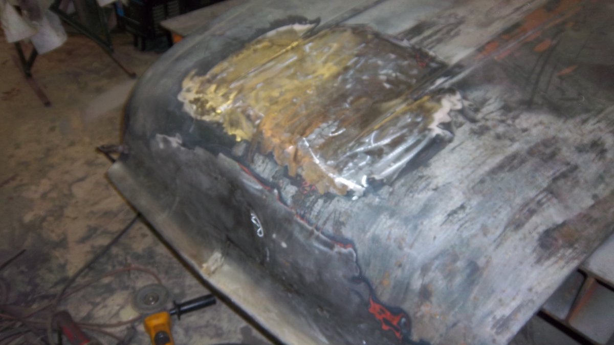

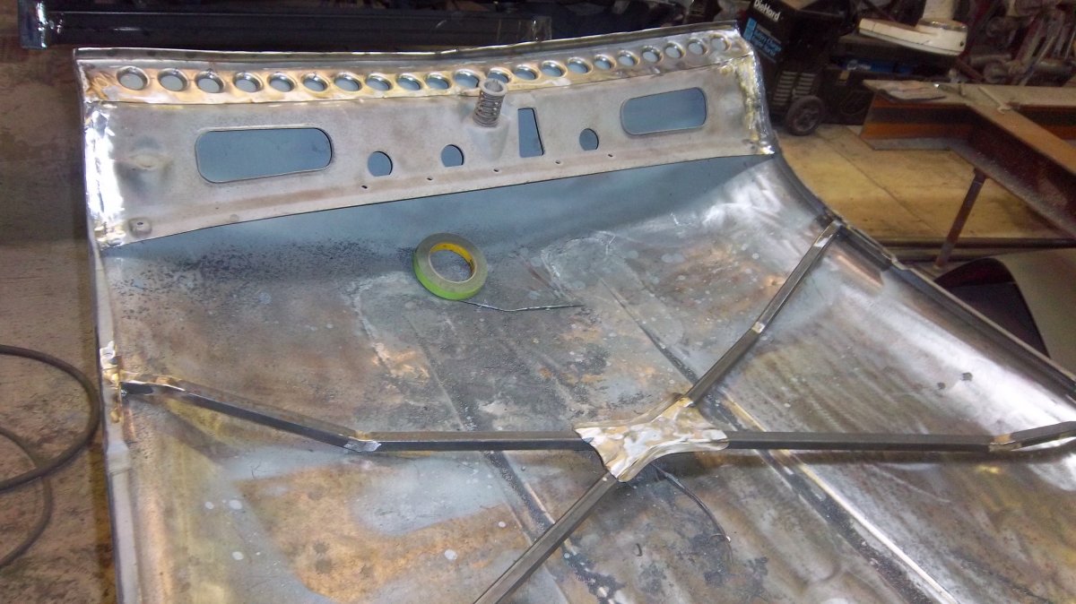

    Finished up the rust repair on the hood. My buddy with the chopped 54 Plymouth, Kenny, helped out by punching and belling the inner support of the hood. I also added some tubing for support, since I took off the 'hood bird' that had support rods bolted to it. May replace the square tubing with round sometime later. 100_1324.JPG 100_1341.JPG KIMG0053.JPG

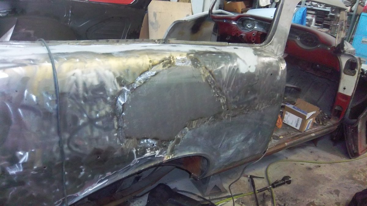

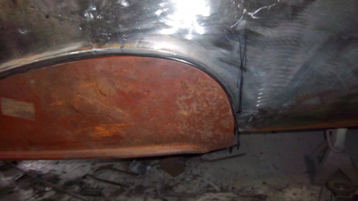

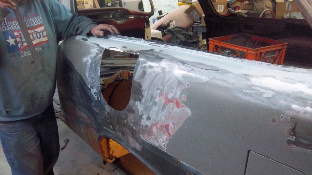

    Back to bodywork. Both quarters had the usual Olds rot up at the top of the wheel well inners. They had been patched once before. Cut them out and redid them. There was also collision damage on both sides. Drivers side I worked out. Pas. side I cut out and replaced, as it was so bad. Also welded up the gas filler door.

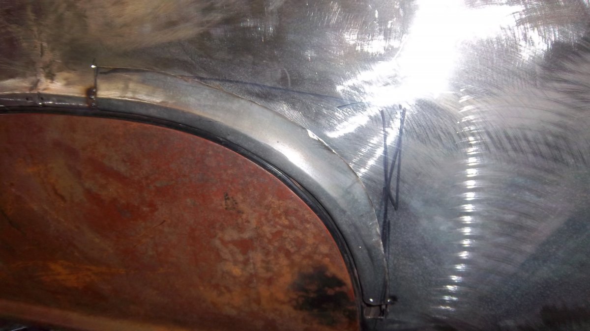

    The PO used a 56 Chevy patch panel to fix the rust on the p***. side. He didn't car about the shape of the wheel well opening, as he was running bubble skirts. I picked up a set of new Foxcrafts at Carlisle, so I had to reshape the openings to fit the Olds skirts.

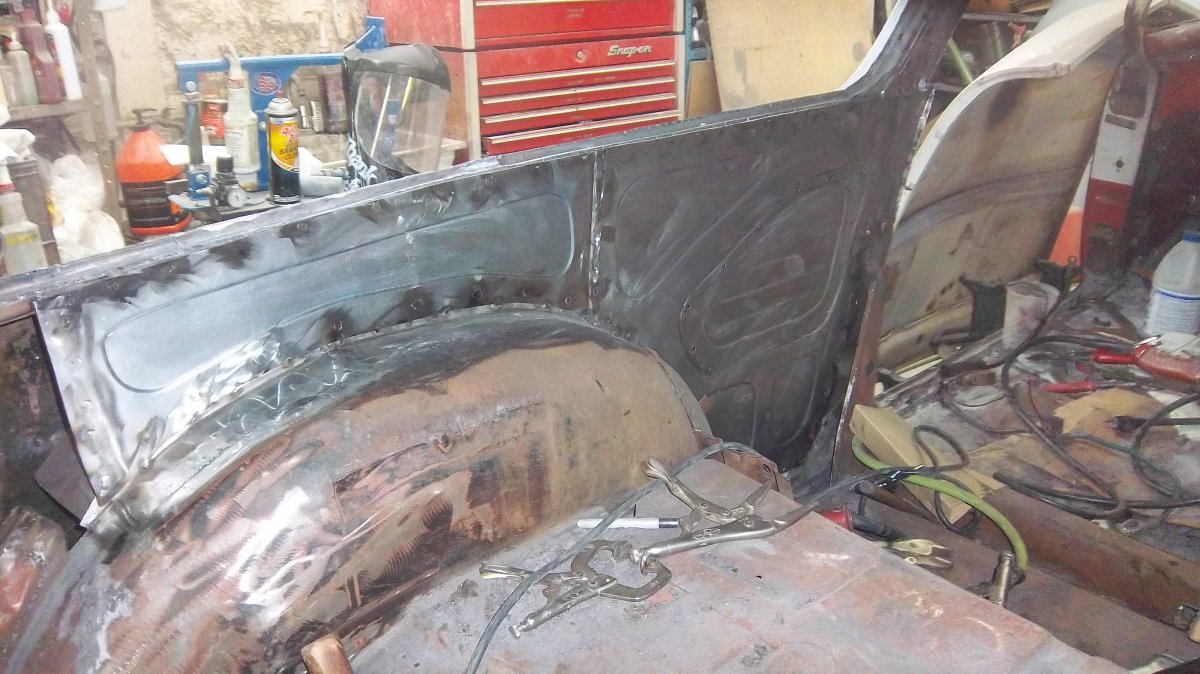

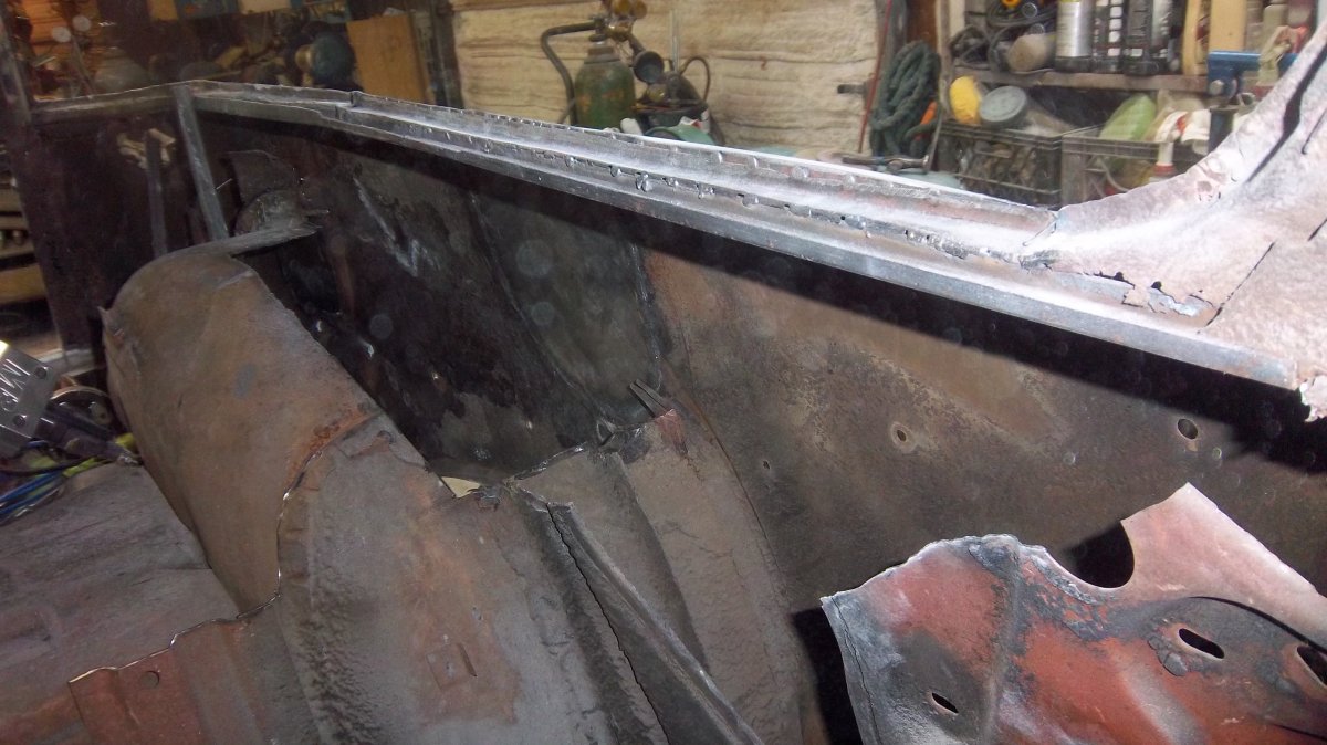

    The extensive work on the quarters, plus rust on the inner wheel wells, made me cut out the interior panels. Now I could access the quarters for hammer and dolly work. Plus, the hardtop interior panels had different structure than a wagon's, so I took the opportunity to make my own, to match up with the Nomad's quarter windows. While I didn't need an access door for the quarter window any more, I figured I would for the side trim.

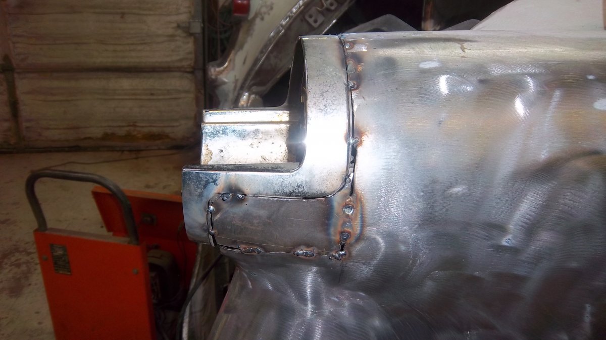

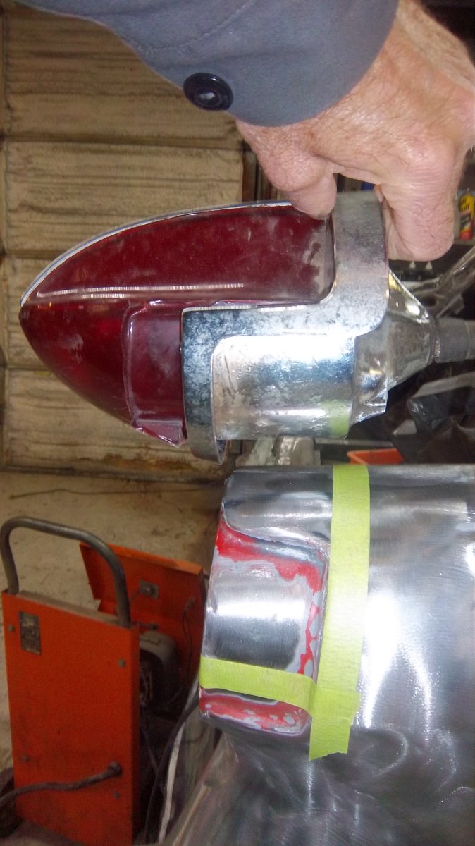

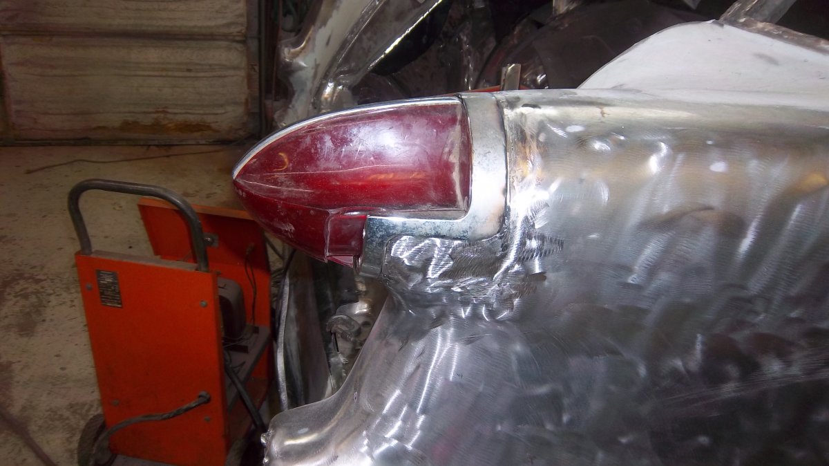

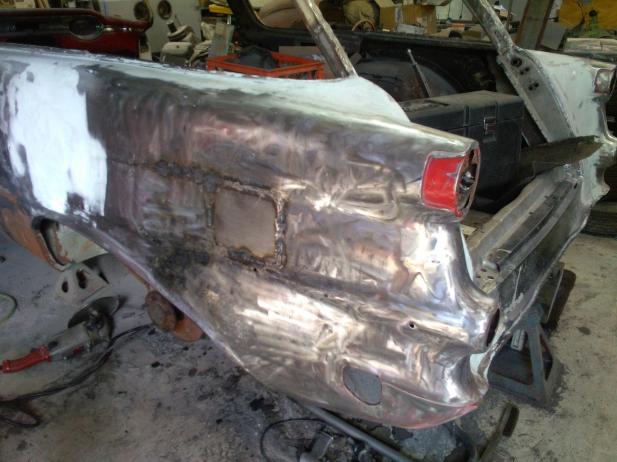

    I was lucky that the PO had found a set of '98' tail lights, way back when. Since the Nomad was the top line trim package on the Chevy, I hoped to make my Olds a '98', as well. The tails are very different, so I got out the cut off tool and welder! Still looking for the '98' side trim, though!
    Originally I was going to just move the gas filler to the interior, but now I want to move it to behind the driver's tail light, so it isn't in the interior cabin. Gotta figure that one out!
