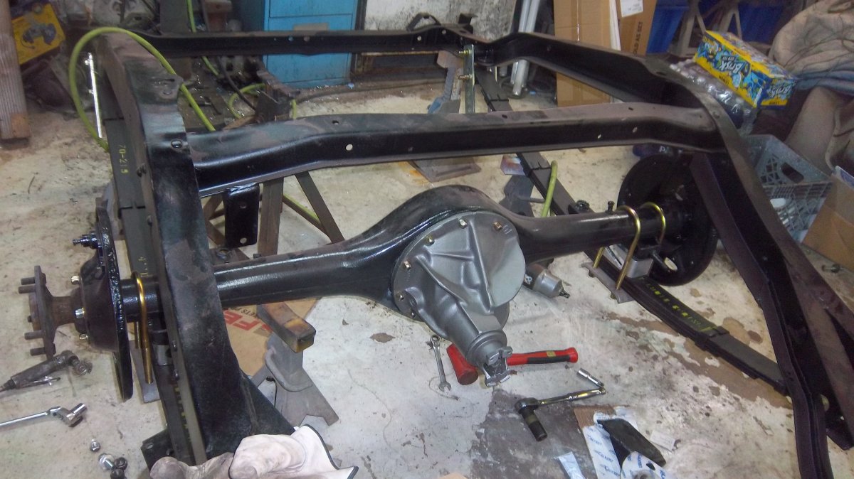

    Blasted the frame, primed with Master Series silver, and a couple coats of their gloss black. Didn't like the glossiness, so I sanded and covered it with SEM Hotrod Black, a satin urethane. Much better. Started the rebuild. I wanted to use the 76 Impala rear I got, but it was too wide. I really liked the 12 inch 'Police package' brakes, so I re-worked the backing plates from the Impala, to fit the Olds rear. A set of Jamco 4" drop leafs, 2 in. lowering blocks, 100_2151.JPG KYB gas shocks, and all grade 8 hardware

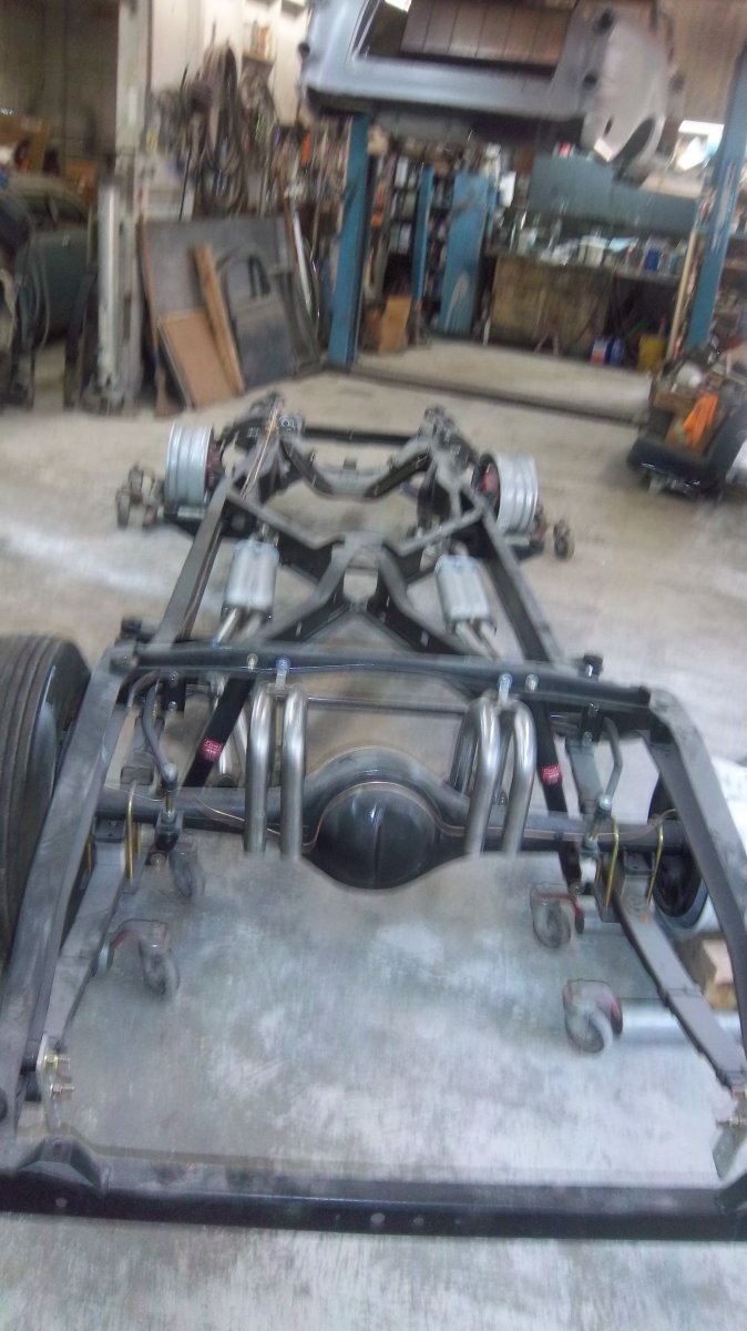

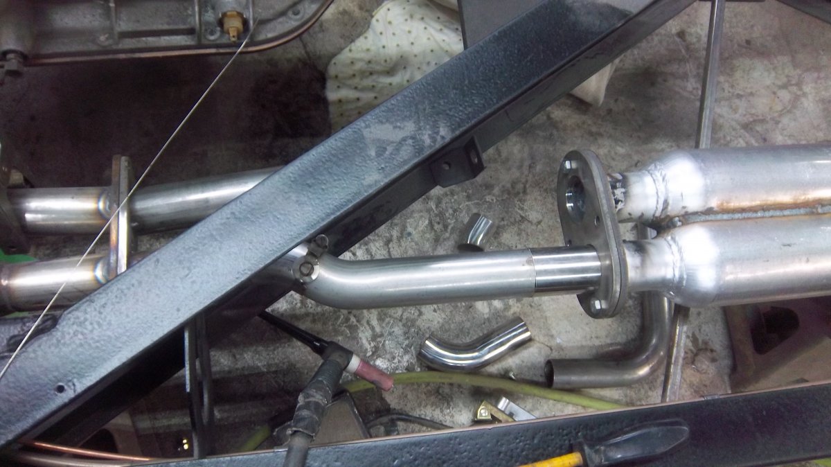

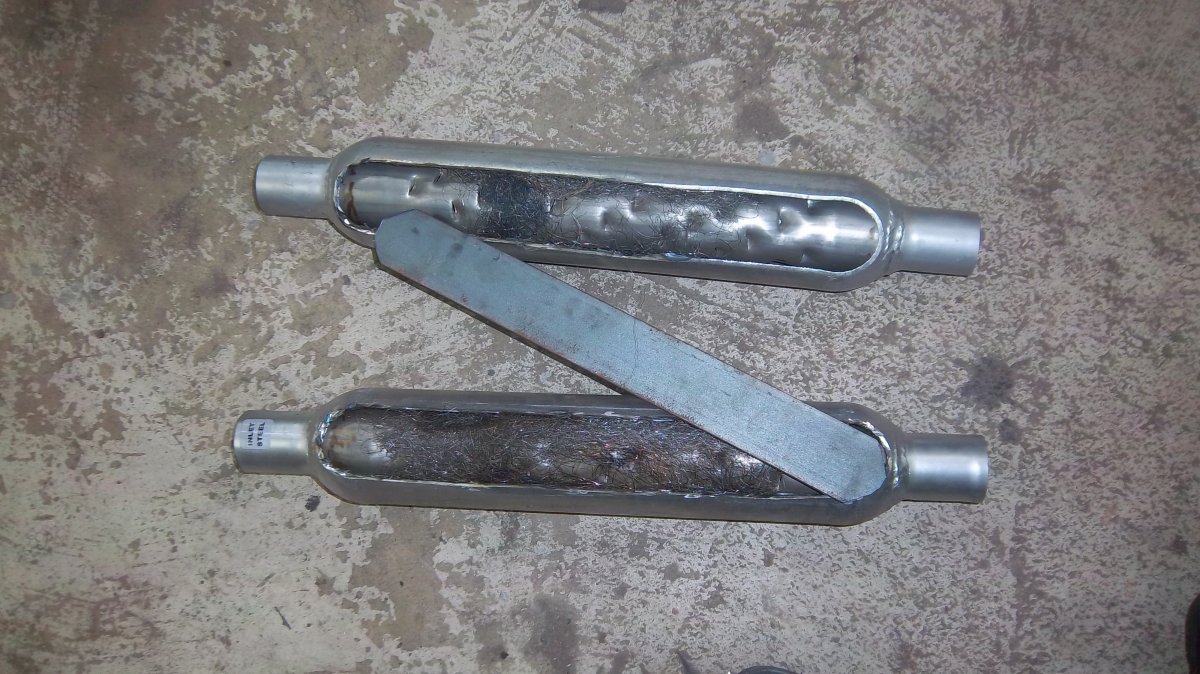

    Update: I got the chopped Lincoln to the point where I will try to sell it, so the Olds is coming back in the shop. In the meantime, in between cursing Henry Ford, I managed to get the complete front and rear end put together on the Olds ch***is. Put on KYB gas shocks, Addco rear swaybar, ran gas and brake lines, etc. But the big job was this:
    I had the idea that it might be really cool to upgrade the exhaust. Well, if duals are better than a single exhaust, then QUADS must be better than duals!
    I started with Ebay SS headers. Of course for a lowered car, they hung down too much, so first order was to shorten them by almost 2 inches. This caused interference with the oil filter, and A frame mounts, so cutting a replacing parts of the tubes were in order. I also wanted to pair up cylinders farthest apart in the firing order. One side worked out OK, but the other I cut one tube out completely, and reran it to match with the proper tube.
    Being a 50's custom guy, I love Brockman Mellowtone mufflers. I ordered 4 steel packs form them, and cut off 1/2" on each side, welded in a separation plate, then welded 2 together. Once in place, i used straight and mandrel bent tubing, as well as water jetted flanges (Thank you again for making these, Chappy444!), to put together the system. I had to widen the openings in the ch***is crossmember, to fit the side by side pipes. 1 3/4" tubing, with 1 inch spacing in between (that's why I had to cut the mufflers). One side is done, now I have to duplicate it on the other!
    I can't do the rest of it until I put the body back on, with the gas tank in place, but I can't wait to hear it!

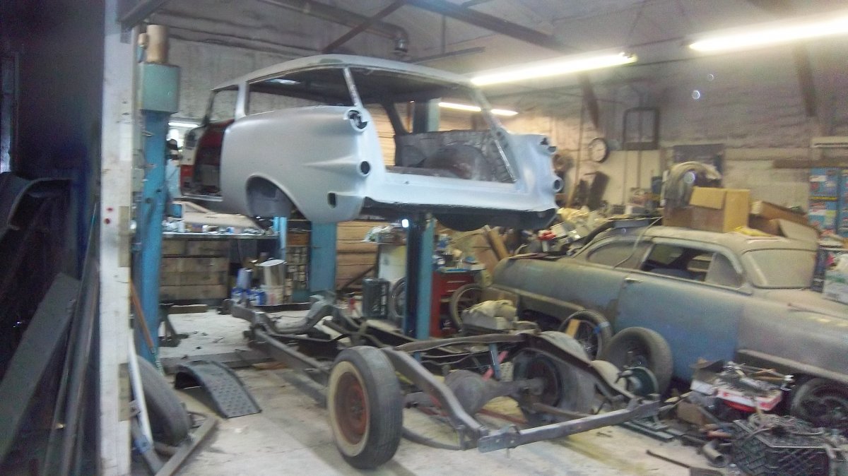

    100_2293.JPG 100_2262.JPG 100_2264.JPG 100_2271.JPG Well, having some other projects in the shop slows work on my own car, of course! I pushed the Lincoln back to the house garage, to brind the Olds body back in. Frame is just about finished. I have to cut out some gaskets for the exhaust system, and knock down the welds a bit. And, waiting (forever) for the parking brake cables to come in. Seems the "police package" 12 in. drums use a special cable, it doesn't have the usual 'snap in' mounting on the backing plate. It has a bolt on piece. Ordered it in July from both Rock Auto and Summit Racing, but they keep pushing off the shipping dates.
    The body is on the rotisserie, fixing the rust issues on the floor, building a body mount or 2. Then on to building a framework for the cargo area floor. Cutting out the spare tire well (as the tire would stick up into the flat area of the floor, laying the tire flat, using part of the old well area for the battery, and storage, and making a hinged floor to cover it all.
    I can't wait until the body goes back on the frame!

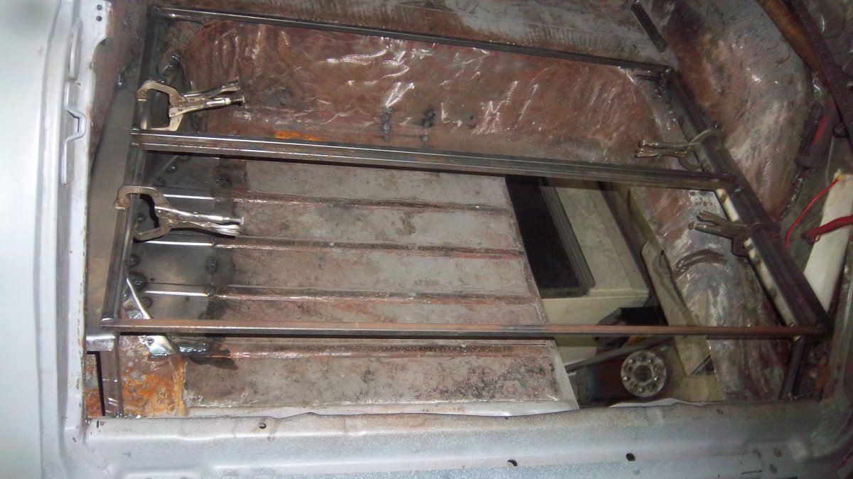

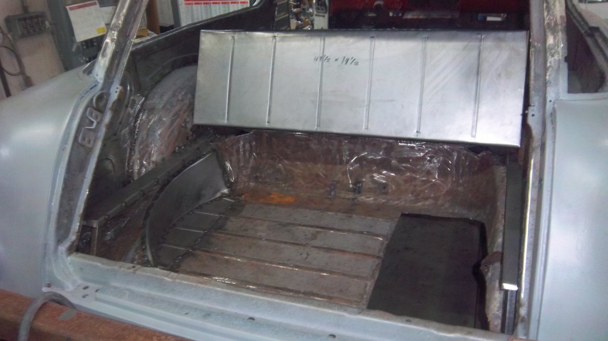

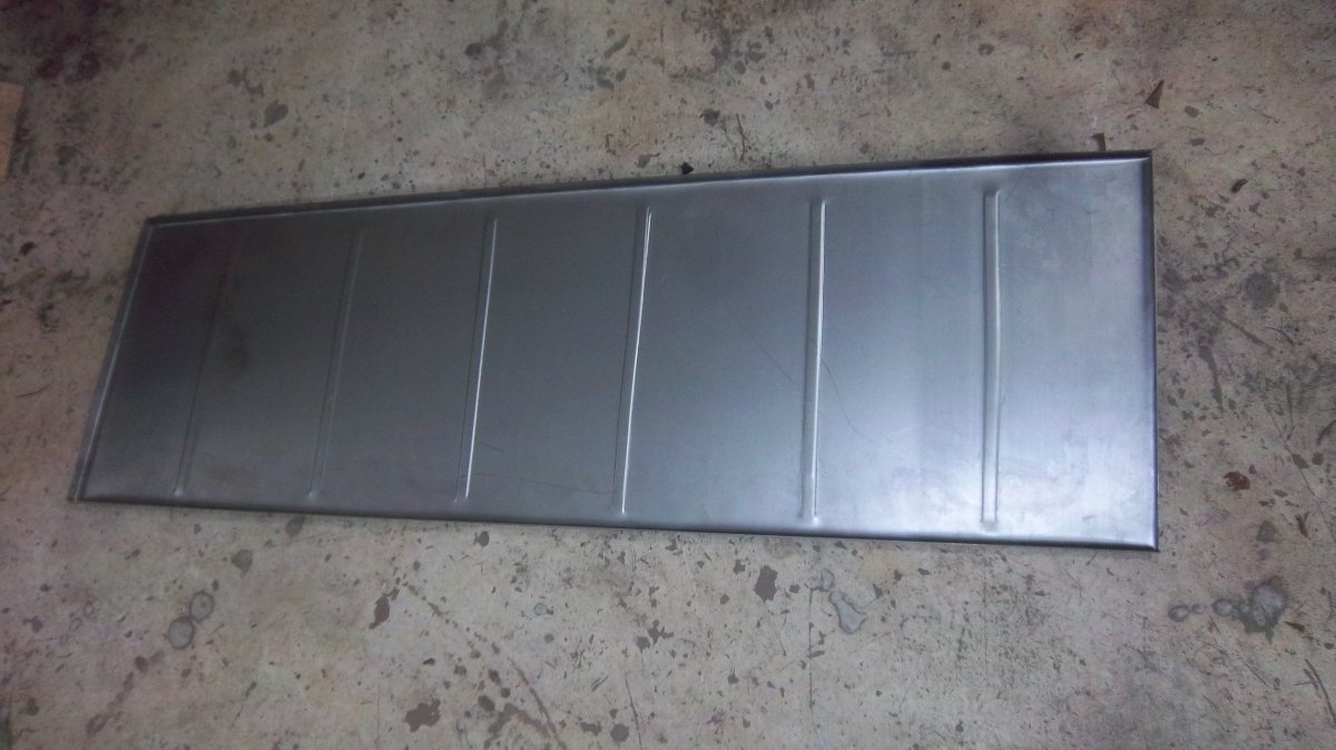

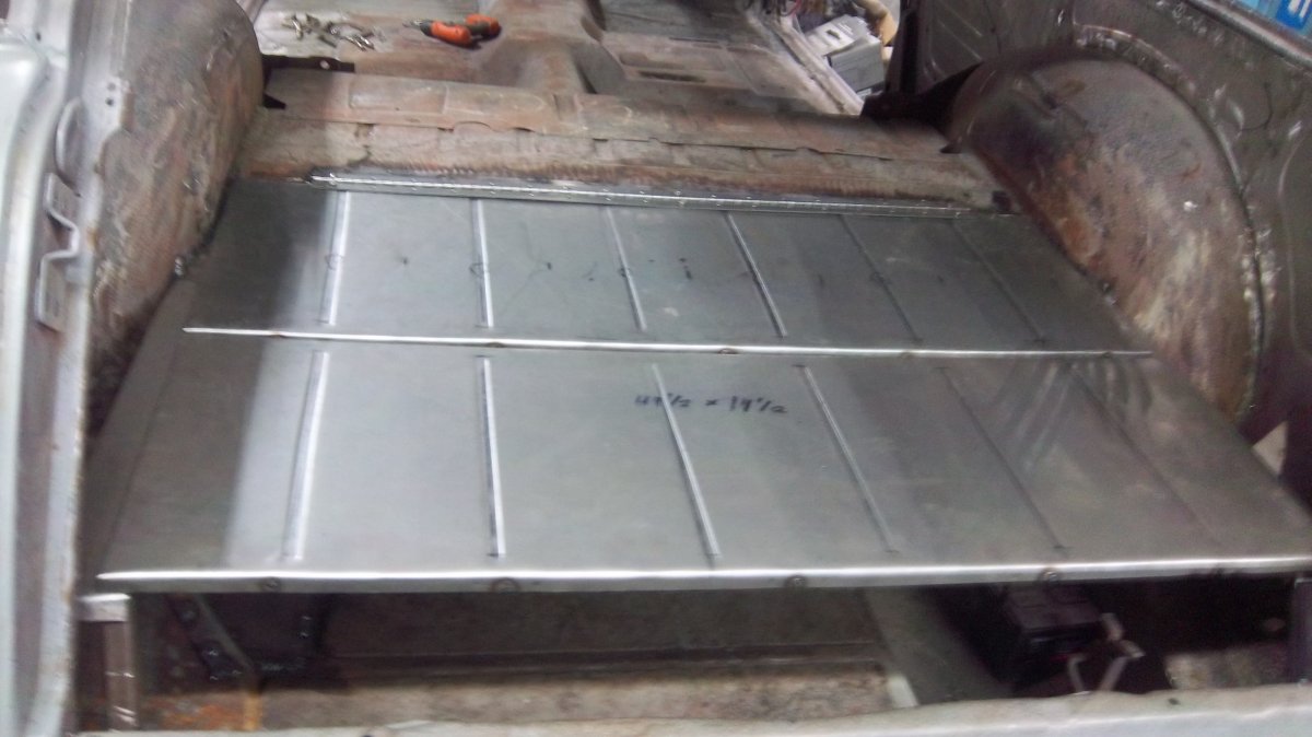

    While Glen is working on putting his engine together, I had some time on the Olds-Mad. I used some 3/4" square tubing to build a frame to support the cargo area floor. They used 1/2" tubing to frame the floor panels. Two of them, hinged to fold on each other. Rolled some beads in for support. Not sure what i will cover them with, but I'm leaning toward using a 50's design linoleum, with half round stainless rub strips, similar to the bars on the Nomad tailgate. Also working on making "pockets" out of fibergl*** for the area between the new cargo floor and the back of the quarter panel, for storage.
    The spare tire fits nicely, flat under the new cargo floor, and the old spare well will house the battery and probably a small tool box. 100_2307.JPG 100_2308.JPG 100_2312.JPG 100_2314.JPG

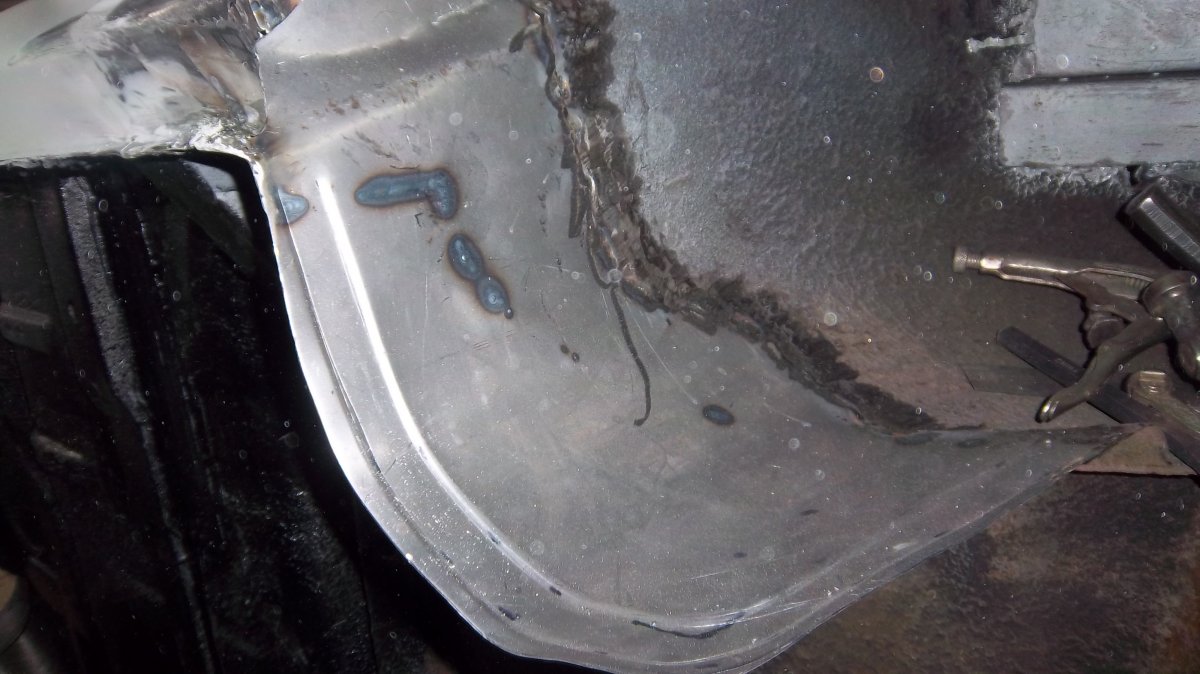

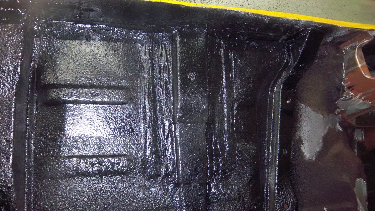

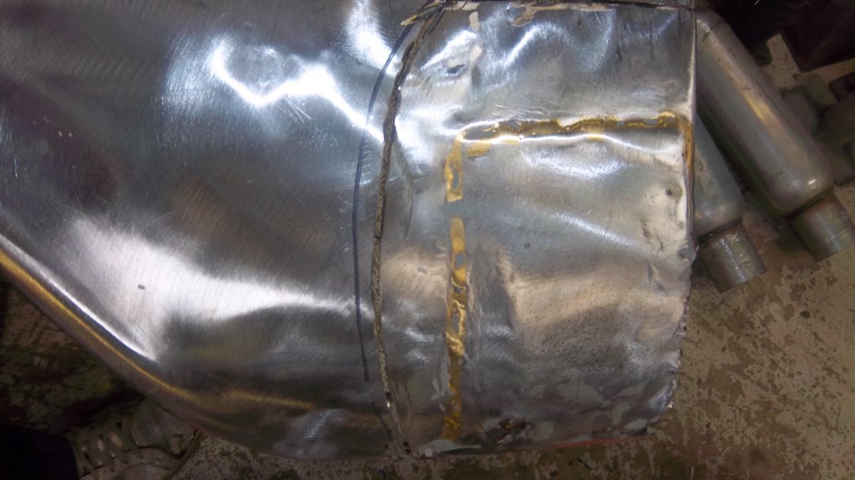

    Cut out the stock spare tire well, and put in a larger one, for the battery and tools. Fixed the rusty sections of the floor, and rewelded some of the PO's patches, too. Moved one gas tank support, so I could use a 56 Chevy gas tank. Lots of cutting and welding to make the new filler tube, though. New rubber between wheel wells and quarters, POR-15 and undercoat on the floor, and back on the ch***is! 100_2385.JPG 100_2395.JPG 100_2382.JPG 100_2398.JPG 100_2401.JPG
