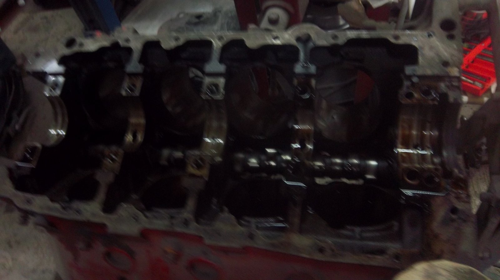

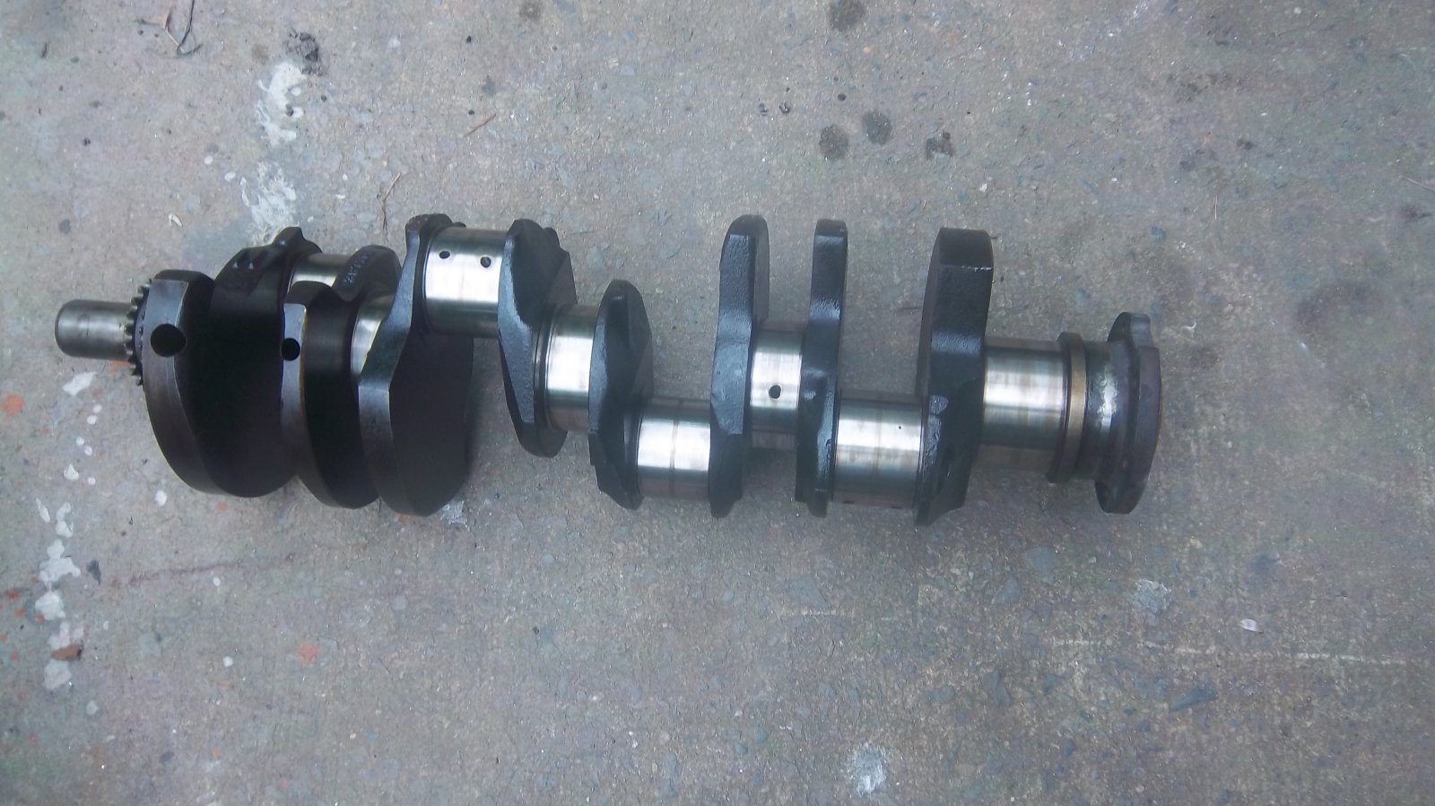

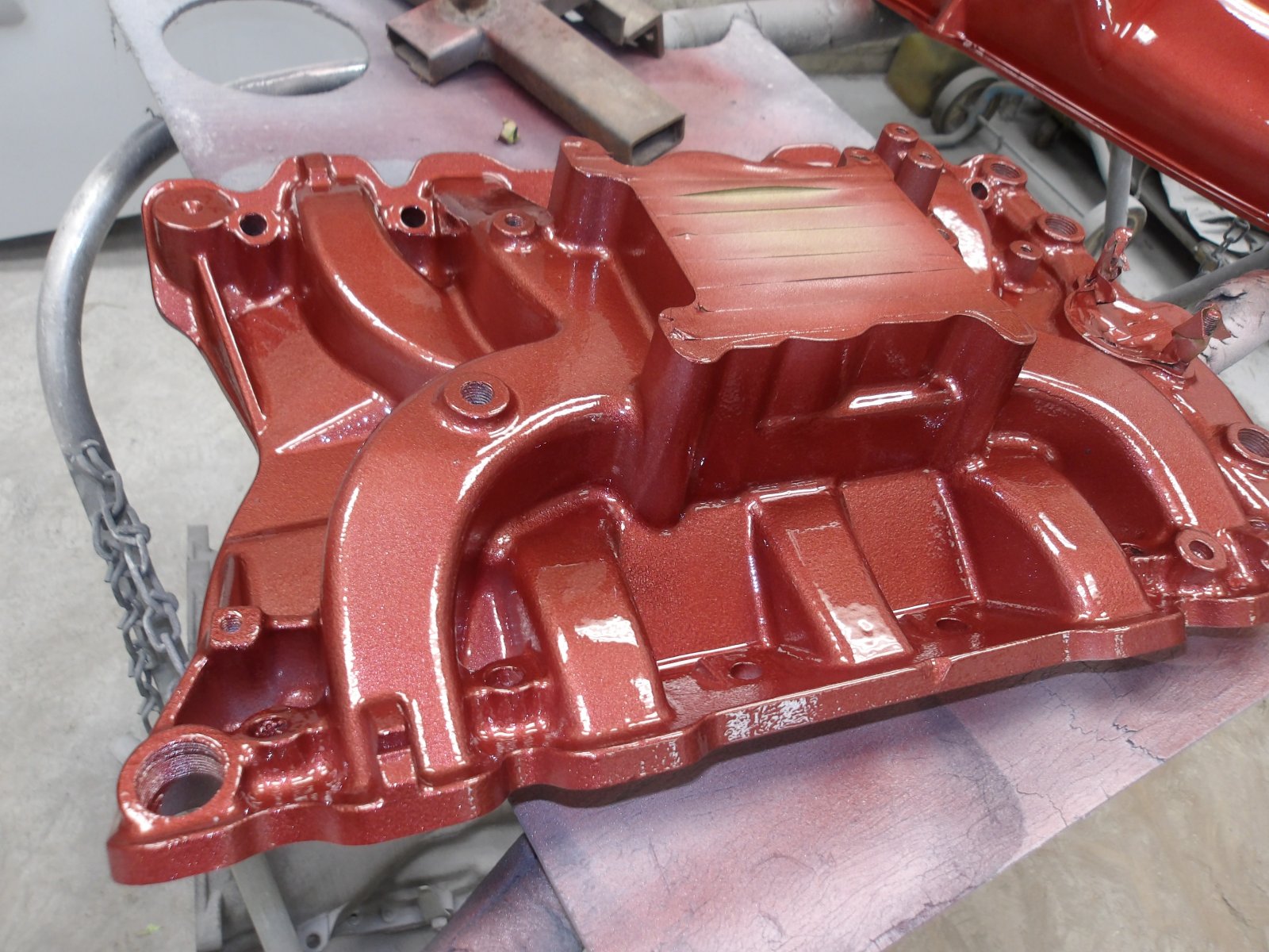

    My next step is building the engine. I order a cam and lifter in march, and just got them a couple weeks ago! Meanwhile, 455 block bored 0.030, new pistons, rings and bearings are here. Now waiting on the crank. Out being polished, or cut, whatever it needs. Once the engine is painted and installed, I can ***emble the front sheet metal and continue. Meanwhile, building other guys' cars!

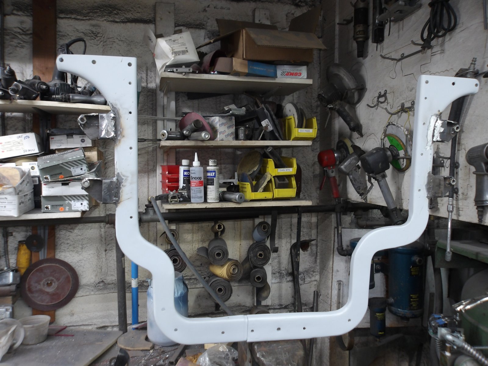

    Since the Olds never made a wagon in 56, there were a lot of modifications to do to get things to work right. A small matter, was that the tailgate, when opened, would hit the license plate guard on the back bumper. I couldn't eliminate it, as the bumper was formed around it, so I had to "section" it to make it shorter. Not easy for an angled part. Not easy, as it had to be chrome plated afterwards, so the metalwork had to be pretty good. I cut and welded it, and had to add a 2 inch piece to the center of the guard, due to the angled top not reaching the widened bottom. I TIGed it together, but then had to use lead to finish off the welds, and fill the low areas.
    It's not quite perfect, as it's difficult to work with hot lead, but my plater will now copper plate it, and I can add more solder, without affecting my previous work, to perfect it. 100_2458.JPG 100_2459.JPG 100_2460.JPG 100_2722.JPG 100_2718.JPG 100_2608.JPG 100_2606.JPG

    I always heard to not use lead on a part that needs to be chrome plated but silver brazing instead, which is what I always used. Any input on this?

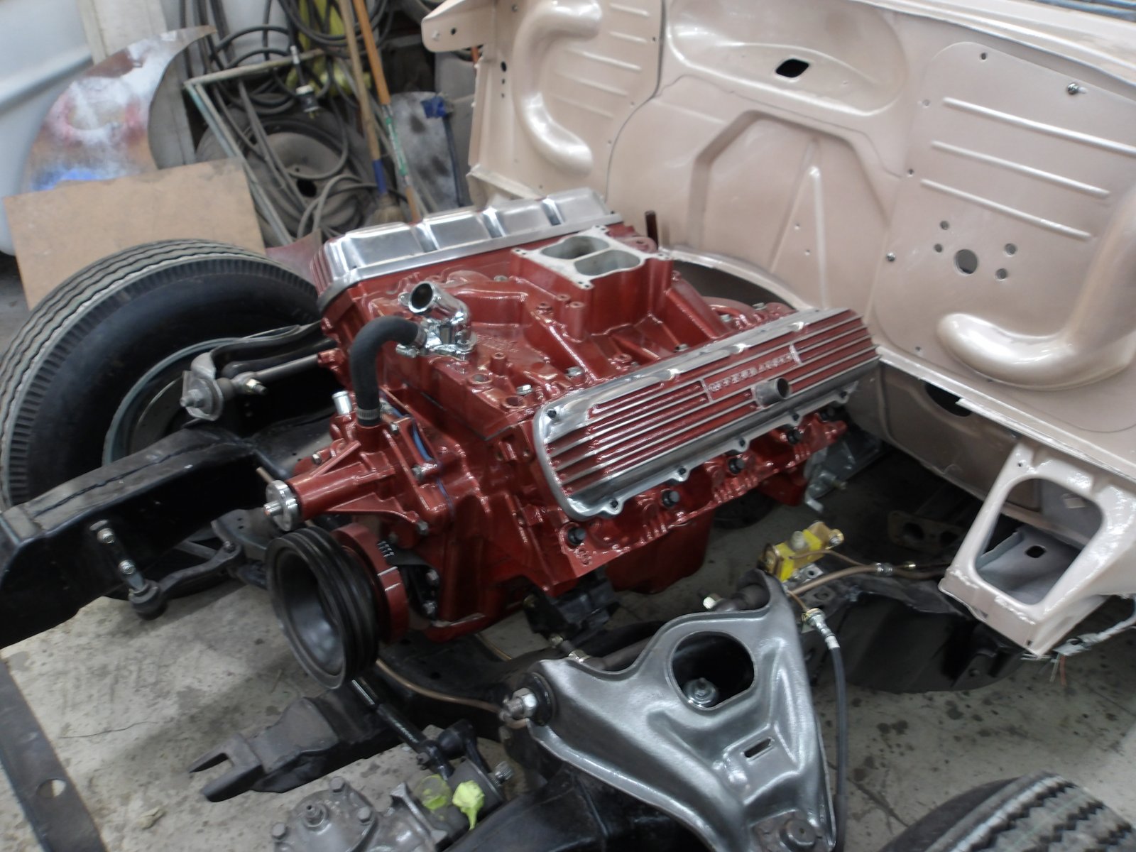

    Forgot to update! Engine is ***embled, painted, and installed. Now getting all the necessary things bolted to it, to get it running. Have to do surgery on the rad support, to fit the new ch***is, inner wheel wells, too. But so far, so good. Since I got the car completely dis***embled, I had to do a lot of trial and error, as well as soliciting advice on what parts go where (as well as a bunch of my 53 Lincoln's parts mixed up with it). Sheet metal, and also various brackets and pulleys from 2 different engines, maybe complete, maybe not!

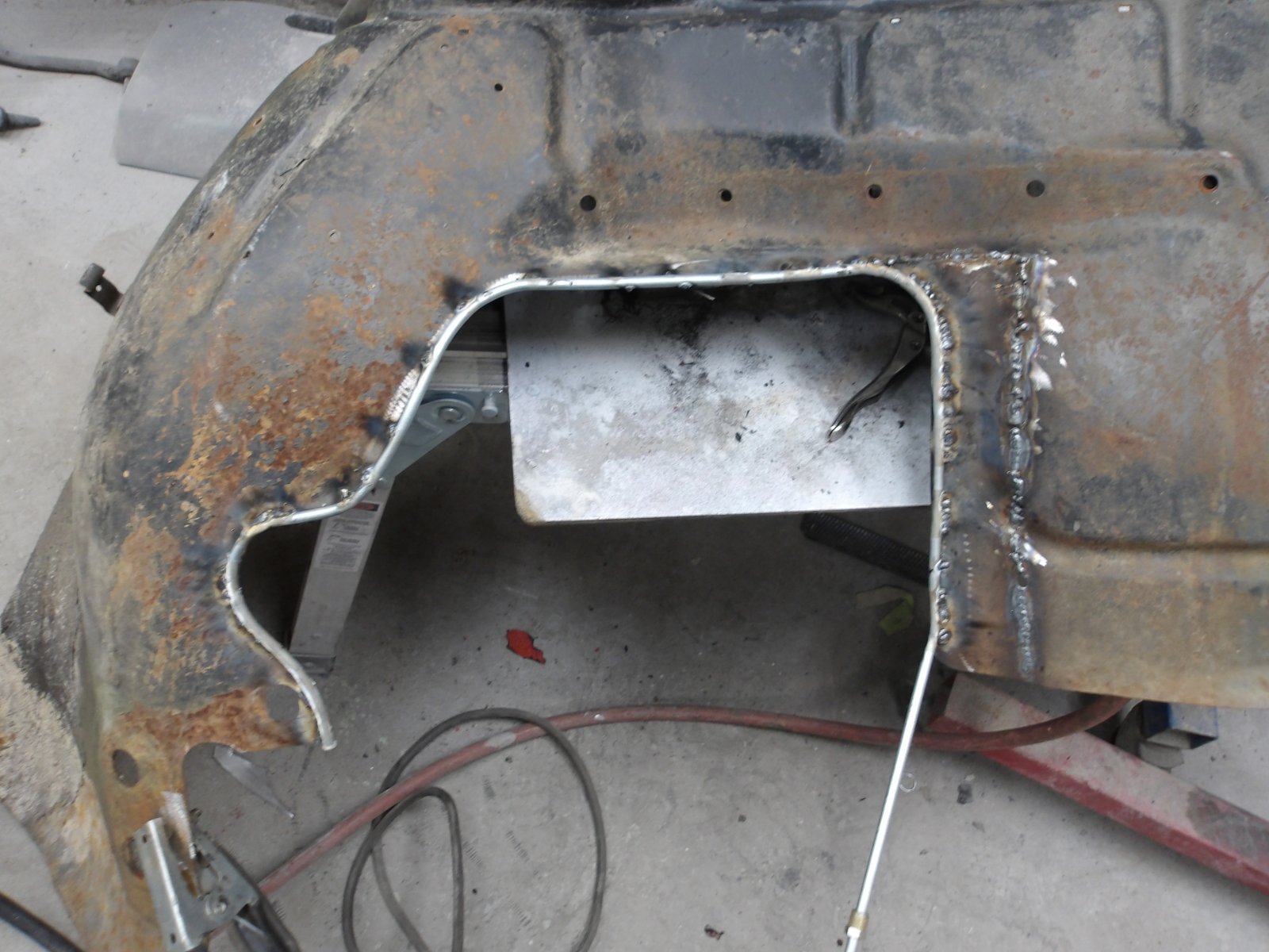

    Modified the front wheel wells, and radiator support to fit the different suspension, and be able to run a 4 core alum. radiator, to cool the big 455. Painted the front end inner sheet metal, but have to go over the undercoating. I bought a gallon of cheaper stuff, and it split and peeled on me. Upol Bedliner going on after I knock off the bad stuff.

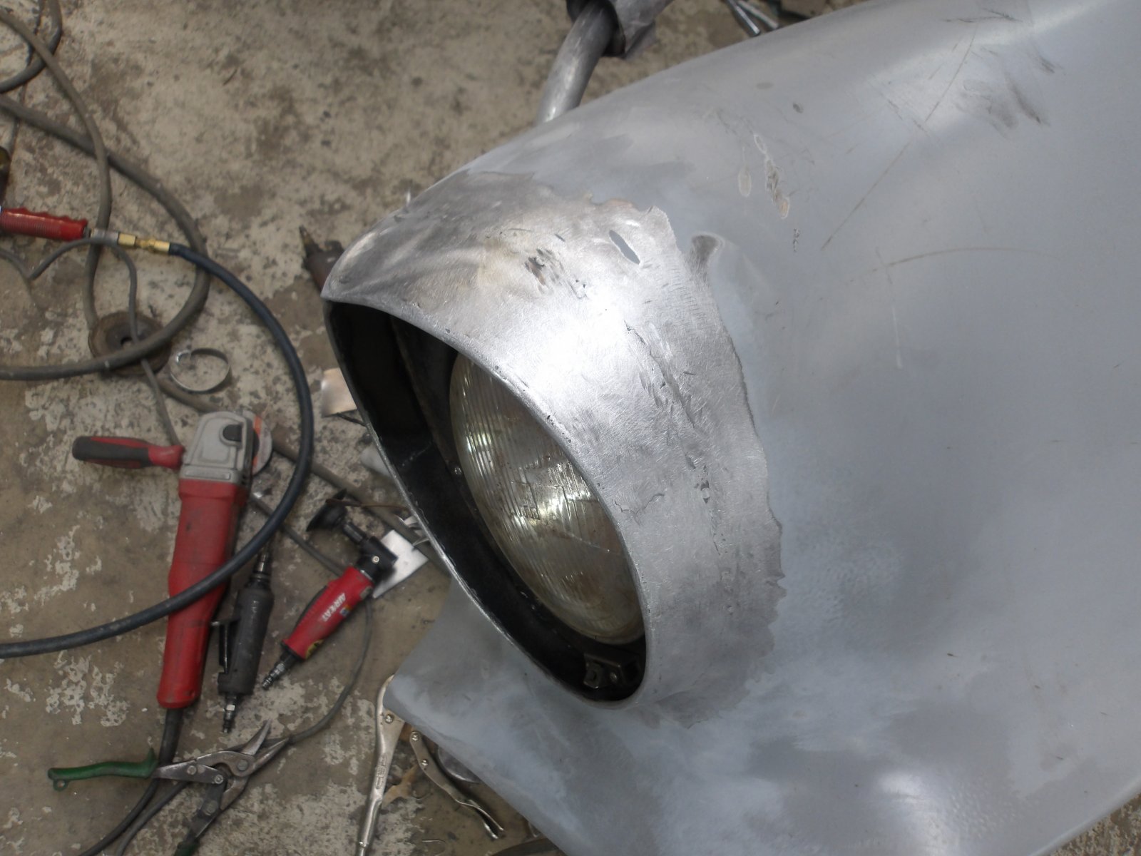

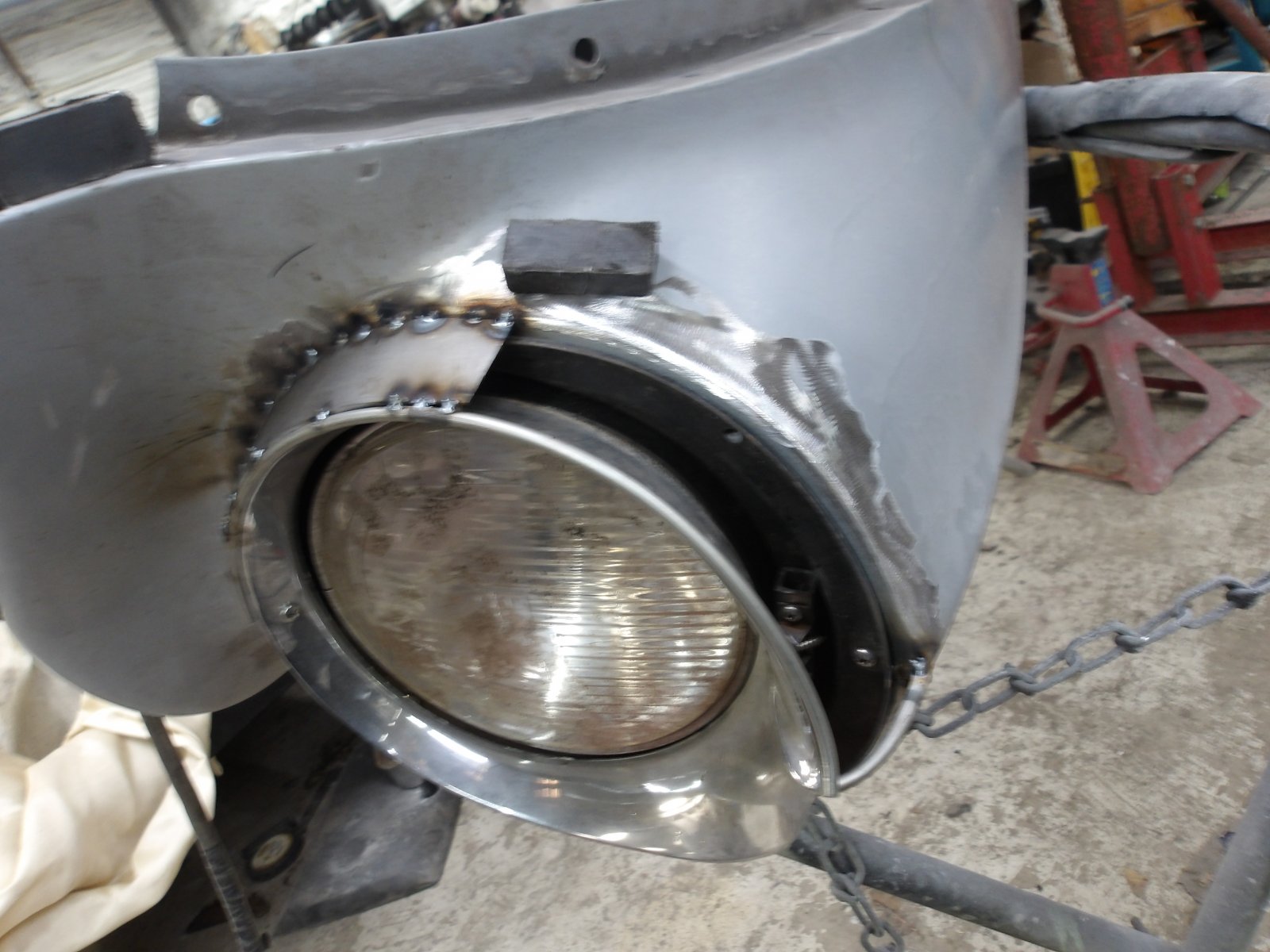

    Semi-Frenched the headlights. Since I'm going for more of a "concept car" vibe, instead of Kustom, I wanted to keep the stock bezels, but the Kustom guy in me wanted to change them, too. So, I compromised. I cut off the outer part of the bezel, just using the inner, and extended the fender to meet the cut down bezel.

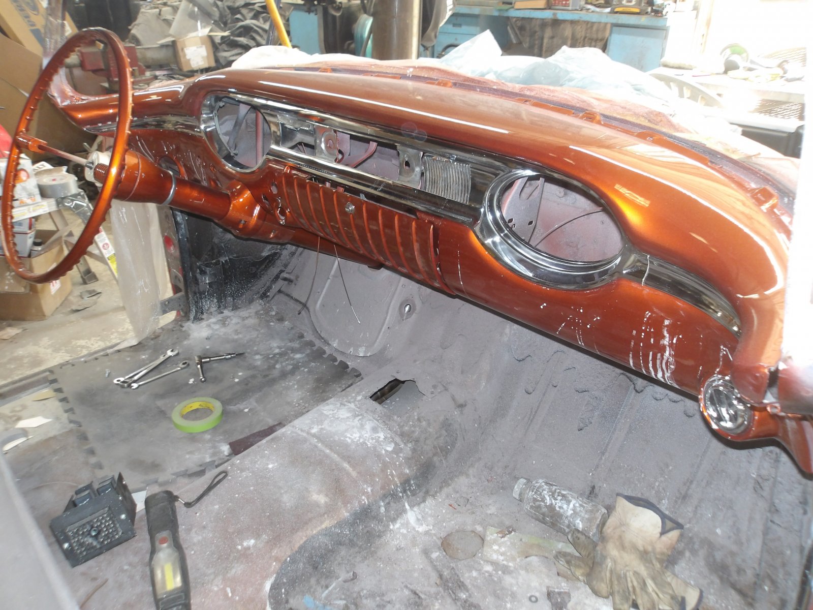

    As we all know, customer projects usually have priority over personal ones! Besides getting the engine just about ready to fire, I got the dash body worked painted, and buffed. Started ***embling it (also made AC duct pods in the dash). Bought a new windshield at Carlisle, went to cut it, and broke it. Made a fan shroud, as the fan extended below the radiator by a couple inches. Hoping to start it soon, and find another windshield, maybe a good original one. The new ones are thinner! 100_0250.JPG 100_0262.JPG 100_0280.JPG 100_0281.JPG

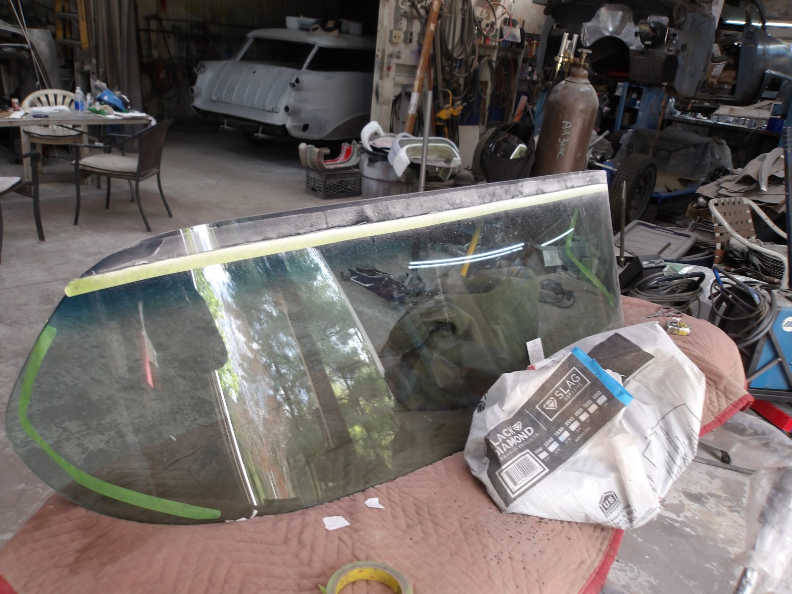

    Well, I did break it. It's the second brand new one I've tried to cut, and broke. With the old original windshields, I've got a much better track record, around 4 out of 5 not broken.
    So I've been searching for an original gl***, and finally found one in a junkyard in Philly. Paid WAYYYY too much for it, and it has a star crack right in the driver's view. But, I brought it home.
    After trying all winter to buy bags of dry sand, to blast it, I finally just went to Tractor Supply and bought some Black Diamond. Since I'm blasting outside, it's hard to try and recycle it, so lots of wasted money. But it did the job!

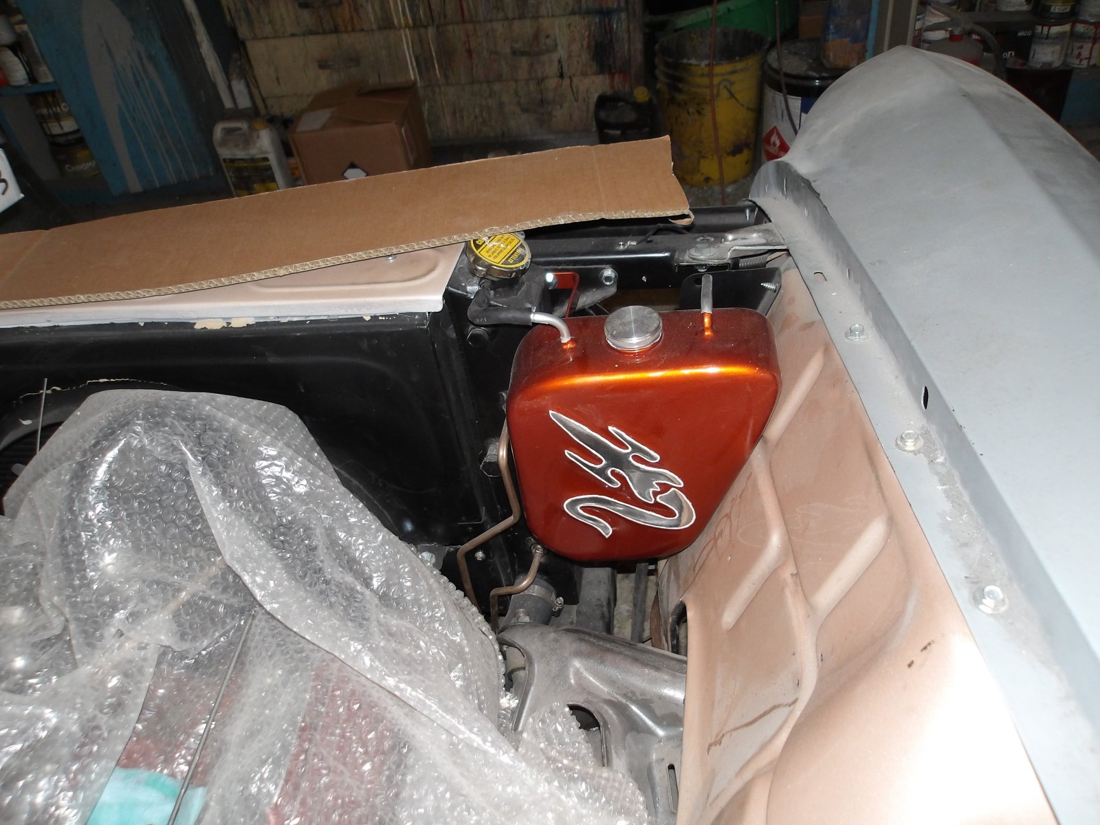

    Did more little things, like building a coolant overflow tank, making new doors for the fresh air vents, as I removed the factory housings to put the break booster on the firewall. Lots of little stuff, but I foresee driving it by the end of the year!

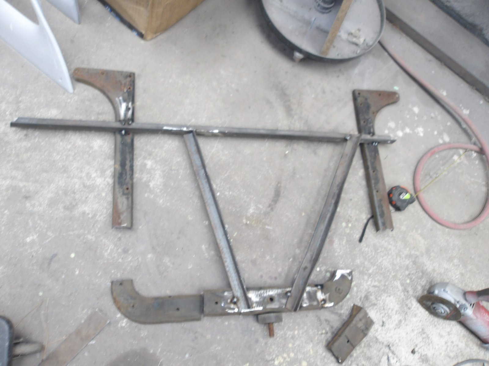

    Next hurdle is to try and get the Nomad seat to work in the Olds body. The rear end kick up is around 4 inches higher in the Olds, so the seat has to fold down, but raise up 4 inches to match the cargo floor, and rear kick up. I'm guessing custom hinges are in the future! Oh, and I'm working with a bunch of rotten wood, and rusty metal, that call themselves "a seat". 100_0593.JPG 100_0595.JPG 100_0656.JPG 100_0658.JPG 100_0594.JPG 100_0592.JPG 100_0597.JPG

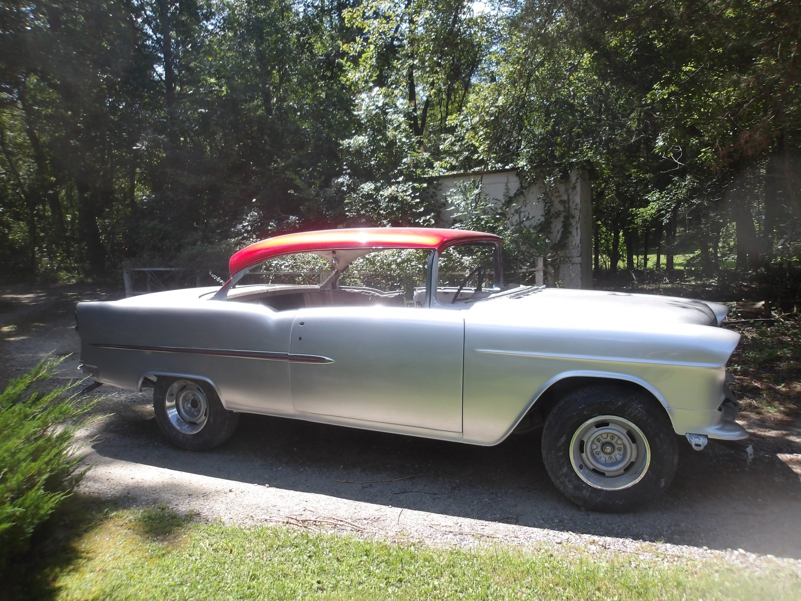

    Been a while, but I'm pretty slow! Did finish bodywork on a nice 55 Chevy, HOK Orion Silver and Candy Apply Red on the roof. As well as some other work, including helping put Kenny's 54 Plymouth on newly fabricated ch***is with C4 Vette suspension.

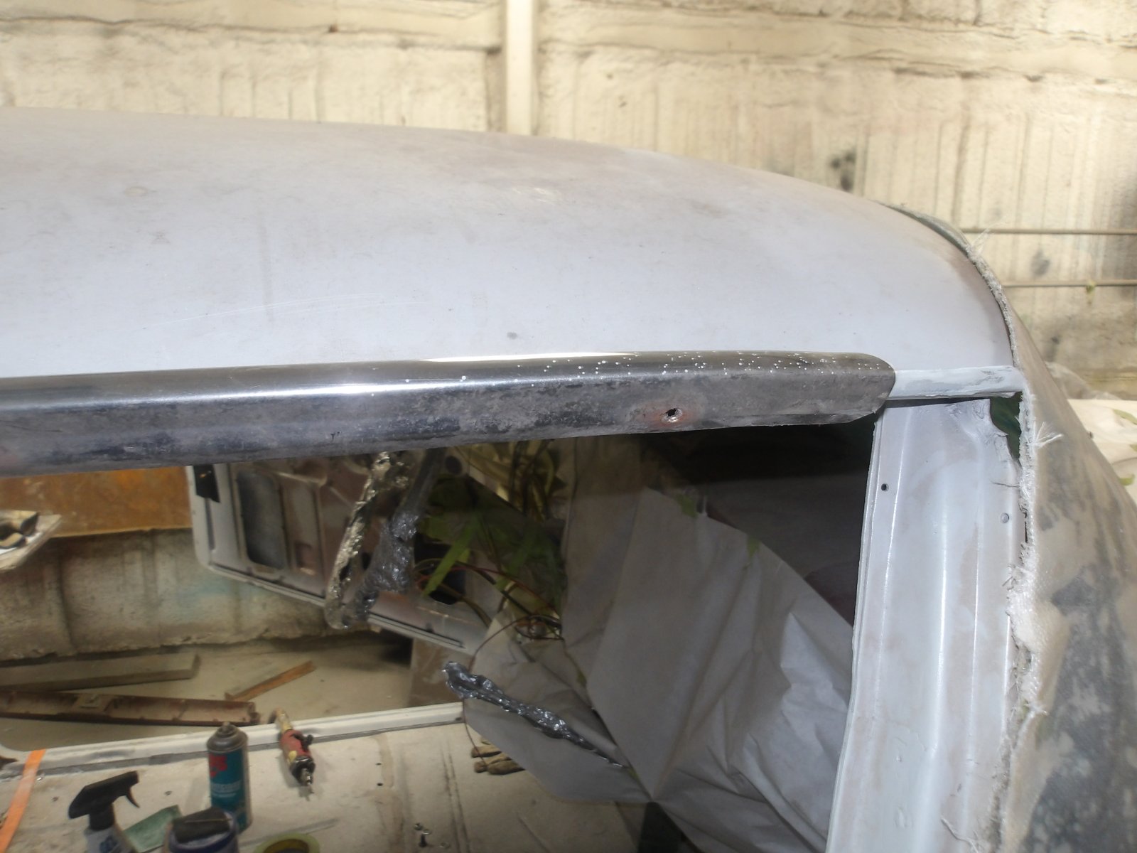

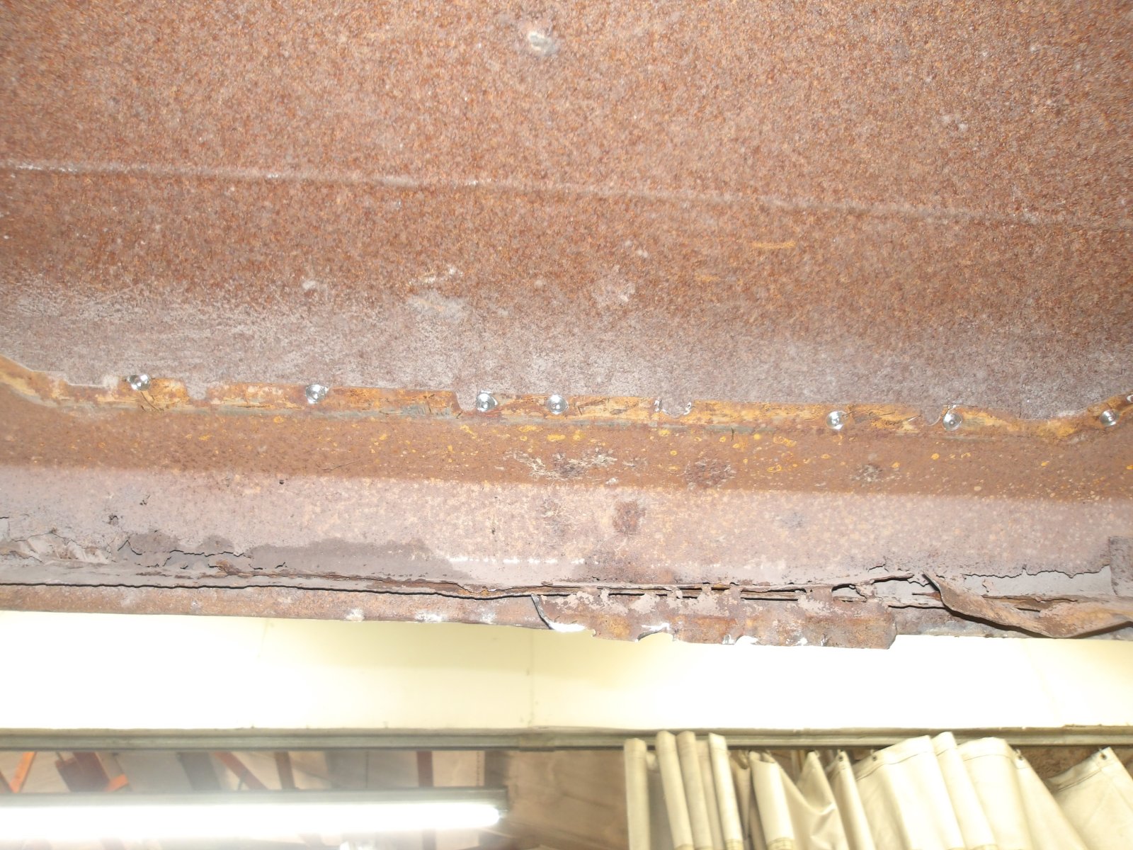

    As for the Olds-Mad, serious surface rust inside the roof made me remove the roof support rails, (millions of spot welds!!!!!), repair the rot, sand, abrade, and acid scrub the rust, and put it all together again. I also stripped the interior sheet metal to bare, and epoxy and Zolatoned it. Next, I wan to try to fit up the gl*** in the quarters, but seems the curved gl*** gaskets are unavailable, for the time being. Guy who made them supposedly went out of business during CoVid. But I keep looking! 100_0703.JPG 100_0715.JPG 100_0719.JPG 100_0720.JPG 100_0996.JPG 100_0994.JPG 100_1003.JPG

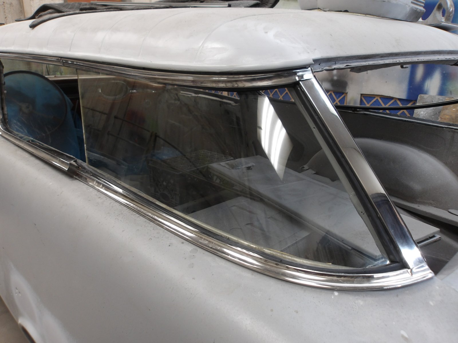

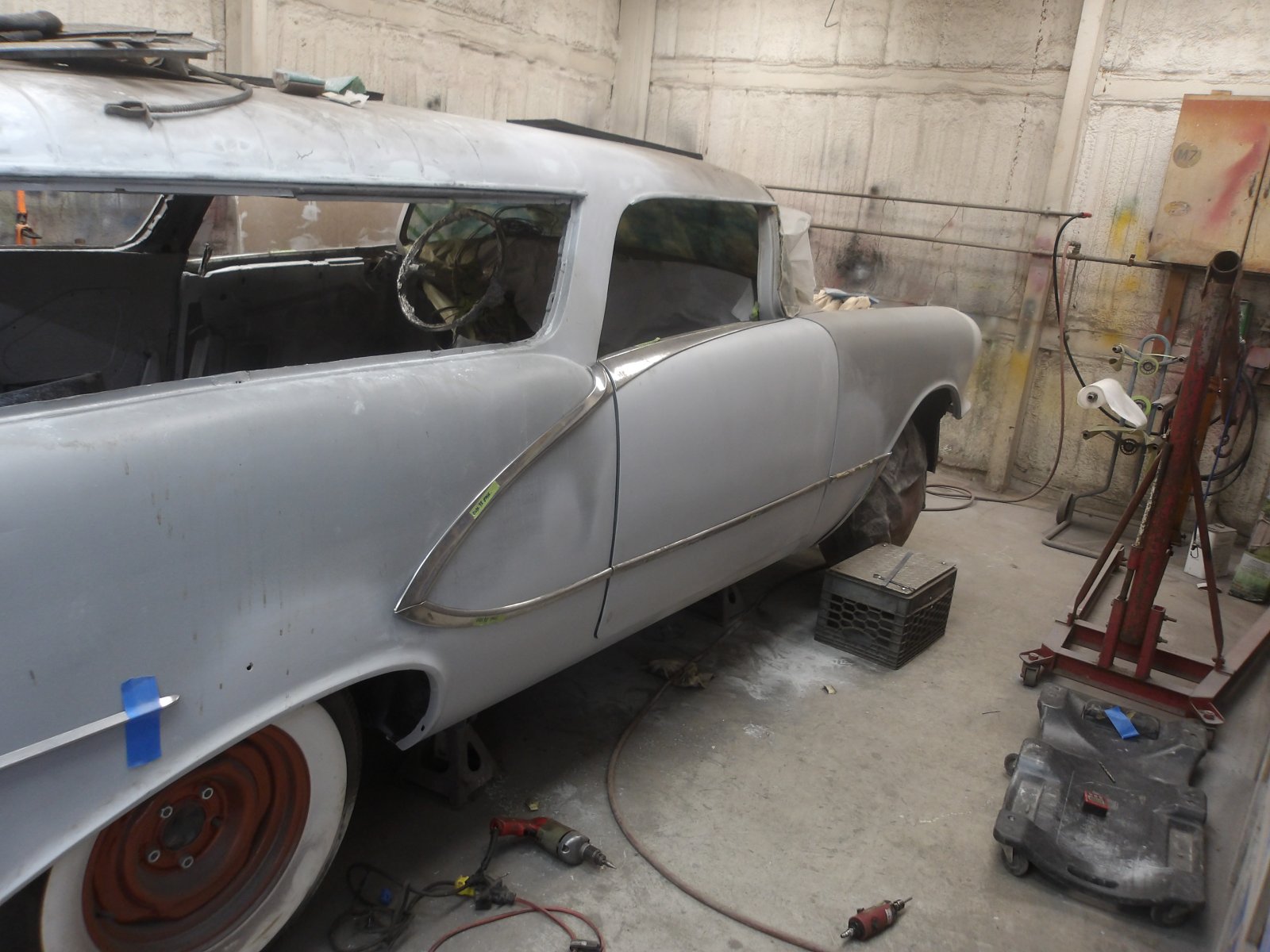

    Now we're getting somewhere! Played around with one of the curved quarter windows, cut it down, tried to find the correct gasket for it, but none available. So I found a replacement that is pretty close, it just doesn't have the front side correct for installing the stainless trim, and sealing the sliding window. But it fits, and it's (temporarily) in!!!!!
    SO, getting more confidence, I went to Carlisle, and bought a new front windshield. Up from $300, 2 years ago, to $450. Making me even more nervous to try and cut it. Well, after taking a couple weeks to get up my courage, I did it! After tweaking it, with a belt sander for a few days, it looks like it will work.
    So, also installed the hood, and found that it needs some reworking on the front lip to match the grill/bumper. Some from previous repairs, some from just factory mismatching.
    Got on the upholstery guy's *** to at least get me my front seat done, so I can take it for a ride! I had to make molds off of the old seat skirts (cheap-o plastic) and make stronger fibergl*** ones. 400.JPG 402.JPG 416.JPG 412.JPG 413.JPG 415.JPG

    Power washed it and rolled it outside. I even got to DRIVE it back inside the shop! 397.JPG
