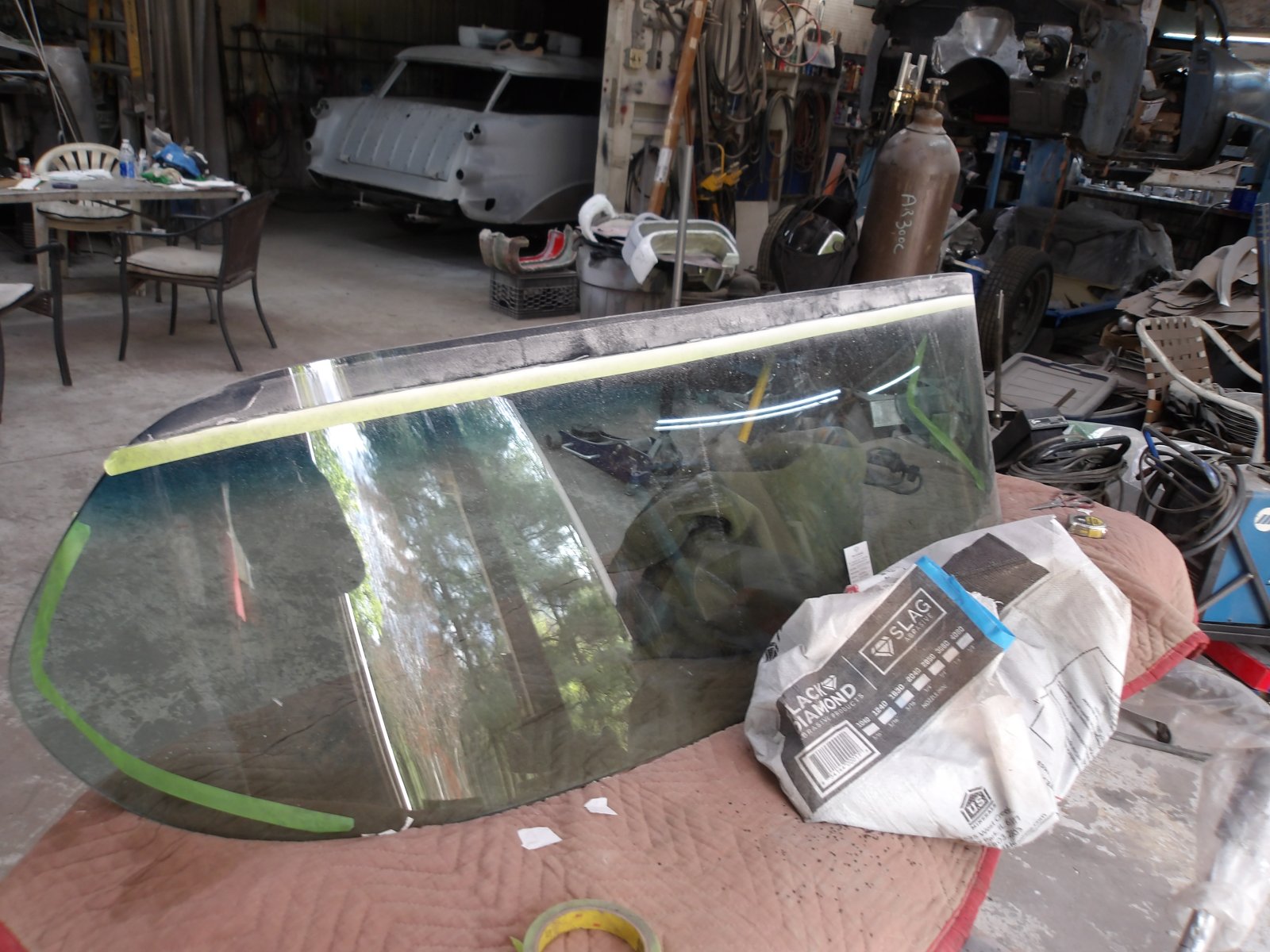

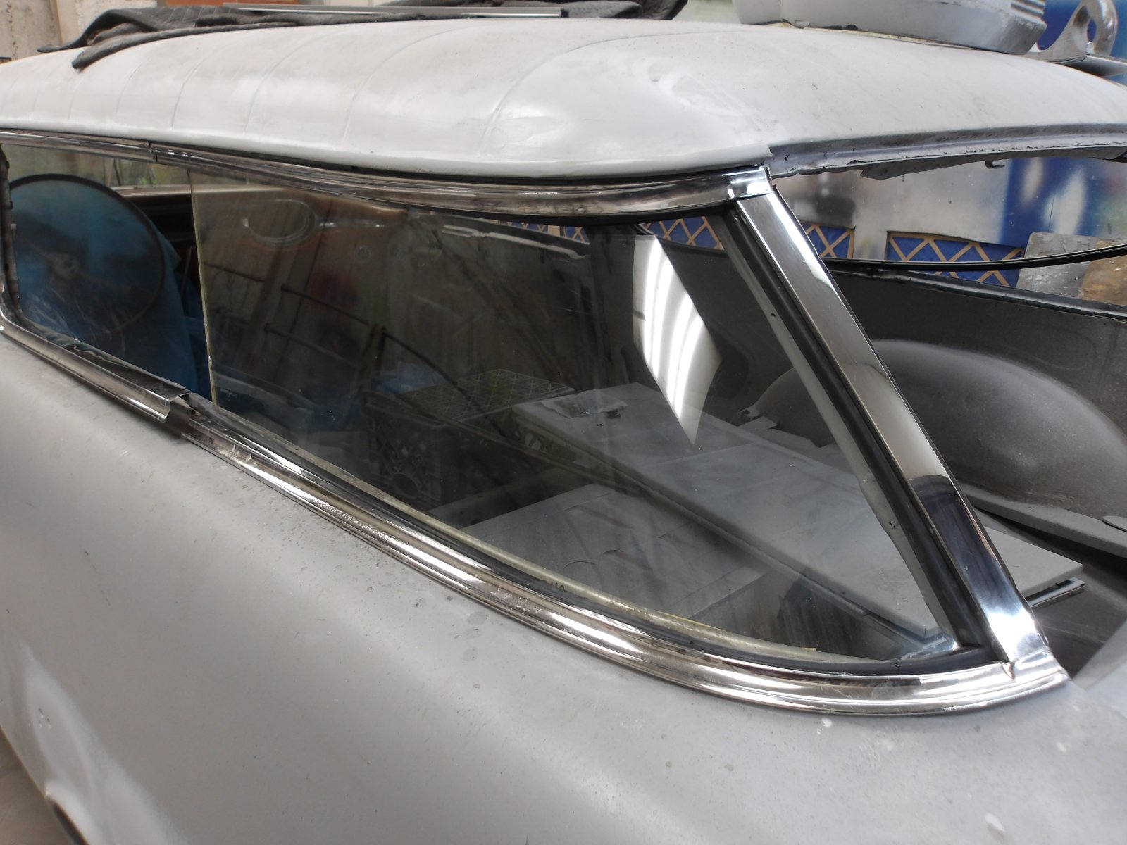

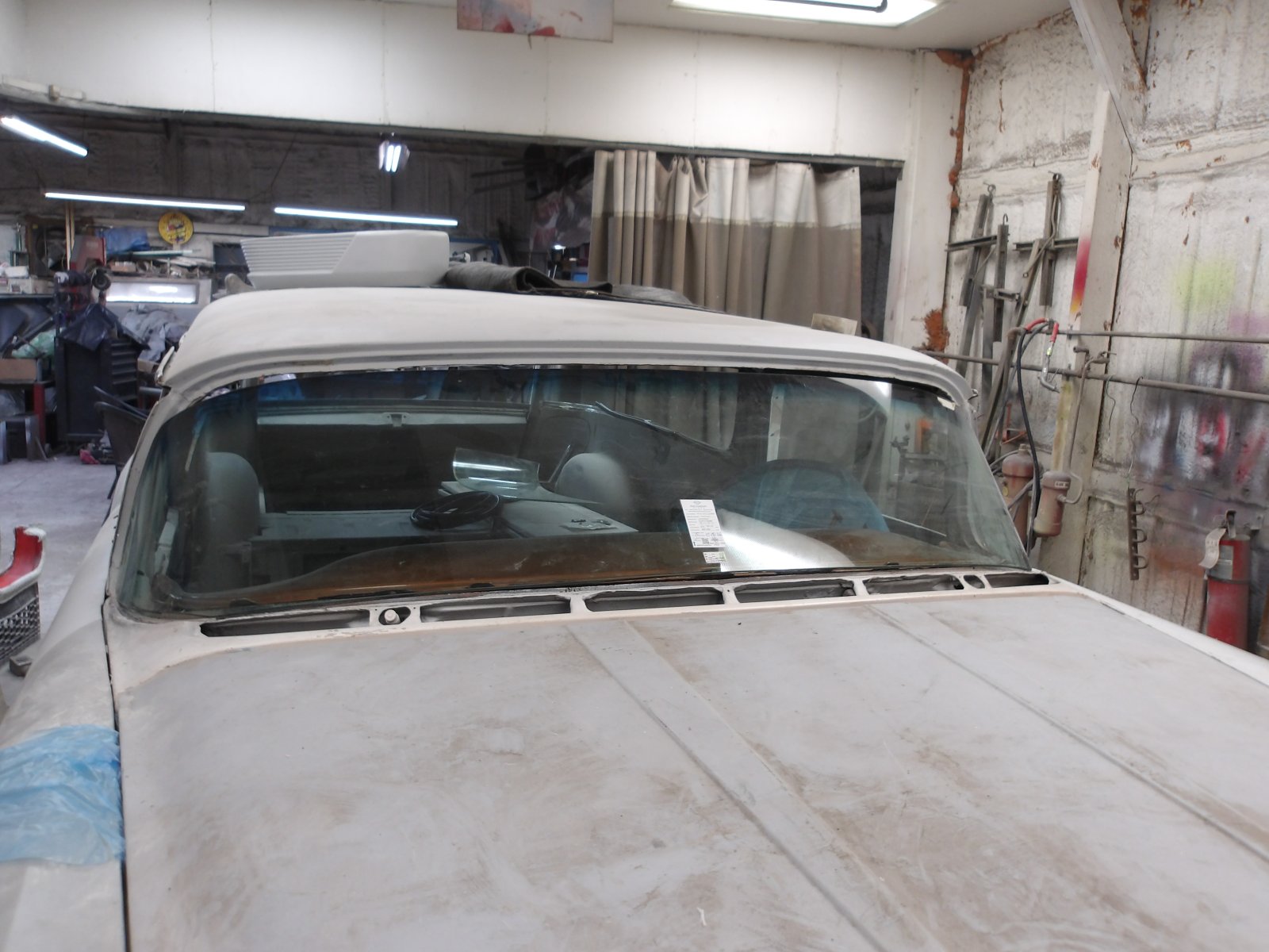

    Chugging along! Cut one of the curved quarter windows, successfully! So, I got another brand new windshield out at Carlisle, and with my confidence restored, gave it a shot.
    It's now cut, installed 412.JPG 416.JPG 415.JPG and sealed up, in the car!!!!!

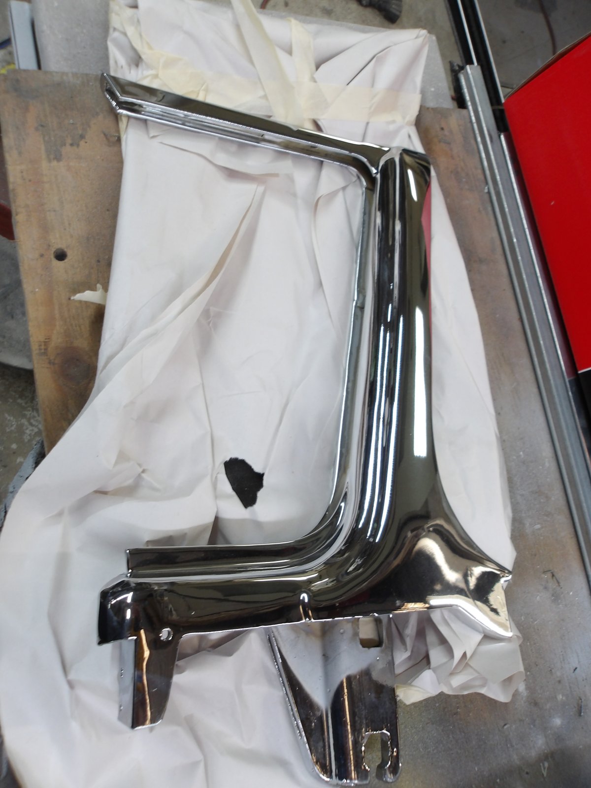

    Another task I was dreading, finished! The Olds has a pot metal vent window housing that had to be cut down. My old 55 was done by the best welder I knew back in '83. Long gone now, so the task was up to me! Got it cut down, the top reshaped for the Nomad roof, and the vent window frame also cut, in 2 places, for height, and again for pivot location. Also cut and welded up the stainless vertical trim on the windshield. Had to make a small 'filler' piece for the gap when leaning the gl*** down. 417.JPG 419.JPG 420.JPG 424.JPG 422.JPG

    More good news, the vent window housings are back from Super Chrome in Asbury Park, NJ (local guys to me). They did a fantastic job plating over the welded pot metal! 426.JPG
