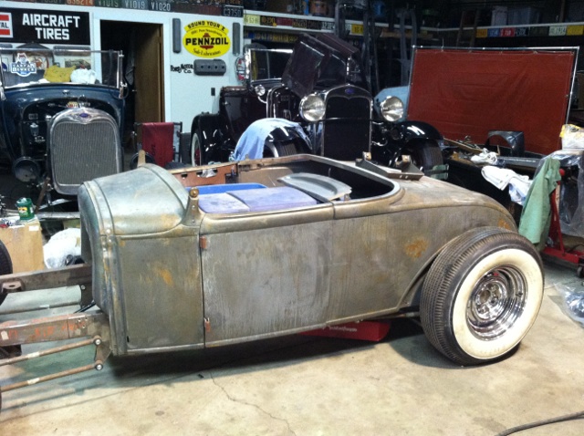

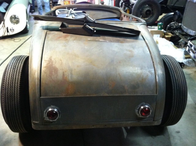

    Here are a few pics I received from the seller. 31.roadster.jpg IMG_1096.jpg IMG_1098.jpg

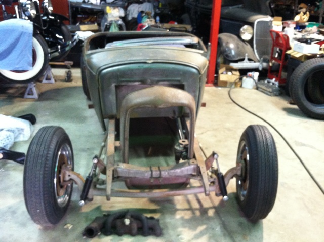

    So, I picked up the car three weeks ago, and not much progress other than taking stock of the parts I have and need. I was going to start in earnest this weekend. The suspension is pretty much done. It looks like a Pete & Jakes frame (based on the design of the rear cross member - let me know your thoughts). It is zee'd 4 inches in the front & rear. The front axle is Super Bell (and probably the entire front suspension). It is 4-link front and rear, with leafs in front and coil-overs and a Ford 9" in the rear. So basically all street rod stuff - traditional "inspired", but not traditional in the true sense. The admins will have to decide if this thread needs to move to the general board.
    The suspension needs very little work (mostly just parts - to be more accurate). It needs fasteners and the front panhard bar, but not really any fabrication needed. Since there is not much to be done to the frame/suspension, I thought I'd start fitting the engine and working on controls/pedals/steering. I have a bell housing now (bought from Grumpy -thx HAMB), so I was going to pull the body off and get the engine and trans mocked into place.
    That was the plan... then on Wednesday I tripped over my dog and separated my shoulder. So, here are some pics of the car in my garage and the engine and trans on the bench - where they will likely stay for the next couple of weeks until my arm is out of the sling. This gives me more time to plan and shop for parts, I suppose. Speaking of planning, there is a question for you guys below...
