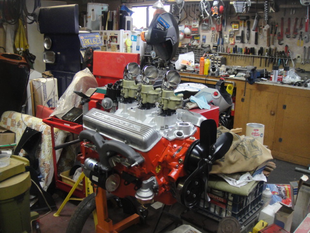

    Like your idea about making a vintage looking SBC.....here's mine. Its actually a 300 HP/327......going in a 51 Ford.

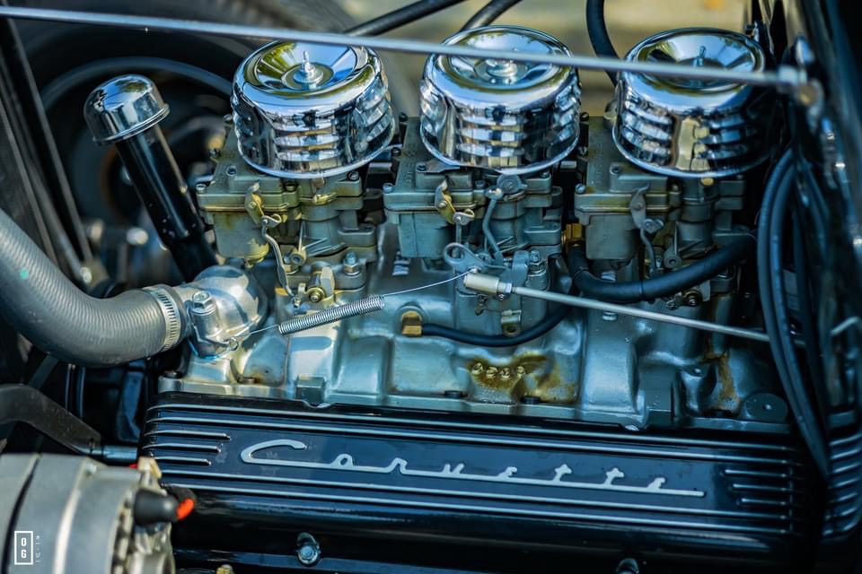

    I repaired the threads in the intake and refinished it. I used Duplicolor "cast aluminium", which is a bit darker and more blue-ish than the "bright aluminium" finish. I think it looks pretty good. I also painted the valve covers. They need another coat. As I said above, my plan is to go back and polish the "Corvette" script and edges of the fins. I have to pick up more carb studs.
    This is what the carbs look like after spending 12 hours in the crock pot full of pine sol:
    I am not happy with this result. I think I am going to clean them again with an old fashioned chem dip - sorry Nature. I tried. Also, after seeing U-235's set-up in the post above I'm definitely going with the yellow chromate dip. I ordered some supplies from Caswell.com; the carbs will be my project this weekend if the Caswell delivery comes by Friday.

    I wasn't happy with how the carb bodies came out after just the Pine Sol dip. I know you guys like photos, so here's a photo journal of what I ended up doing. If anyone wants more details about the zinc plating process, I took a bunch of pics along the way, so I could post those, too. See above for the "before" pic after they came out of the Pine Sol, then...
    After soda blasting:
    Into the zinc electroplating rig:
    The carb on the right is fresh out of the plating bath. It is zinc plated, but because I was using a 6v charger (too much voltage, note the bubbles in the pic above), the plating didn't lay down flat -- it has more of a sandblasted rough cast look to it. The carb of the left was plated same as the other, but then it was brushed with a soft, br***-bristle wire brush. Much better.
    Both carbs - top and bottom - brushed after plating:
    Into the yellow chromate solution for 10 seconds (heated to 80 F using a crock pot - anyone want to come over to my house for pot roast??!):
    And here's an example of the carbs after they were dried. I didn't want the bright gold or easter egg yellow look. I was going for more of the original yellow-olive look:
    The linkage looks wonky because nothing is bolted together yet. I was just checking to see how the color looked next to the intake. The center carb had been plated before, and it came out a slightly different color, but when the whole thing is put together I don't think it will be noticeable unless you really look for it.

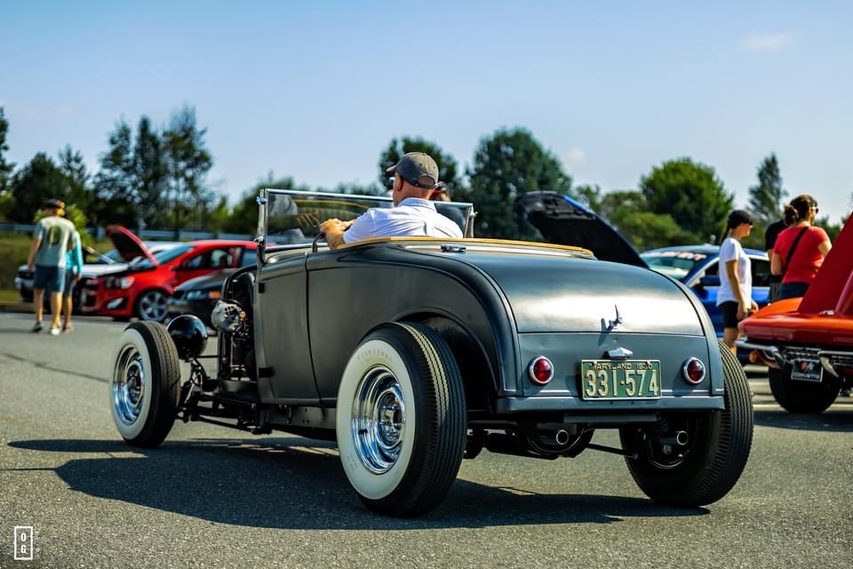

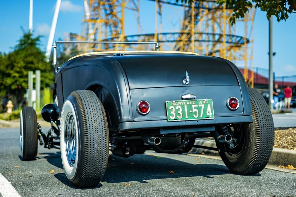

    After driving it around for a bit, I think I am going to change a few thing up - go for more of a cruiser vibe. I am thinking of putting fenders on it, switching to an automatic, and moving the master cylinder under the floor. Braking takes quite a bit of force - my pedal setup is kind of a hodgepodge of circle track parts and custom. I am sure the ratios are wrong.
