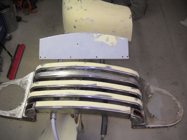

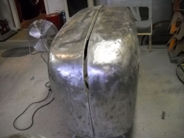

    Did some hammering this weekend.
    That left running board looked like a total loss, but I hammered on it for a couple hours today and got it into decent shape. I will lay a coat of 'gl*** along the outer edge and it will look like new. The right one looked better, but it actually took more work. Cheapest steel running boards out there are $400 + shipping for new. Other steel that look OEM are much higher.
    The bed now has a 1 3/4" square tube steel frame and is quite solid. I have to replace the front panel and spend a day hammering on the back of the cab.

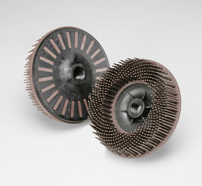

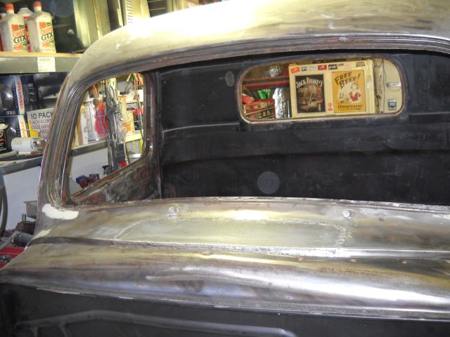

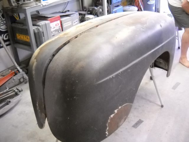

    I stripped the entire cab and front fenders to bare metal a few weeks back. I used the 3M brown bristle disc in a 4.5" angle grinder. This was about 3 hours work, pausing to rest and let the tool (and the tool running it) cool off. :D

    Here is the rot on the front bed panel. I replaced it with a donor from an 80's Chevy truck:
    Here is the tube frame I made for the base:

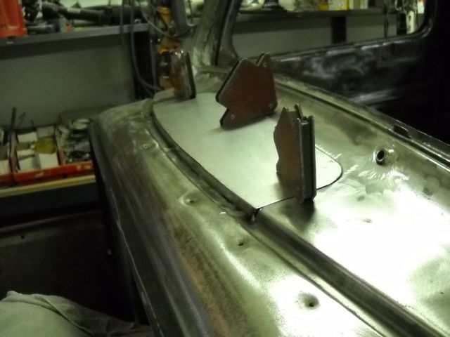

    Filled the cowl vent

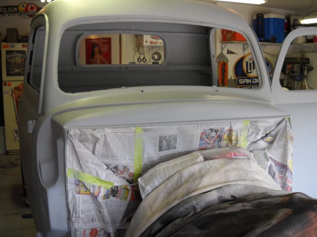

    Here is a shot of my PPE and the primered cab:

    This shows a 3M Bristle 60 grit bristle disc and what it will do in pretty short order to two layers of primer, two layers of paint, and body filler. It has tremendous advantages to media blasting:

    Nice, looks like I need to get me some of thse 3m discs. How much did you do with one? Use it on an angle grinder?
  26. wildearp
    Joined: Oct 24, 2007
    Posts: 521
    wildearp
    from tucson, az
    4.5" electric angle grinder. Very little pressure, let it glide on the work surface. The wheels aren't cheap, unless you get them on the intarwebs. About a half of one wheel did those rear fenders. The brown wheels are the best.

    Have you used the 3m purple stripit discs? Are these better? I'm getting ready to buy another box, might switch if they work better. Thanks

    Yes, I use the purple discs. For flat surfaces, the bristle discs are much faster, and they do not like tight spots that will easily break off the bristles. The purple is great for edges, door jambs, etc. The cheap copies that harbor freight sells don't last 1/4 of the time the 3M purple discs last.
