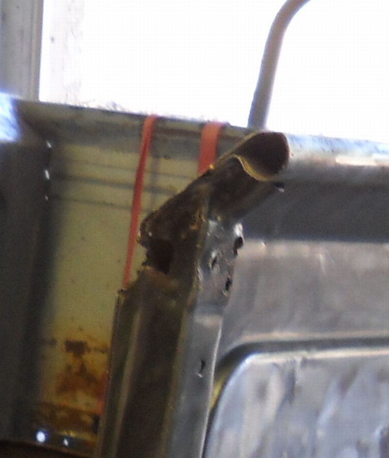

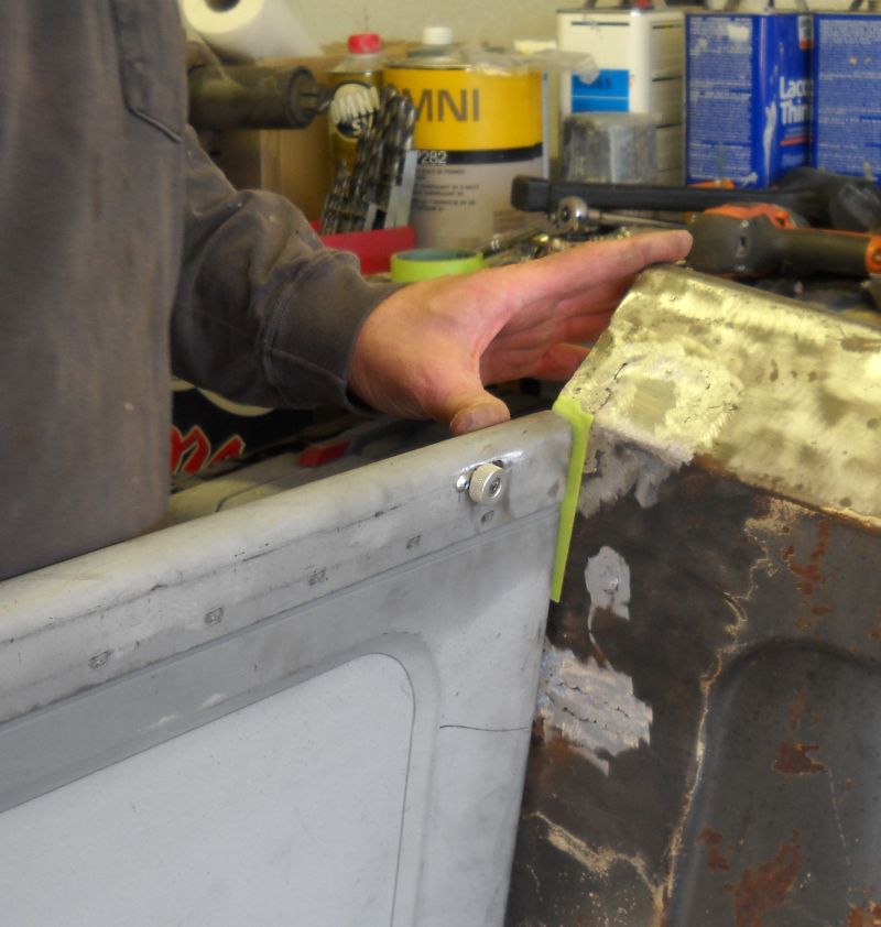

    Here are the holes I fixed on each side. I plugged the tailgate holes and added hidden latches from Mar-K. I also filled the stake pockets. During all of this, the motor on my air compressor caught fire..................:(
