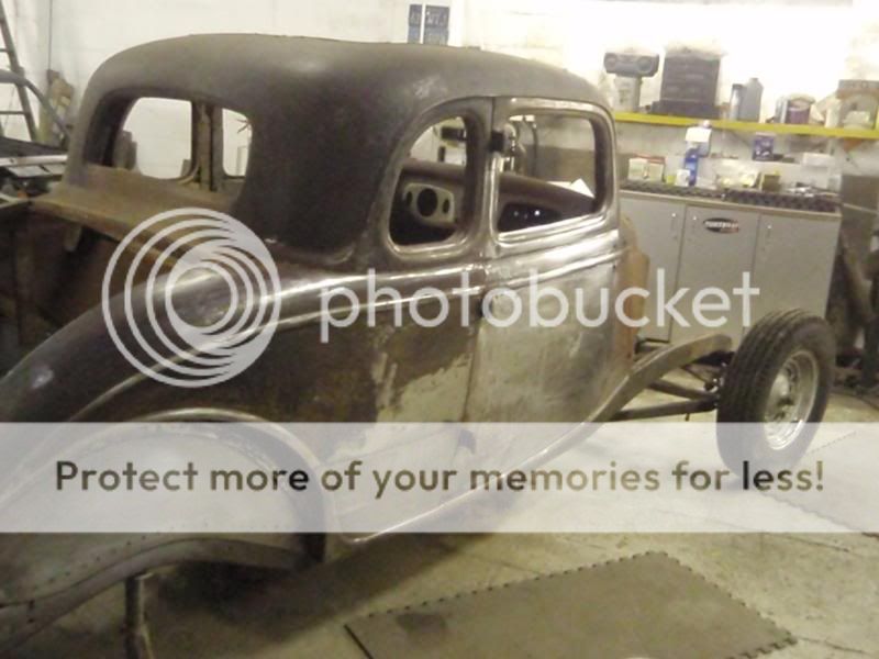

    Well I got the other side in,
    and cleaned some things up
    then had a play
    Just waiting on them panels but still no sign :(

  13. bobbooth
    Joined: Mar 8, 2006
    Posts: 383
    bobbooth
    from limeyland
    Hooray she's up and rolling, after ages ******* about with the rear spring which was beginning to do my head in. its a 39 rear end with a 34 spring just seemed like forever to get the old bushes out of the perches and eyes of each spring. But happy as a pig in muck
    ignore the ****py tyres
    And thanks for all the support guys it has certainly spurred me on :D

    To be fair NO and Yes :confused: I had to split the spring pack and put the lower leaf on which ended up flat and then bolt and clamp each leaf as I went along:mad: It was only done for mock up purposes and to make the car mobile just in case i should need to move it anywhere.I think that there is a problem with using that spring and will probably swap it out and use the 39 spring and grind on it a little;)

    Got a little done yesterday,modified some headlight stands and stuff, just for mock up purposes really..threw the hood /hubcaps and screen on...

    Hers a little question for you model 40 guys, I squeezed the 34 spring onto a 39 rear and fitted it up into the car, but something aint right i am getting a wheel base of 109.5 ", I'm using a stock front end so that is right, so was thinking that i will stick the 39 spring in (grinding a little) any other ideas?
  22. 2deuces64
    Joined: Mar 9, 2006
    Posts: 1,720
    2deuces64
    I'm thinking the spring mount on the 39 rear is longer causing the rear end to move forward. Changing to the 39 spring may be the way to go. This is an asumption since I dont have either rear end or spring

    Should be 112" wheelbase. Sounds like the curved spring along with the different-length hangars on the '39 rear are "placing" your rear too far forward. Beautiful build! DD

    Yep I agree gotta be the length of the axle spring hangers but I haven't got a 34 rear to measure off.
