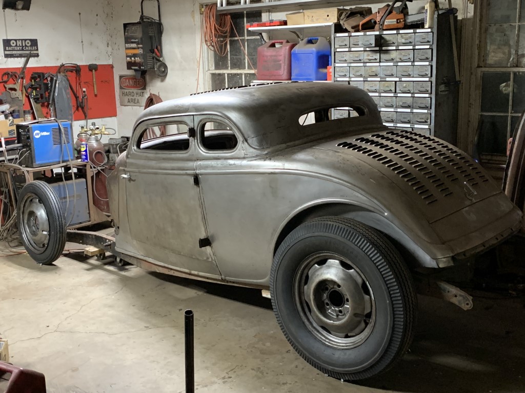

    Will motorcycle tire hold up to the side loads of a heavier car?

    Looks incredible! Quick question- did the roof insert change at all dimensionally around the perimeter after it was louvered??

    I guess we will see.
    I've seen these tires on some VERY expensive cars.
    Rich

    Not that I noticed.
    It did add a lot of strength.

  6. I ran them on my old T and drove them HARD up in the twisties. Never had an issue.

    DAmn, I don't know how i've missed all this. GREAT job Rich. you punch the louvers?

    So nasty looking…looks like it’s doing a hundred miles an hour right there in your garage!

    Yep, with a big hammer.

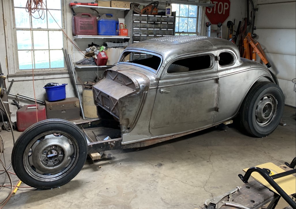

    When I put the stock spring under the car, it was WAY too high. IMG_0322.JPG

    I made a jig and started de-arching each leaf in the pack.

    I fabbed up the gas tank and battery brackets.

    I used three flatheads and three transmissions to get the parts that I needed.

    I'm using a 41 truck transmission, but it needed 34 type rear mount, and 34 type cross shaft and lever.

    Time for the stock crossmember and frame horns to go.

    Starting the sweep and pinch.

    Trim and fit the new crossmember.

    Motor mounts installed, mocking up the front axle.
