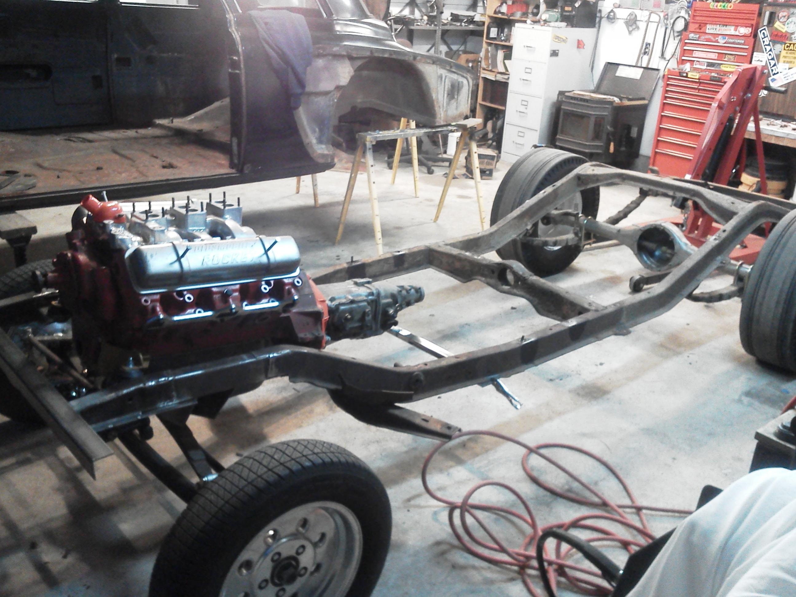

    Well got the body lifted off the fram over the weekend. Time to start cleaning.

    Well looks like I am going to have to make some adjustments to the frame. The original middle crossmember is going to create a issue with the drive line. So I am going to move it forward about 10 inches and open up the center to make a drive shaft safety loop. I am then going to modify the mount for the trans to come off it. Right now the existing mount and the radius rod brackets will end up sharing the same spot. Damn should have made more measurements before I bought the radius rods.

    Well I got more work done on the safety loop. Moved a existing cross member forwards and added the loop.

    Finished mocking up my front suspension.
