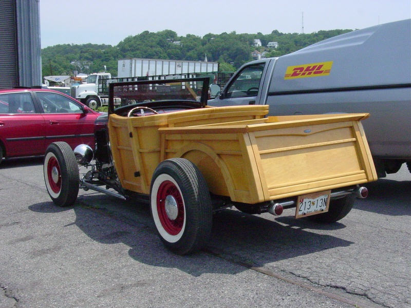

  9. Here's a very similar car built by Kirk Duquett several years ago. The trick in my opinion is to not build the body as slab sided, totally flat, box.
