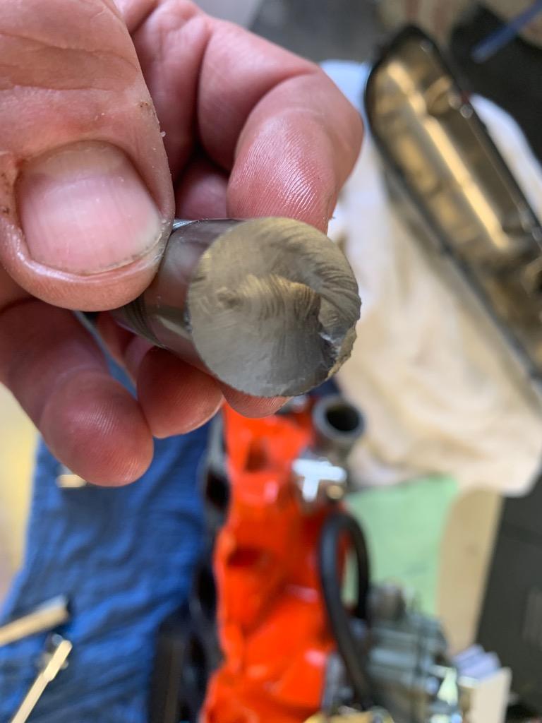

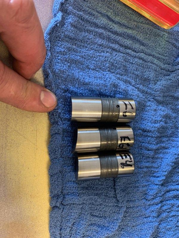

    NoelC, recently (past several months) many have shown pics of failed lifters, ground down. Unsure if I recall a cam pic or not.

    IMG_4002.jpg IMG_4004.jpg July, 2022 Summit cam and lifters. Heard a "tick" in 5 minutes, it got worse and shut it down in less than 20 minutes.

    Guess I missed that. I do stand corrected.
    But it goes to what I said. Heard a tick and waited till it got worse. I'm sorry for the loss.
    The question is why. Show us that but, why did it occur. Best we can conclude is thru no fault of their own. Doctor tried but the patient died, next. It's called practice. Some do it 3 times till they figure it out.
