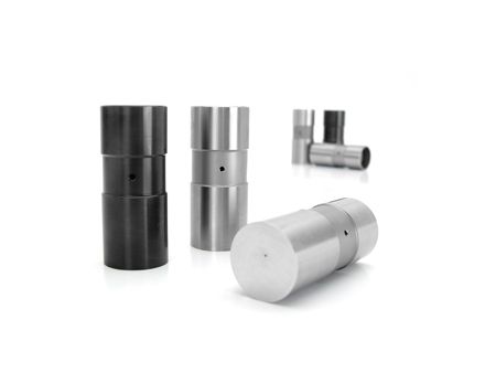

    Articles.... on wear.. interesting the DLC coatings.. this was used in high load diesel engine components well over 10yr ago. Cost tends to be the primary limiter. Also.. early in the break-in procedure is of note. Post 2007... diesels.. When oil formulation changes other non common wear began to appear. Many of these issues were addressed with improved surface finishes...
    Trend Article:
    The bane of flat tappet lifters is, of course the break-in period where minimal lubrication and valve spring pressure conspire to flatten a cam and ruin lifters very quickly. Aggressive cam designs and valve spring pressures only exacerbate the problem so very careful break-in procedures are required. Special break-in oils with higher ZDDP content are recommended and the best procedure is to pre-oil the engine prior to firing so all the oil galleries are full. Following that, most builders take the engine immediately to 2500 rpm to ensure plenty of oil splash during the 20-30-minute break-in period.
    Typical flat tappet solid lifters are manufactured from hardened iron or chilled iron which is inexpensive and easy to machine. However, Trend's flat tappets are manufactured from tool steels which is much harder and stronger and allows the lifters to live in incredibly brutal racing environments. They are available in Cup, and Premium versions which are compatible with tool steel and cast iron camshafts respectively. In addition to strength and wear resistant characteristics, the properties of tool steel, and available DLC coatings, reduce friction which promotes power.
    Good to see this tech making it main stream.
