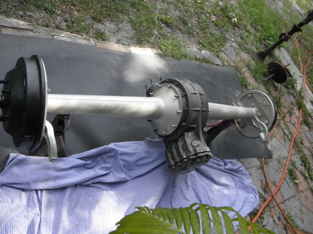

    Here are some photos of the complete unit. I love the look but parts and differentials are expensive to make them work on the street.
    ***embled with 40 axle tubes and 48 brakes.
    Right and left adapter plates.
    NOS center section with adapters H852A.
    Inside look at bearing cups and seal area. These are NOS.
    This NOS is aluminum that has set for a long time and turned dark gray.
